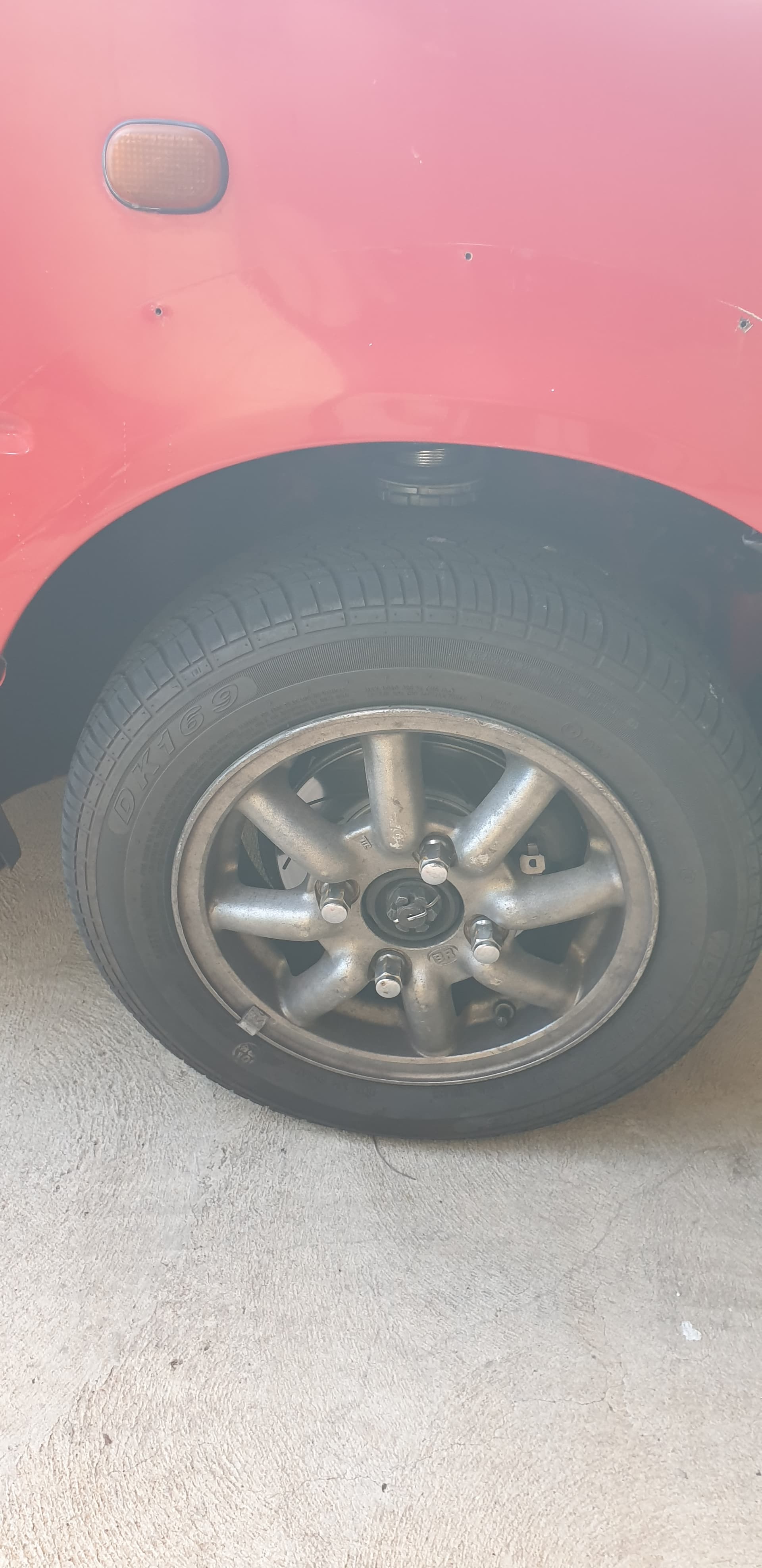

Hi Guys, I’ve got a Trxx dash cluster installed in my L200 but the speedo undereads by about 10kph is there any way to recalibrate it ? Its had a EFJL dropped in so Im running the 5speed box with LSD, when it still had the standard instruments installed read fine. Cheers
what wheels are you running?
Hi mate 145/70

By the looks of it the L200 with the 5 speed lsd from the trxx ran either 155/70r12 or 155/70r13 tyres.
Basically the speedo drive off the secondary shaft is toothed to match the tyres.
