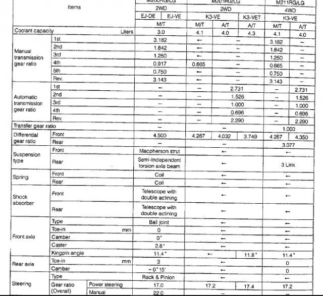

Thanks for comment. Maybe someone is know what are technical differences. I think it can be difference gear ratio like that table. I guess this difference about speed and acceleration.
oh nice. so there’s another one - different final drives
…and little more oil in the VET
…runs of a larger cooler as well
