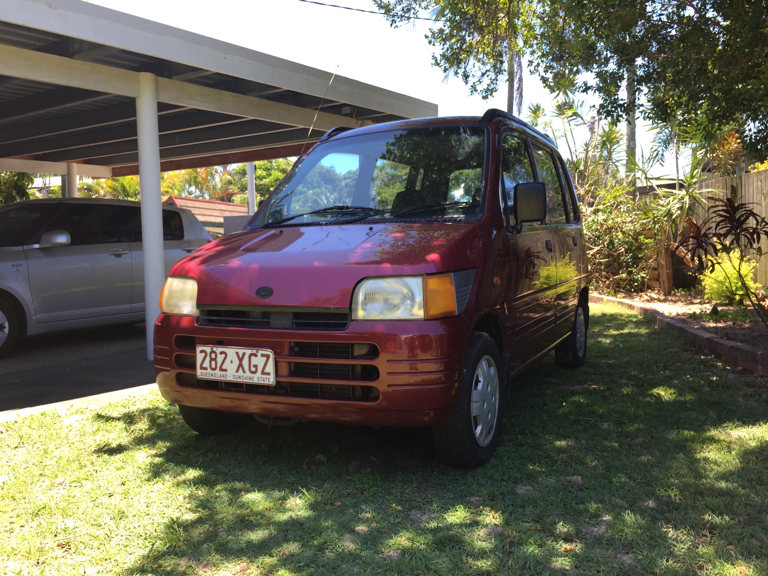

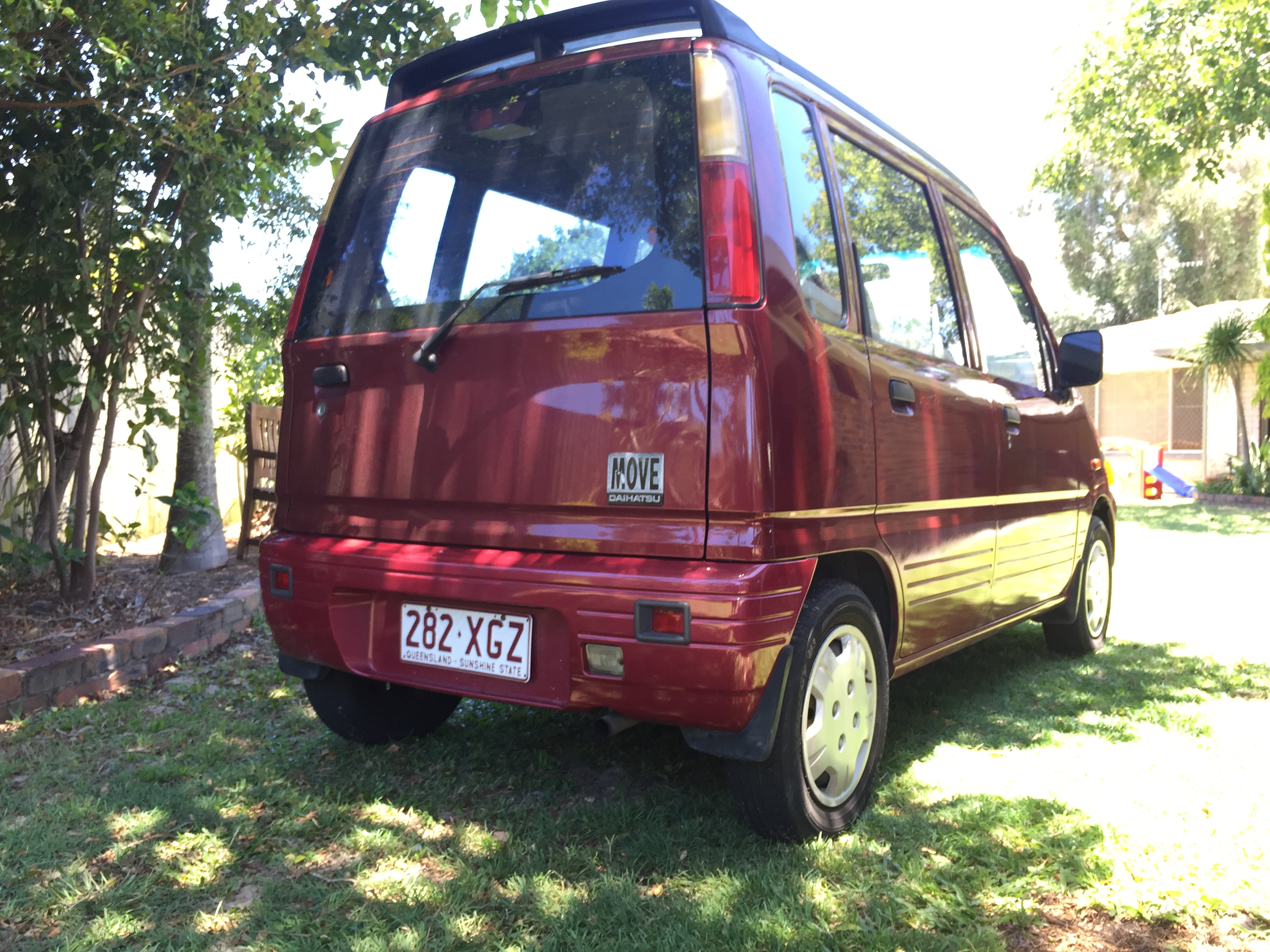

Not a major update, but, I was able to get a bonnet and rear bar from a Move of similar colour to replace the faded and chipped original ones.
Nice and clean Rob.
