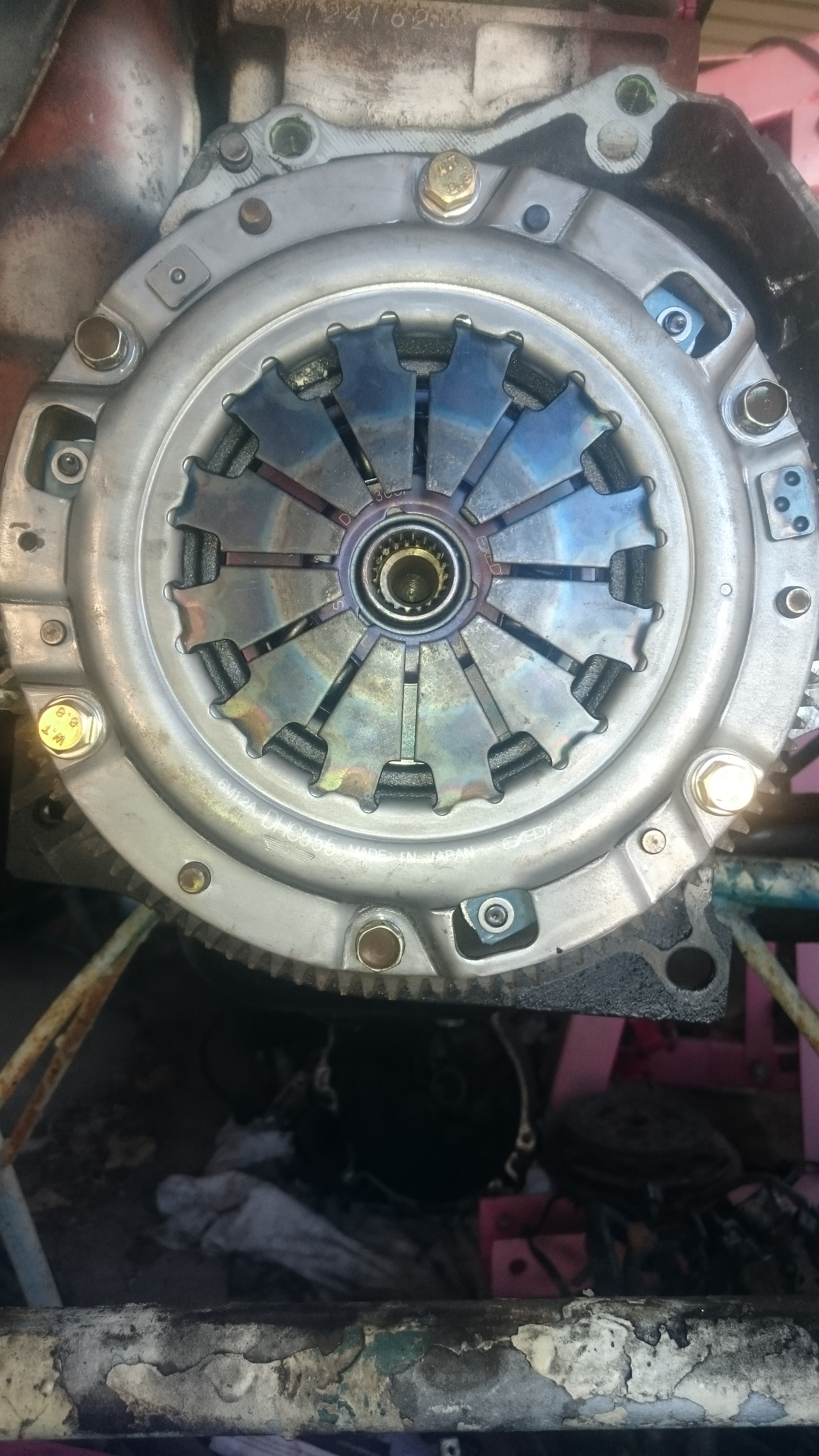

I also made sure the clutch was installed straight, as the universal alignment tool I have seemed dodgy… First time I was all concerned that r wasn’t straight… So I pulled it off and redid it, and it looks to be straight as an arrow now…

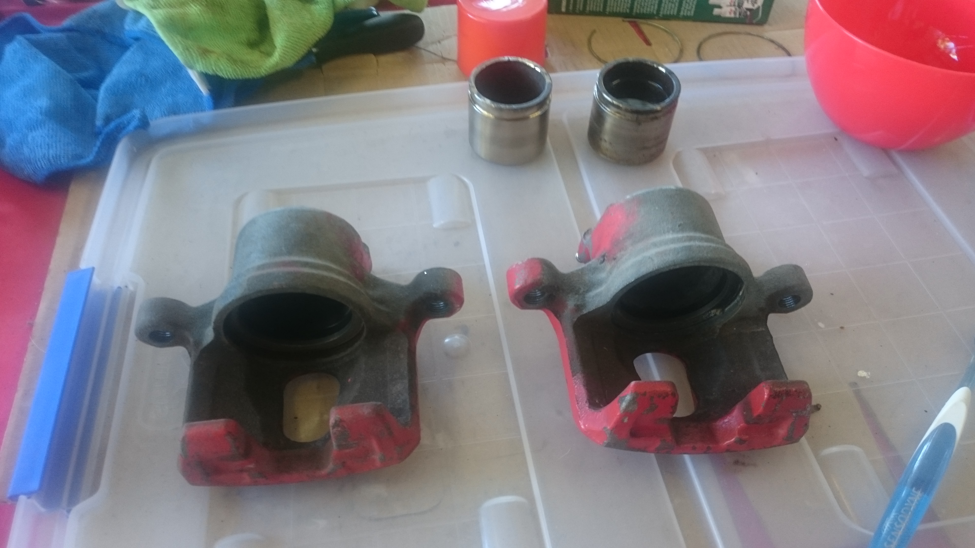

Mini update… Apparently they only had one calliper rebuild kit in Australia for some reason so I jumped online and ordered a kit from the UK, 35 pounds or something so not too bad… In the meantime I thought I’d finish pulling callipers apart and repaint them so they aren’t that horrible half red…

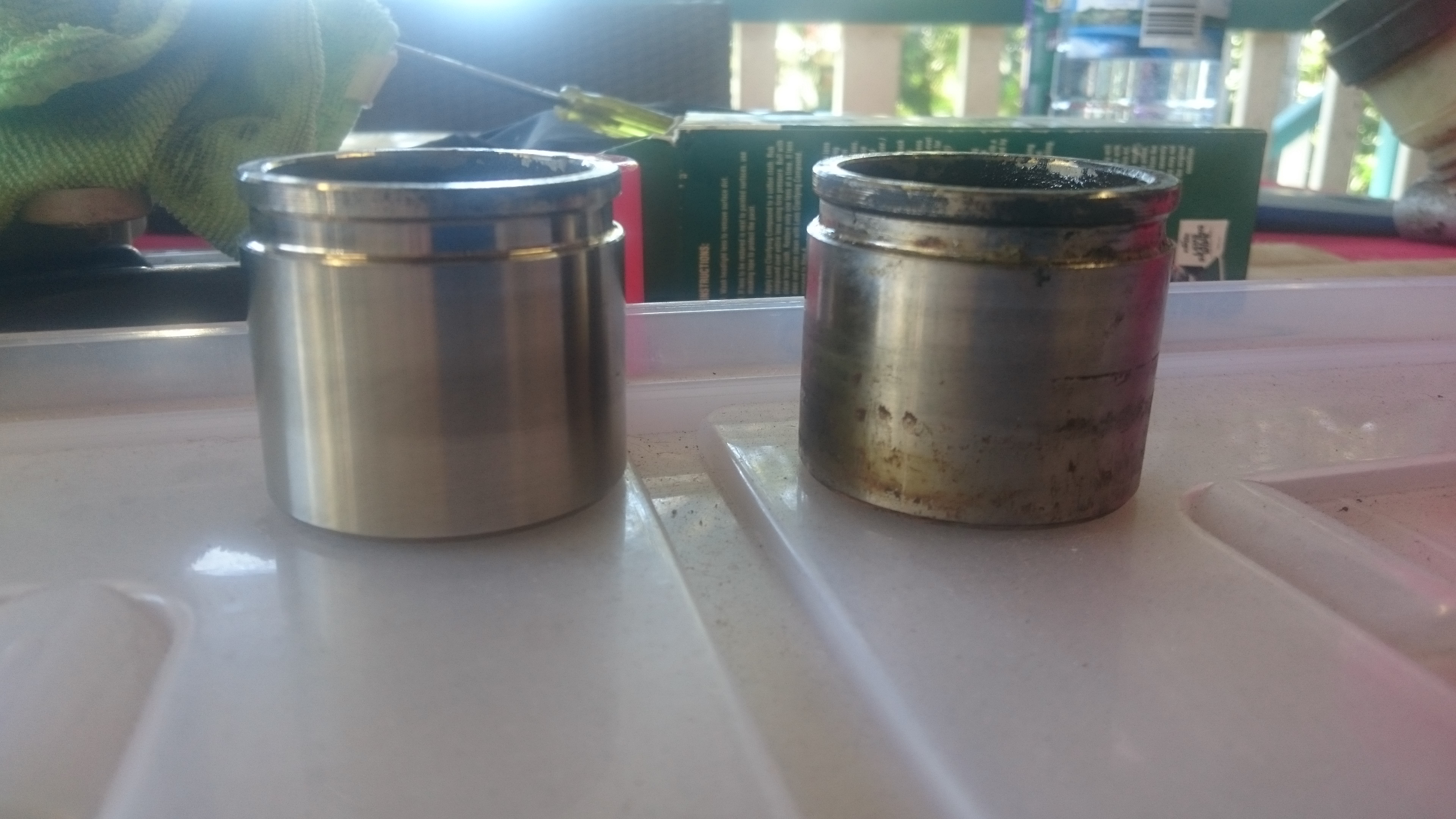

I started by popping the pistons out to check for scores, remarkably they are in pretty good shape so no need to replace them for now. Decided to give them a clean since there was heaps of shit on them.
As you can see the left one is cleaned and the right one isn’t, so a noticeable difference there… I also tried cleaning up the calipers with some brake cleaner and then degreaser and although it got lots of the shit off, it’s still not flawless… I think I’ll hit it with some heavier sruff when I get the chance…
The grey colour isn’t dirt it’s where the old shitty red paint has come off, so once I get it cleaned properly I’ll paint them up and get them ready for the rebuild kit

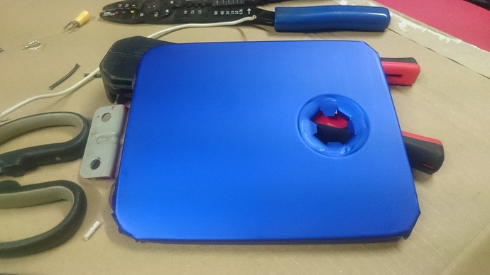

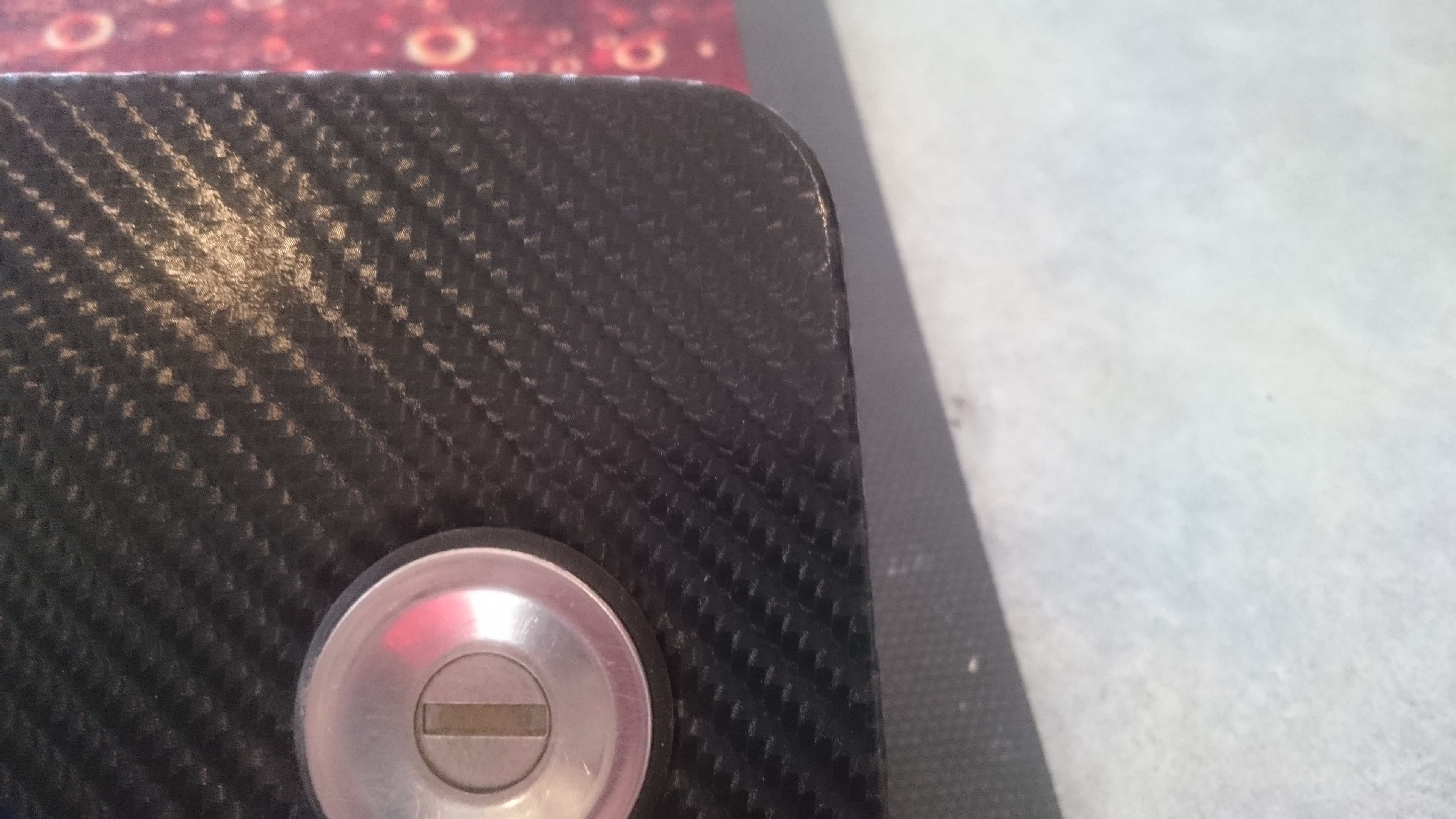

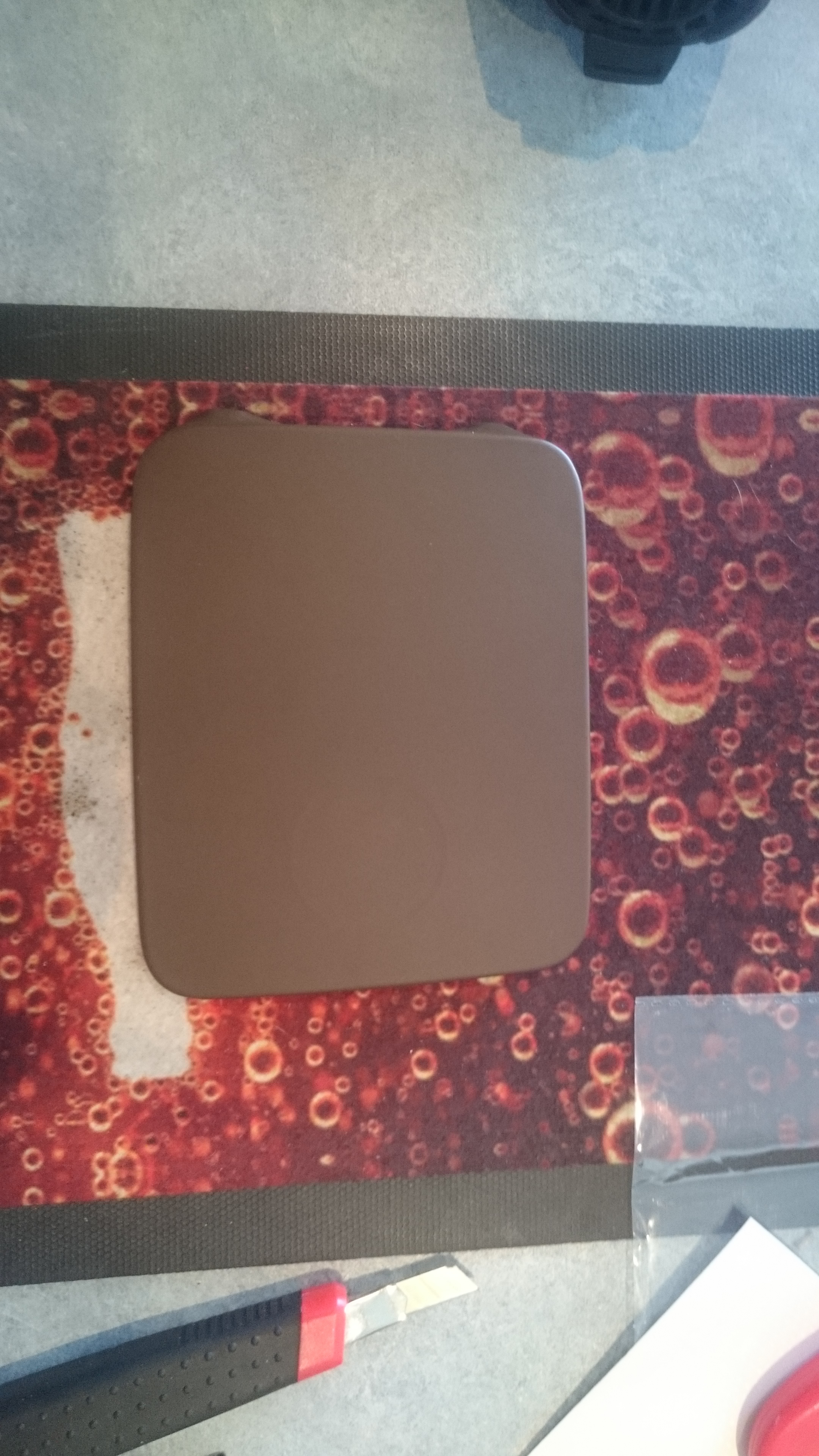

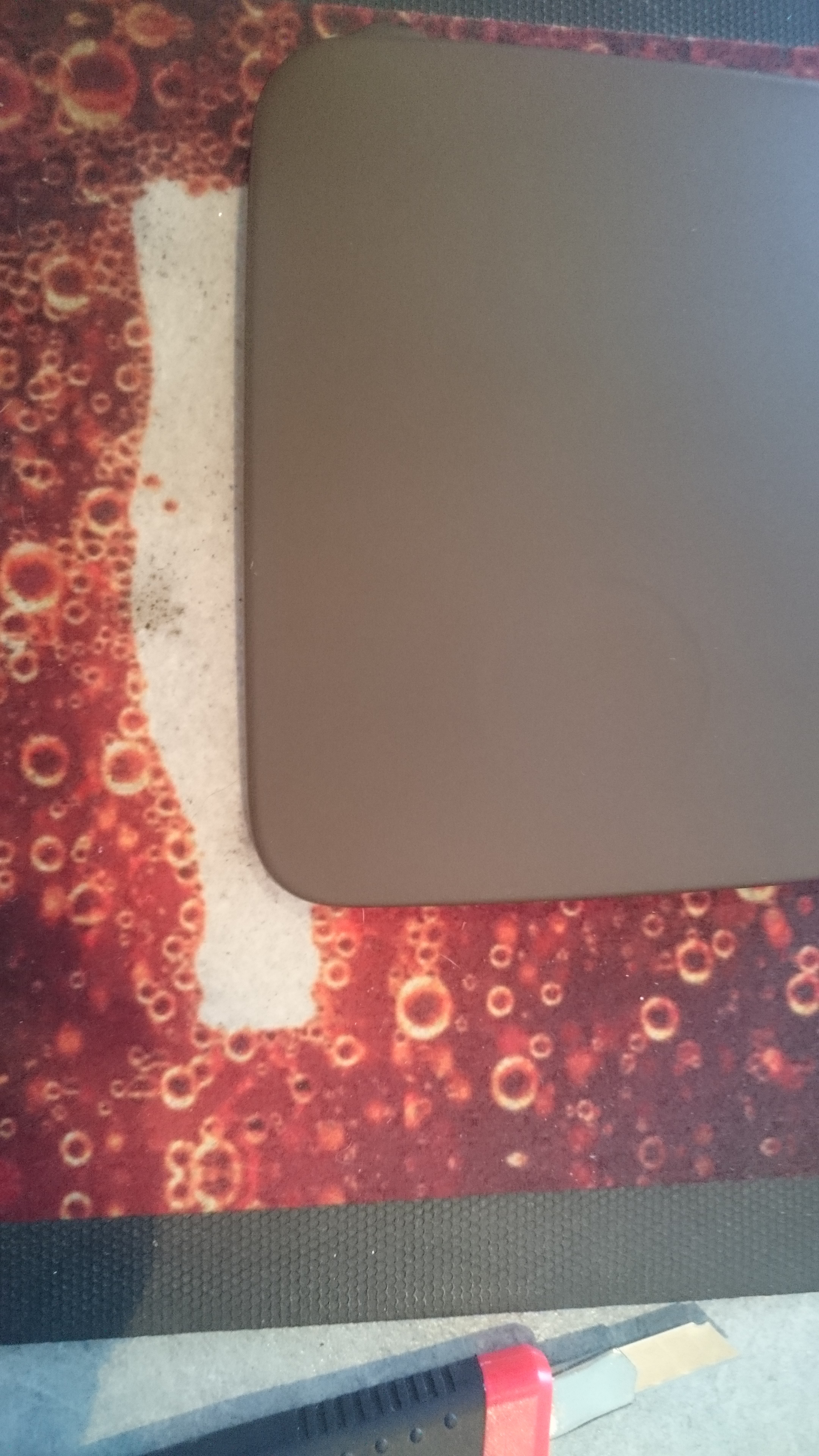

Alright so just a tiny update. Got the heat gun sorted and gave the wrapping another try. And holy shit thr heatgun Is the key…
No heat gun - check out how shitty the corners are
And with the heat gun - check how awesome the corners are…

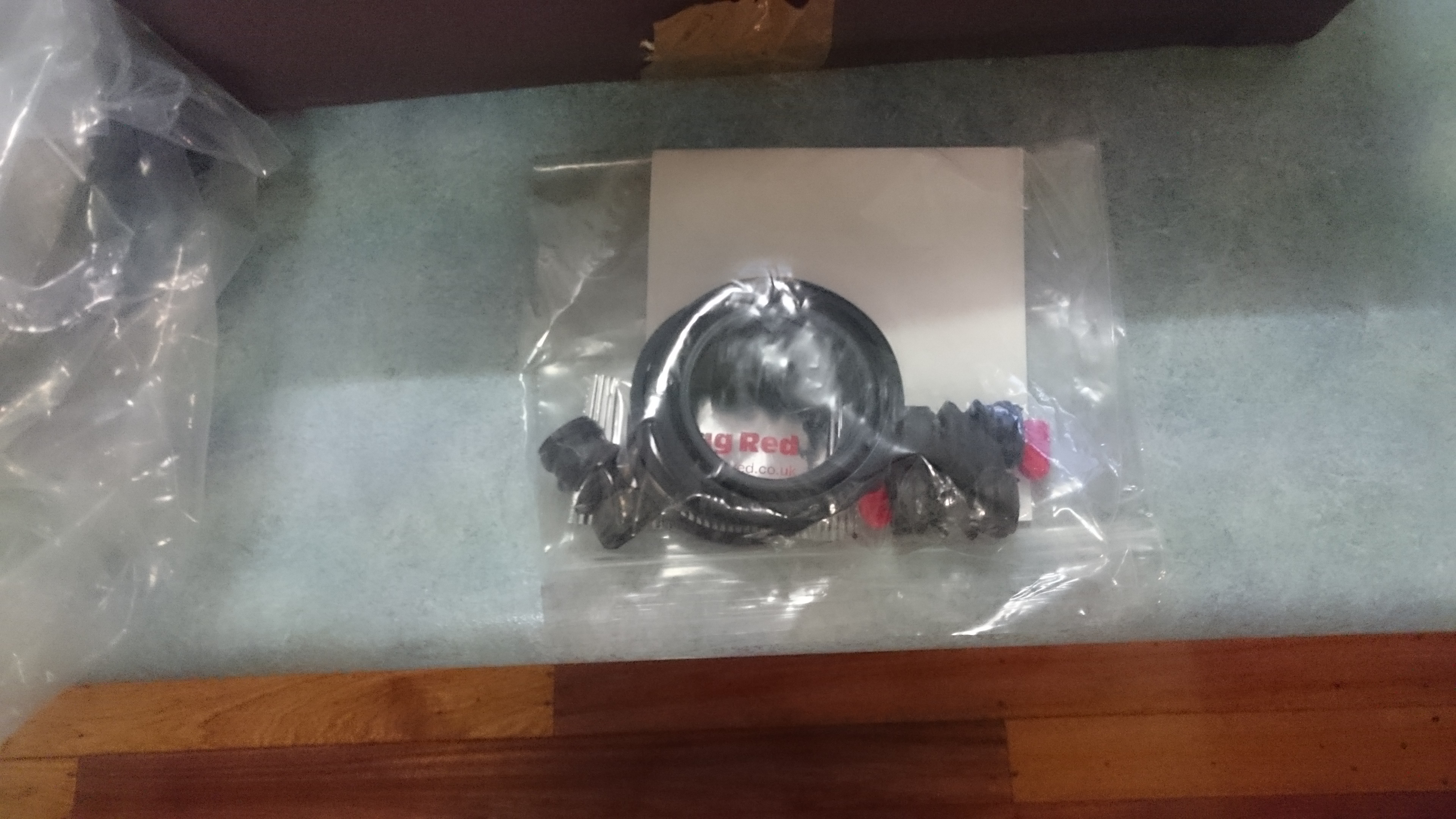

Calipers rebuild kit

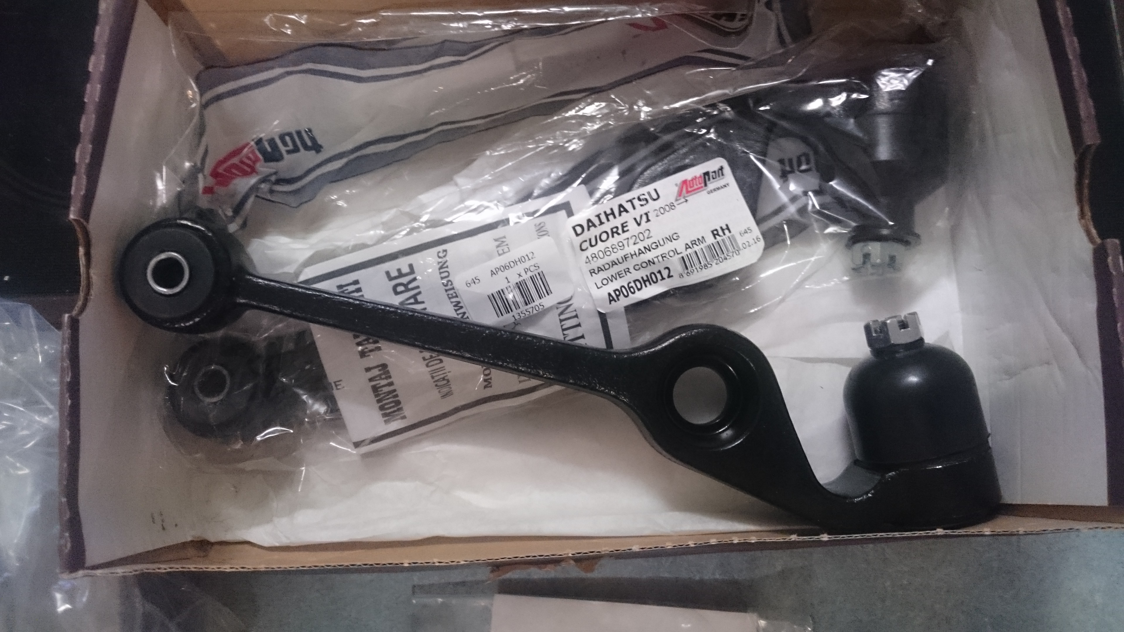

The L700 LCA’s

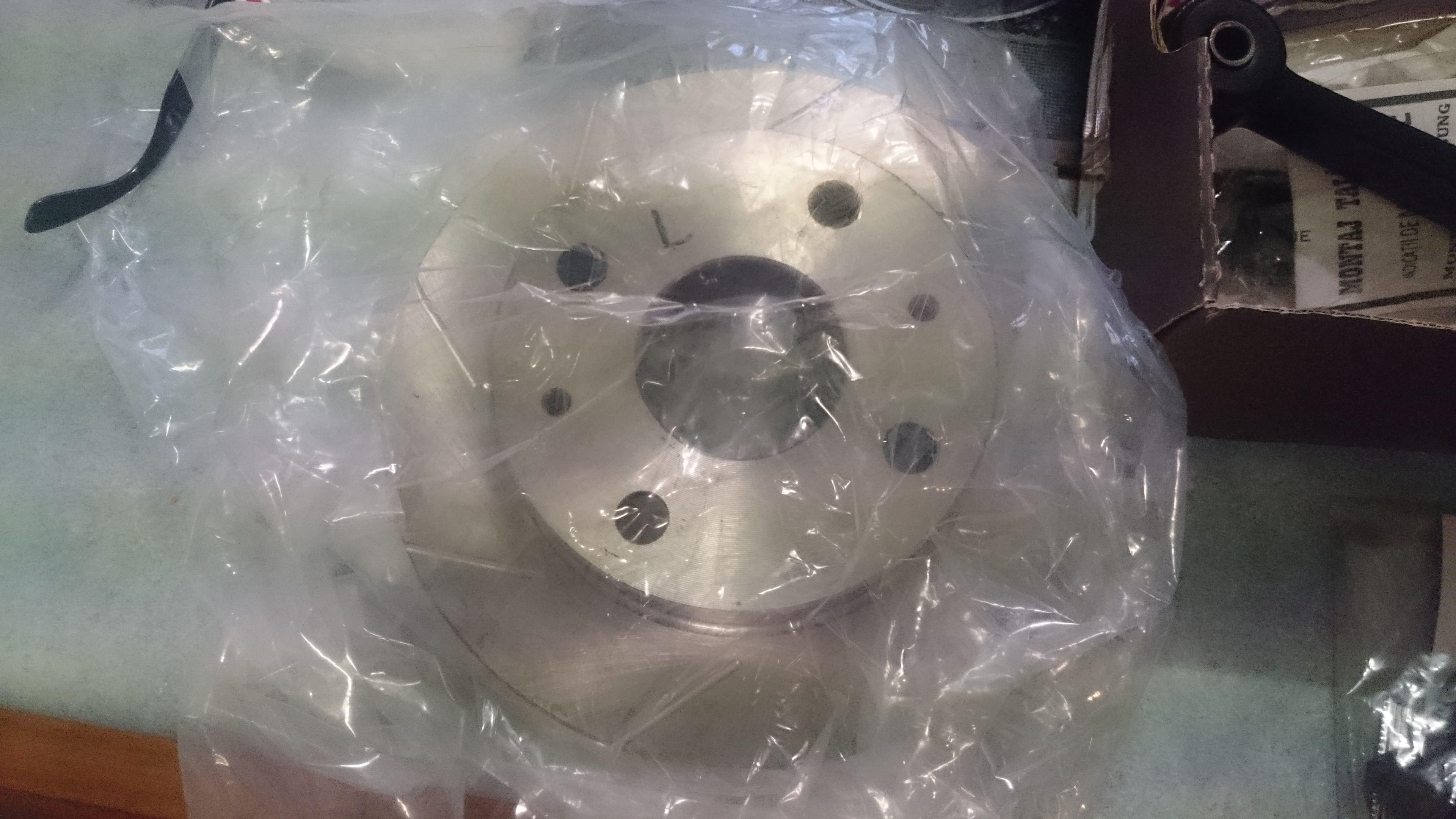

The rda slotted rotors
So yeah work csn be done now… Will rebuild the calipers tomorrow, then mount those and rotors to the hub, bash out the L200 lca and install the L700 one and then mount the hubs with brakes and shit done…

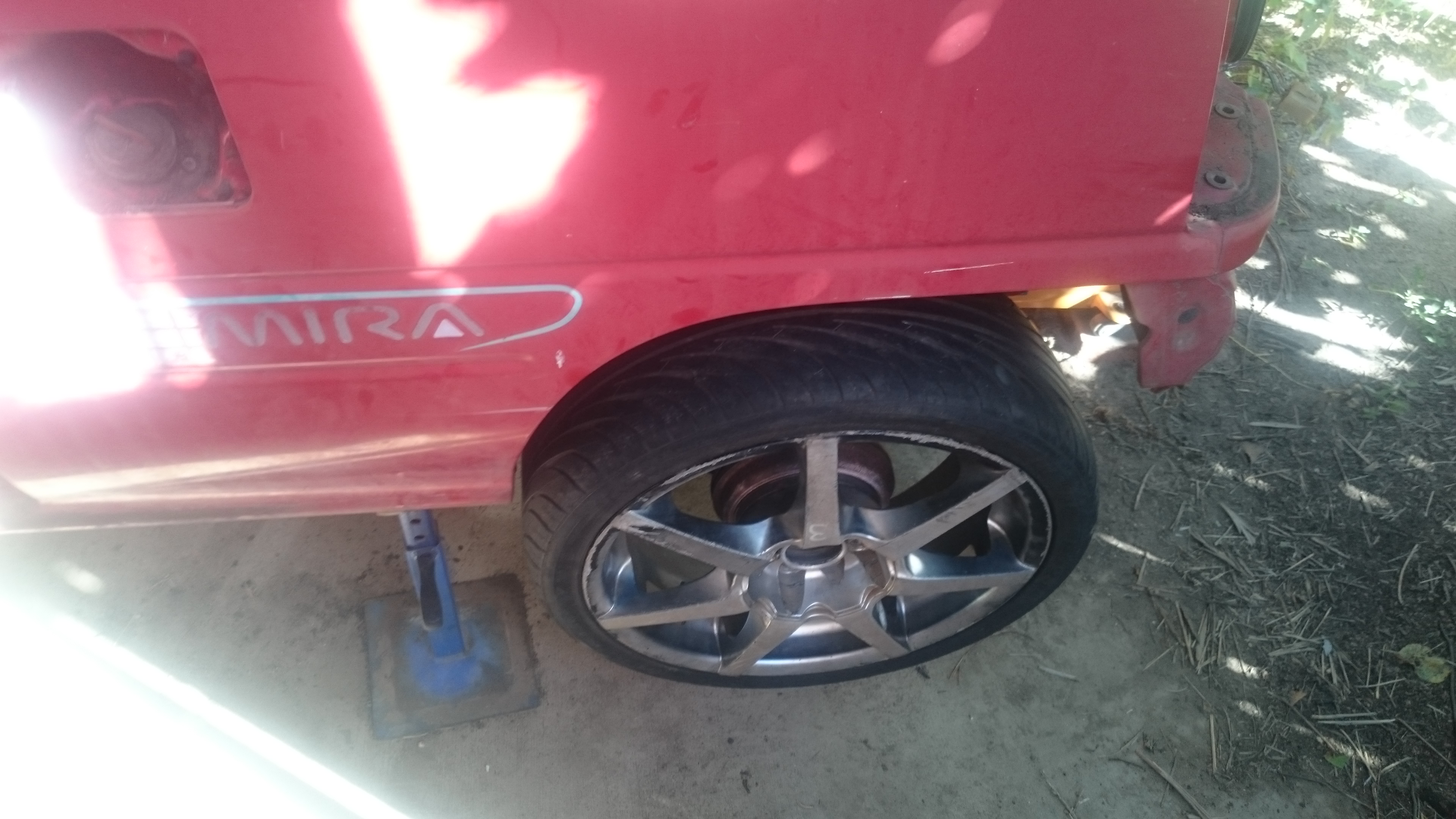

Here’s some photos of the 15s I got just to roll the car around on… It touches the inner wheel well and pokes out about an inch, so obviously 205s on a 15x6.5 wheel with +35 offset would only work with flares and extensive wheel well bashing… The car looka funny with that much rubber on it though…

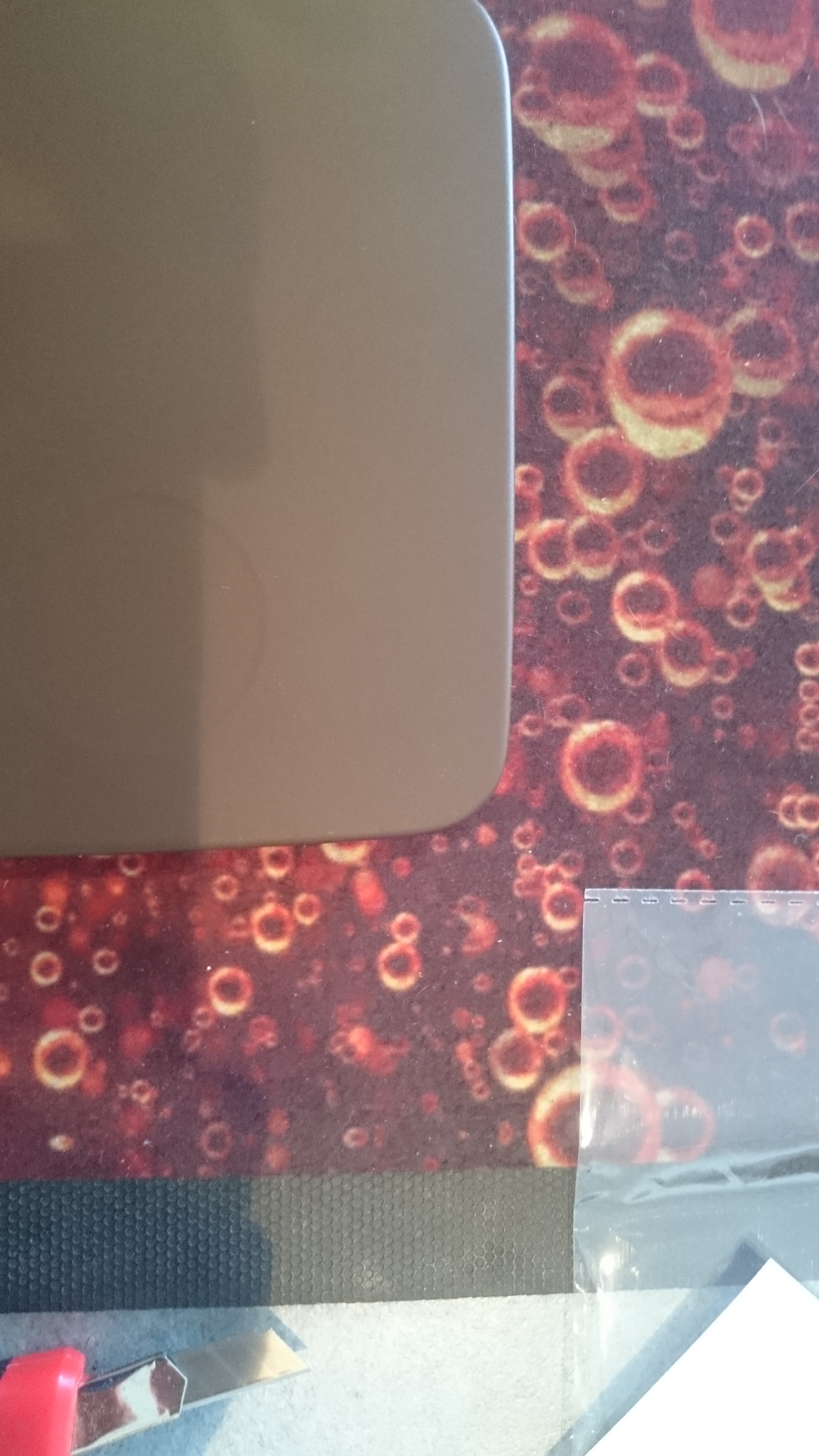

And the wrapping practice is finished I think, I redid the fuel lid and the corners were perfect, so it looks like it’s time to get the super secret colour out and get it happening… The carbon looks pretty good but I dont think I’ll leave it, I’m not a huge fan of having fake carbon stuff on my car hahahaha

Wow, brand new L700 control arms! If you think 205/50/15s are tight on the front, then just wait till you attempt to put then on the front. I guess you’ve seen the work on mine to get 15x7s to fit on the rear. I’m part way through getting them on the front.
Hahaha yeah the brand new control arms are super pretty. and yeah seeing those 205s on the back doesn’t give me hopes for the front, looks like 185s are going to be the way to go for thr AR1s… ah well, I don’t need to be able to steer much with these tyres on, just so I csn roll the car around…
Where did you source the L700 lca? What price?
Hey dude… So the control arms were a fuck around but I speak very basic German so I was able to get around it with Google translate and my high school memory that wasn’t affected by marijuana…
https://okzam.de
So thsts the website. If you go there using a desktop you can have the browser auto translate the page, search ‘cuore’ in the search box at the top and go from there…
It ended up being about 135 bucks delivered or some shit, let me know if you have issues I have no problem doing it again for ya…

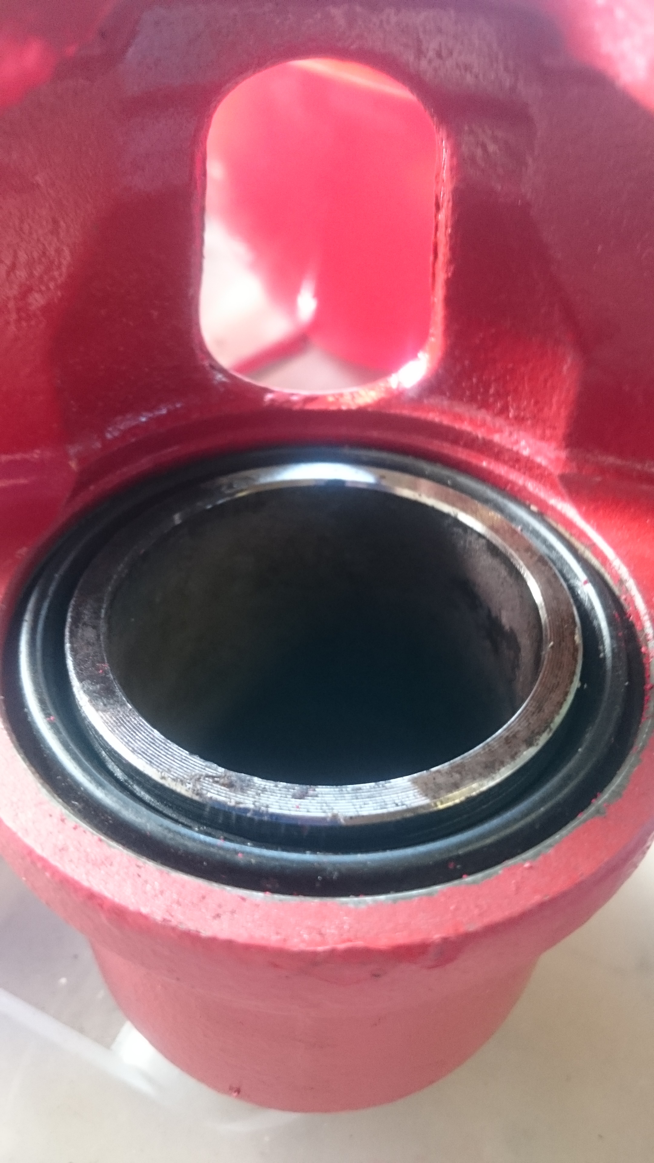

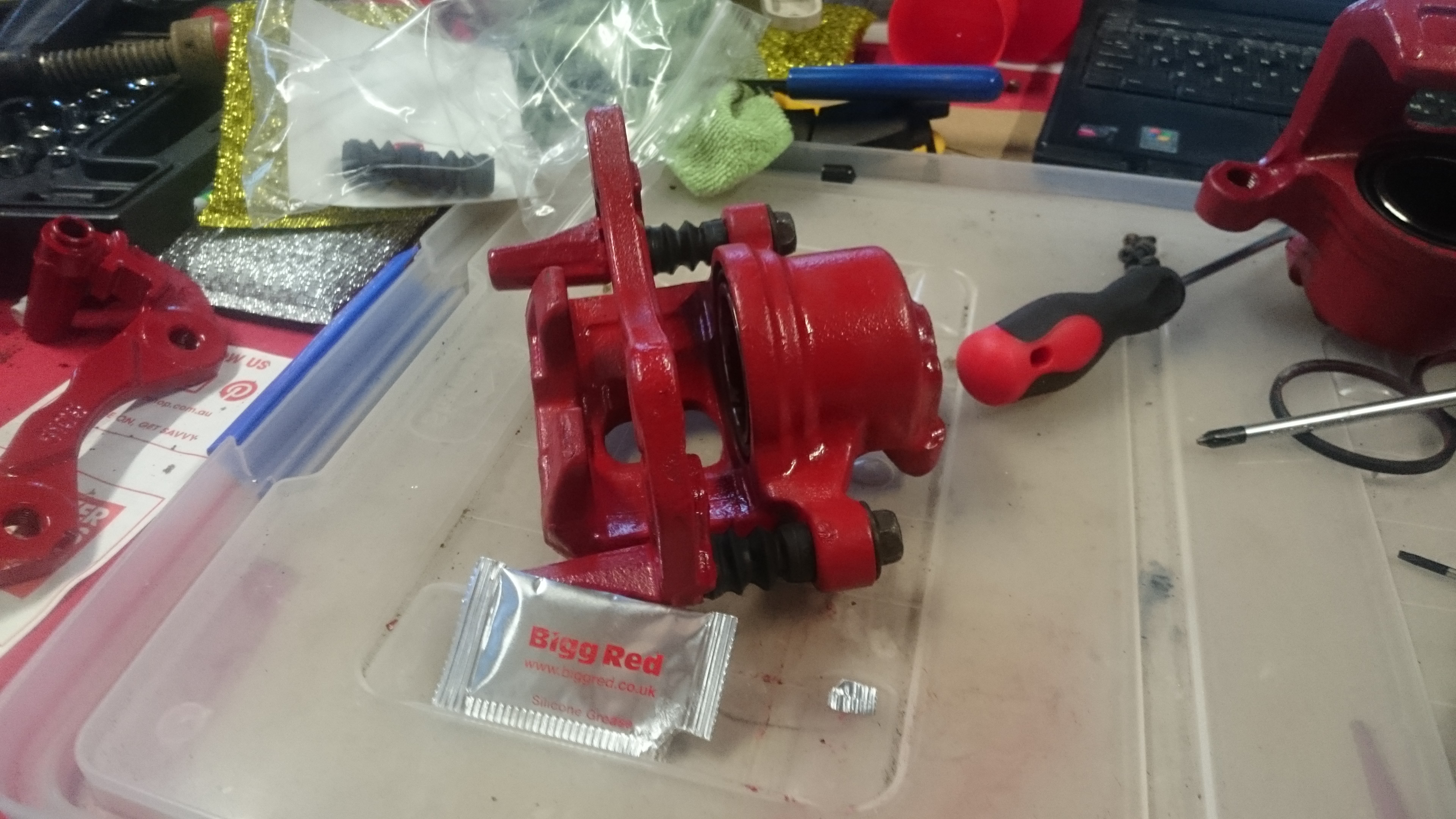

So since my caliper rebuild kit came I decided to do those… Stripped them down, repainted them red, and re assembled with the kit… No real issues other than getting the piston boot ring to slot back into place, apparently there isn’t a trick and it just takes patience, eventually I got it done.
DSC_0023
And the finished product…
DSC_0029

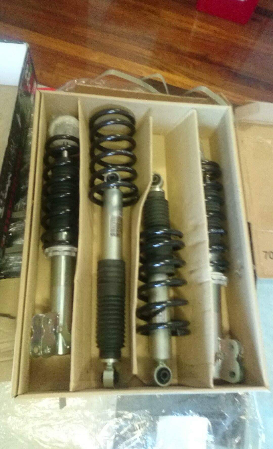

AlriAlright next was the coilovers came… Now I’m usually not a fan of cheap coilovers but it was a cheaper option to get the car running whilst I do my proper homework to sort out how i want to go about it…
received_10212685688870951
received_10212685683790824

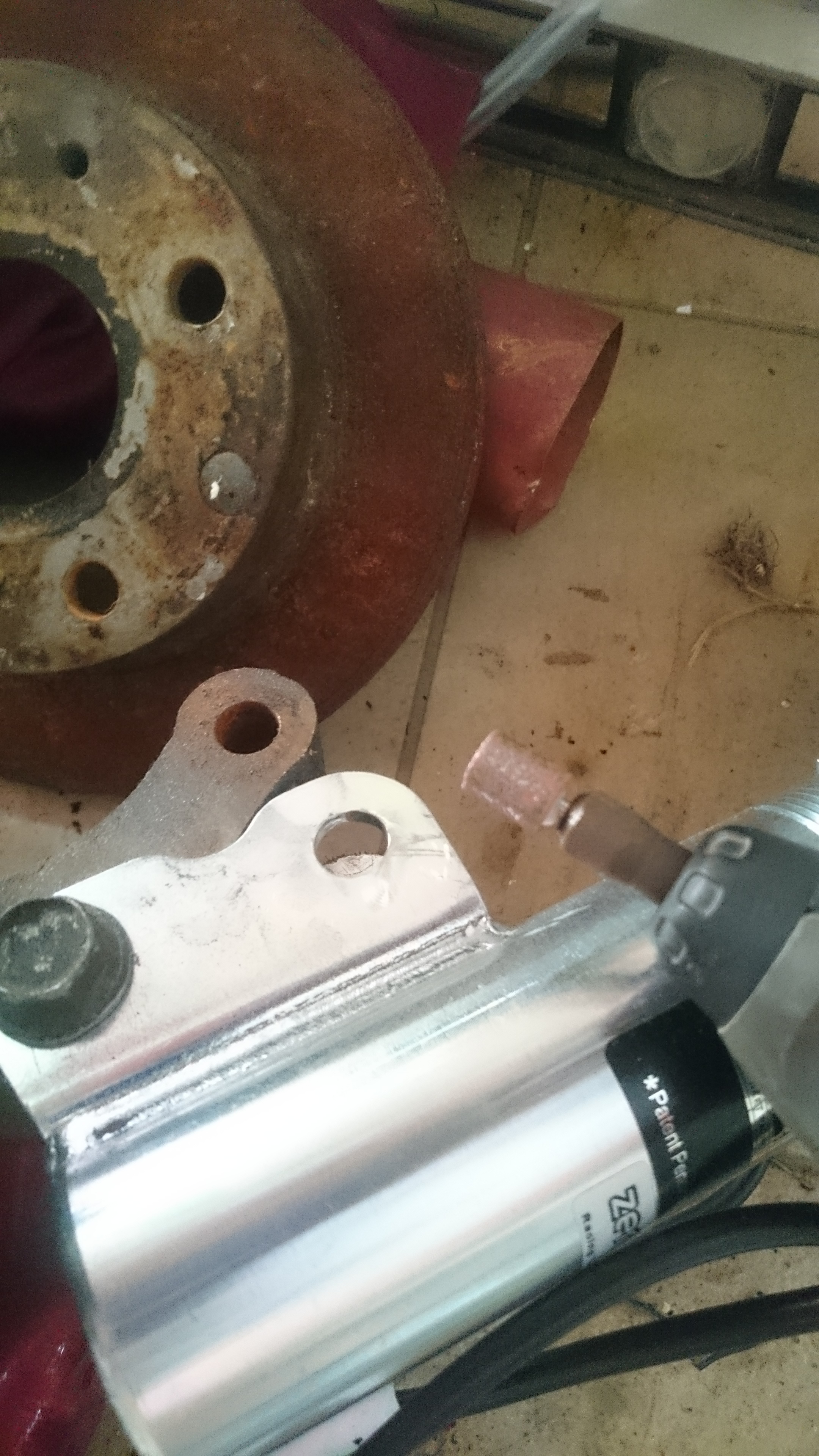

But if you’re following along on facey you will know that for some stepid reason I measured the hole distance for the uprights and thought they were the same L700 and L200 and they are not… So my L200 coilovers were not a straight bolt up to the L700 hubs…
Thrn a lovely man @FortisD suggested I just drill the holes out since It was only off by about 4mm so I whipped the Dremel out and away I went.
DSC_0044
So one side is now completed even though I didn’t take a photo of it done, but I ran out of time so tomorrow it will have to be…

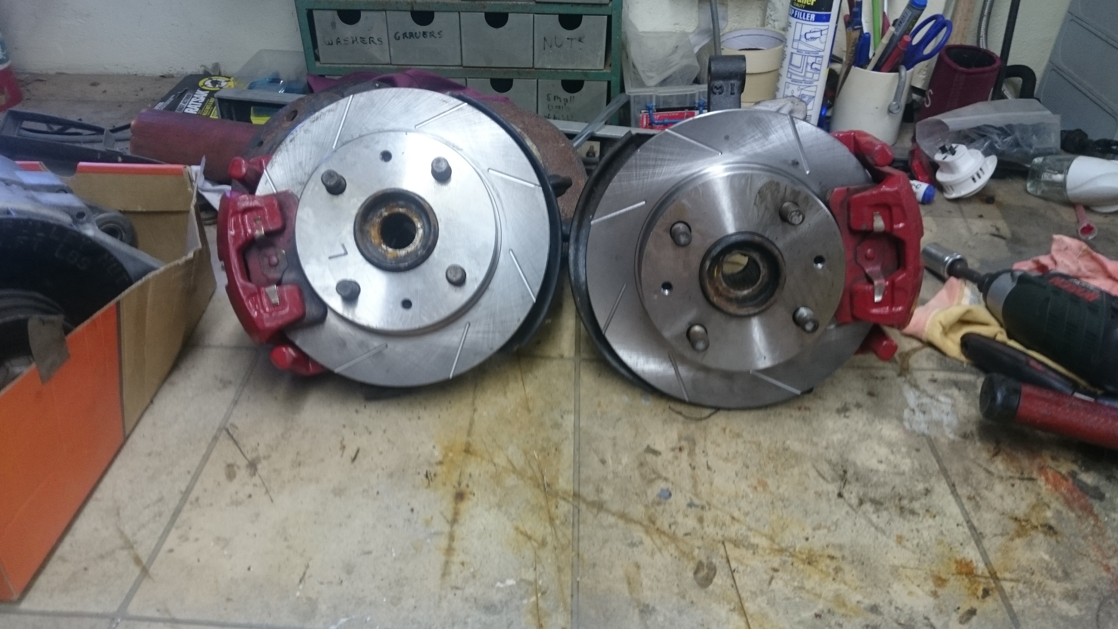

The other thing I did today was completely mount the brakes on the hubs with thr new rotors, personally I love the look of new brakes so here they are…
DSC_0041

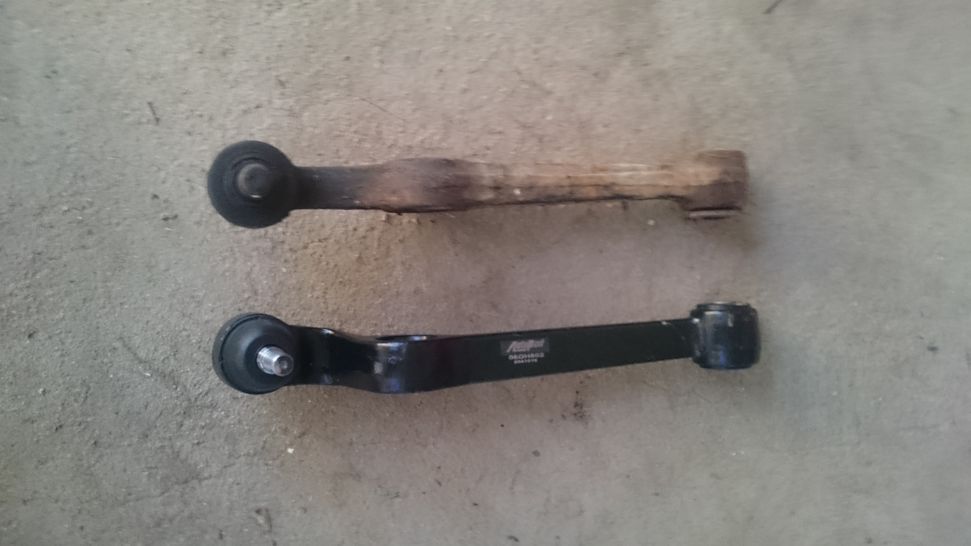

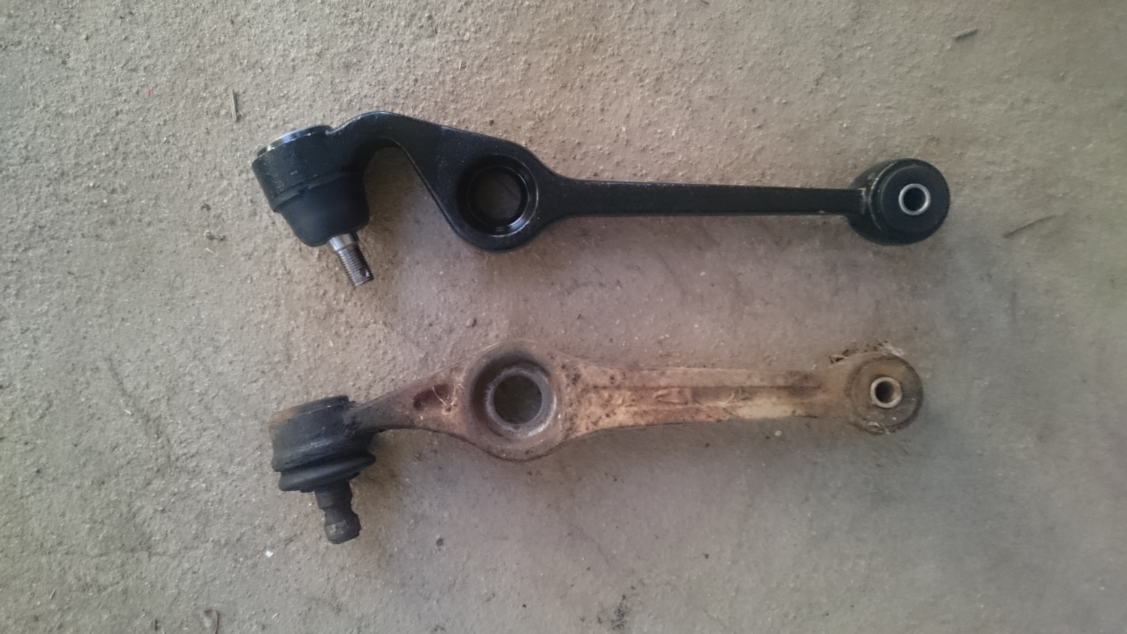

Also I installed the new LCA’s, I attached a pic of them next to the old ones for a later comparison for everyone to use…
DSC_0042
DSC_0043
A few interesting things to notice here, mostly that the length difference is negligible, but more so to me that the L700 has a slight curve in it. As well as the ball joint angle is different on the L700 lca… The swaybar hooked up perfectly though and the knuckle went onto the ball joint easily so it’s all going well…

Seeing that you dremel that hole probably you should purchase camber bolts
Yeps camber bolts already purchased… When they get here I’ll get them straight in…
