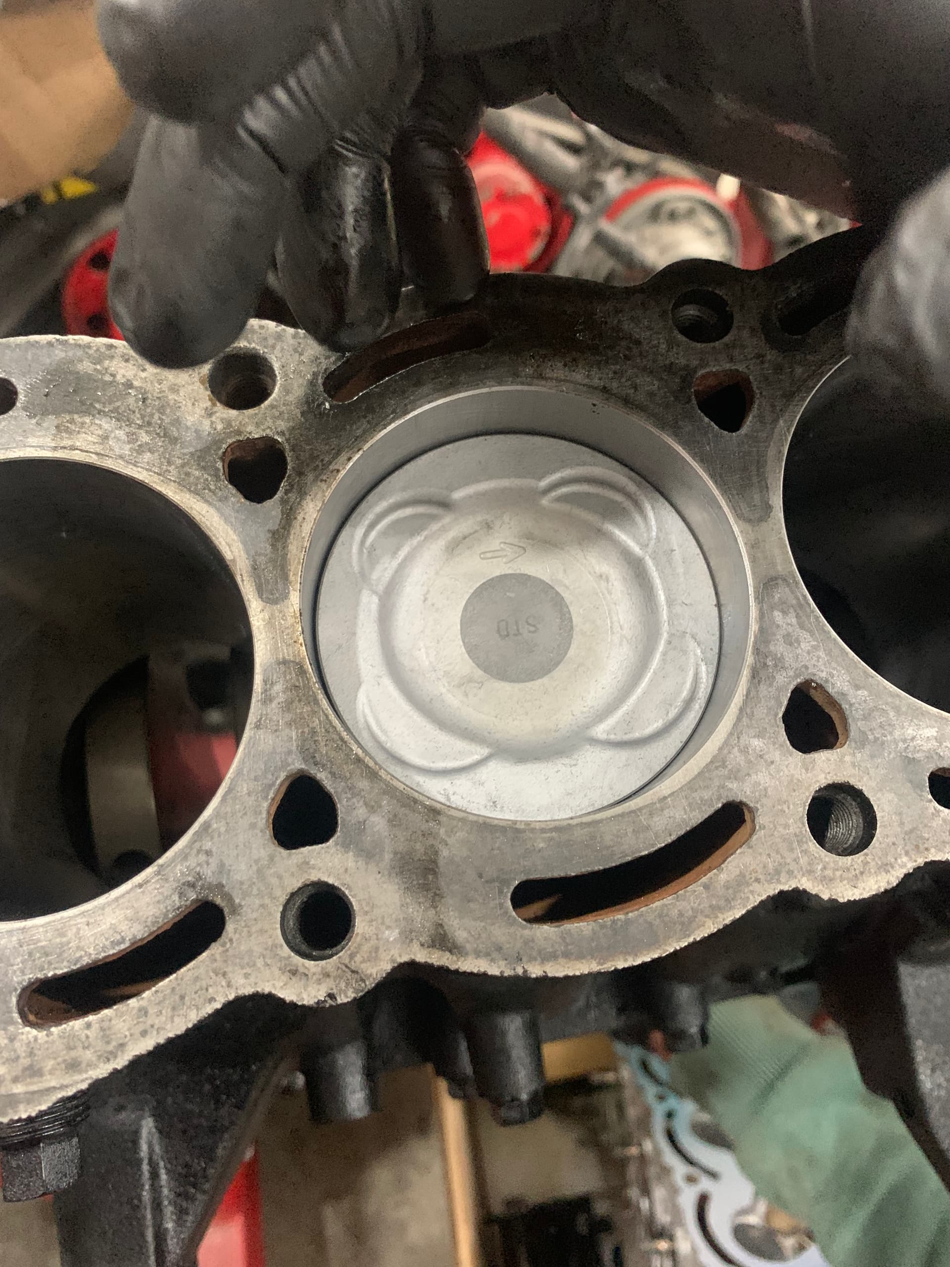

I measured compression and did endoscopy, it gives out 8.0 at each cylinder and the engine is consuming oil now. So now we will be ordering EJ pistons, rings and crank bearings for overhauling

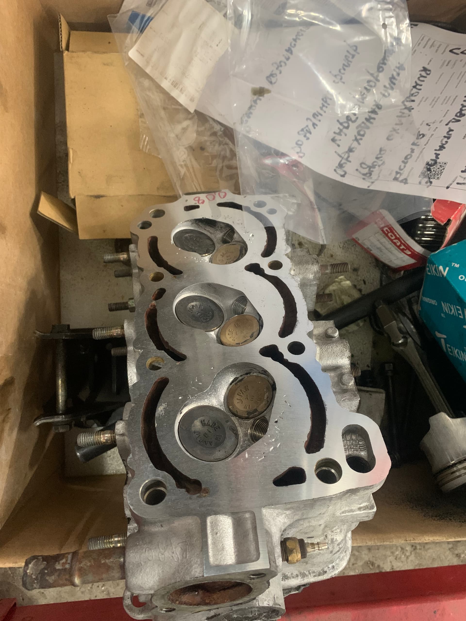

Engine is ED10 block with ED20 head and Volga Gaz-24 126 Carburetor (you cant find any oem parts for cars like this in small Armenia, so we run anything we can find here)
I am very happy to find this forum and thanks to @evilhighway I now have information and understanding that EJ block parts will fit into our ED

Making the ED into a EJ 6 valve sounds like fun. Keep us up to date.
Welcome Vlad, Good to see someone else having some fun with what I have done before.
Let us know how it goes and sing out if any help needed.
@Vlad Your country side looks similar to how mine is in outback Australia.
@DaleJeffree a 6 valve ed with ej pistons was what was in my budget track hack before I sold it. Because ED’s have a habit of the cam timing gear flogging out I put an ef one on there. The timing had very minimal adjustment. Because of that I used to put 4 Litres of E85 in each full tank of fuel just to help reduce and possible knock. After I sold it the new owner did blow it up. I did tell him but…
In that car I got my personal best at QR Raceway. Beating the previous times I got in the turbo move and it was N/A.

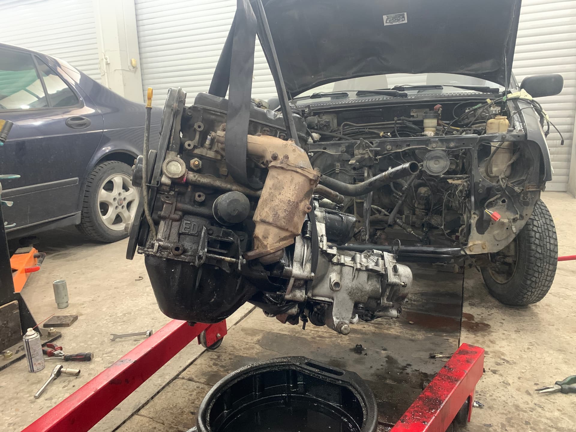

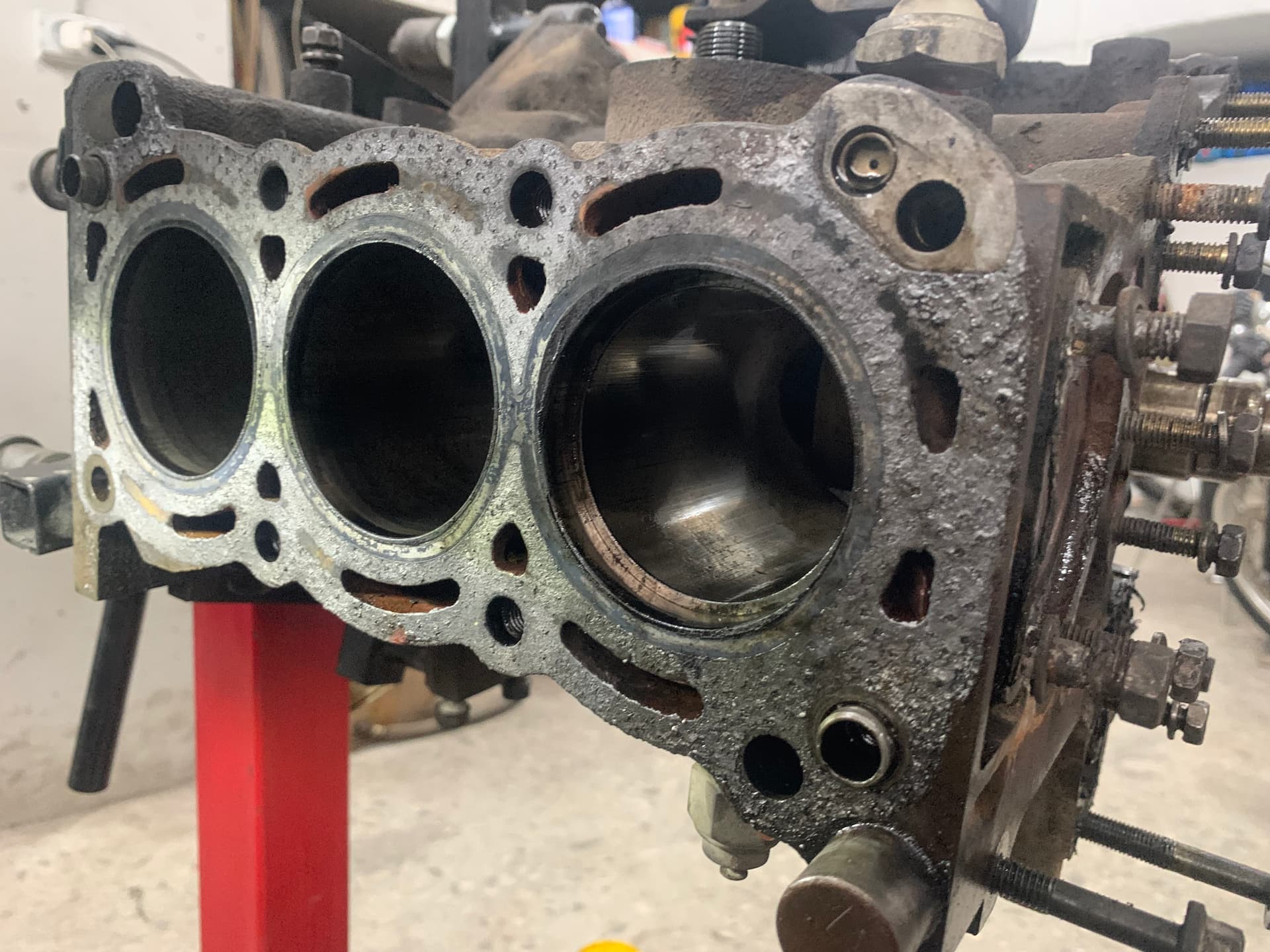

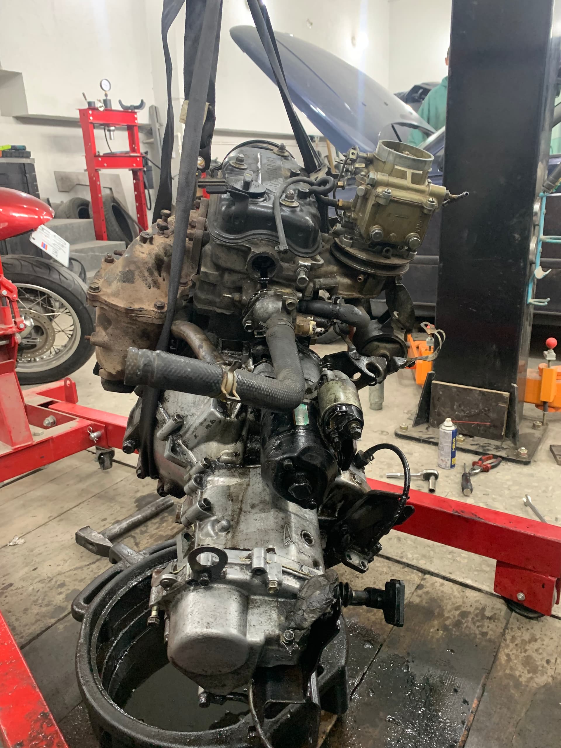

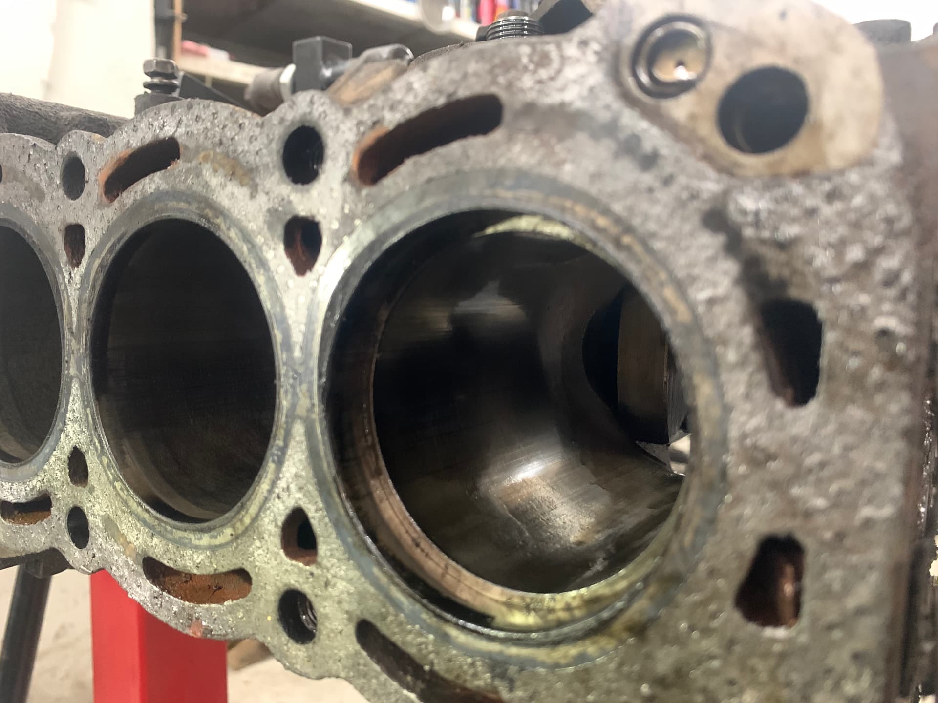

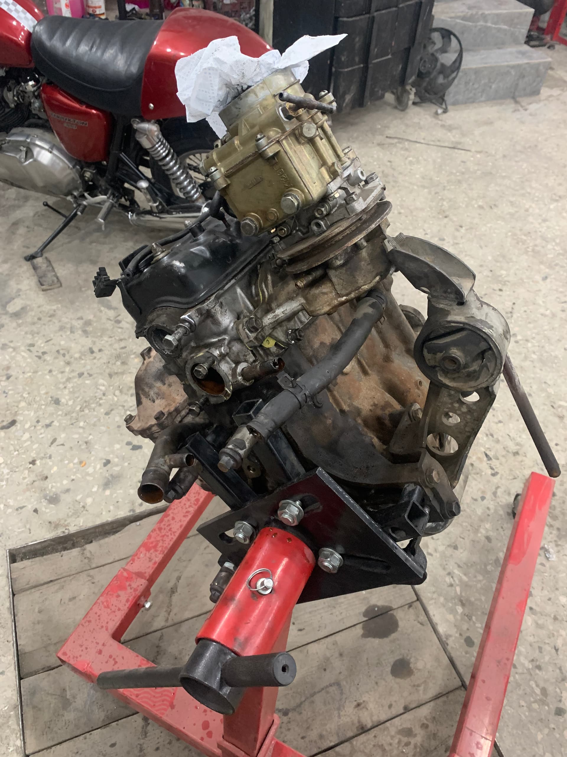

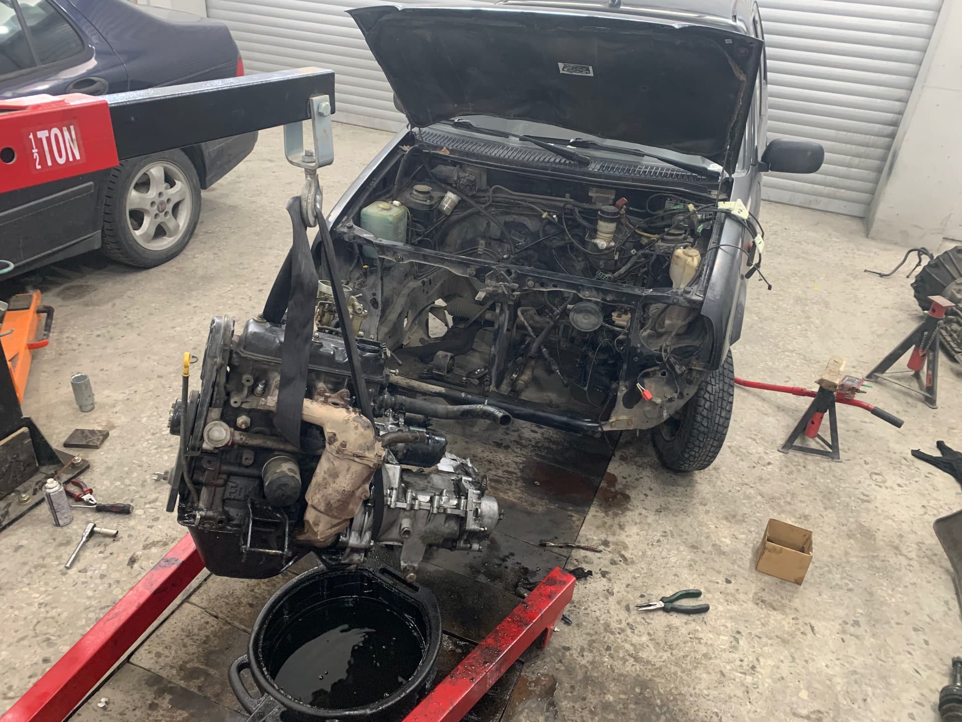

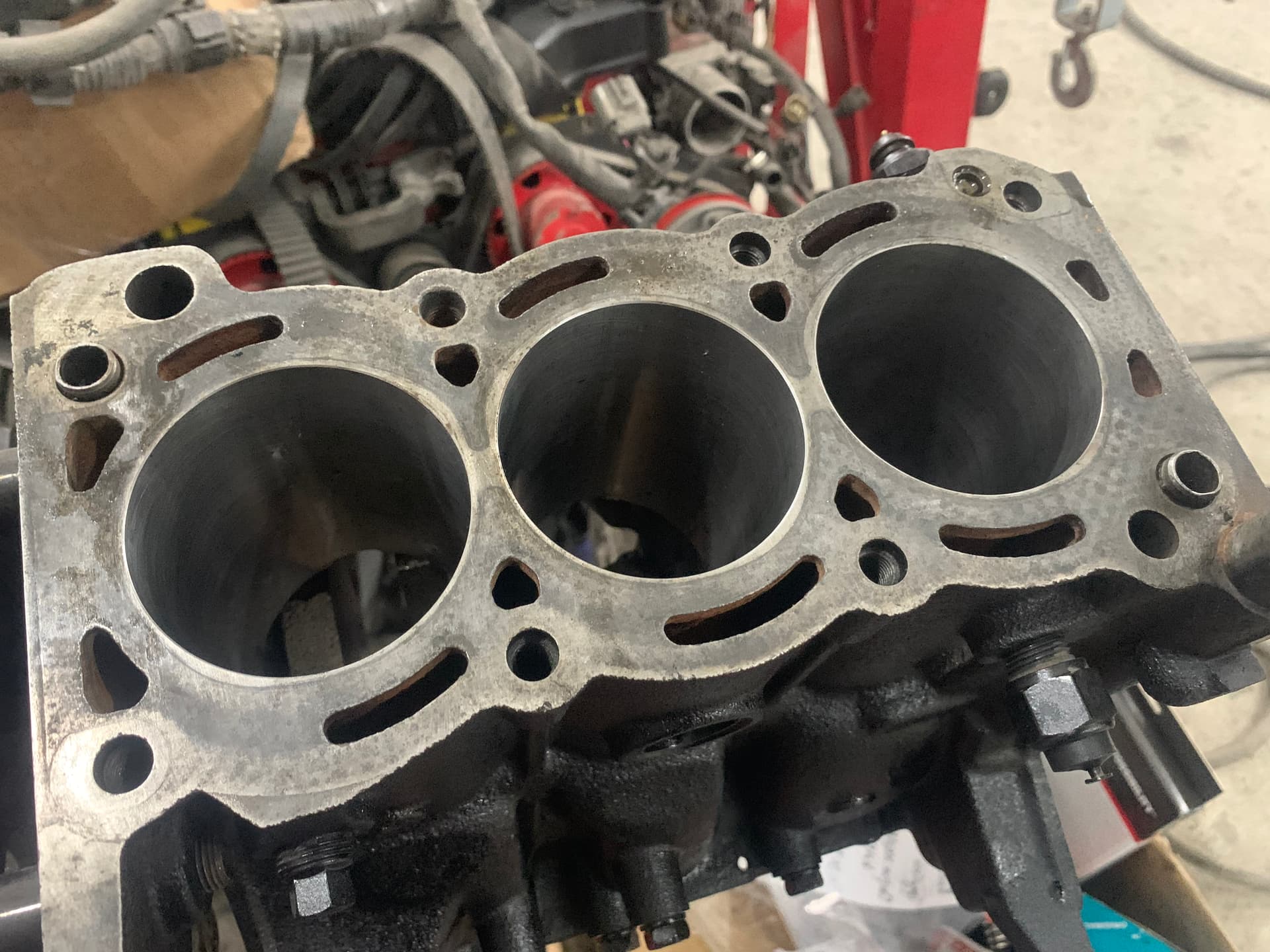

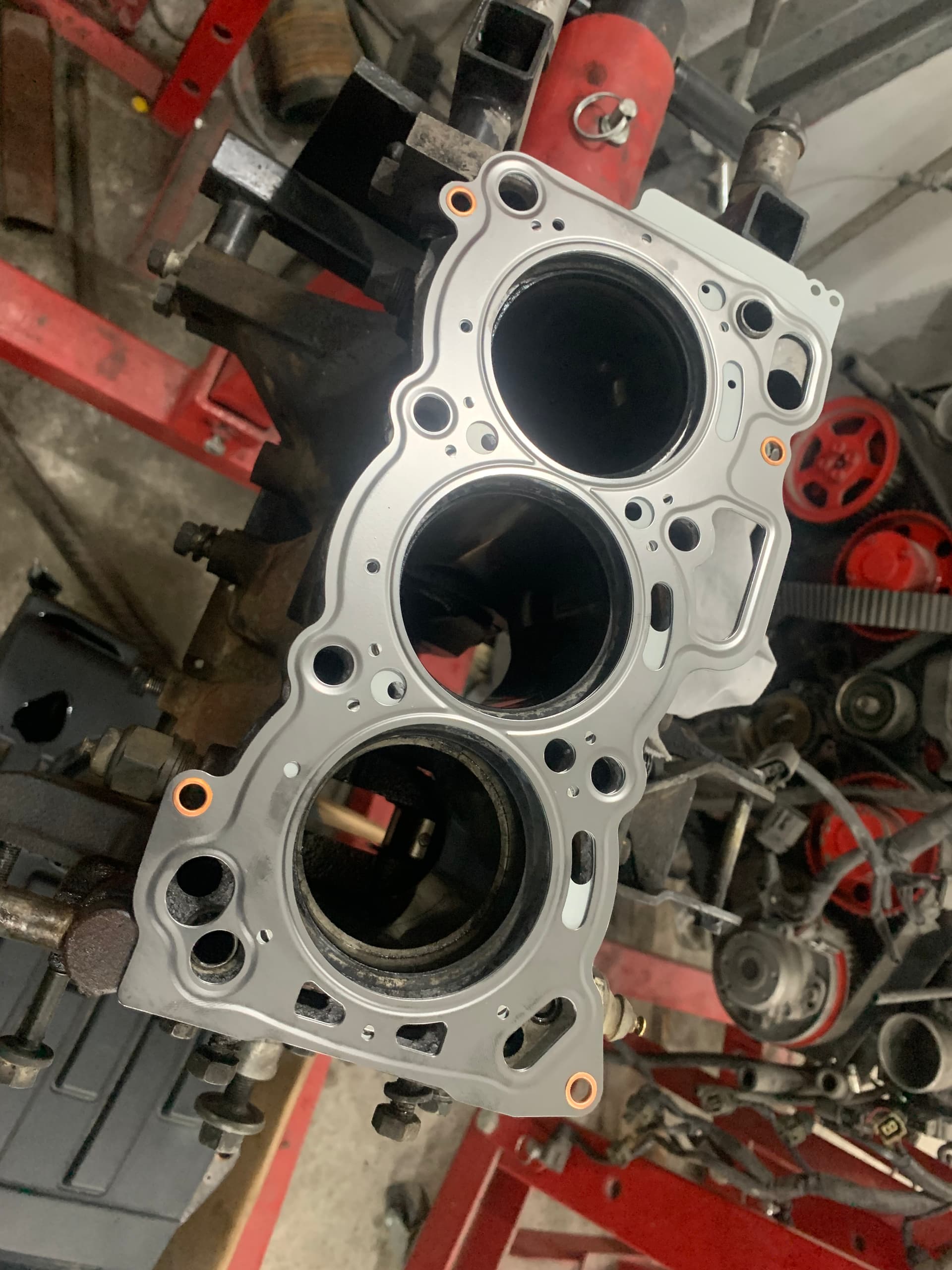

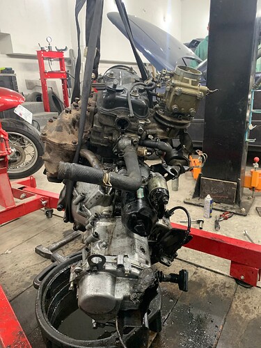

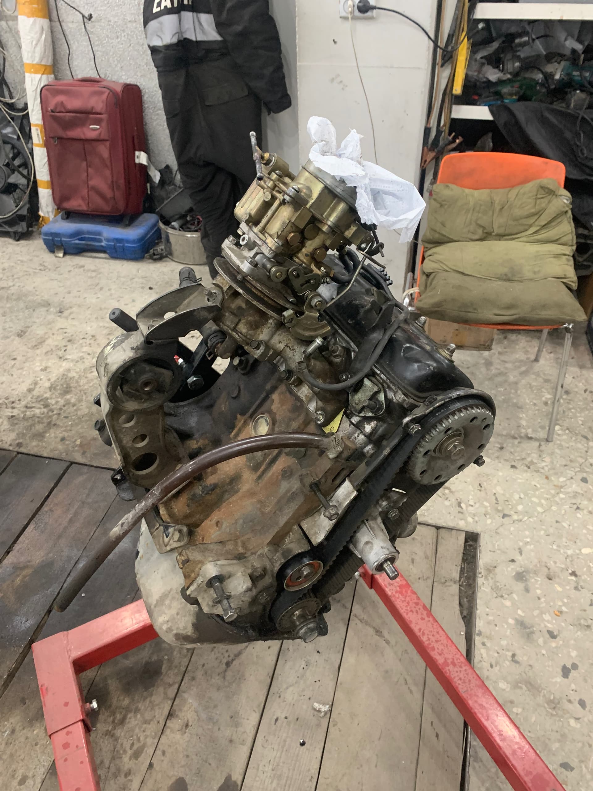

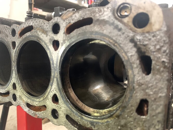

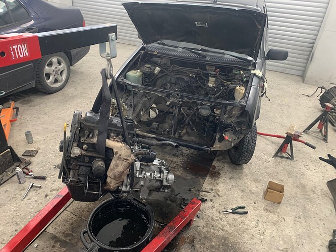

Hi there! Finally we pulled out the motor and disassembled it. Crankshaft has already been repaired by someone in past, so we have to do at least 0.50 repair on it (or more). We already found crank and rod bearings and gasket set online, the main question now where do I find a head gasket for ED block that will fit 73mm bore? Should I order custom one?
The car will be a daily driver, not a track one, so the reliability is a top priority

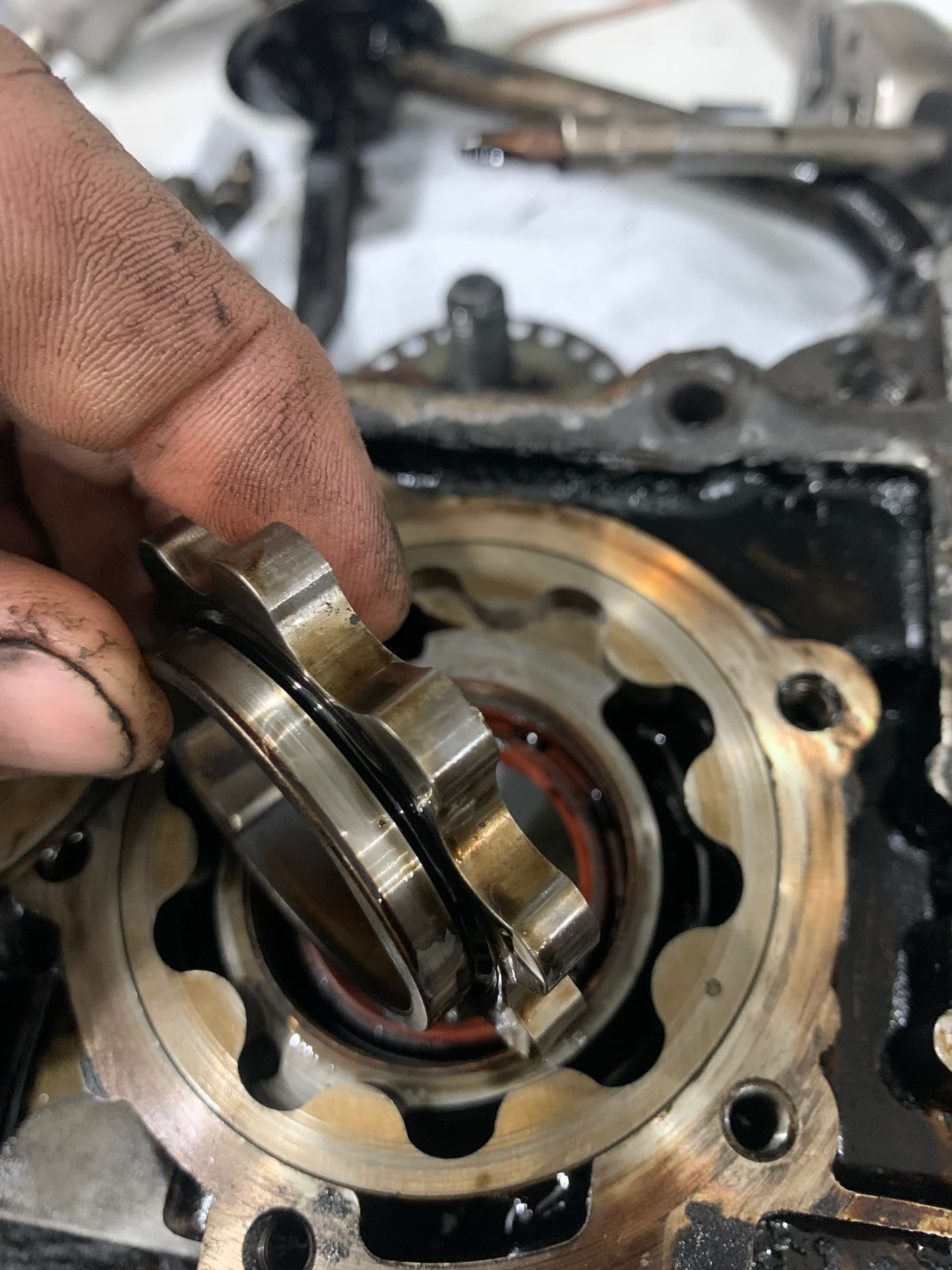

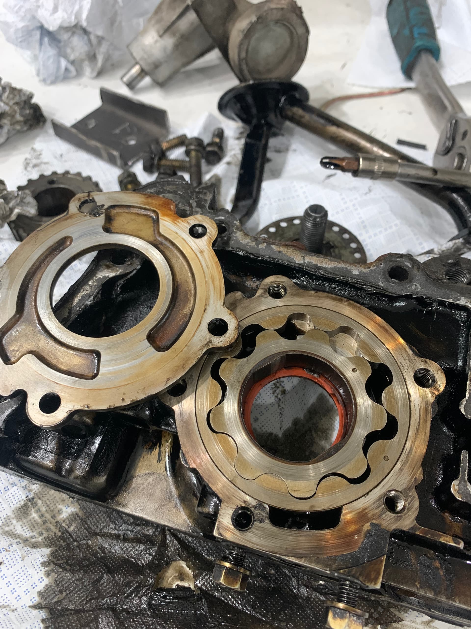

Oil pump seems fine, I think I will leave old one
Advices are very much appreciated :slight_smile:

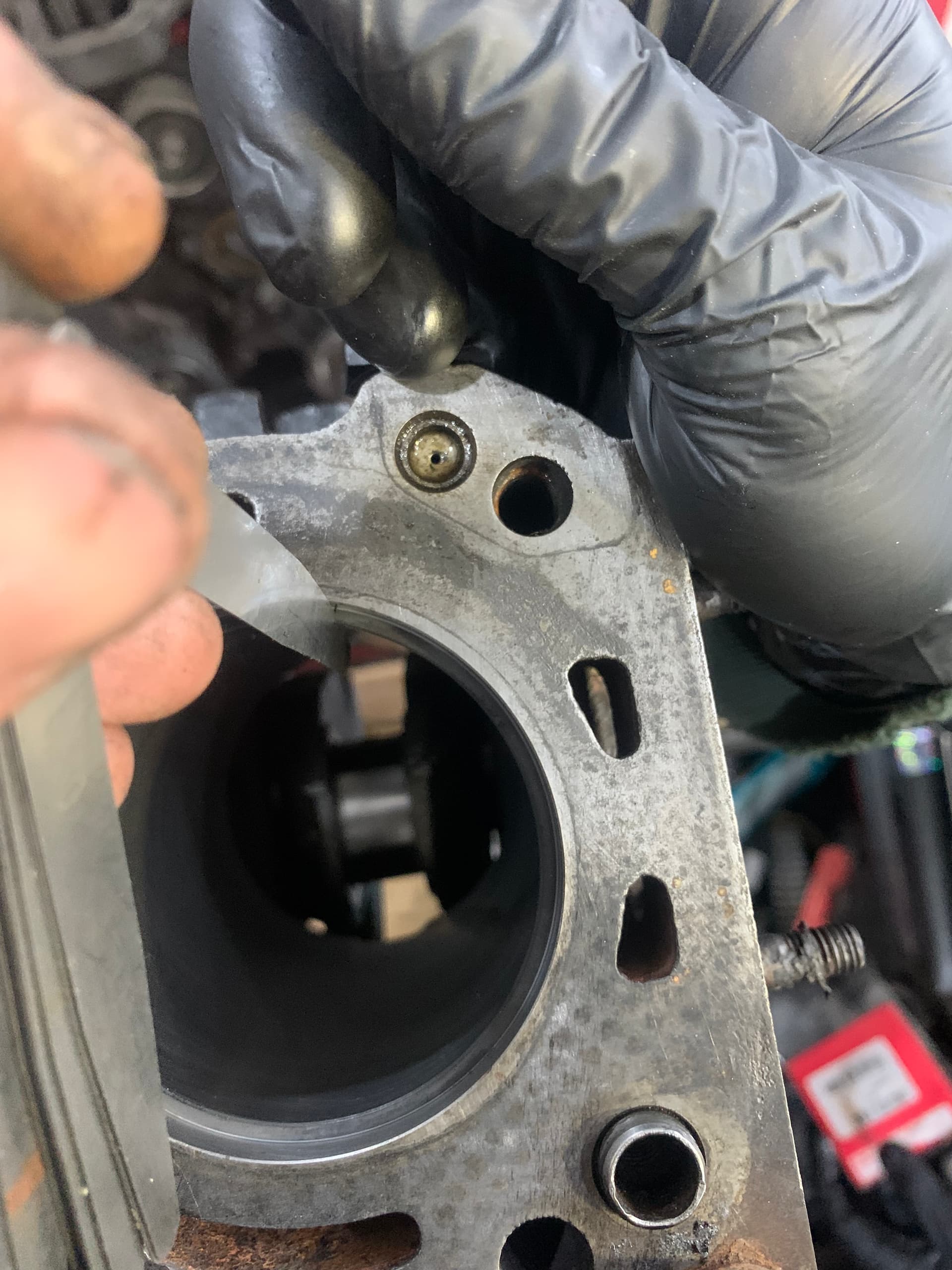

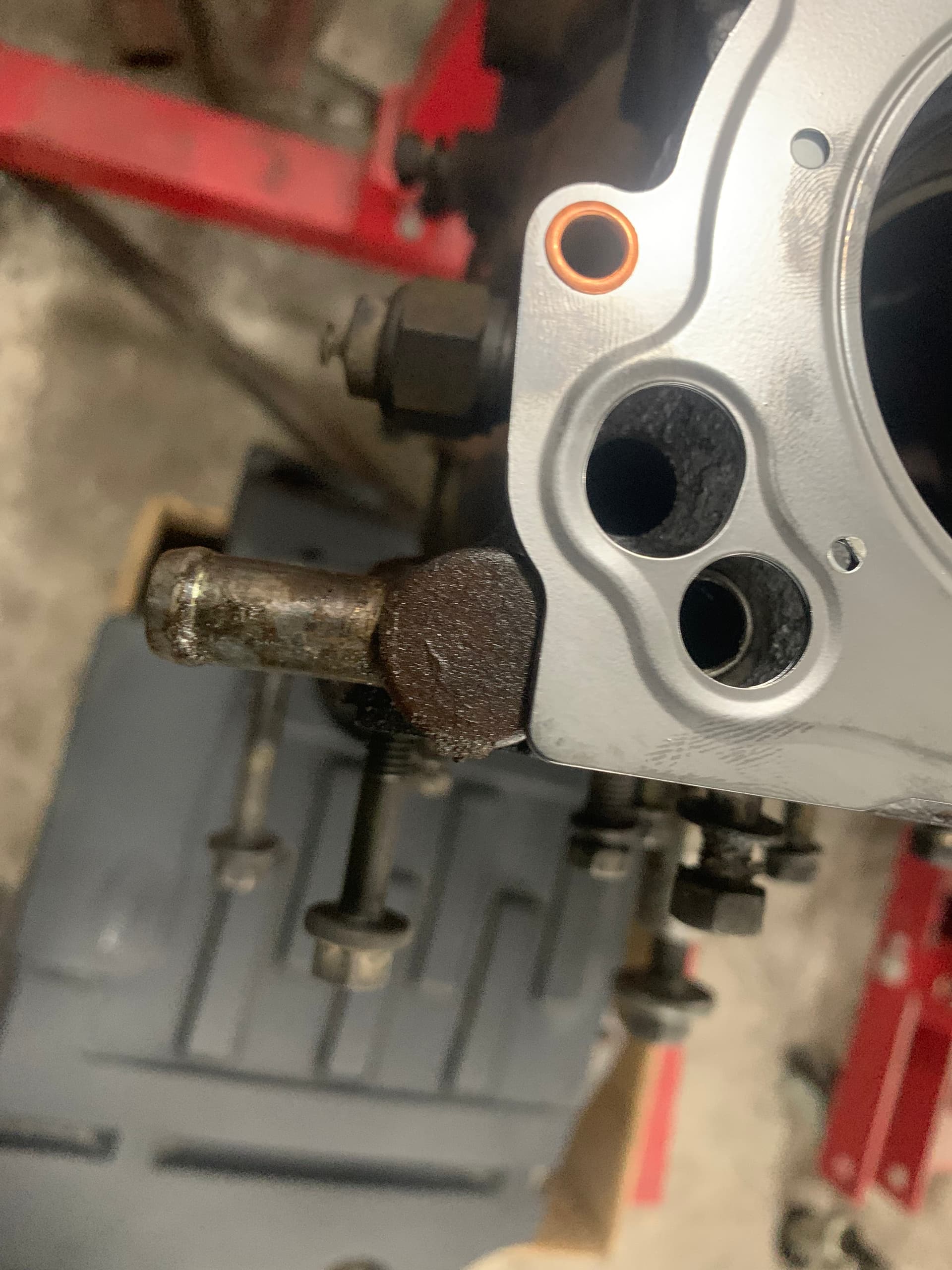

ejde headgasket the non-steel mlm ones are more fogiving then the steel mls ones
Ej-de gasket will fit onto ED block? Aren’t cooling and oil channels are different?
they have an extra Gallery that hangs over the block at the front but besides that its pretty much the same.

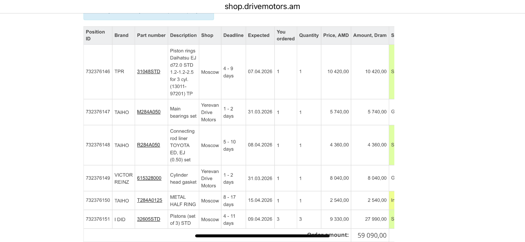

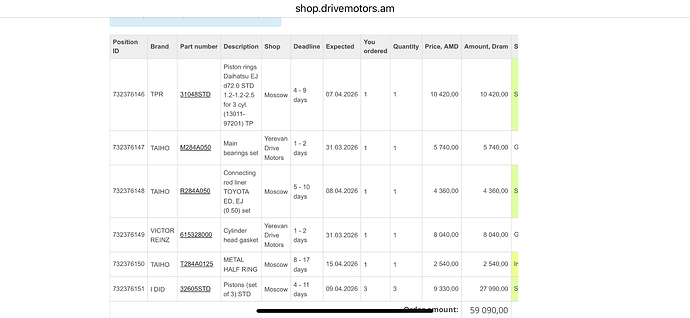

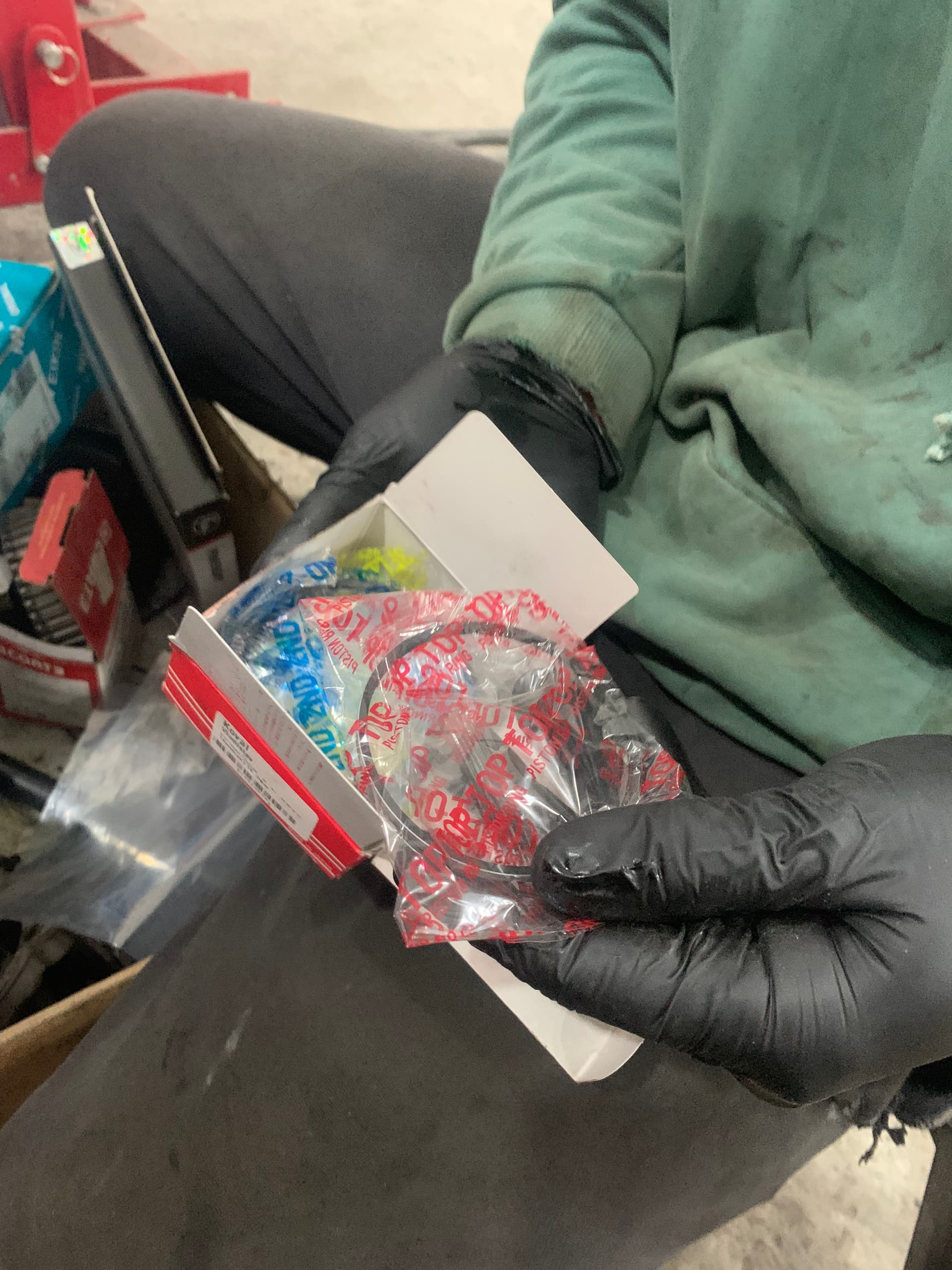

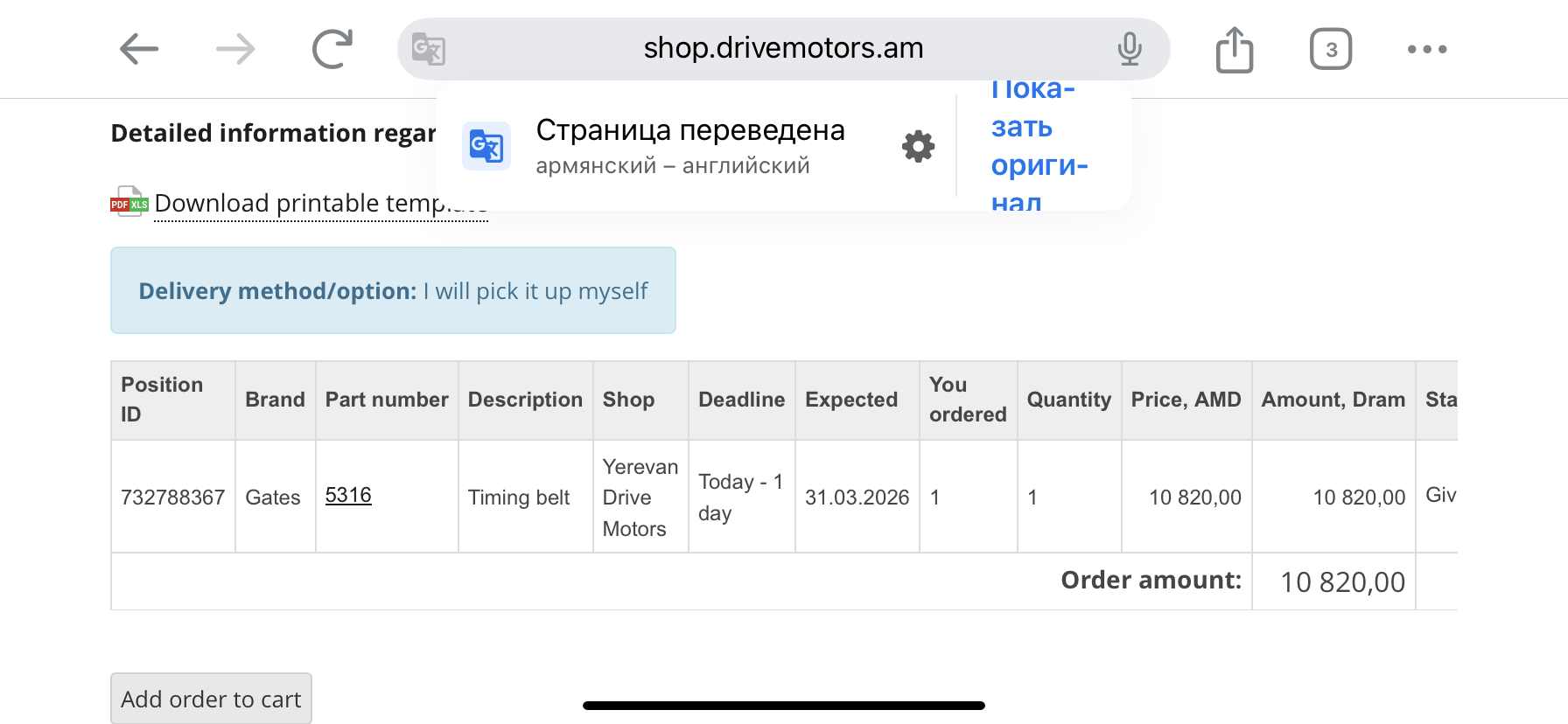

We found and ordered all parts for engine repair
Overall parts cost is around 400 AUD including pistons, gaskets, timing belt, im amazed how cheap it is
For anyone who needs part numbers they all listed here:
Head gasket torque specs:
EJ gasket fits right in on ED block except this little engine ventilation thingy, i suppose i just cut a bit off from gasket?

yeh trim that bit. just be careful.

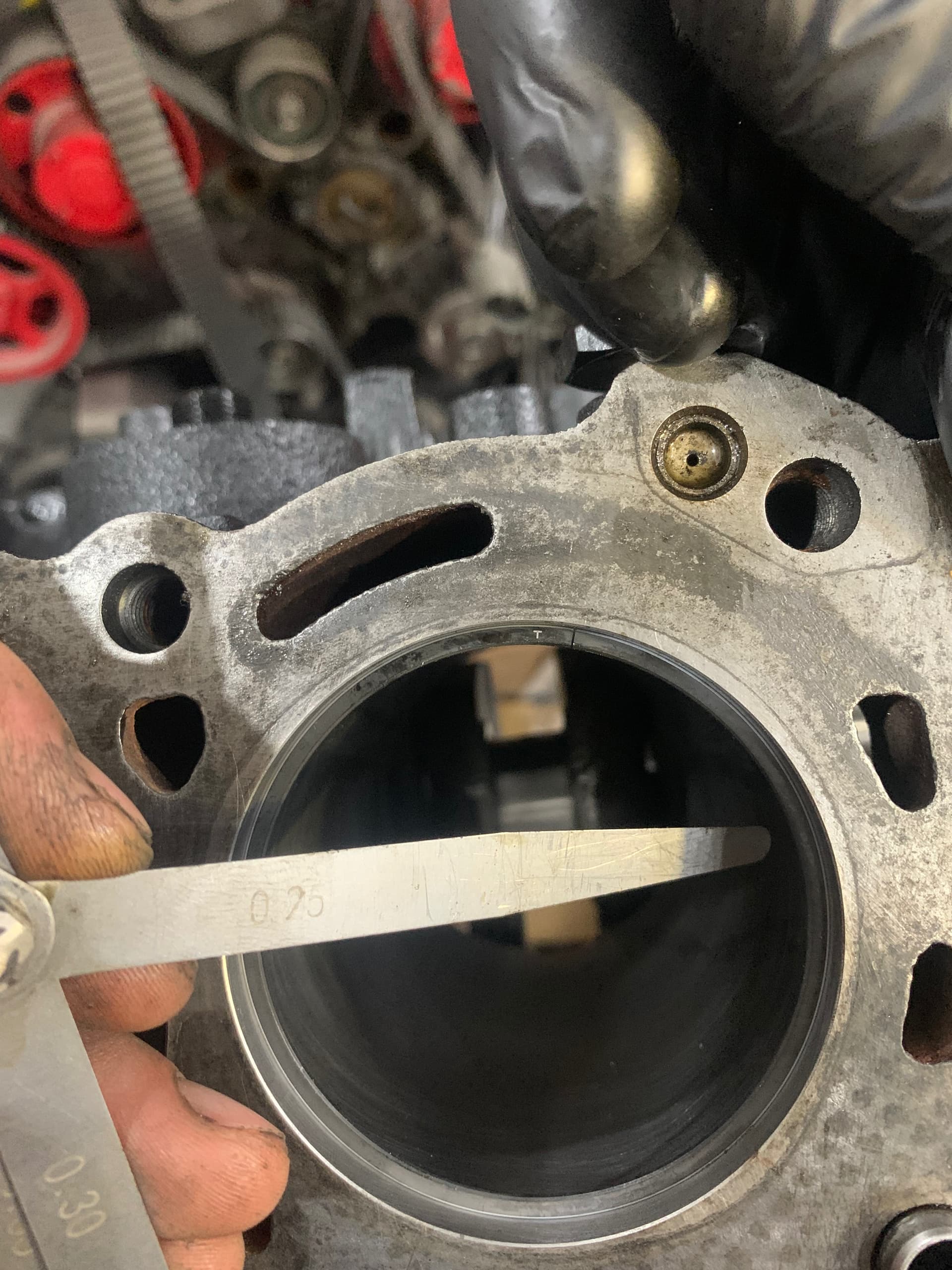

We took our engine to machinist to re-bore it for new pistons 72mm. Head was resurfaced also. Crank was bored to 0.50 repair size (overall work cost around 200 bucks)
Now we are waiting for new head bolts and gasket kit to assembly the engine

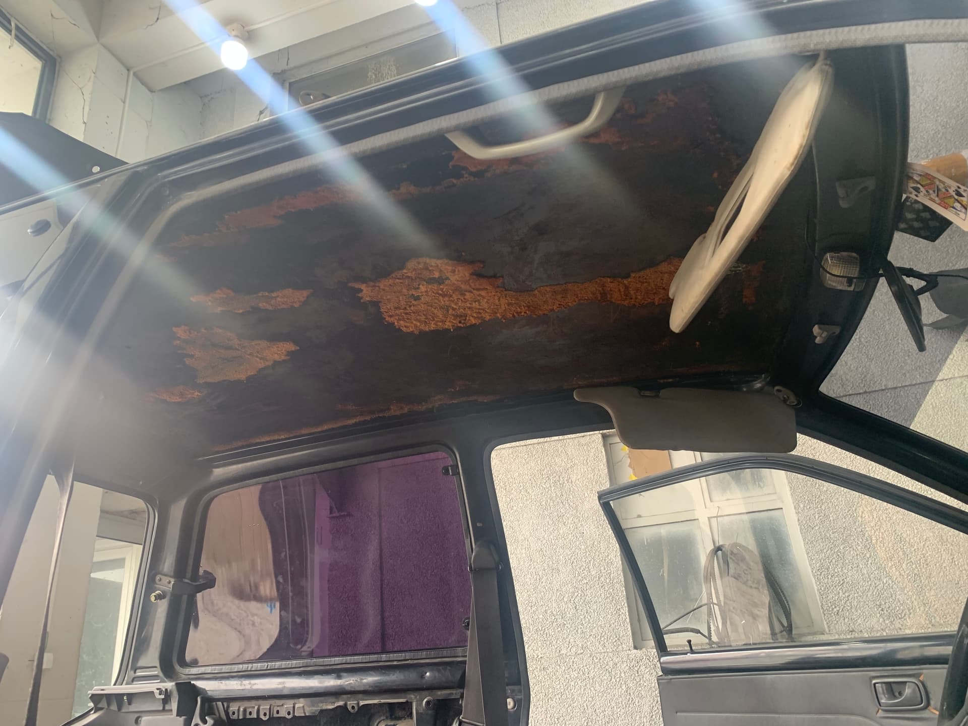

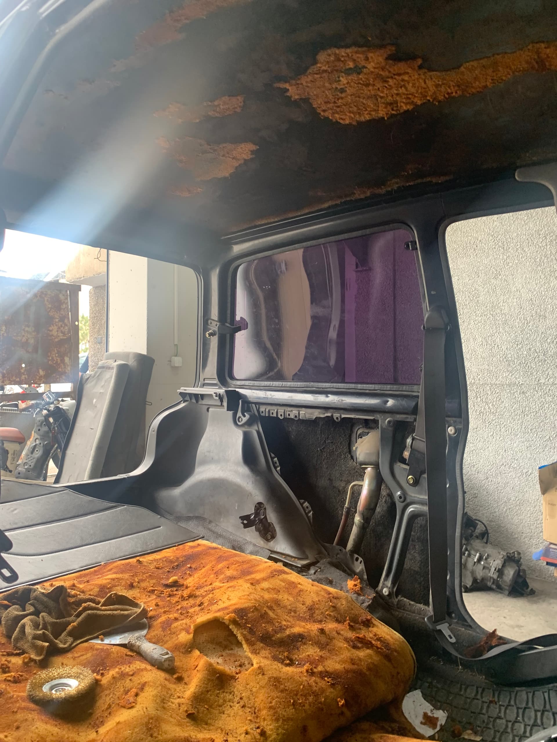

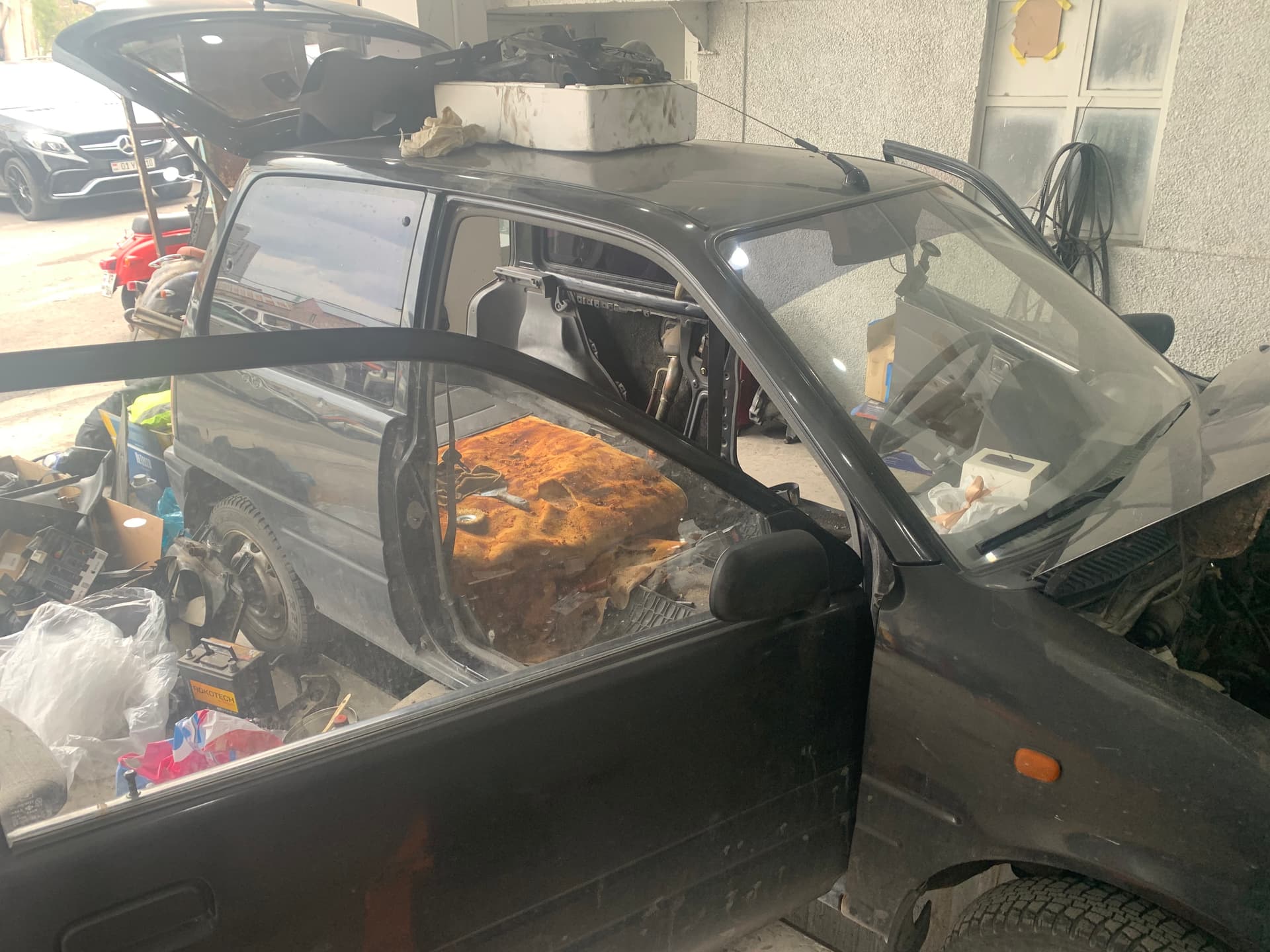

And my friend also decided to change his ceiling covering and repair door trims. we stripped all the interior, removed glue on the ceiling with angle grinder with metal brush disc, this was the only way it came off. there was a little bit of rust because of moisture captured in foam rubber. I cleaned it off and applied regular acrylic spray can enamel. later this week we will put a new cover on ceiling
these are photos before, i will post the result later

That would be a good price, in Germany.
I’m surprised that boring away slightly more than 2.5 mm on each side would be possible.
