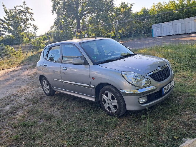

Hi guys, first i wanna tell you, that i am so happy to find this forum with fellas like you, who are ready to help and assist with experience and knowledge, and of course pictures and instructions to these amazing cars of yours. Now on my question, i bought daihatsu sirion m1 with 1.3 l engine, 2002 year ,102 hp , k3-ve engine. When i took the car in my possession and give it a punch till 140 kmh i heard rattling noise from the engine bay like the pistons are with me in the cabine :grinning:. I knew something was wrong but when you dont have the money you just turn the music up , right (or just keep the speed below 140 :grinning:which i did )? But i few months ago i got the check engine light and went to a shop for a diagnostic test and it showed me p0133 (slow feedback from the o2 sensor) with p0300 to p0304 (misfires ) . I changed the o2 sensor and a little while after i left the shop , got an check engine light and went back to see what codes was throwing at me … it showed airbags and abs faults , we cleaned then but it kept misfiring. The guy told me that he cant help me… kept misfiring with the codes p0300 , p0314 with p0136 a few time , so i changed the second o2 oxygen sensor, with no difference… sometimes it threw p01300 which the obd2 scanner said that i should check the manual service for that exact code, but in the manual they start from p01346 , which is timing chain but at iddle i dont have rattling sounds . Also the long fuel trimms are around 40 percent and up. Changed the spark plugs with febi 2 months ago , checked the coils, taking them out to see if the engine would stall which it did. I tried to do check for vacuum leakes with DIYU smoke jar, but it was not very efficient because i cant make the pressure like a professional smoke machine . I cleaned the injectors with carb cleaner but nothing changed. The short fuel trimm of o2 sensor 1 is around 0 or negative 2 or 3 percent , the short trimm fuel of o2 second sensor is always around 20 percent and up.most of the misfires (blinking check engine light ) keep happening while i am waiting at traffic lights and i am at iddle .if it was definitely a timing chain wouldnt the misfiring keep hapening on cylinder 1 and 3 ? I hope you guys help me, im losing sanity here :rofl: applause to the creators of this forum , really having a good time reading about your d’s :grinning:

P is Potsdam right? Just a bit to far for me. But someone should help you with a compression test. And dont forget to look at the plugs. Snake eyes will help.
The rattling which is like someone is hamering my door occure only when i hit 140 kmh . Yeah, I am in potsdam. If yhe spark plugs are hitting the pistons, the next thing they should hit, should be the head of the person who sold them to me… i willmake a video , so dveryone can hear how the engine works at iddle.
