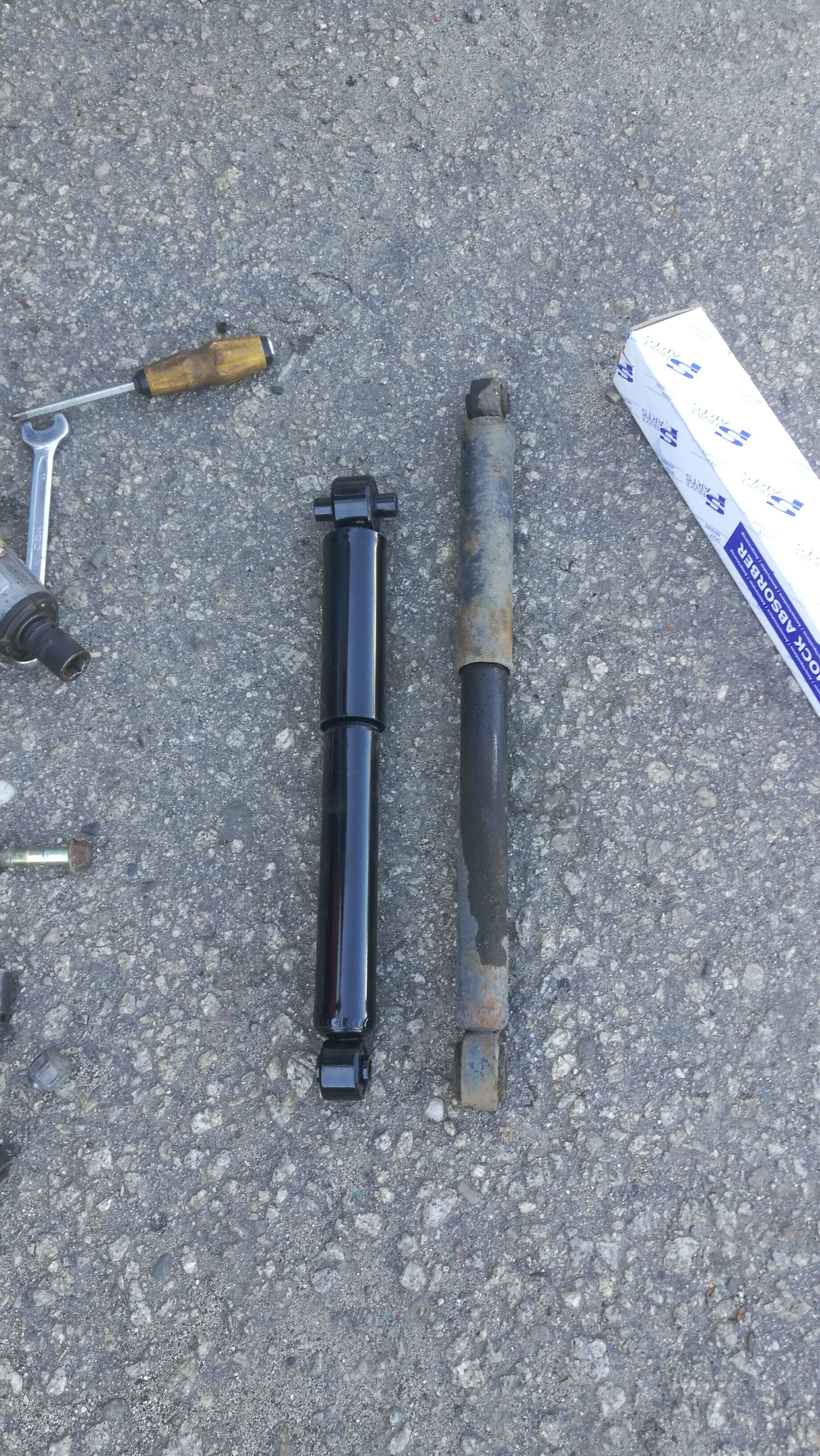

Update! The i20 shocks are a success. I had to make the width of the eyelets smaller to fit. They are alot shorter, but they’re much stiffer. They definitely only really work for lowering as they are quite short.

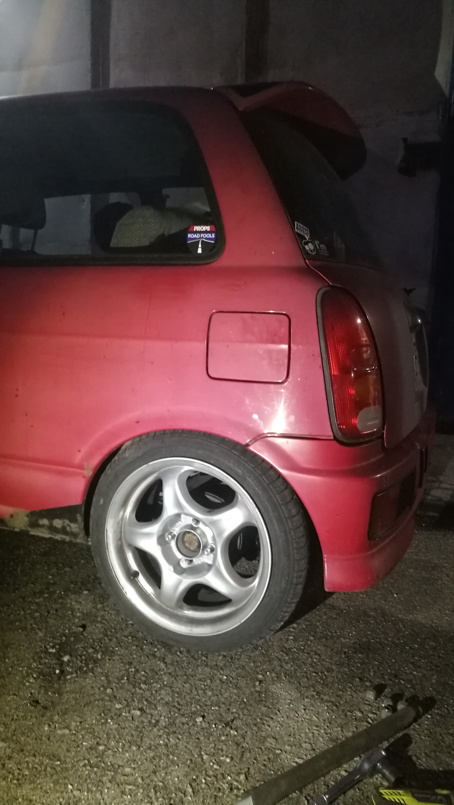

I did rear lowering with 89-95 excel/pony shocks
I used lefrover Micra K11 stock rear springs, these are cut about 3 coils. Micra was about 100-150kg heavier so springrate should be ideal, “sporty”
Most important thing: imo these shocks are almost too short. As mentioned in other treads, I had hard times with lack of SAG (negative travel, the amount of travel that goes when suspension needs to extend, like hitting the hole incthe road)
In short: in this setup, when you have some solid bump (imagine like- tree root bulk the sidewalk) car can go airbone. Maybe not so much to consider at racetrack, but can be dangerous in street driving.
I dont measuring it. Usually when you have you springs mounted, without shocks, you drops the car and then proceed to tighten the shock eyelets. In this case Excel shock didnt reached the axle eyelets, until i reached about 80-100mm drop.
In stance days its not that much, but back in the days that was racecar teritory
First tests was promising- handling is firm and stable, but in this case shocks works almost at maximum extend. It may affect their longevity.
Side note: it will be also hard to match same amount of drop in the front :grimacing: polo 6n coilovers will be not working in my case…

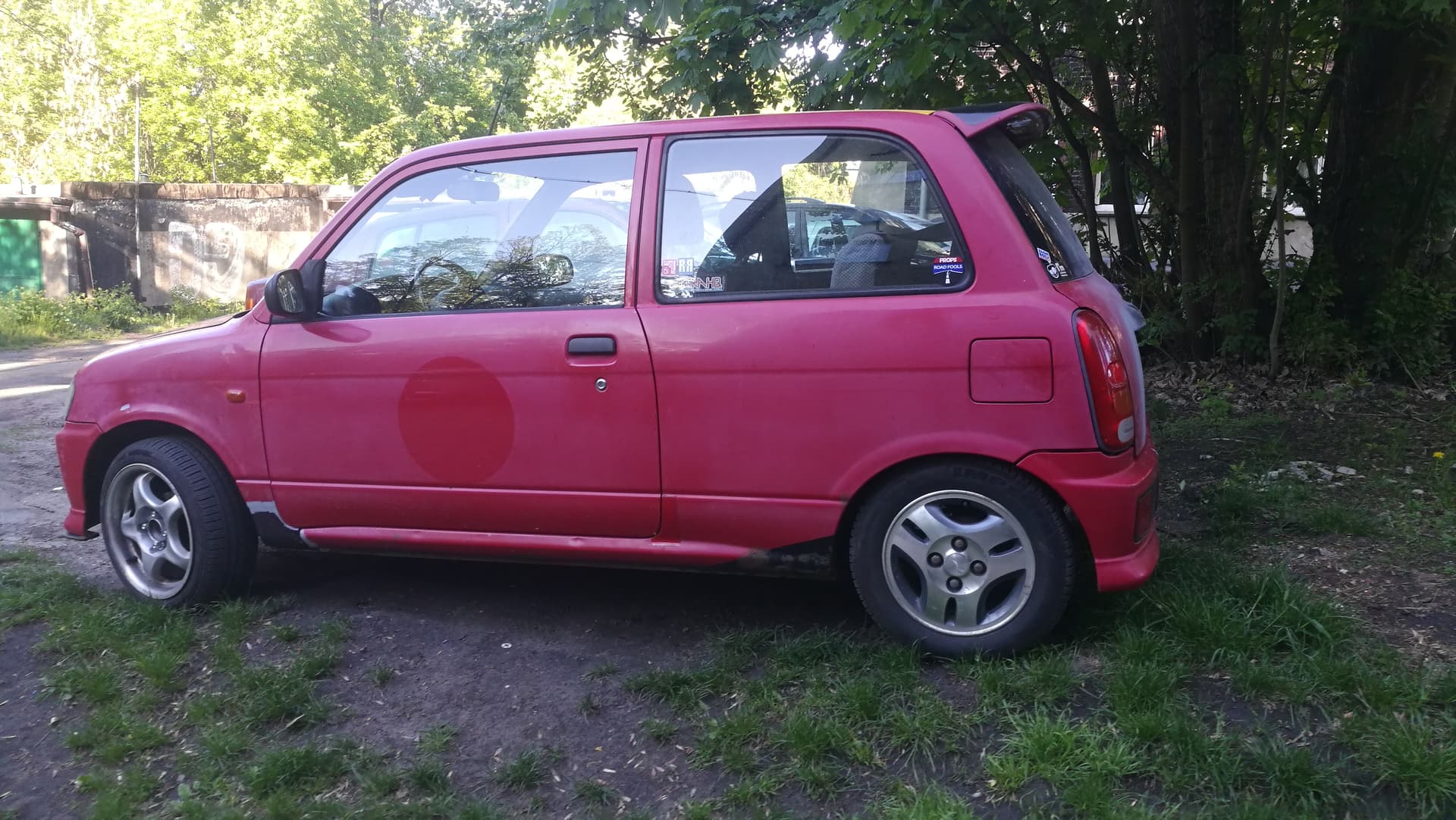

Photos:
Here, good example how dramatic the deop is compared to stock height at front. Stock 13” dont rub the stock fenders
15” gonna need serious fender roll :thinking:
