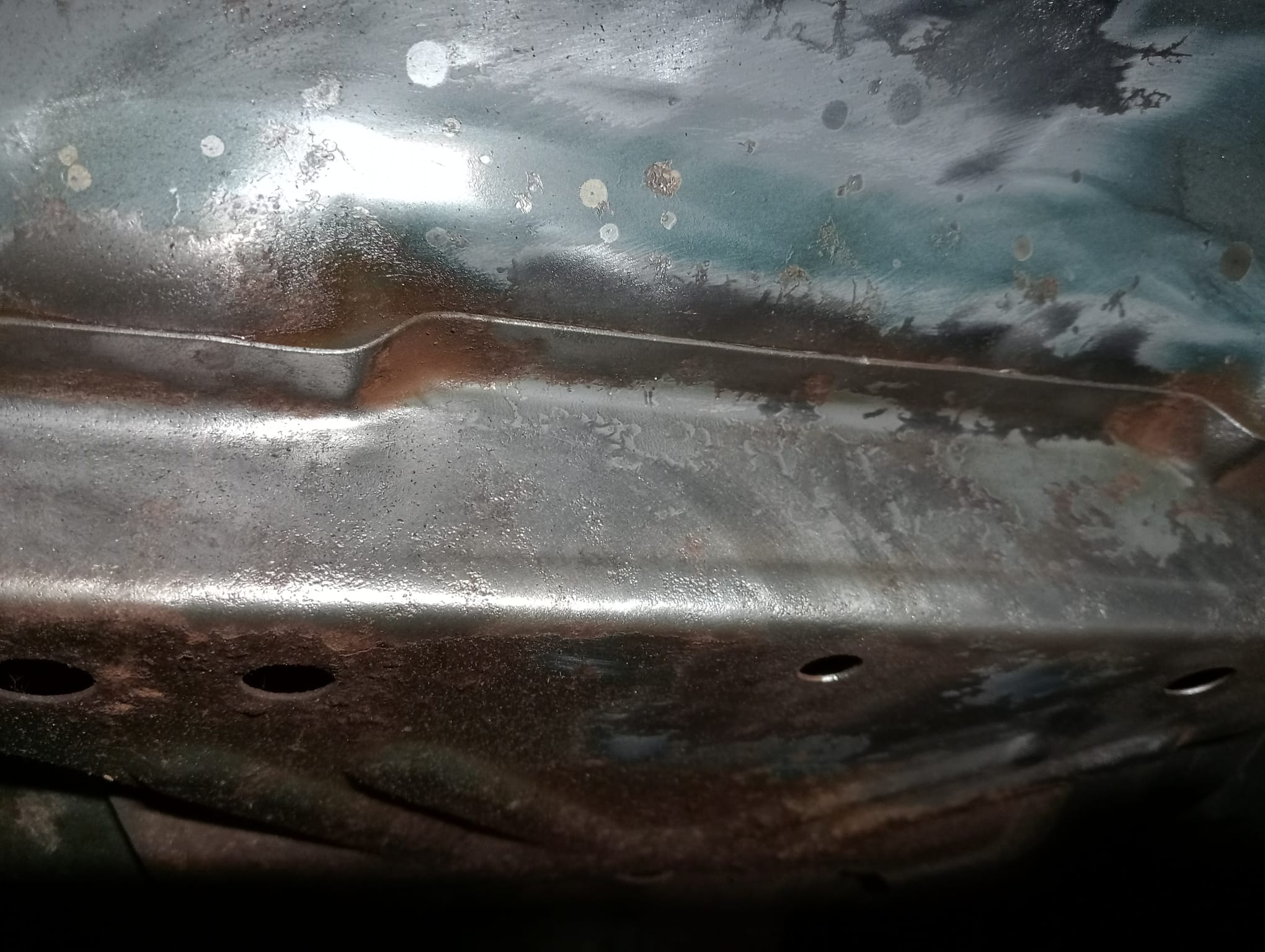

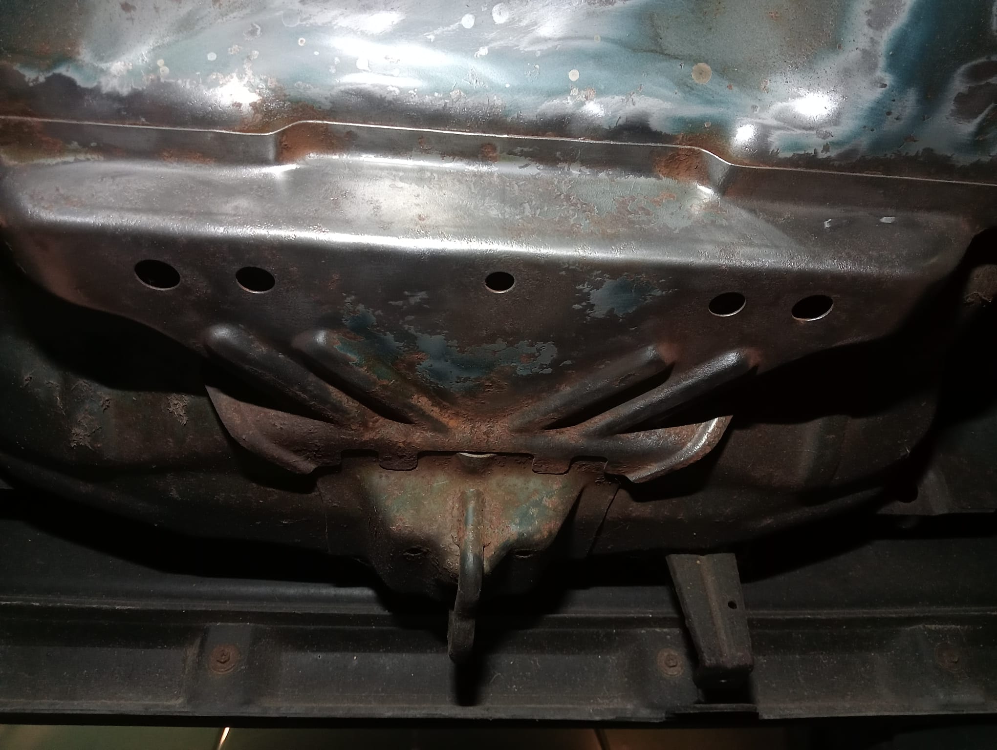

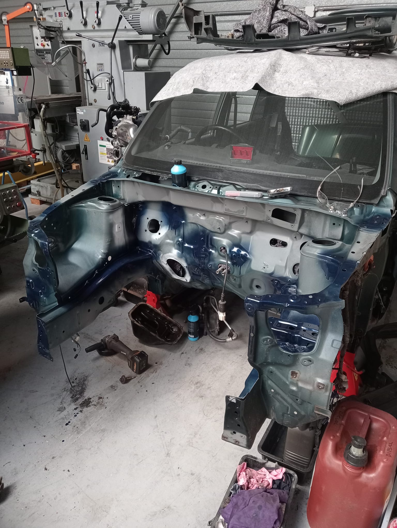

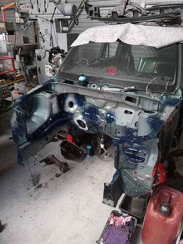

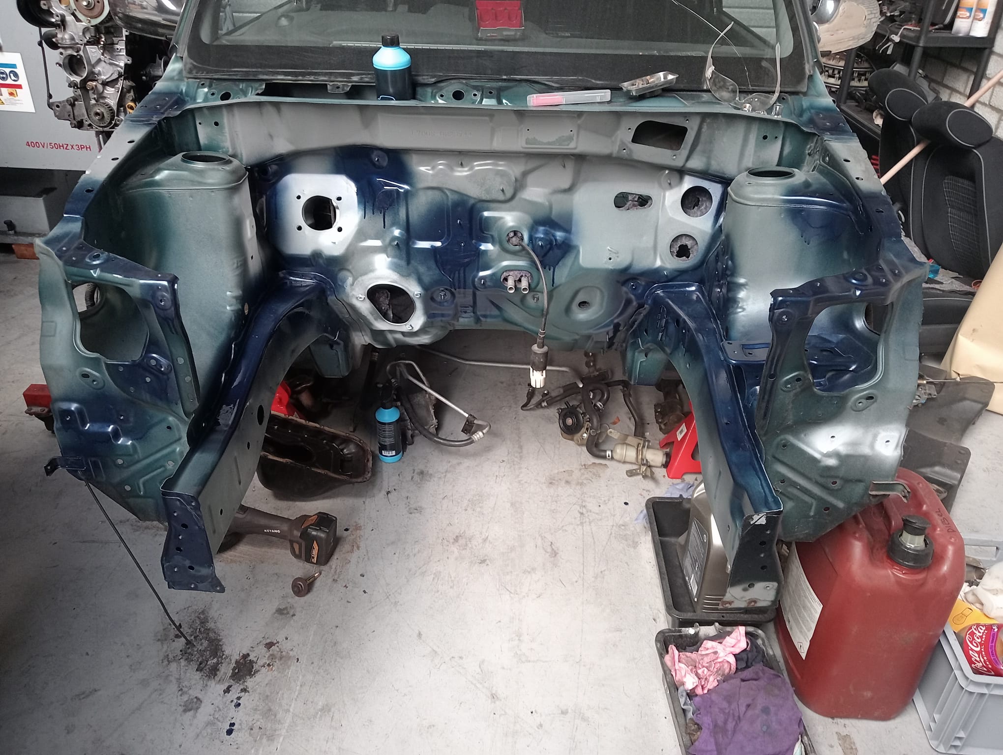

I’ve been focusing mainly on the rust removal for now. But i might have found a fun engine to swap into the Gino.
If you look closely you can see that the rust has started eating away at the metal already. Just in time.
However… I’m going to hold on with torturing myself underneath the car until i now how long it’ll take for the laser rust remover to arrive that one of my coworkers ordered. He’s willing to test it out for free on my car.

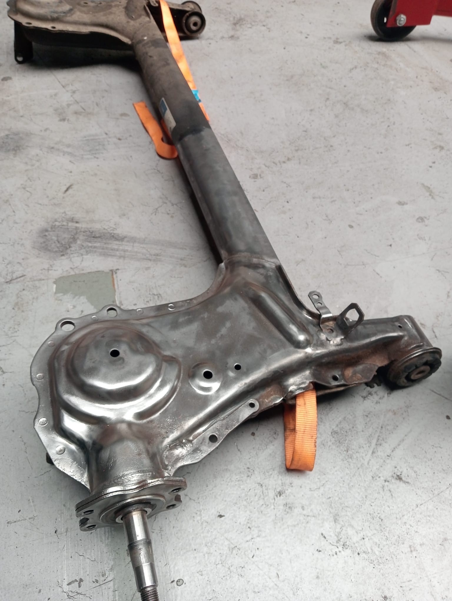

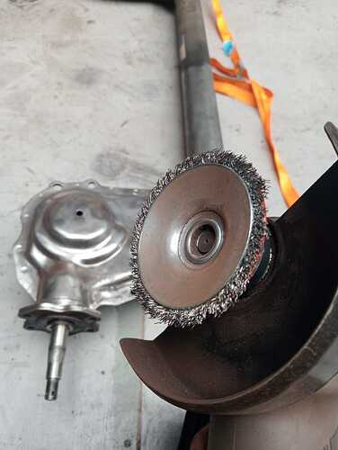

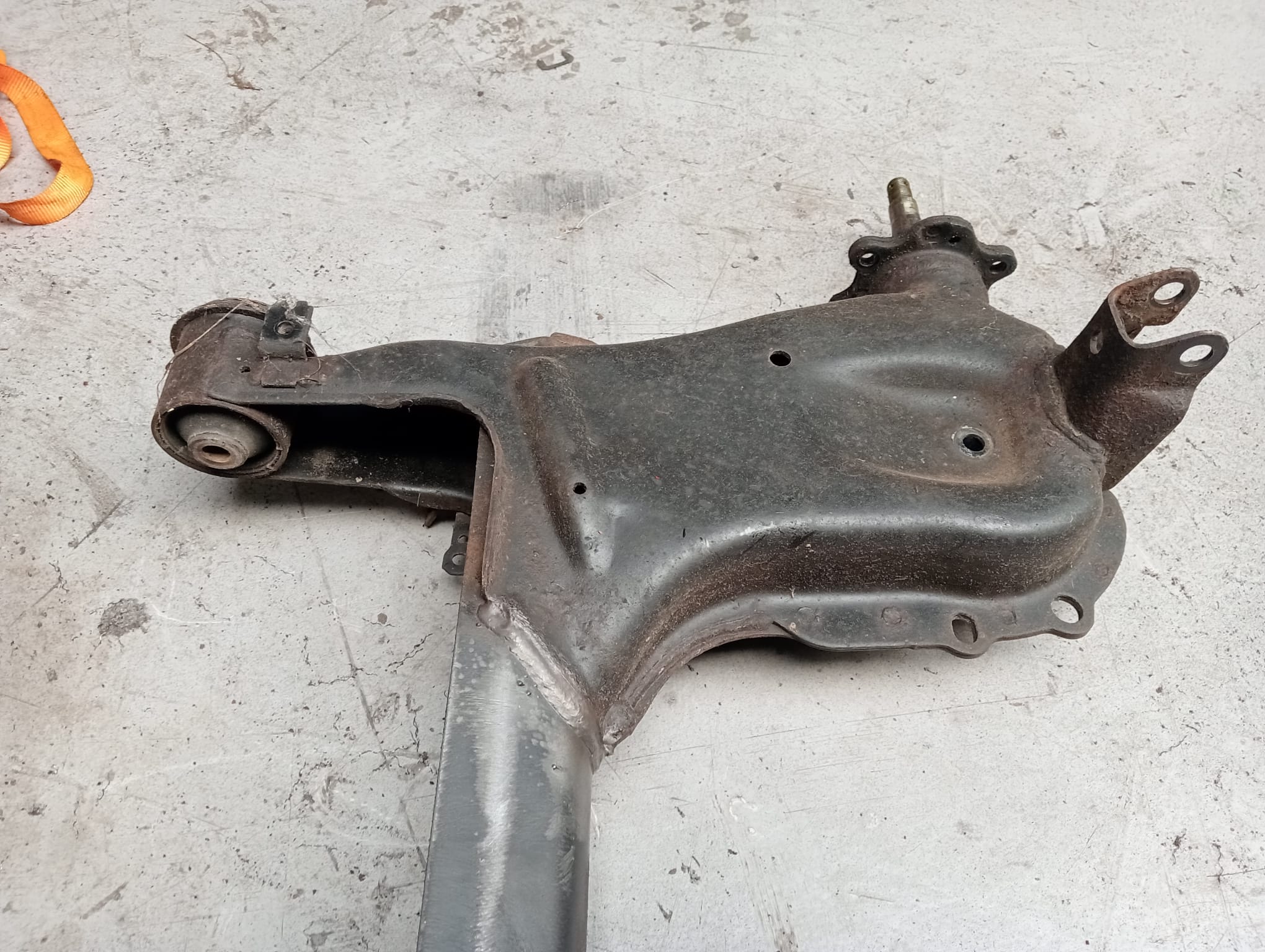

So i’ve been removing any signs of rust in the engine bay. For the time being i covered the bare metal with some B42 blue paint. Later i found a can of LP2 midnight purple and sprayed on some of it. Now i want to do the entire engine bay with midnight purple.

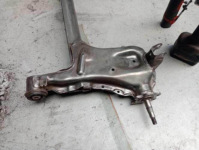

Also been busy on the rear axle as i would love to get it in as soon as the underside is finished. Plus i want to mount the bigger brakes.
Recently picked up complete rear drum brakes and calipers from a M1 Sirion for my Gino considering the future engine swap.

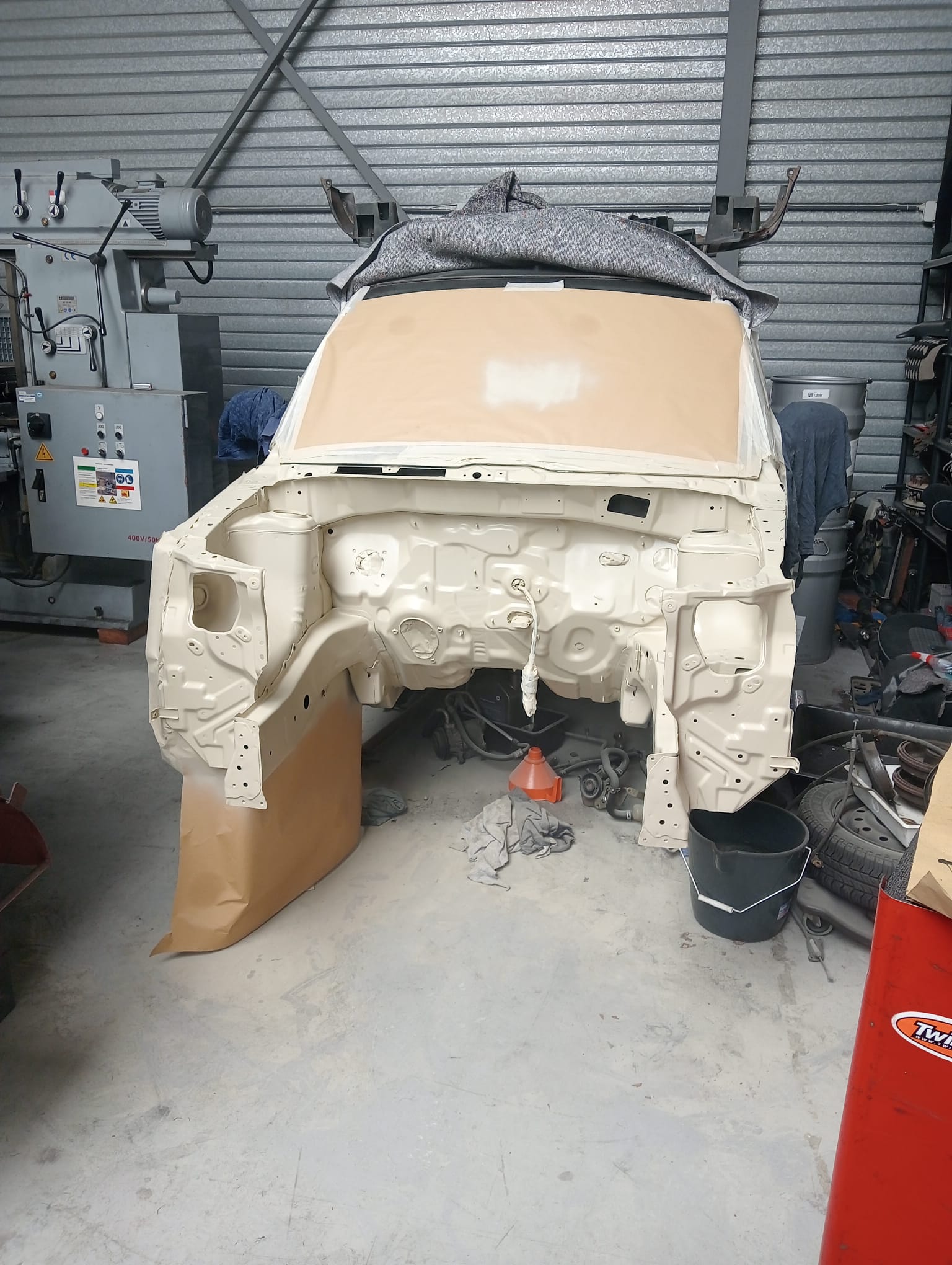

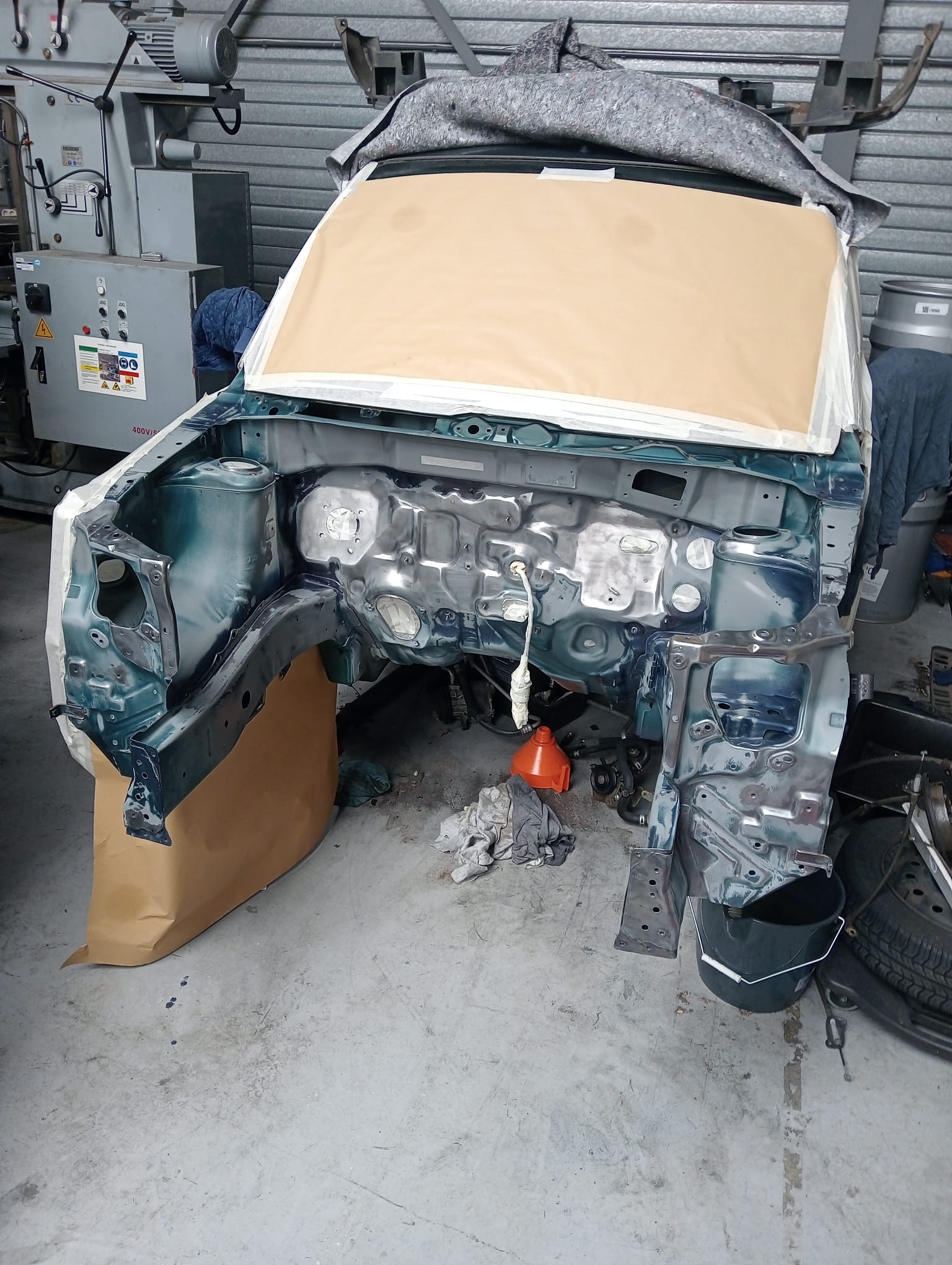

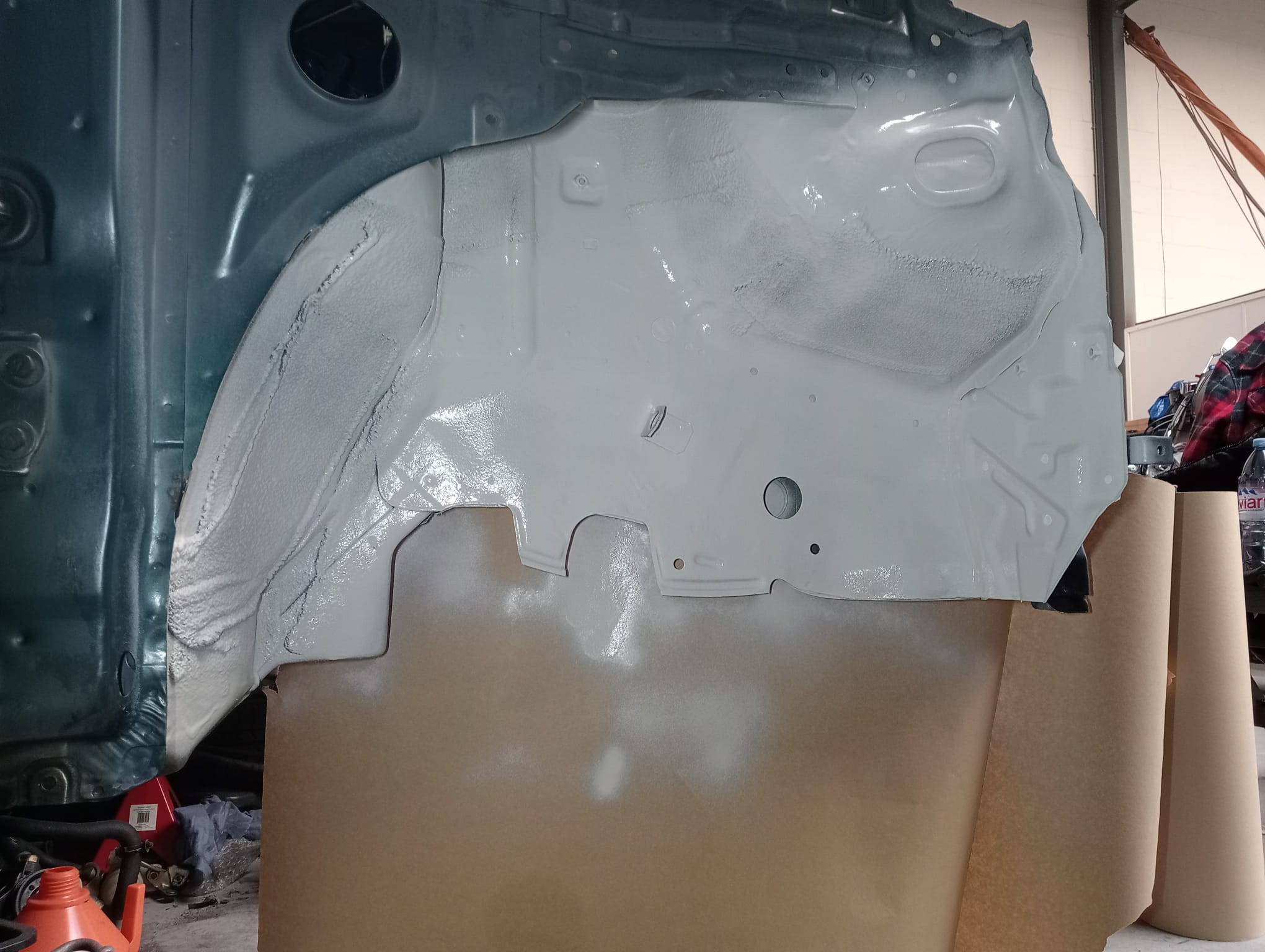

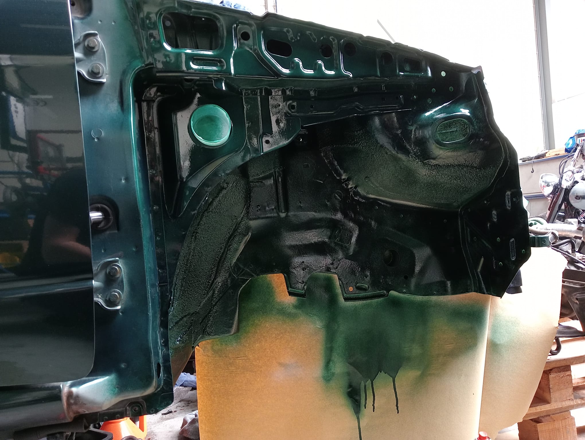

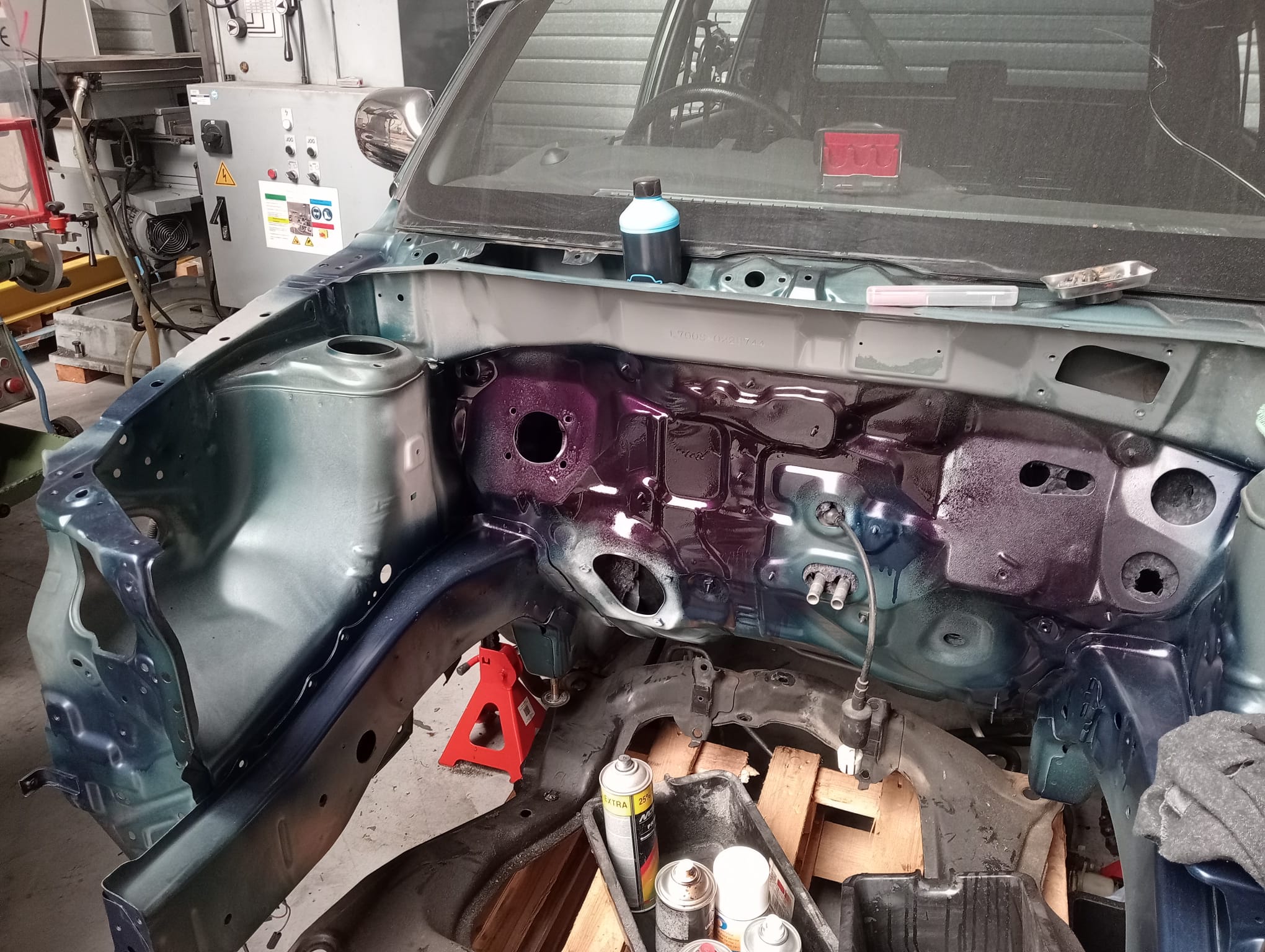

A little update
coated and painted the drivers side wheel well after removing the little bit of rust it had.
After lots and lots brushing and sanding it was time for primer yesterday.
Hopefully i’ll get to paint the engine bay next weekend or the weekend after that (if i order the correct color this time).
