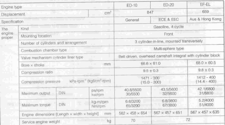

For anyone planning on doing this swap, I just bumped into some ED and EF-EL side-by-side specs which raises the question of the possibility to swap out an EF-EL crankshaft and connecting rods, replacing them with those of an ED, in order to get an 865 cc EF-EL with plenty of low-end torque. It’s probably already been answered numerous times. But, I couldn’t yet find the appropriate thread it may have been posted on:
To put an efel crank and rods in an ed10/20 has been played around with about 10-14 years ago (the first time I remember) and while physically possible have a look at the stroke difference. The compression ration will drop way to low. Obviously the the ed and the ejde are taller blocks.
To go the other way and use the ed stuff in the efel the gudgeon pins are of a different size than the ed10/20. You would be better off going with a nissan march piston or similar (72mm) on the ef/el rods and boring the block.
What you are suggesting is to pretty much make a stroker block. The rod and piston combo would be way to tall for it and just longer rods don’t really make a stroker. You really need a crank grind to suit the rods you would use.
Oh the exert from the L500 Manual you have there has been around for as long as I can remember and you should be able to find it somewhere in the manuals section to download.
I did indeed copy that from a down-loaded manual.
Later on this afternoon, it dawned on me that the EF-EL blocks could have been cast shorter than those of the EDs. In which case even shorter rods than those previously mentioned in my earlier post would be required. As long as the pistons reach where they’re supposed to be, there shouldn’t be any change in compression, unless the replacent pistons are deeper dished. My main concern was if the longer crank throws would clear the block or not, without cutting away material.
Then there’s the valve size question. With increased displacement, more gas will need to get past those valves which may end up under-dimensioned, in that case. In all other Daihatsu engines, the intake cam lobes raise their accompaning valves higher, simply because exhaust gases move better on their own. Which makes me wonder as to why the exhaust side of the Ef-ELs have the double valves, instead of the other way around where incoming air/fuel mixtures are the ones needing more assist
