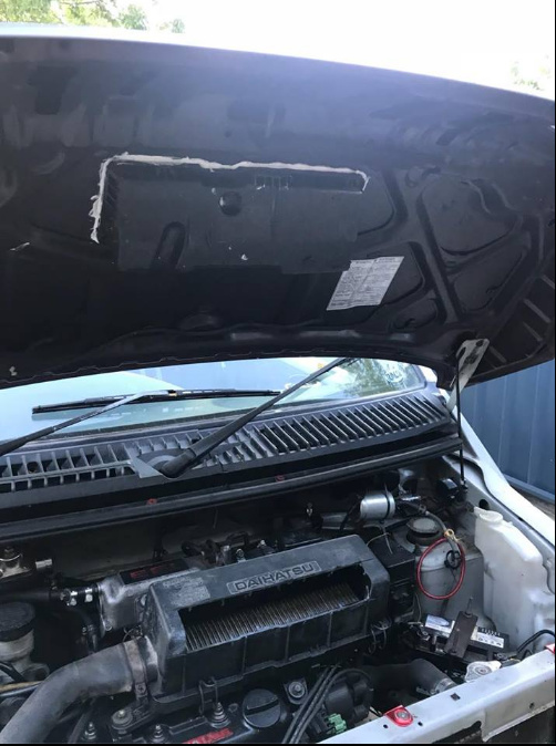

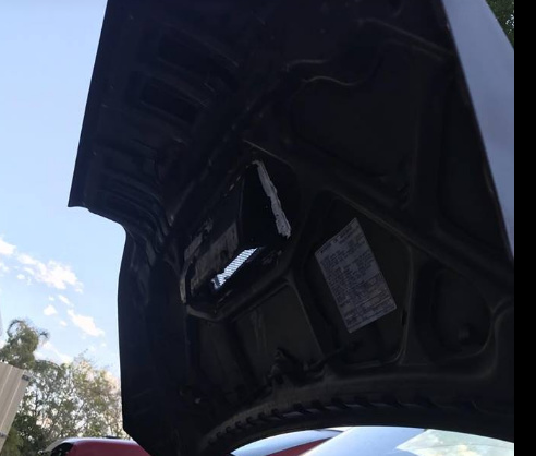

Had a play with the spare bonnet I have (Thankyou Hoveâs) I made a small cold air intake for it. I just used things that I had laying around with the exception on a tube of sika flex. I cut a hole in the bonnet got some mesh and some metal strapping and sika flexed it all in and underneath I had an old ef/el air intake and chopped it so the air could be directed to the top of the move air box and simply cut a hole in the move air box.
Added some paint and there we have it a fun little project for upcoming track day.

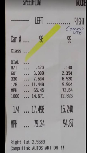

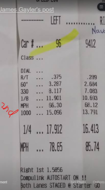

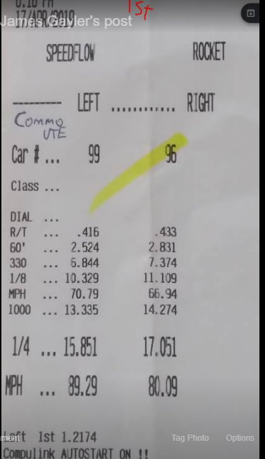

I havent updated this for a long time but basically running a td04 turbo off this now and took it out to the drags last night. here is the vid on it and thankyou to @Luke for coming along and filming and making the Vid. I hope you all enjoy! We had a great night!
Soooo close to 16s! I think youâre going to walk Bertie bus on the straights on the trackday!
canât argue with those times
I can my take offâs were really crappy hahahaha!

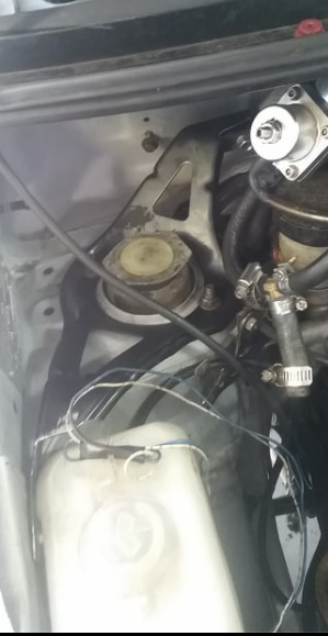

I got out yesterday to have a look at the move and had a look at some gtvi strut top braces that bolt onto firewall and the side rail. On a move they donât hit the firewall but do make it to the side walls. Even though It really hasnât been advised to I thought I would try making the strut top brace with a few modifications and a square piece of steel tubing I was able to make the brace and it just in front of the firewall behind the intake manifold etc. I was originally going to weld the tube to the braces but instead I have decided to just bolt it. The reason for that is while it may add strength and stability I wanted it to also have the flex points of the bolts if it needâs it. Another big bonus is that it will be easier to take off if I can take it apart. I now just have to relocate some things a bit more so everything reaches where it should.
Nice! Any noticeable difference? a Move race car! I love that thought.
no havent driven it yet. I did that late last night and have been lazy and not put evrything back together yet. Will let you know when I do take it for a drive.

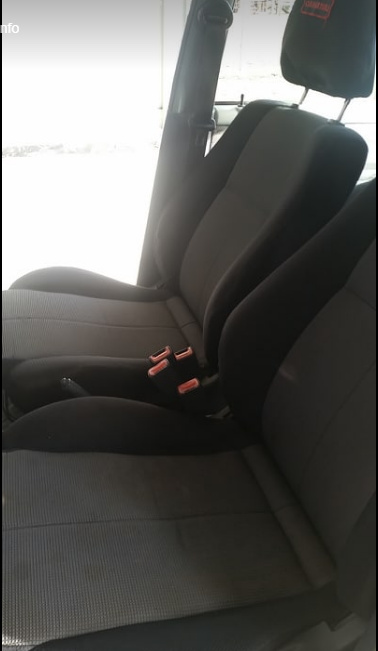

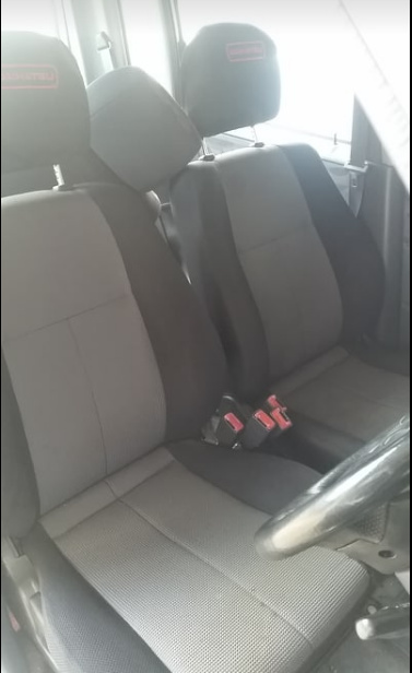

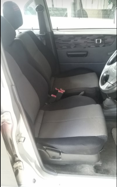

Inspired by @b_hoves I have put the gtvi seats in my move and they do sit lower but I can still see out the windowâs so that is a bonus hopefully this takes away some of the pain I get when in my ankle when driving. I have to have my seat way forward and it makes me have my foot what feels like alomost 90 degrees on the throttle.

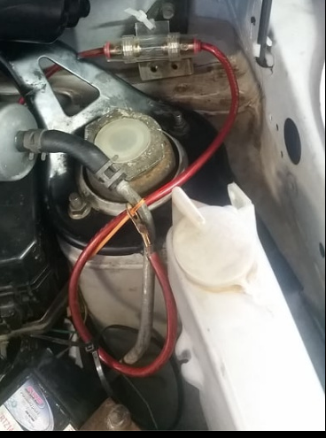

I also have put in a slightly bigger breather in the rocker cover and put in a new oil catch can.
as for seat belt clickyâs with the seats I havent decided which ones I want to keep in there yet hahaha!
Glad to be of inspiration. I havenât picked which seatbelt clickers to keep either. Iâm leaning towards the GTVi ones for the clean look.

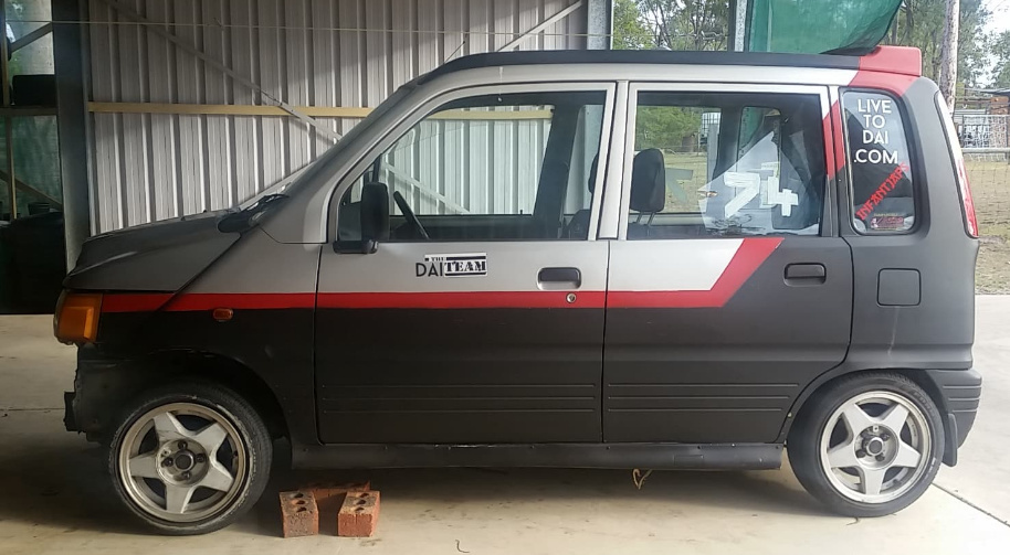

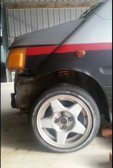

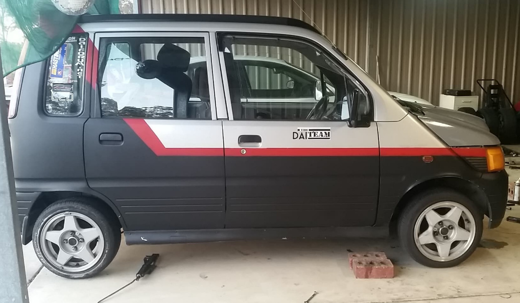

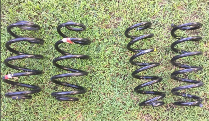

Today I swapped out the front shocks and springs that were in my mira and put them in the move. The shocks are sirion gtvi and the springs are mira kings. I dont have anything to measure camber with the exception of a spirit level bubble. I got the camber a touch on the negative side with the bubble just touching the outer line on each wheel. The gtvi shocks are really tall compared to the suzuki wagon r ones that I had in it. The move now has more like a rwd drag car stance than anything. I happened to find a complete set of springs from a 2008 ford ge 6 that I will be picking up this week for the measly sum of $20. I will see how these go and if they will work in the back of the move. At the moment it has rear cut springs from a suzuki cino. I am hoping I may be able to get these ok with a stiffer spring and a little bit taller than what I currently have. If they work then great and if not it is only $20. I may have to go back to the suzuki wagon r shocks also the ride height at the front is really tall but it is more soft with the mira kings than the rsrâs.
I didnt have a shoe handy so a brick for the shoe test seemed better. ( my tyres are only 155/55âs So I do have room for bigger tyres.
and these are the springs Im picking up.
4x4 stance!
Nice work on the rear springs for $20. They should be good.
I spoke to a suspension guy at the recommendation of MrG and he suggested finding a way to fit the coilover springs like the ones you listed in Bertieâs thread rather than getting custom kings done.

Ok so I got the springs today and by the looks of the front springs from the gc8 are going to be about spot on for what I need. If anything it maybe a little too stiff but will see how it goes. I do need to take a coil or 2 off them . 1 Coil is a definite so they will fit but I really think I should go back to the suzuki wagon r strutâs for the front and use the mira kings on those instead of the rsrâs. I had a proper look at the rsrâs today and they are a progressive spring in comparison to the kingâs. That maybe why they were a bit stiffer when really pushing in the cornerâsâŚ
After I sort all that out I after I have to fix the dump pipe from the turbo as it is leaking, So I will use my thicker pipe and wel in a new section so I can get it more free flowing.
I played around with rear springs today and I actually like how the move looks atm I am waiting to drive it to see how it handles now but I think the back is definitely stiffer and the front sits a bit higher than the rear. I also made and hopefully fixed my dump pipe off the turbo and is now atleast 2 inch instead of stock mira size pipe.
Went out and got this running today I did a rope wheel alignment now that it is so tall and seems to be ok. I also had issues with the fan realy but seem to have that sorted. So after a little bit of driving this seems to handle better than before the strut bar seems to help also but different so I will need to get used to it but I can really feel the weight transfer in the cornerâs now. The dump pipe being bigger well that has made a huge difference. Before when getting into 4th gear I could only boost to around 5 psi with this now I am getting 10 psi in 4th and it seems to have come alive alot more in the earlier gears also. I do have a little bit of a leak in the joiner (exhaust) but am not really to concerned but will need to attend to it I guess. The other issue I was having was an intercooler hose popping off. I have a temporary one on there at the moment which is thin and I dont think will last long so I best find a bit of radiator pipe that is the right size I guess and long enough,
