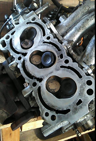

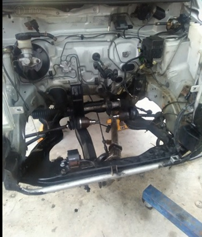

Progress/destruction pics from yesterday.

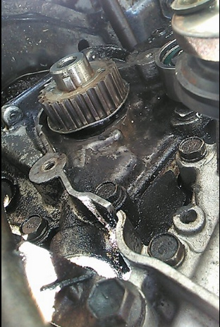

this is the unmovable object

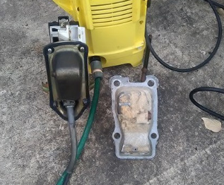

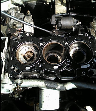

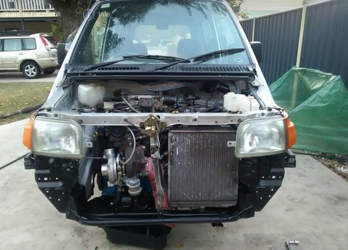

this is with multi layer steel gasket for ejde just a small mod and some overhang and the work great.

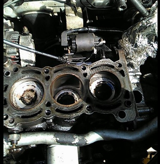

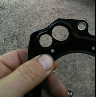

this is where you need to grind or file the head gasket back to fit around this bit.

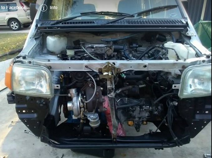

I got a new seal. built a cog puller the it failed so back to bashing crap out of it with wedging stuff in there to move it. I didnt get the damn thing off until about 3pm . The reason it wasnt coming off was the key had a bur on it and it was keeping it from moving forward. Brute force and ignorance got it out in the end I had to clean up all the burs I made on the cog and then do the seal and its all back together by this time all I could do was sit the head on the block and call it a day. From here it should only be another day to get the rest back together. Although I found a couple of other small jobs to do with it also.
yeh just the rest to go. I am so happy that bit is over though I had vision’s of having to use my spare block or steal the mira’s engine. Thank god i didnt have to

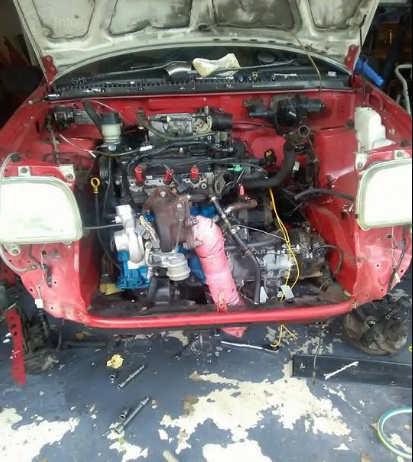

well things didnt go to plan like I was hoping after doing all this work it seems the crank seal housing got damaged and when i got it all back together it spilled it oil all over the place after 5 mins of running. So after feeling disappointment, I had a day off yesterday and today I took the timing gear off and saw the damage. I had a couple of options
was to take the engine out see if I can fix it.
take the engine out and replace it with my other ed20 I have.
take the engine out and replace it with the franken engine (with the ejde pistons) out of the mira and use that with boost.
So the common denominator as you see is take the engine out.
So
Thanks Dale. The stuffed motor will be donor parts etc or fixed anyway. I have made a decision during the hours of last night that I will be putting the mira engine in and making the move a manual.

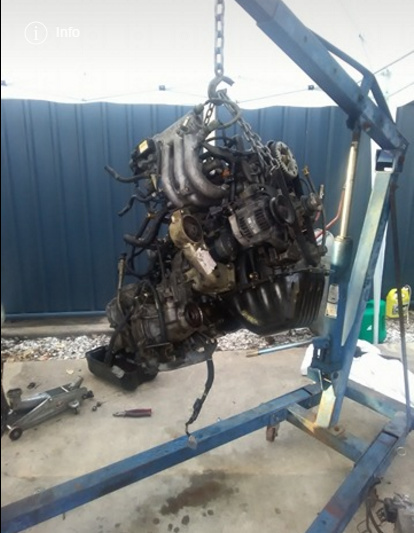

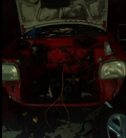

Got a bit done today but not going falt out with it. I got the engine out of the mira at the end of the day. B4 that I cleaned (roughly) the move engine bay and got some rust converter on a couple of bits and some subframe black to make it last and look a bit better.
I took off the sirion hubs off the mira with the other l stuff for 4x100 also (only the front). I have made a few discoveries with everything as I go. I will need a bigger hole in the floor for the manual so a bit of cutting will need to be done. I think I may bite the bullet and buy a move manual pedal box as it would be 100 time easier than what I was looking at doing. but see how I go first. The other thing is I have no idea how I am going to wire this thing in. With zero exerience in doing so It may be a lot of research or who know’s I may end up convincing my mrs in letting me get a microsquirt or something .

Eventually I got the engine in so I can start prepping the other stuff too.
