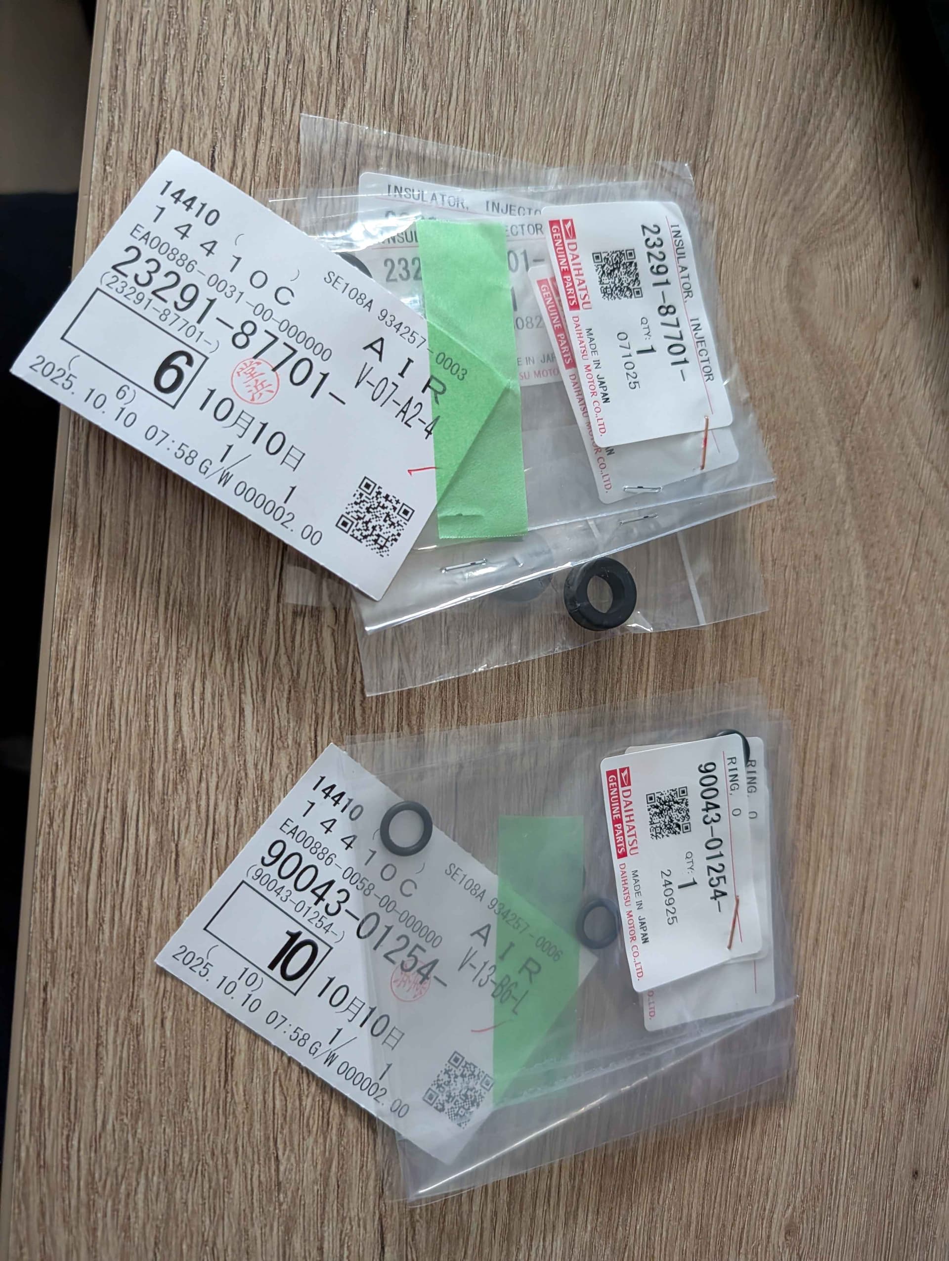

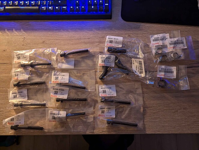

Dai parts! The head bolts are packed like individual snacks and all the hoses and clamps for the turbo cooling system are here too. Yay!
That’s because they’re sold per bolt instead of a set like the aftermarket bolts.
So just buy as many as you want/need. :joy:
Sure I’ll only replace 2 next time
:rofl: :rofl: :rofl:

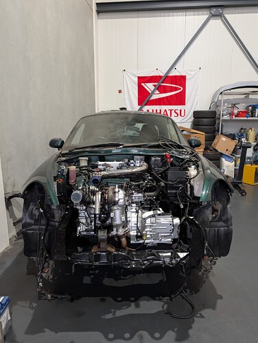

Officially putting things back together instead of taking them apart.
Finally getting to replacing the thing that failed.
Timing is mostly new. The chain, guiders and tensioner are all NoS. I tried to order the oil pump chain but it was out of stock. But it looks fine. The timing components weren’t even in bad shape in the first place. It’s just a “while the engine is out anyways” kinda thing.
Almost looks like an engine again. How odd.

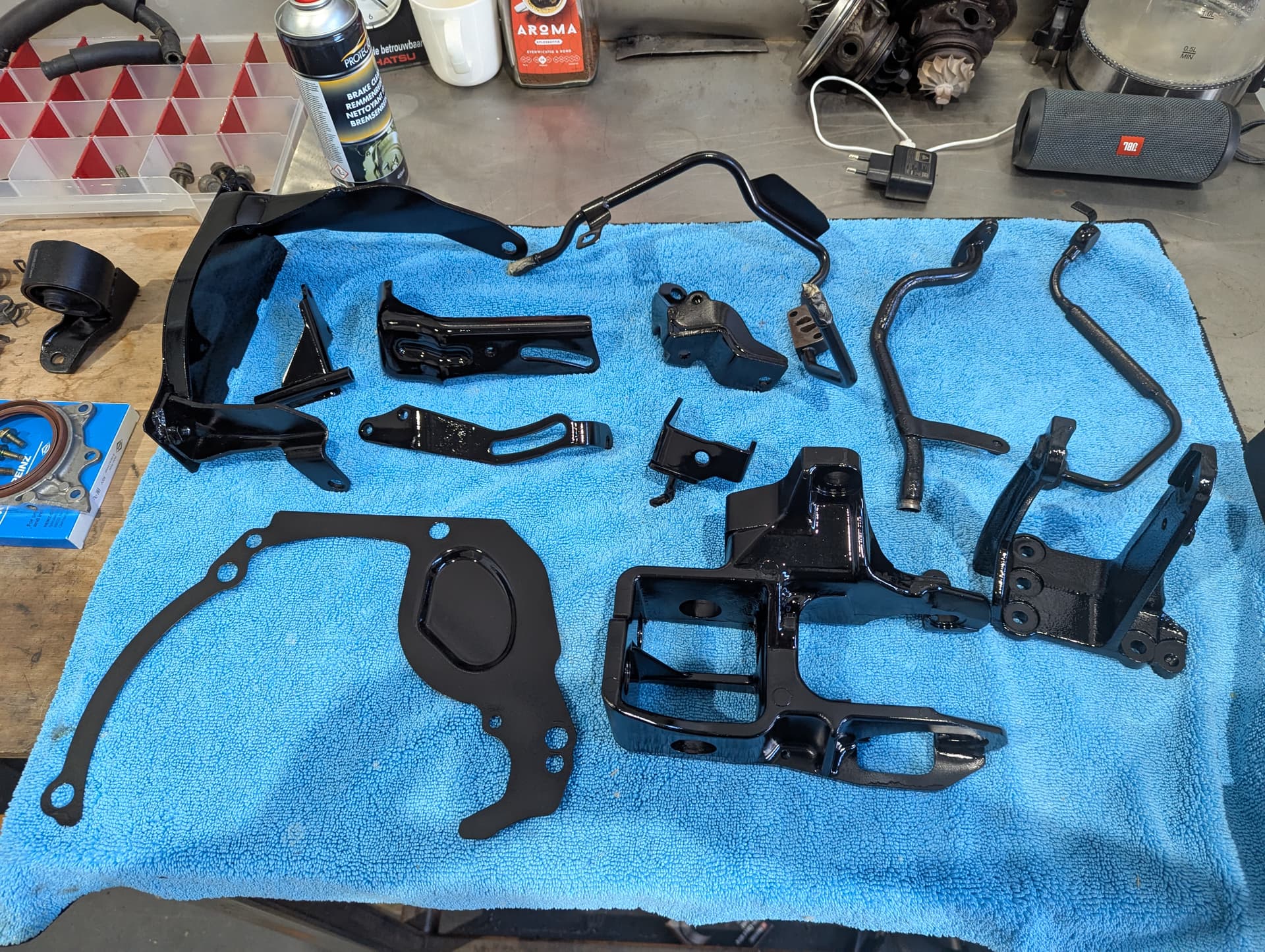

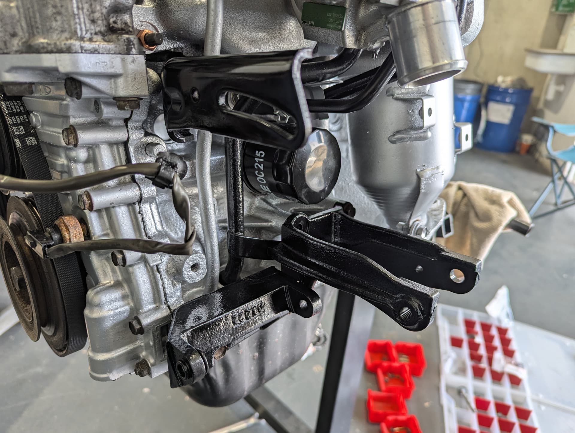

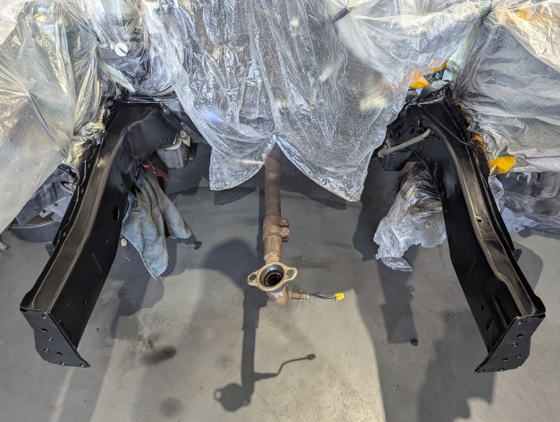

Cracked open some black paint
Still some brackets to go, but getting there.
Now it’s time to figure out what I want to do with the transmission casing :man_shrugging:t2:
