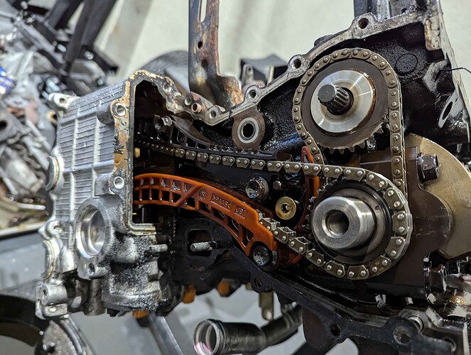

The intake manifold is off. I was looking for how to get the tension of the chain and started to remove the chain cover.
I came to the realisation that the oil pickup is bolted to it from the inside… So I had to remove the oil sump first.
Oh well, here’s a look into the engine so far.
