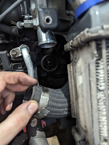

This boi was due for an oil change (again).
Daihatsu, why did you make it so difficult to change the oil filter.
I’m aware Daihatsu uses a special tool and a certain height filter to fit it through the engine mount.
But my old filter did not fit through the engine mount… So the bumper, the airbox and the turbo to intercooler hose had to come off.
It’s certainly not ideal.
As usual, I fitted a magnetic sump plug.

If you use the z443 it will just fit through the engine mount. The z 386 does not. I felt this pain once or twice doing the oil filter in a copen.

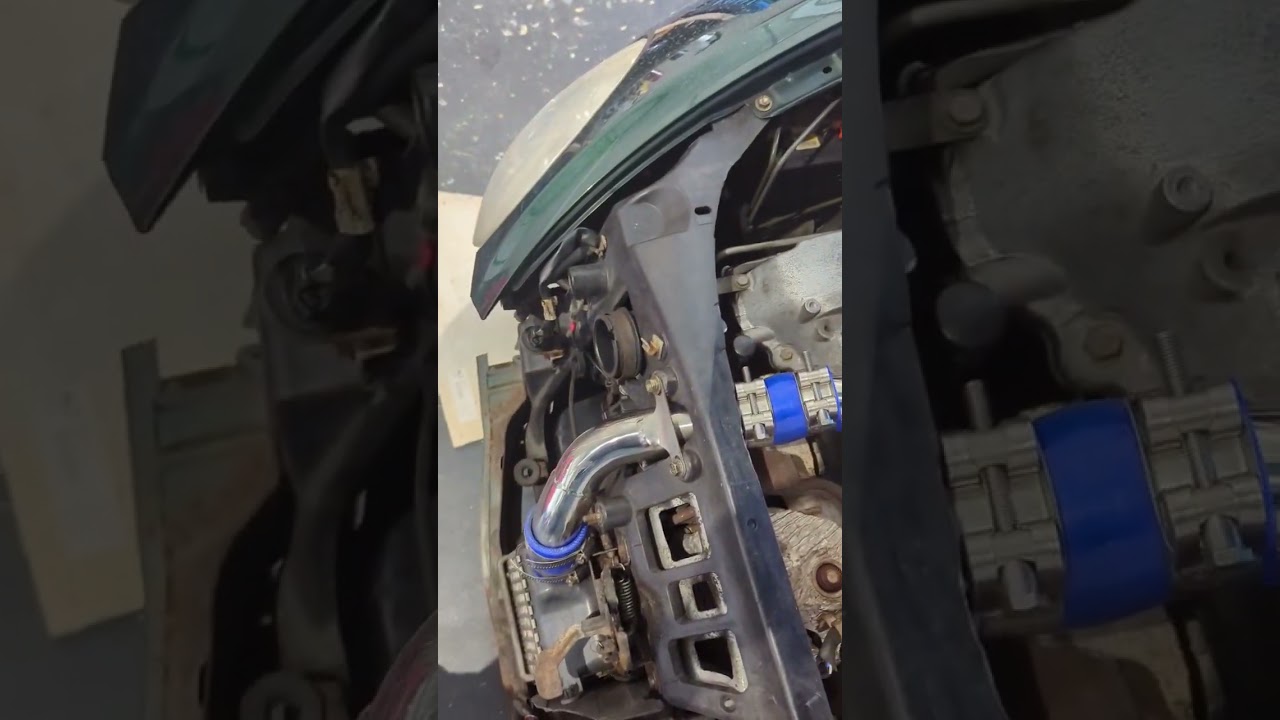

Okay so this damn engine is out. A lot of rounded and stripped bolts have been tackled. Sadly it was all previously ugga-dugga-ed in with no regard for the next person. We squeezed out the engine with the side engine mount still on because the bolt was just rounded and we had no space to weld a nut to it or anything.
I broke an inner CV joint while pulling an axle too. And maybe we forgot to disconnect the last bolts of the shifter mechanism which might have been slightly bent now…
Anyways, it’s out. That’s the important part. I’ll get it in the engine stand to start removing the head. I’m the meantime I’ll order new engine mounts, the necessary bolts and look for a new shifter mechanism.
