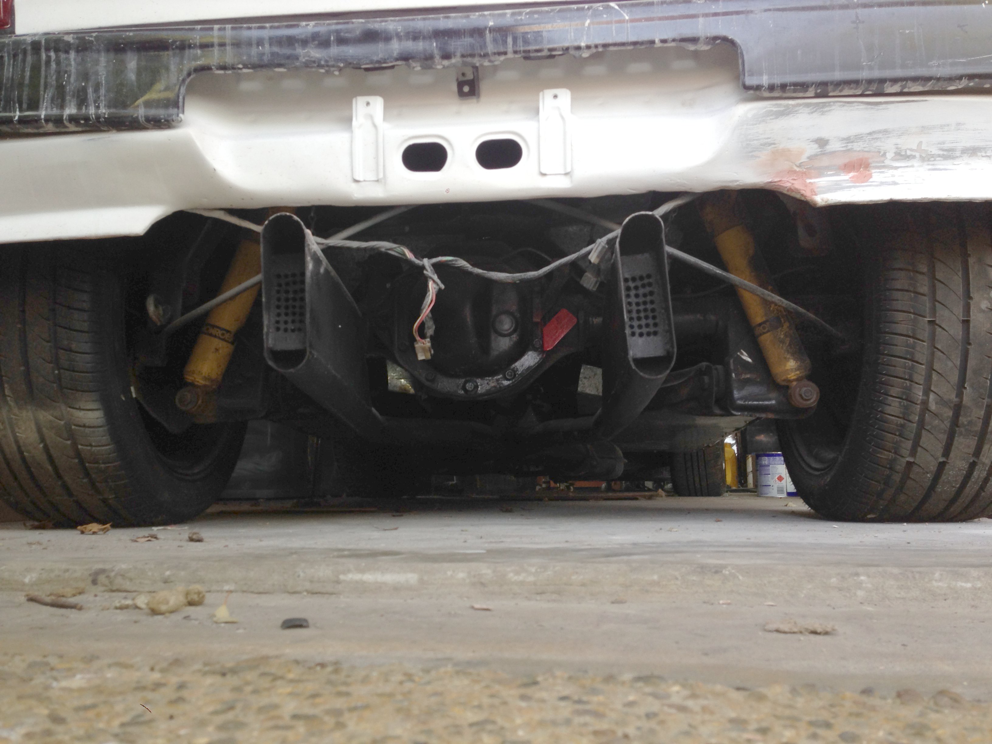

Finished the exhaust off today . Didn’t expect it to quiet it done so much, but happy with the result. Need to cut and twist one side to make it look right

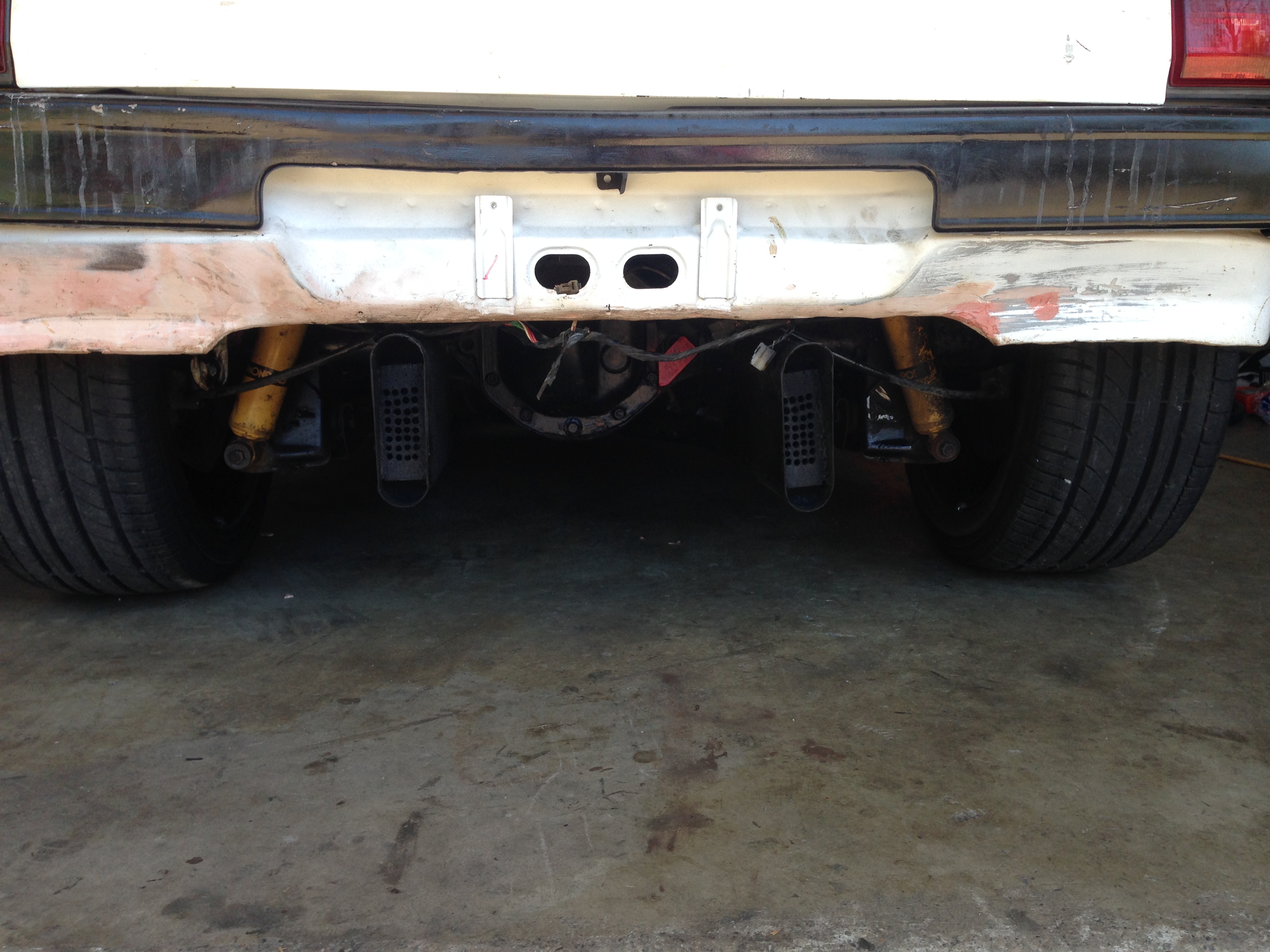

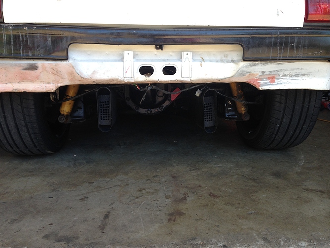

Pic of the rear end :slight_smile: Need to straighten the right side up before it drives me insane
anybody want any pics of anything let me know

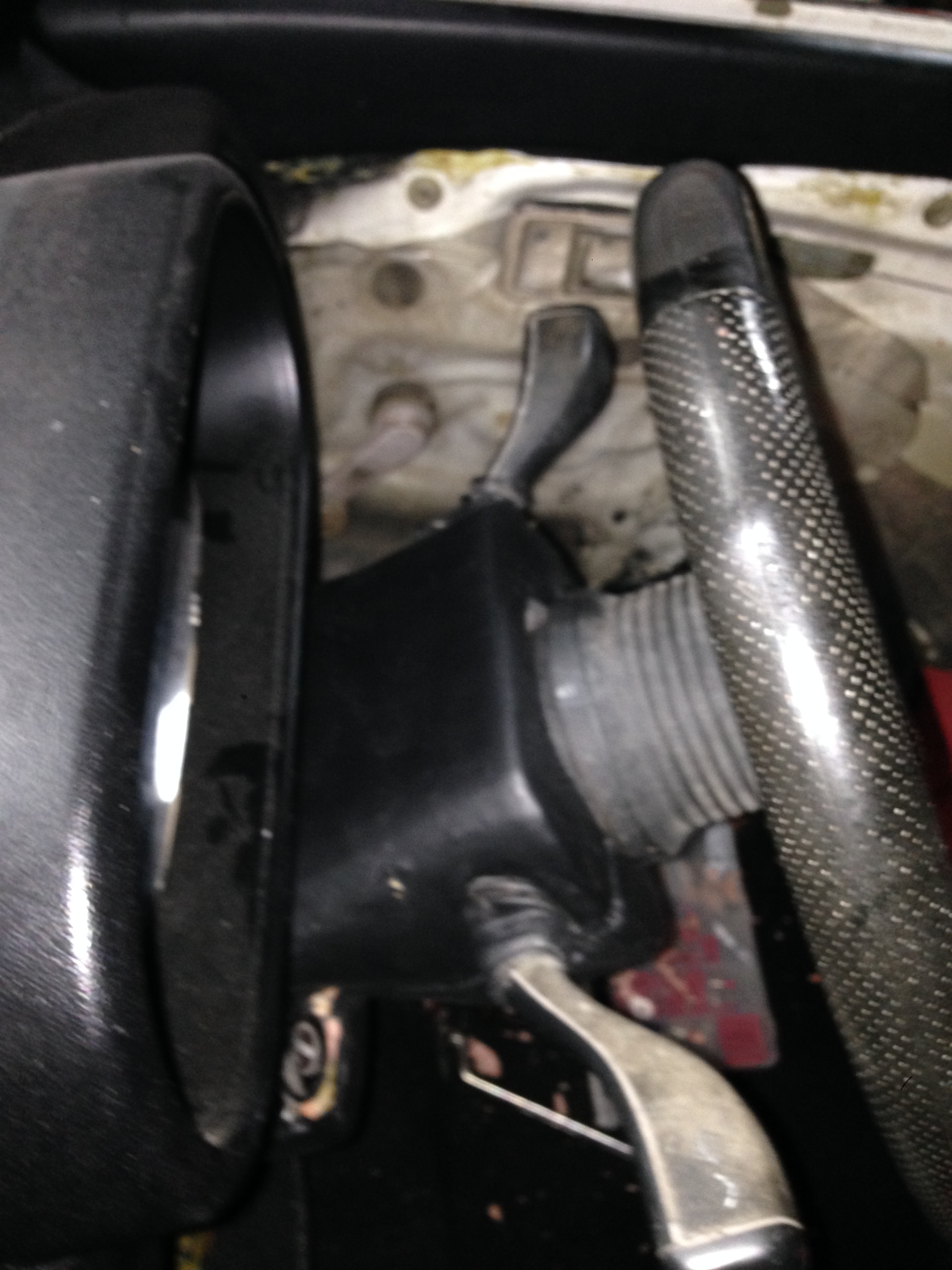

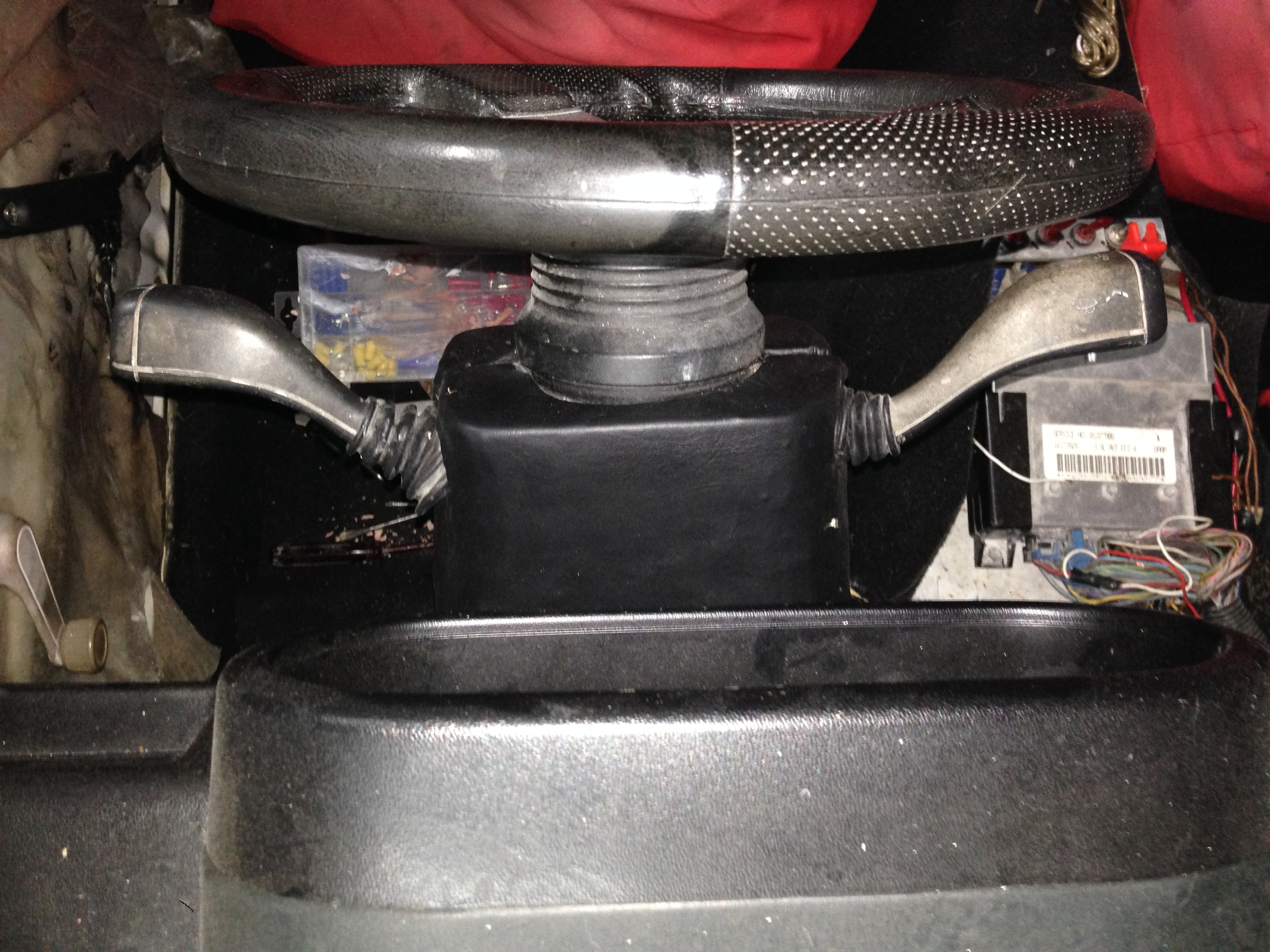

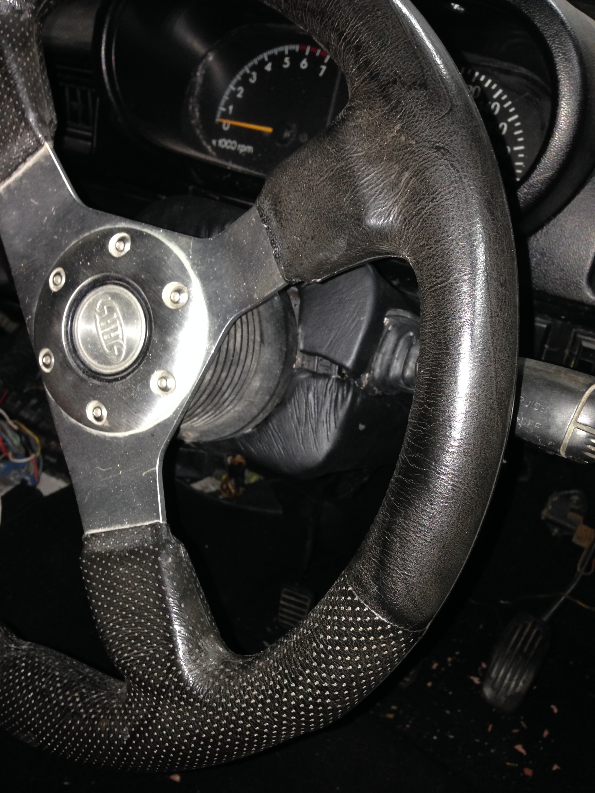

Done the shroud for the column. Ended up wrapping it in the black vinyl i’ve been using for the rest of the trim :slight_smile:

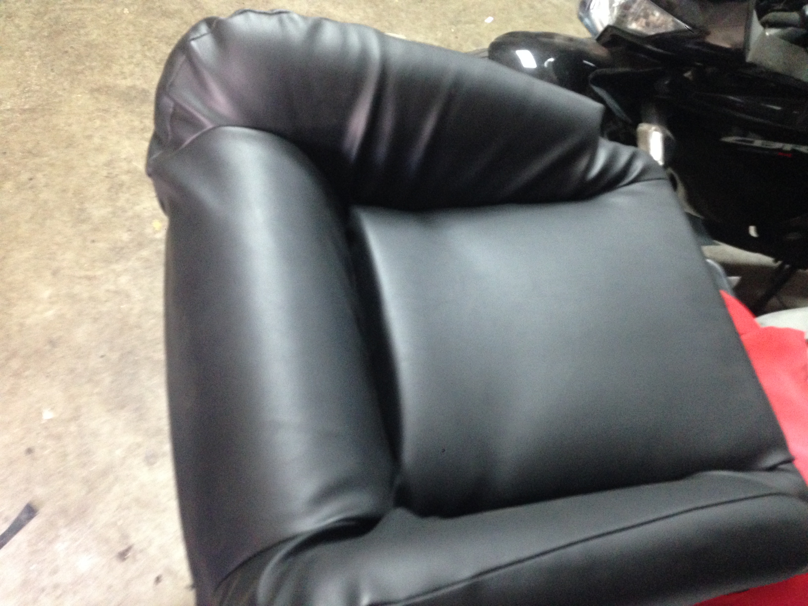

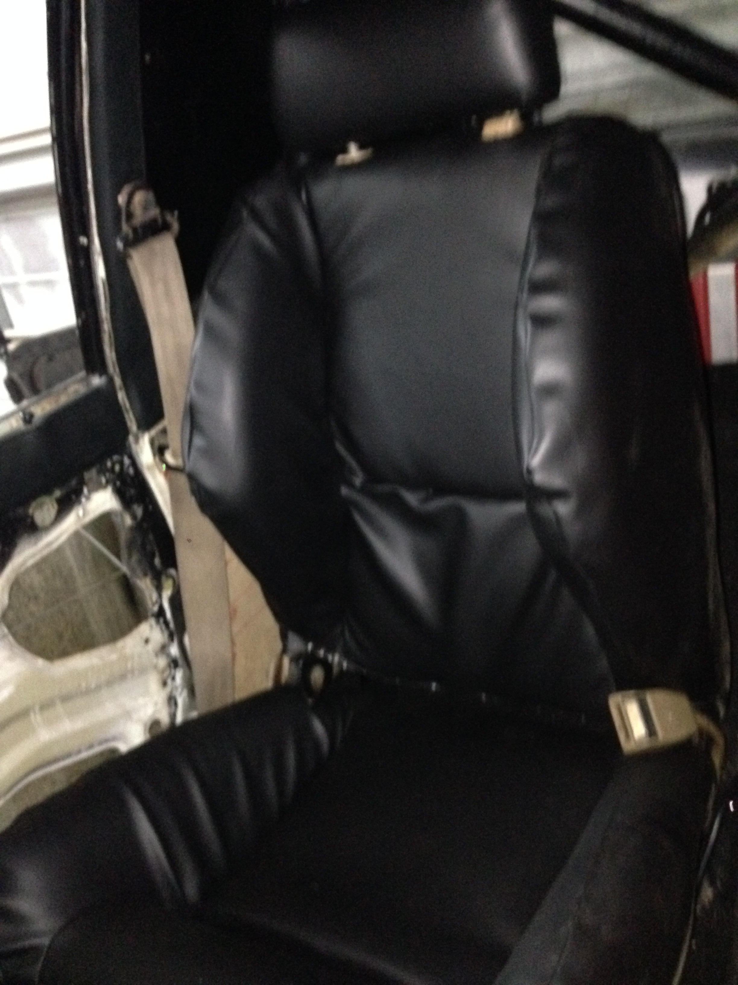

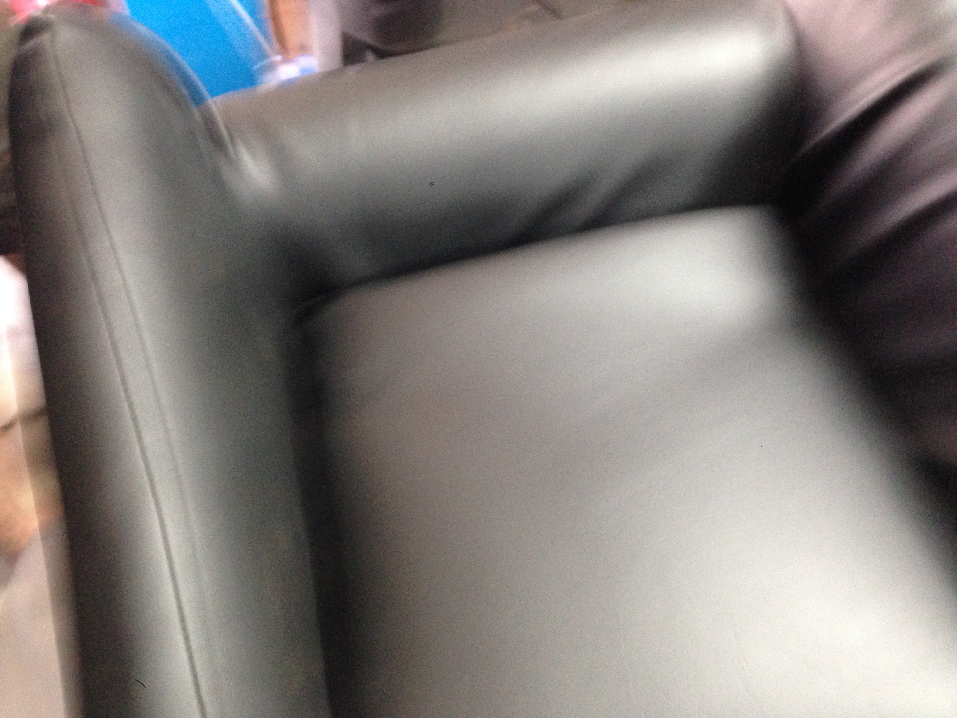

Got my sewing machine :slight_smile: and have started the seats .
Bolstered it up a little bit to hold me a bit better, not too bad from stock seats
Still need to pull it around a bit more to get a few wrinkles out, not too bad considering it’s been over twenty years since Ive sewed anything :blush:

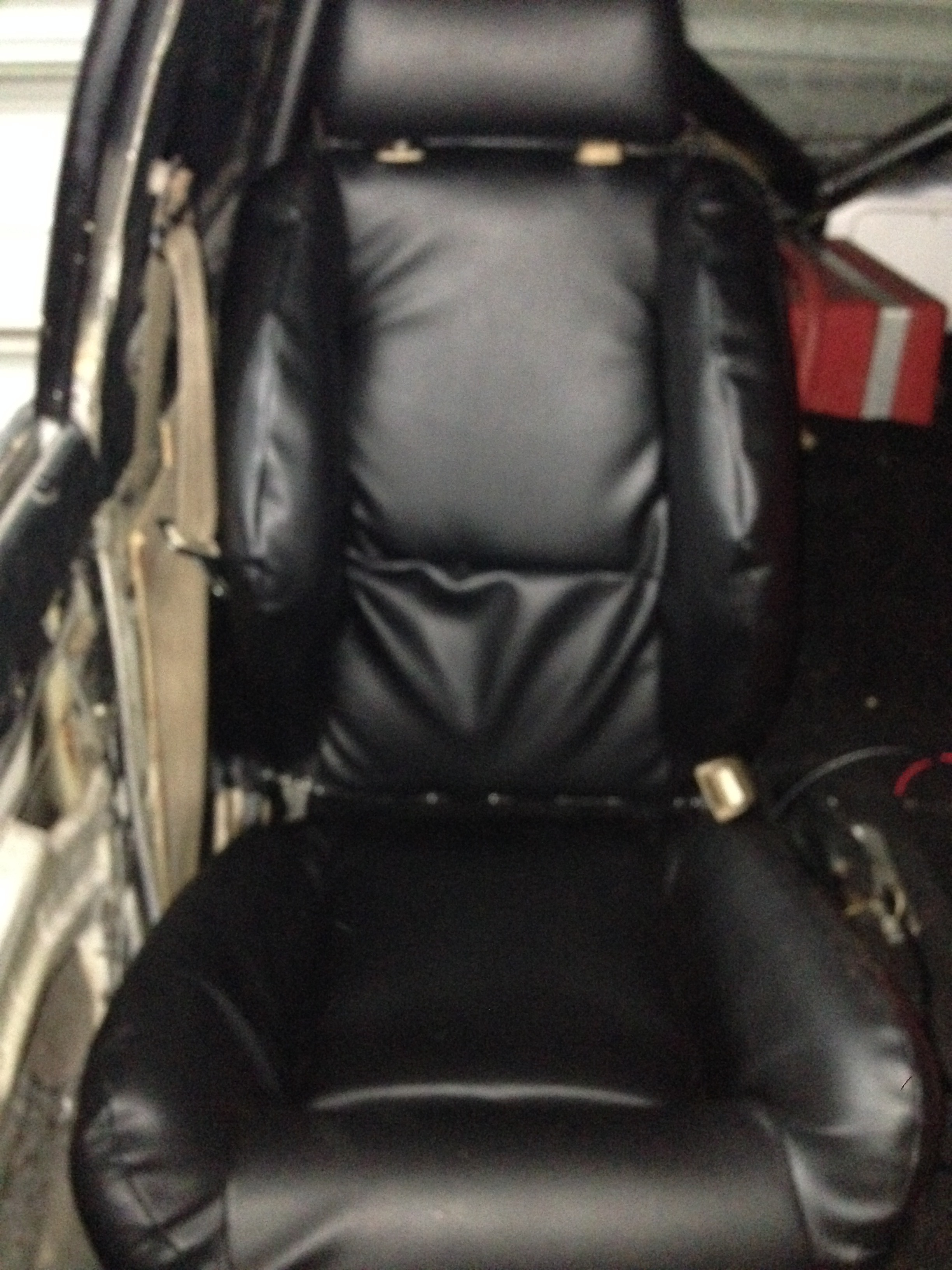

Seems to be a little better then the stock seat :slight_smile: Added a fair bit of foam to bolster everything up.
Holds on pretty well too :smile: Have to hit it with a hair dryer and get some wrinkles out
Now to do the other side

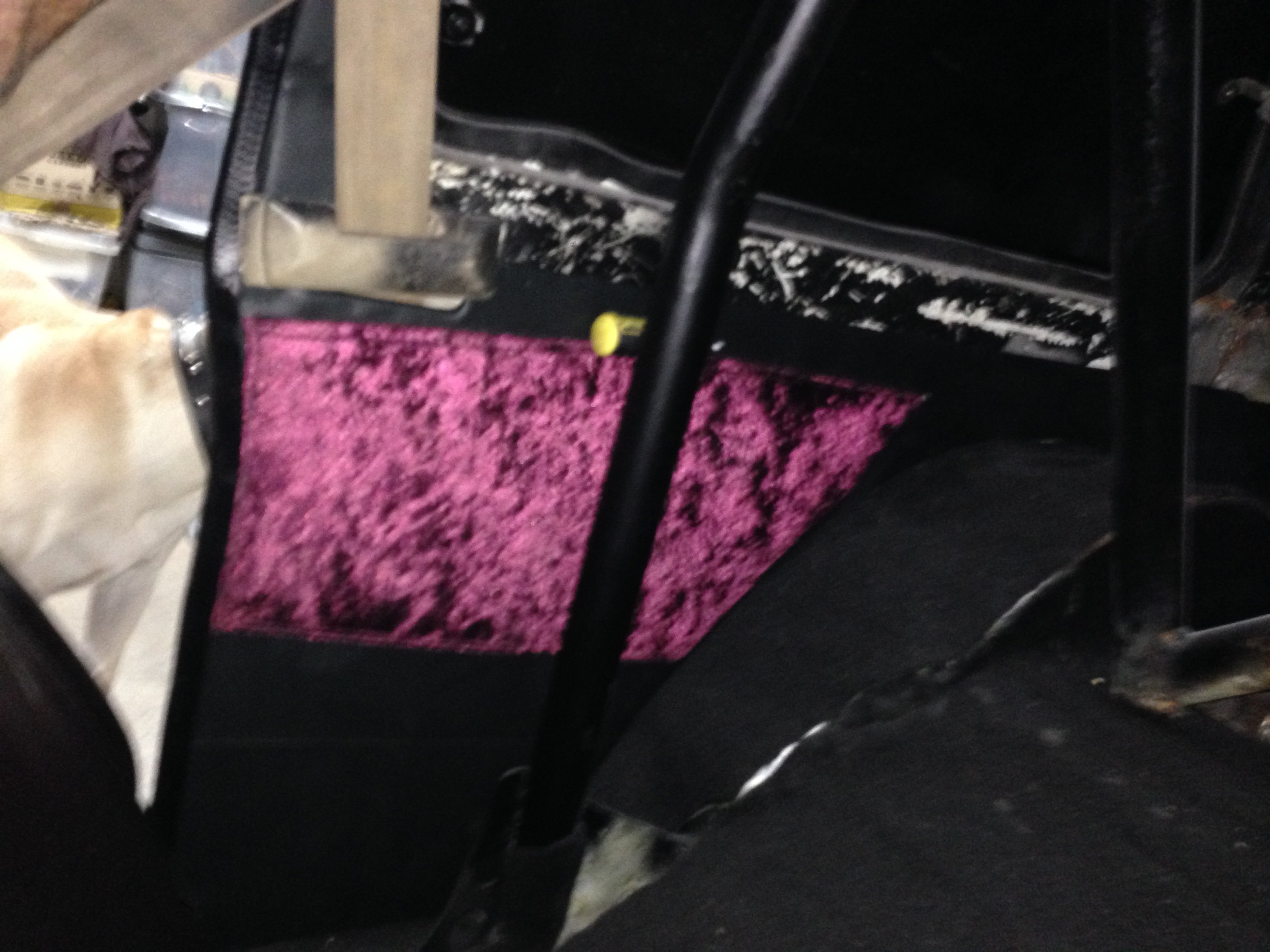

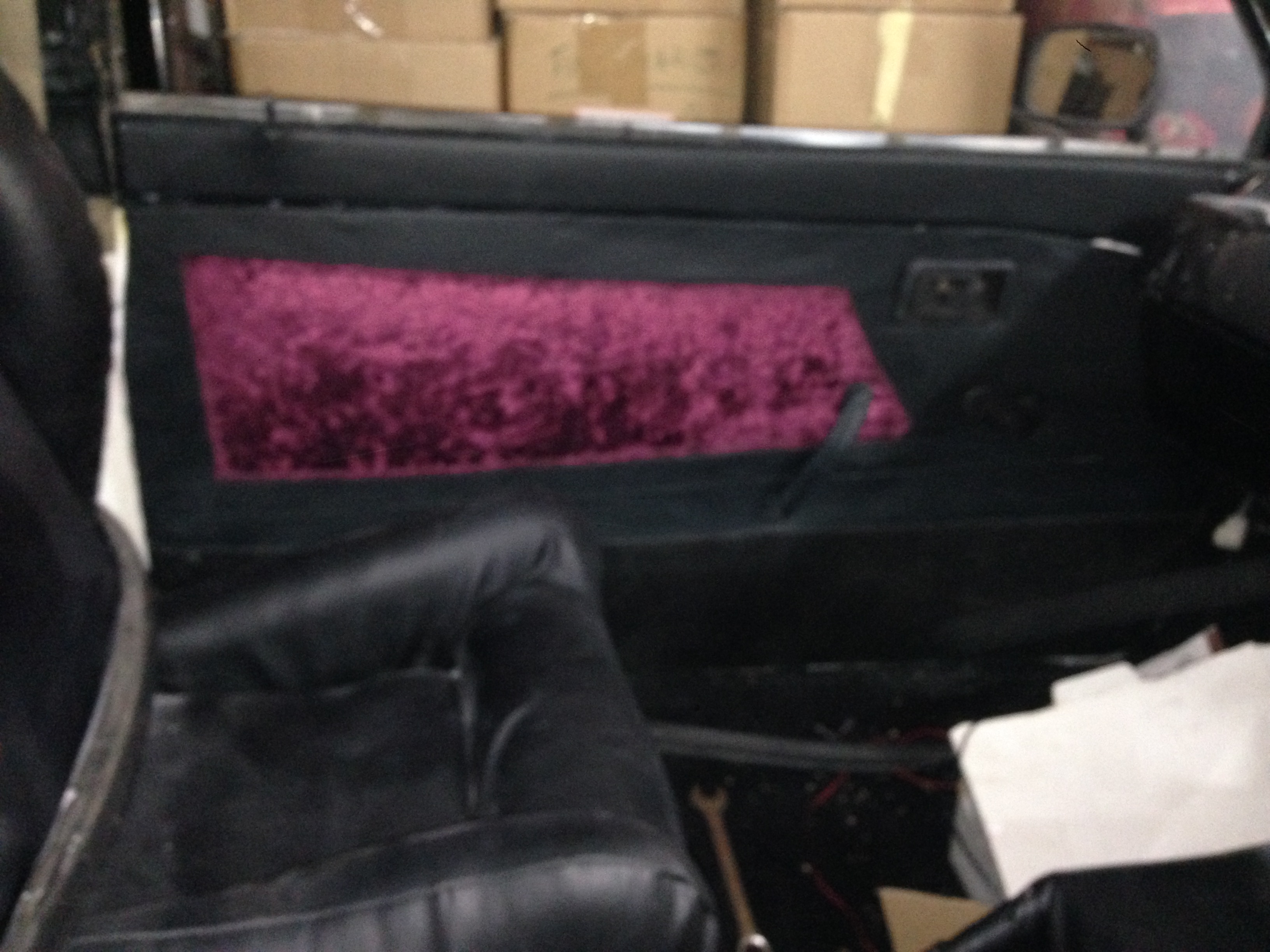

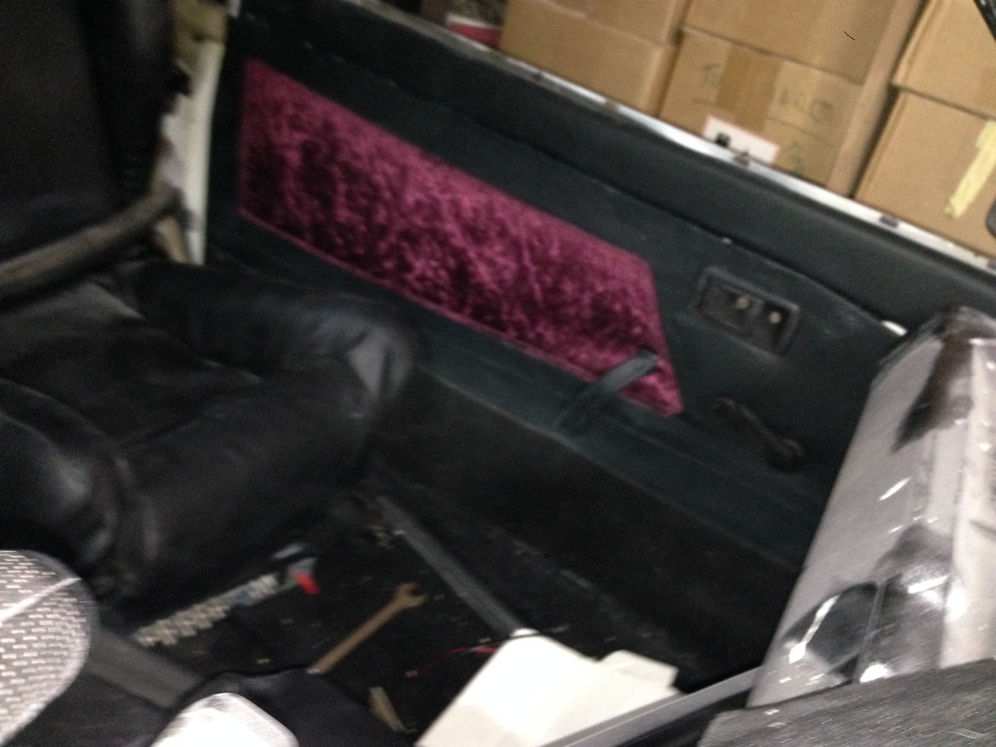

Anyway got around to doing some trims :slight_smile:
![Img_0244|666x500]
Got to rip the seats out and redo the centre with this fabric

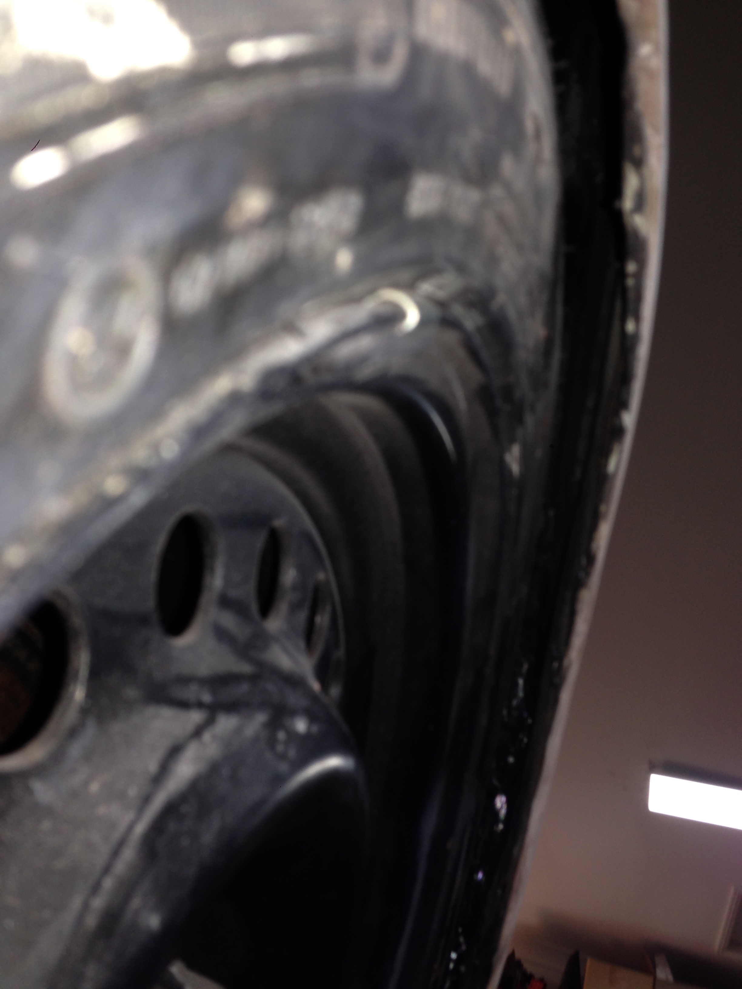

Pic of the rear end :slight_smile: Still need to straitening the exhausts. And the clearanece around the rear tyres.
