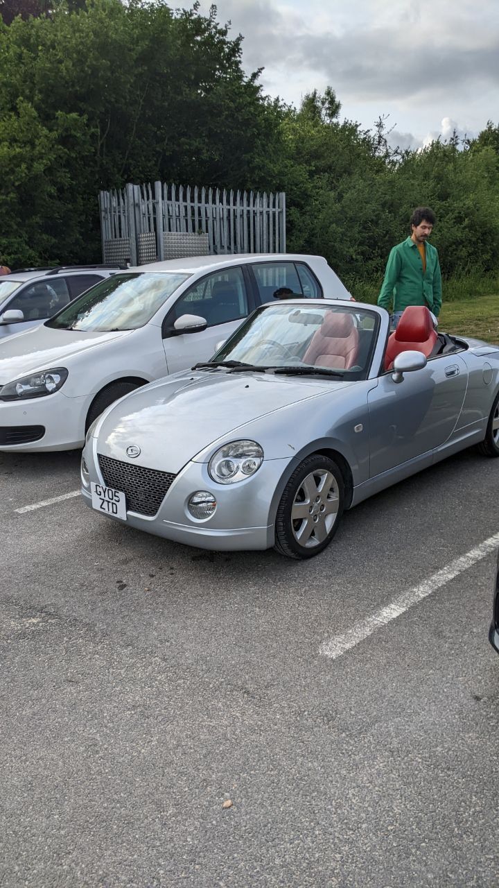

This chap had recently bought his Copen and it was in lovely condition. It has the JB-DET engine and manual gearbox, thought a lot of the engine bay parts were very familiar from my Sirion. He was meeting up with another guy whose Copen has lost the battle with rust and the two of them spent a solid 2 hours swapping the tonneau cover for the folding hardtop between the bad car and the good.

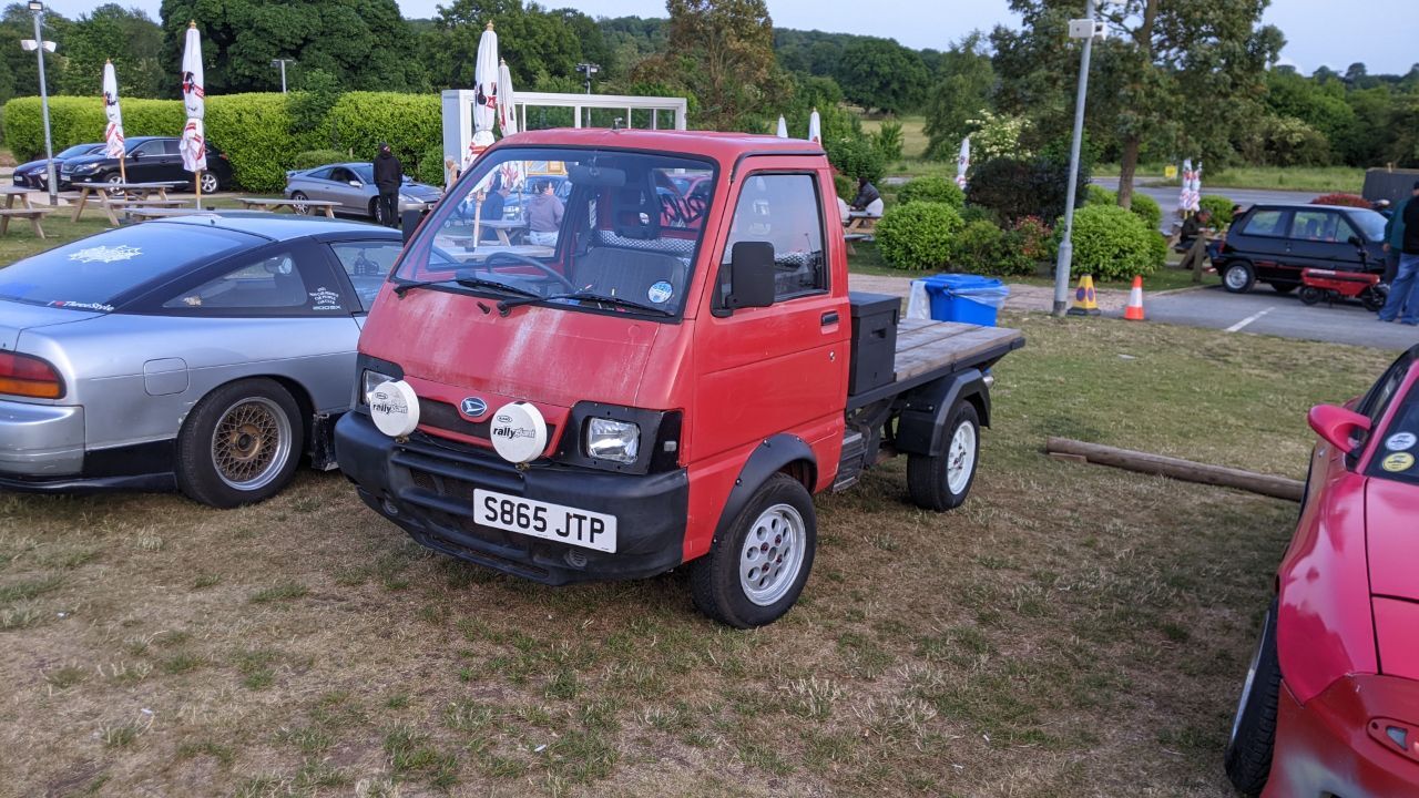

The other Daihatsu friend was a guy who brought this 1998 Hijet. It had only done 30k miles but was a bit cosmetically worn. He’d done a load of mechanical work to it inlcuding changing the hubs to accept 4x108mm Ford Fiesta mk2 ‘pepperpot’ alloys which I thought looked excellent. He gave my daughter a ride on the back round the field of the venue which she loved.
My Sirion got plenty of positive feedback even amongst some much more impressive machinery which was nice. Most of the cars there were daily drivers rather than show queens so my slightly ‘patinated’ car blended in just fine!
