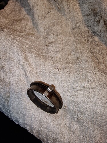

So ive been told on my ej-ve engine has 2 cam sensors, engine ive fitted only has one ej-de, i had already fitted the second one, but I’m guessing the trigger wheel on cam end is not fitted due to non vvt.
yeh that would be correct the ejde only has the one that is on the front or timing belt side and the ejve has the extra one at the back like what you have pictured.
We did not get ejve in Aus, I have the cams and solenoid but not the extra trigger on the back of the cam like what you have pictured. :frowning:
Oh dear.:grimacing: no going back.
So this is the inlet camshaft trigger wheel for rear camshaft position sensor. Tapped off really easy so going to disassemble engine to fit. Going to be fun. Yes I have marked it so i know which way it sits.

did the trigger wheel only go back on one way or did you have to get it in a certain spot etc for timing?
Had to be in a certain position.
was there markings? or did you have to calculate it so it was it the right degrees?
The lugs on trigger wheel all spaced equally, one lined up perfectly with casting mark on camshaft.
awesome thanks mate!

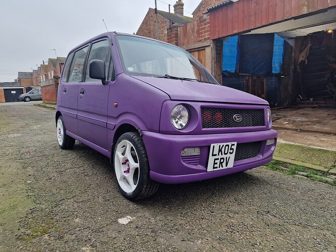

Progress at last, all 4 tyres mounted, one sanded and light coat of paint. Temperature in double figures, what a difference. The second picture is with flash, makes them look a brighter white than I think they are.
One side matches, just one wheel to refinish now. I think this could make it in for mot before the daily.
A few more pics.
All 4 now fitted. Arch gap needs to go.
