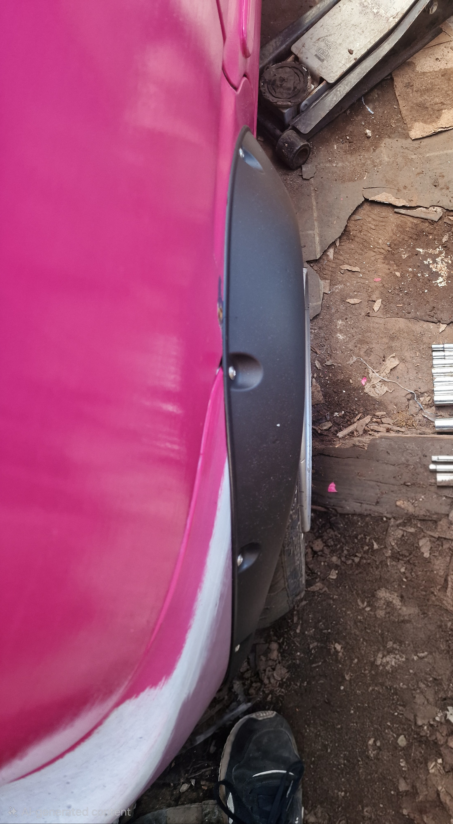

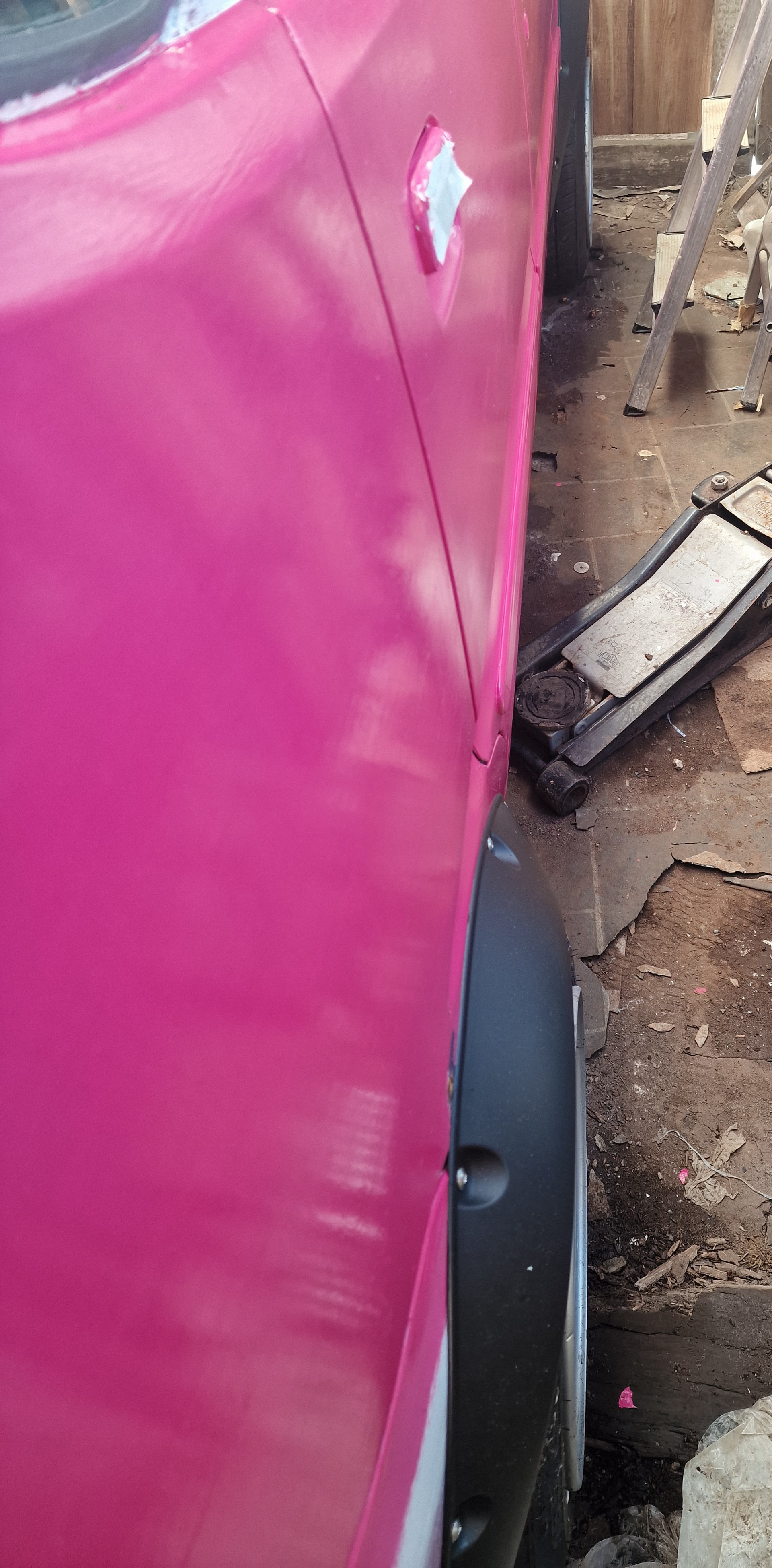

More paint.

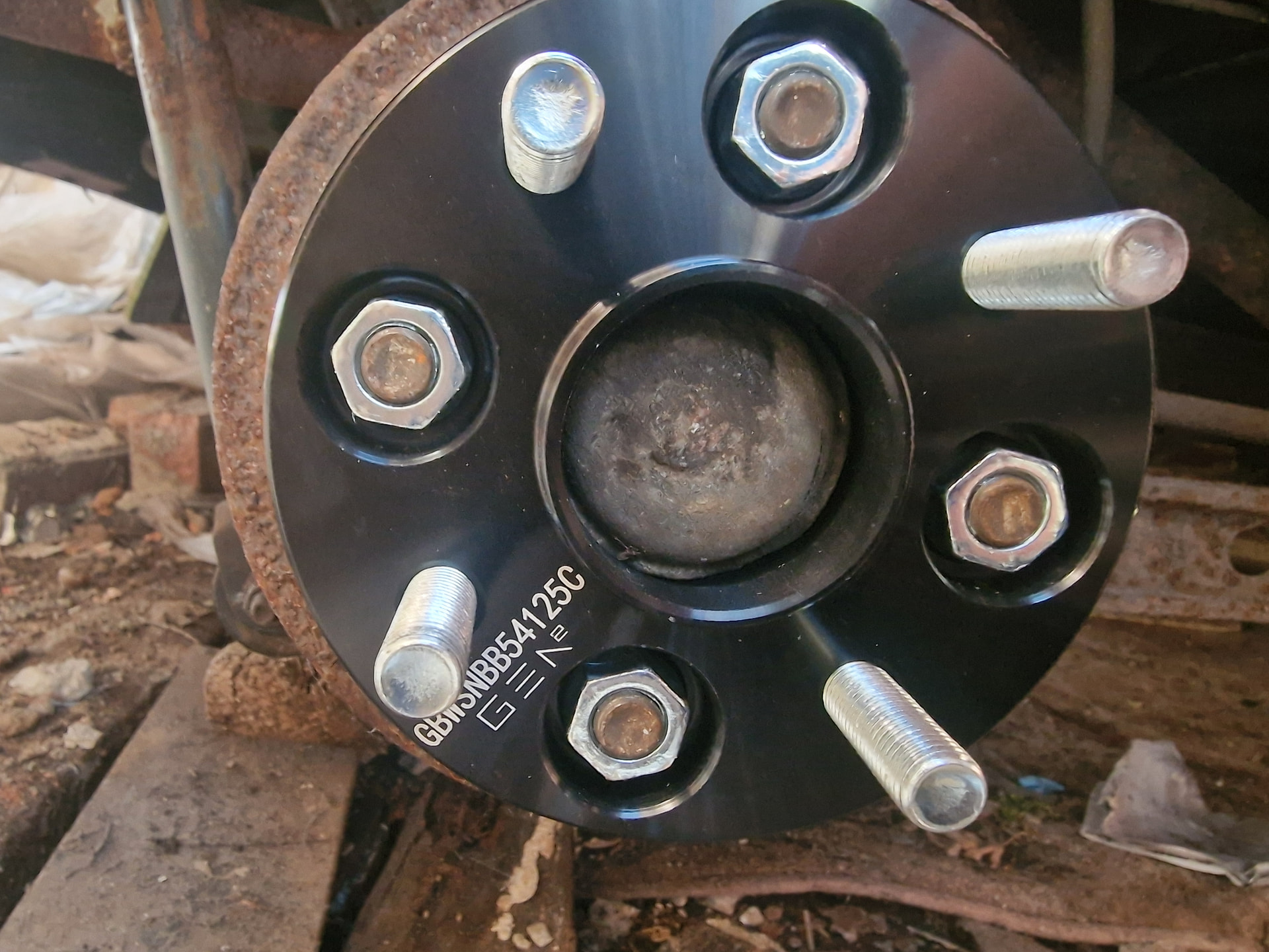

Forgot to put wheel spacers fitted.

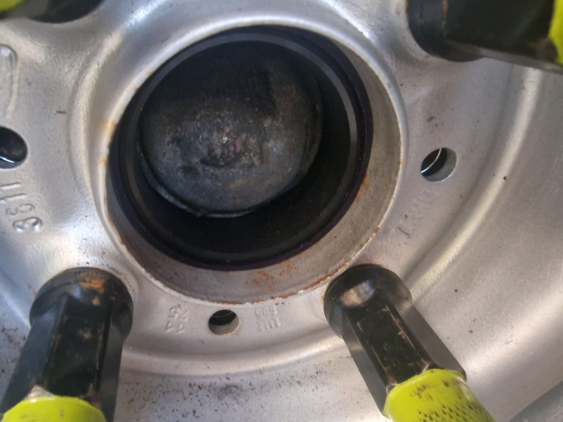

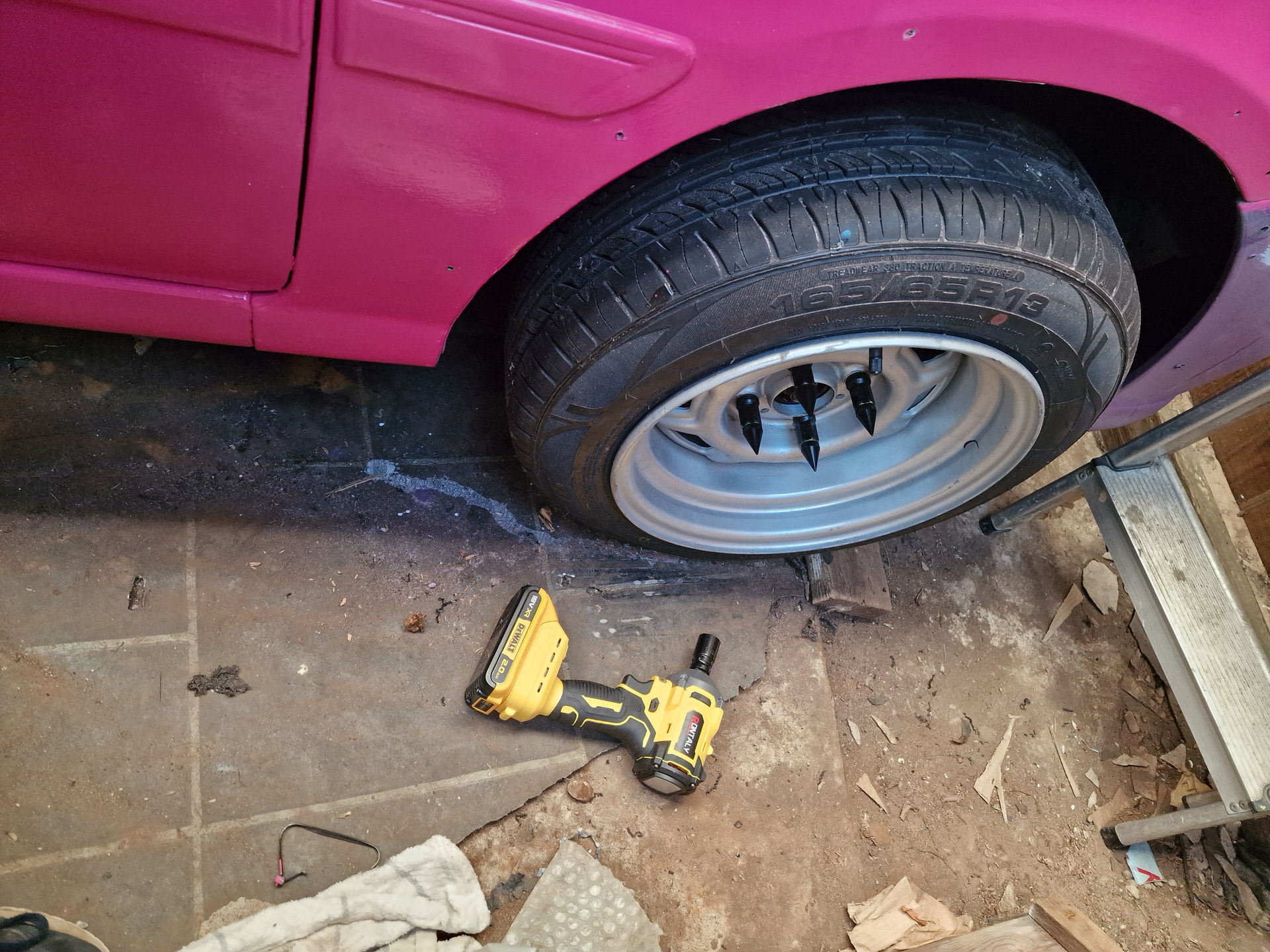

Hubcentric spacers, 4x100, 54.1cb, 25mm spacer. Wheels have 57.1 to 54.1 spigot rings. Arches need repositioning, and ideally a bit lower, but need to be driven.

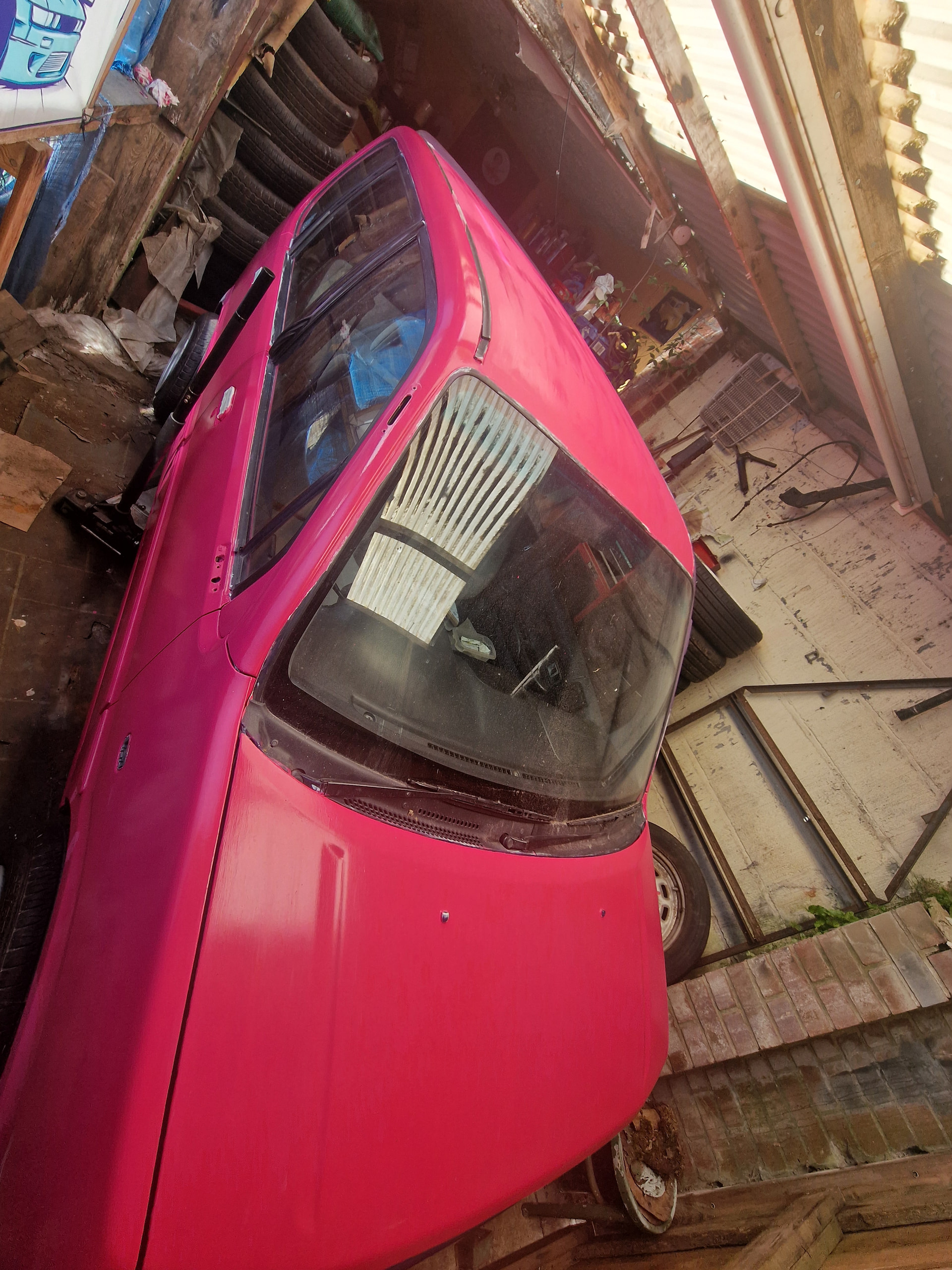

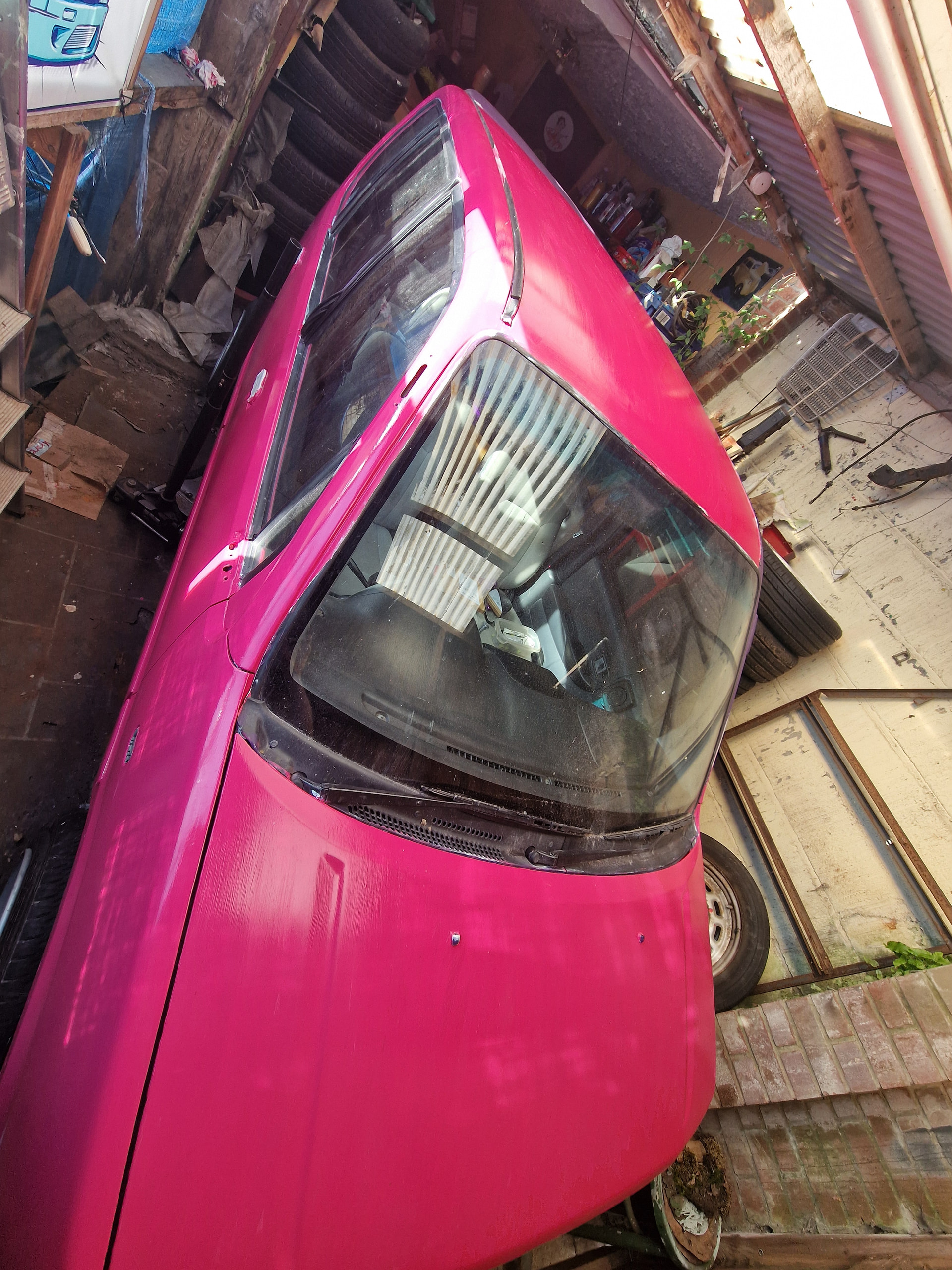

Slowly getting there, but not so much of a mind distraction now.

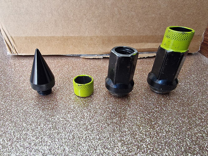

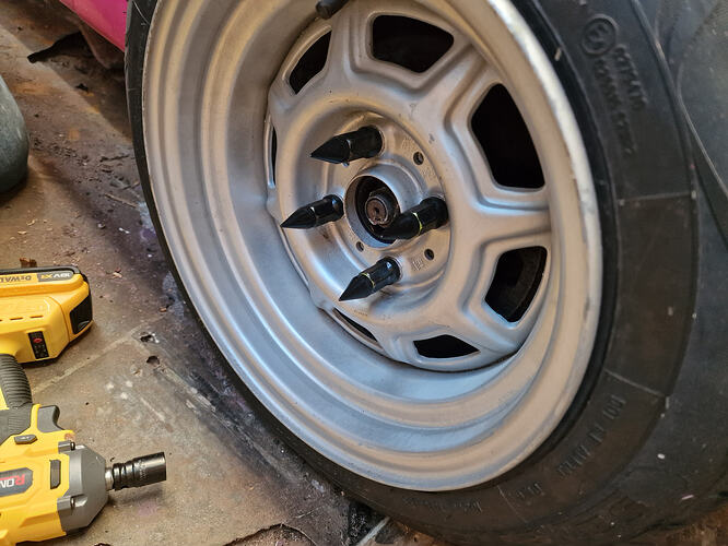

Steel lugnuts cut down, and cheapo spikes added.
I’m suspecting, one of your ancestors once rode a chariot in Rome which was reponsible for destroying the wheels of other chariots, during races?
