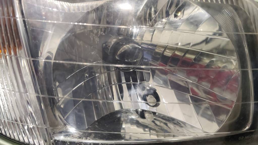

front LED H4 projector install

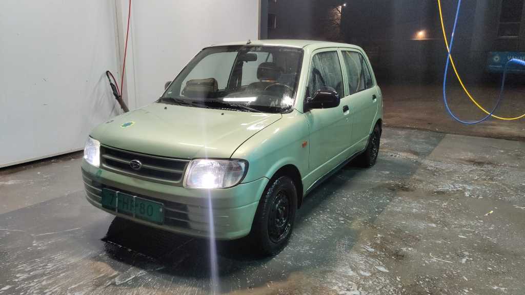

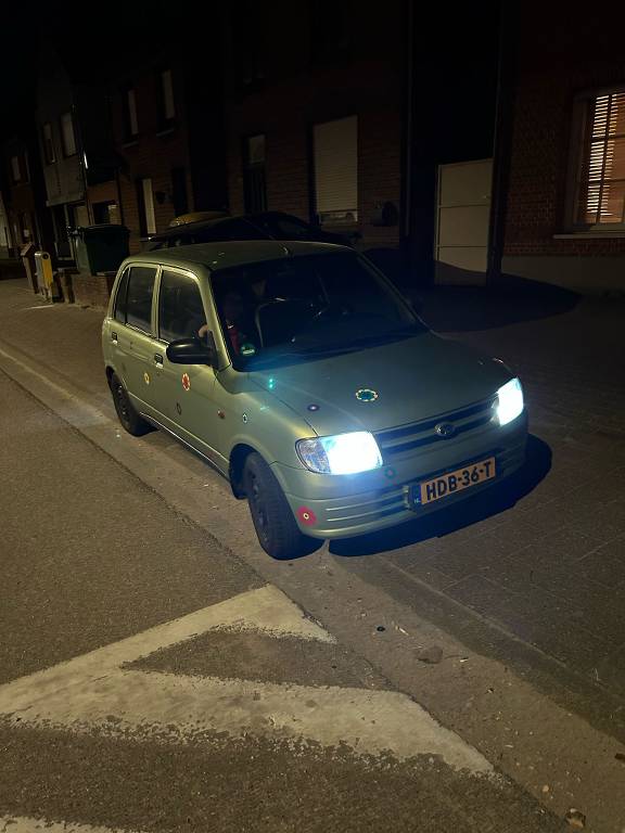

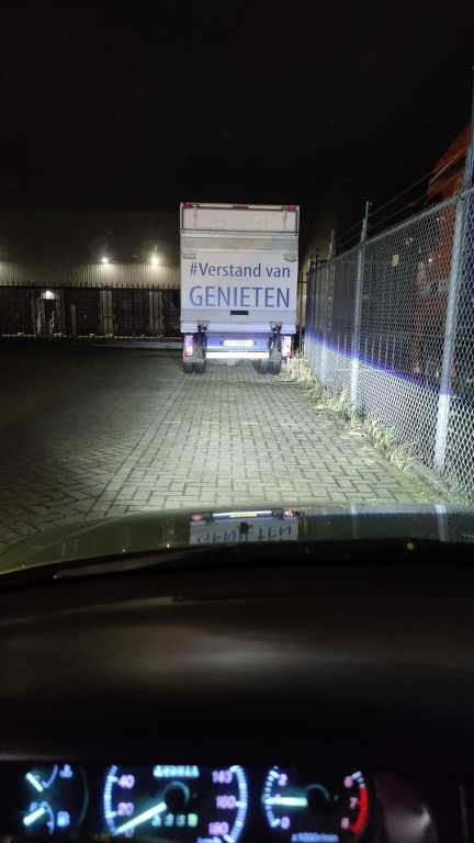

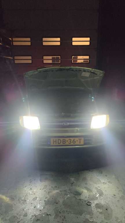

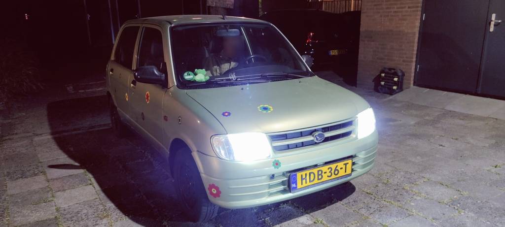

Same as the 276, I did the headlights upgraded to LED projectors they pass inspection so I can leave them in and a lot more brighter than halogens

What’s the LED projectors you’ve used there, they seem to fit quite nicely. Definitely would be an upgrade over halogens.
(currently my unknown age H3 halogen fog lights are brighter than my H4 main globes)
They are Stella H4 led projectors from Aliexpress.
They are originally for motorcycle so they are weather and vibrationproof. Not cheap but, reliable ones and bright like the new gen cars.

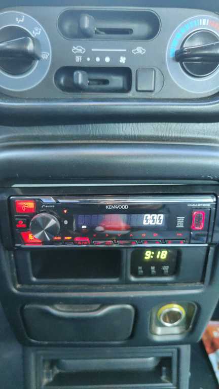

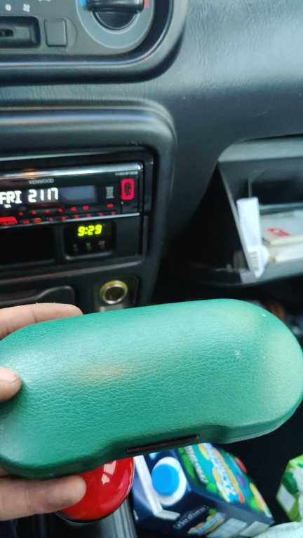

Did some modifications on the midconsole:
Before I started I made a third key just in case. So I got 3 keys

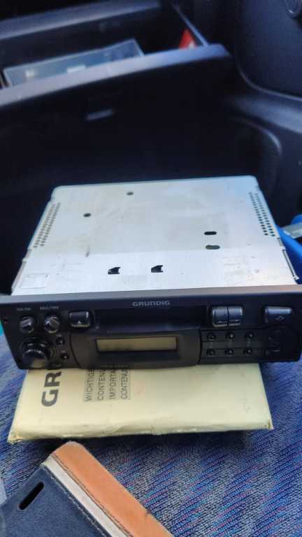

Removing the old oem casette radio, nothing wrong with it just need bluetooth. Will put in my oldtimer

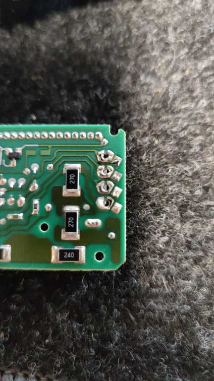

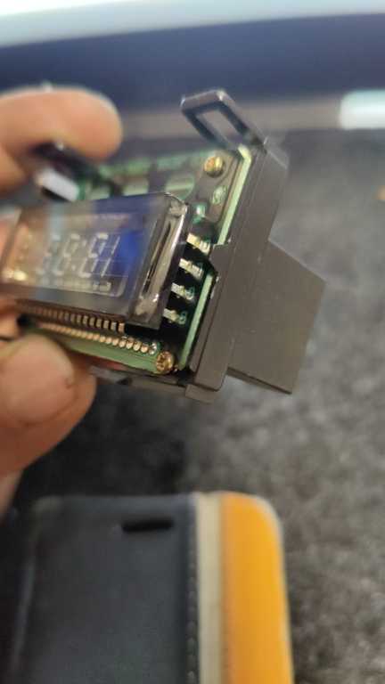

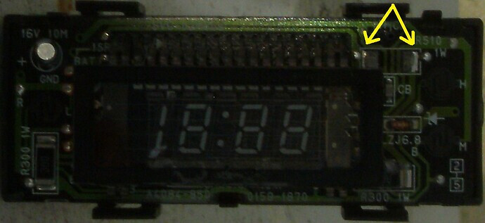

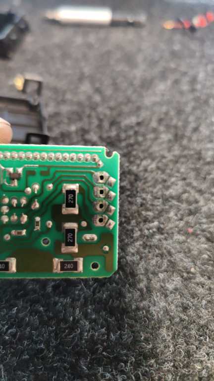

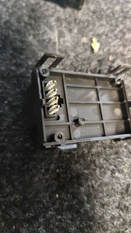

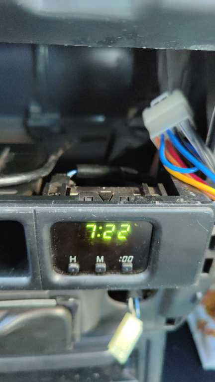

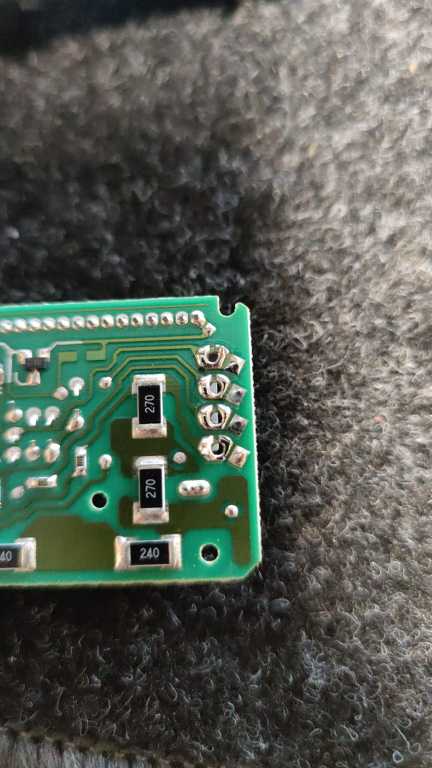

Clock is acting up weird sometimes it turns itself off:
Soldering points just old:
Installed new radio and working clock without intermittment.

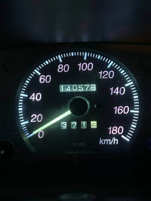

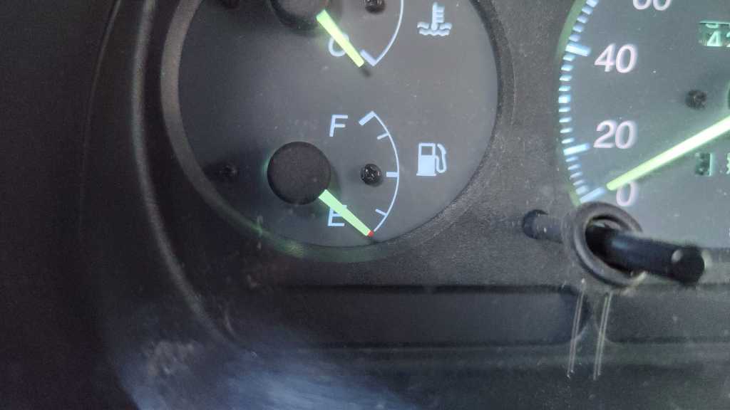

Put fuel again in it, 33.9L and no more.
Its 40L so 6-8L left when hitting the red

[quote=“enshiu, post:18, topic:7000”]…Soldering points just old…[/quote]
The same company probably made clocks for Suzuki also. One of those electronic bits detached from my Suzuki’s clock. I ended up soldering-in a traditional resistor, because I wasn’t certain if heating the original at soldering would damage it. They must have had initial problems with solder baths
Also Lexus, Toyota, Mazda, Subaru and Mitsubishi.
Funny thing is my 1996 Camry clock still works no soldering done
