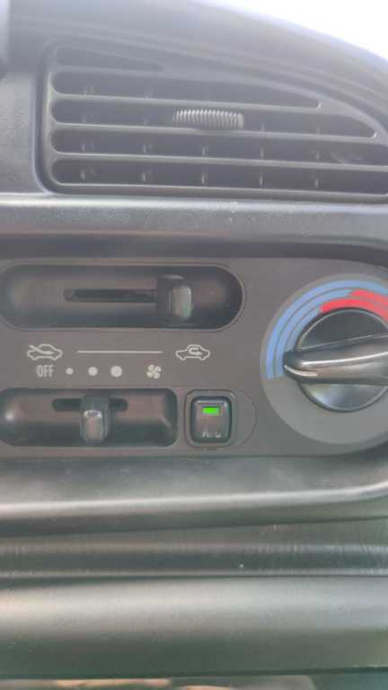

A/C woes.

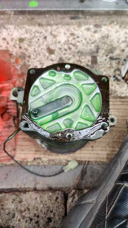

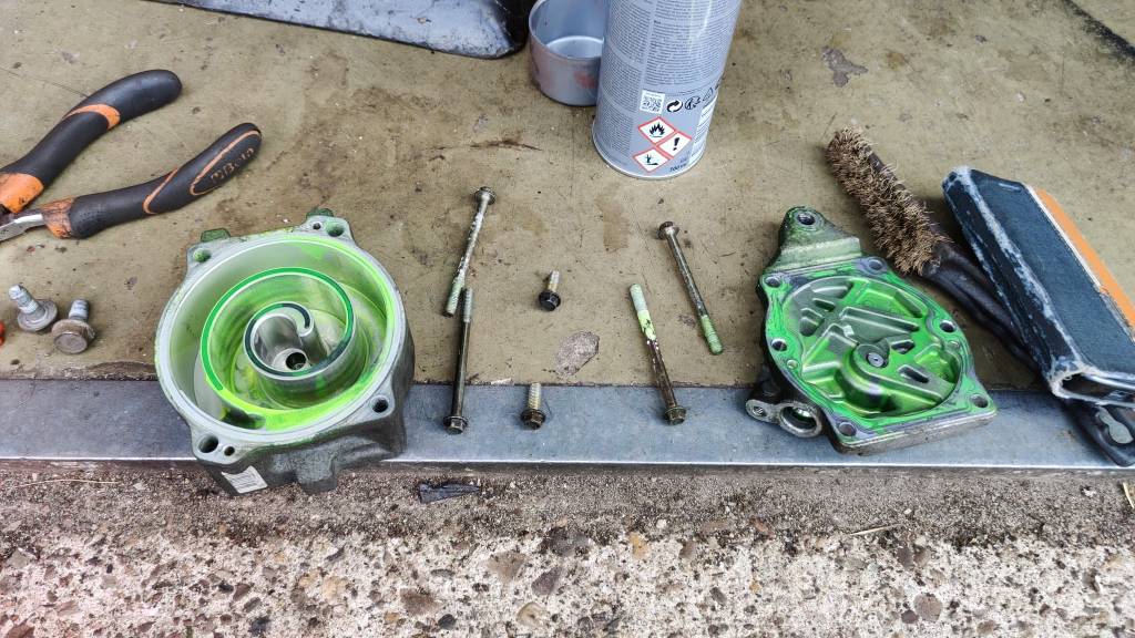

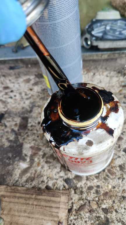

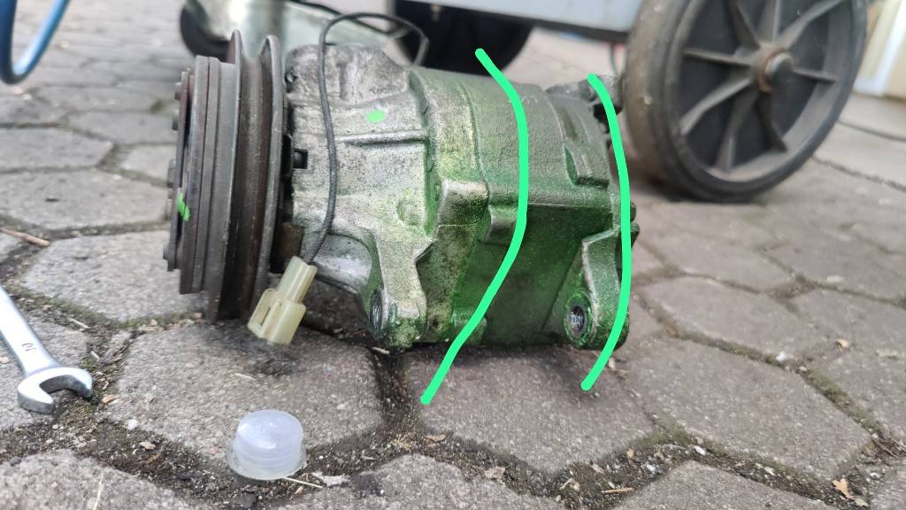

Now its almost gas tight and the AC clutch gives up:

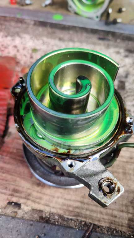

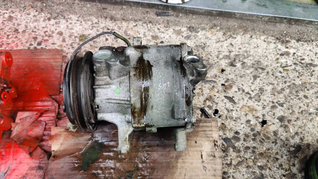

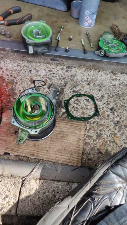

Fixing the seals of the A/C pump
Lets see what will happen:

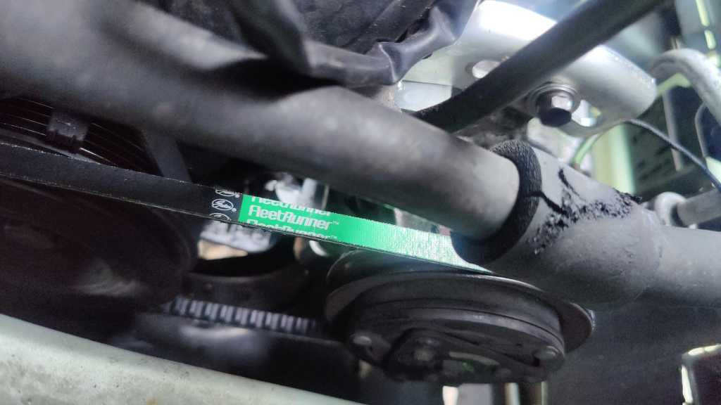

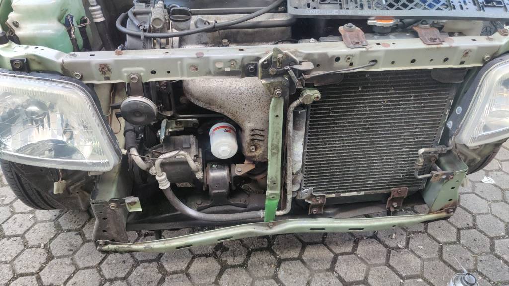

One hard line seems to be kinked will need to replace it.
Its on over pressure …
Made some pictures:
ordered new drier filter from Kavo parts.
Its clogged
