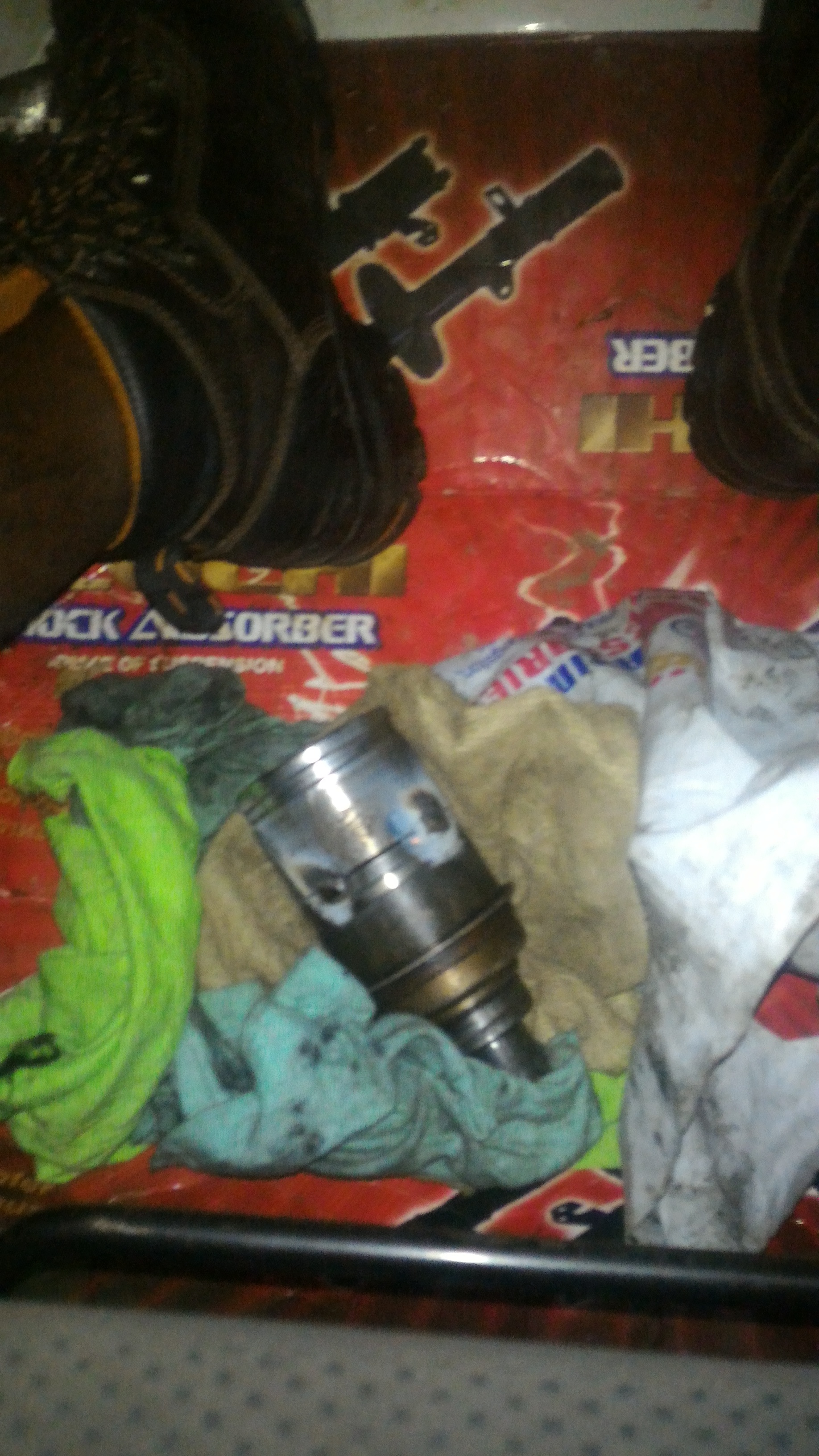

The long side is the culprit. From it happened all I can remember is you pointing out how the axle behaves under load. With using the EJ gearbox I had to use a longer axle and it was resplined without being re hardened. It’s at the point that all this happen I’m being directed to what machine shop might had been able to reharden it

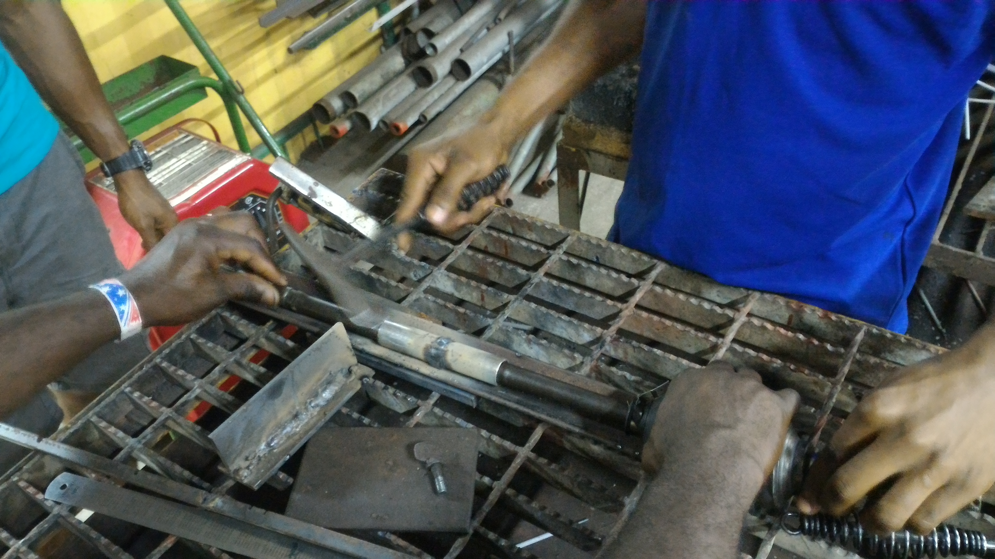

Now when all this happened it was a public holiday; close to the end of the raceday trying to find a solution to get my car home as wrecking was not an option. There were was a machinist at the meet who pointed me to a welder who called a friend to open his shop and give me a hand.
A fabricator who was a part of another team helped me rig this up to get going.
We used the stock long axle; provided by a friend who lived in the area and two 3/4" sockets were fitted to the axle and welded.
I think a “cut and shut” axle would be better than the “un heat” treated resplined one. It would matter what steel was used too.
cut and shut…meaning and axle that’s cut and joined with steel?
Im wondering if I need thicker axles though also
Yes cut and joined with a tube.
A thicker axle may mean you keep breaking them through the spline. Big chunky ones won’t flex. A bit of flex/twist will filter out torque spikes. If I remember I’ll look up Carroll Smith’s Engineer to Win which has some info on it (or is it Race to Win. I know it’s not in his book Tune to Win as I have that here and it was not in it).

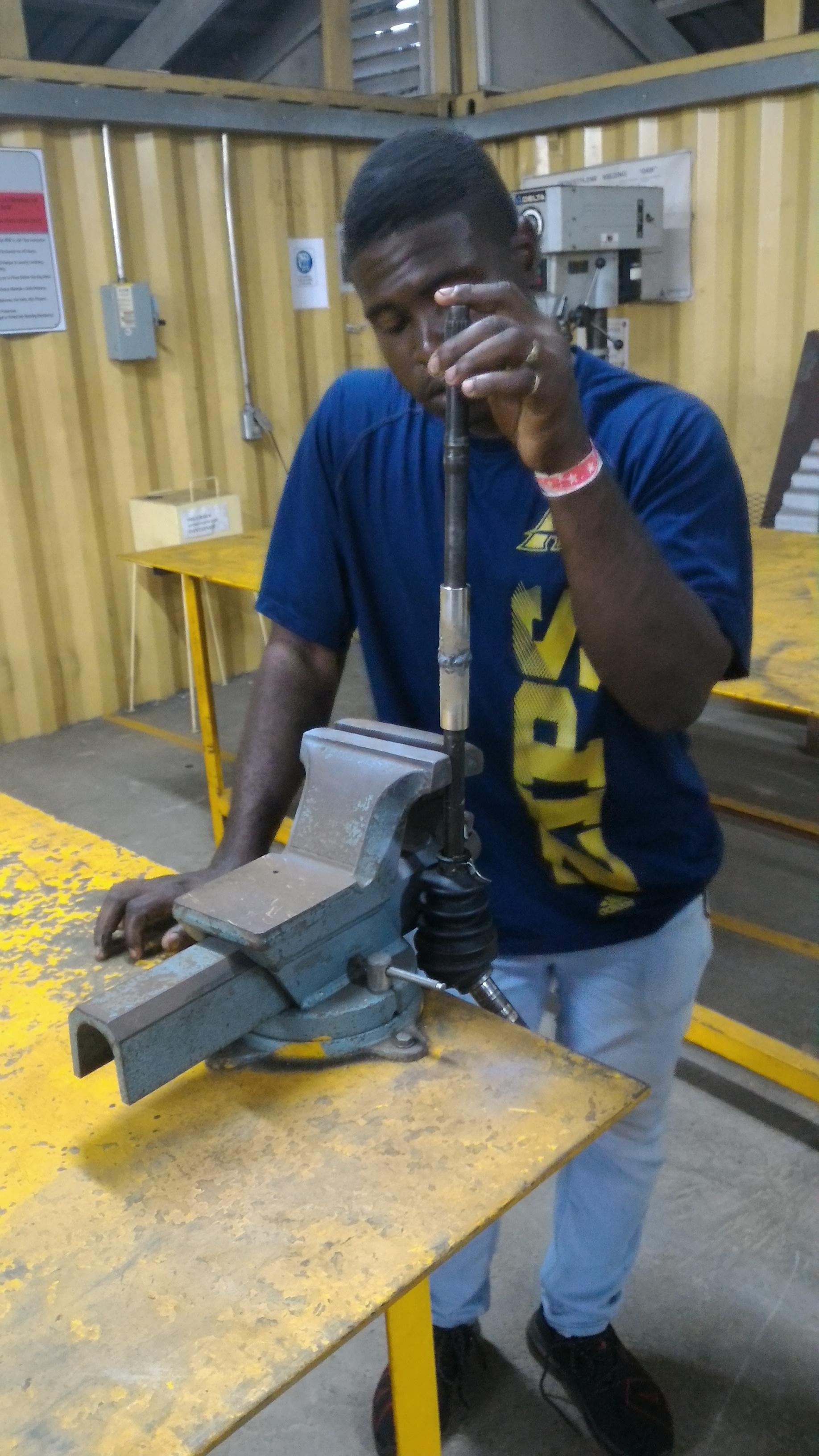

What we decided to do with the right side was to extend the C.V cup, basically cutting housing from another cup and welding it.
This way I’m able to use the stock right axle assembly.
The photo below was the mock up before we welded it

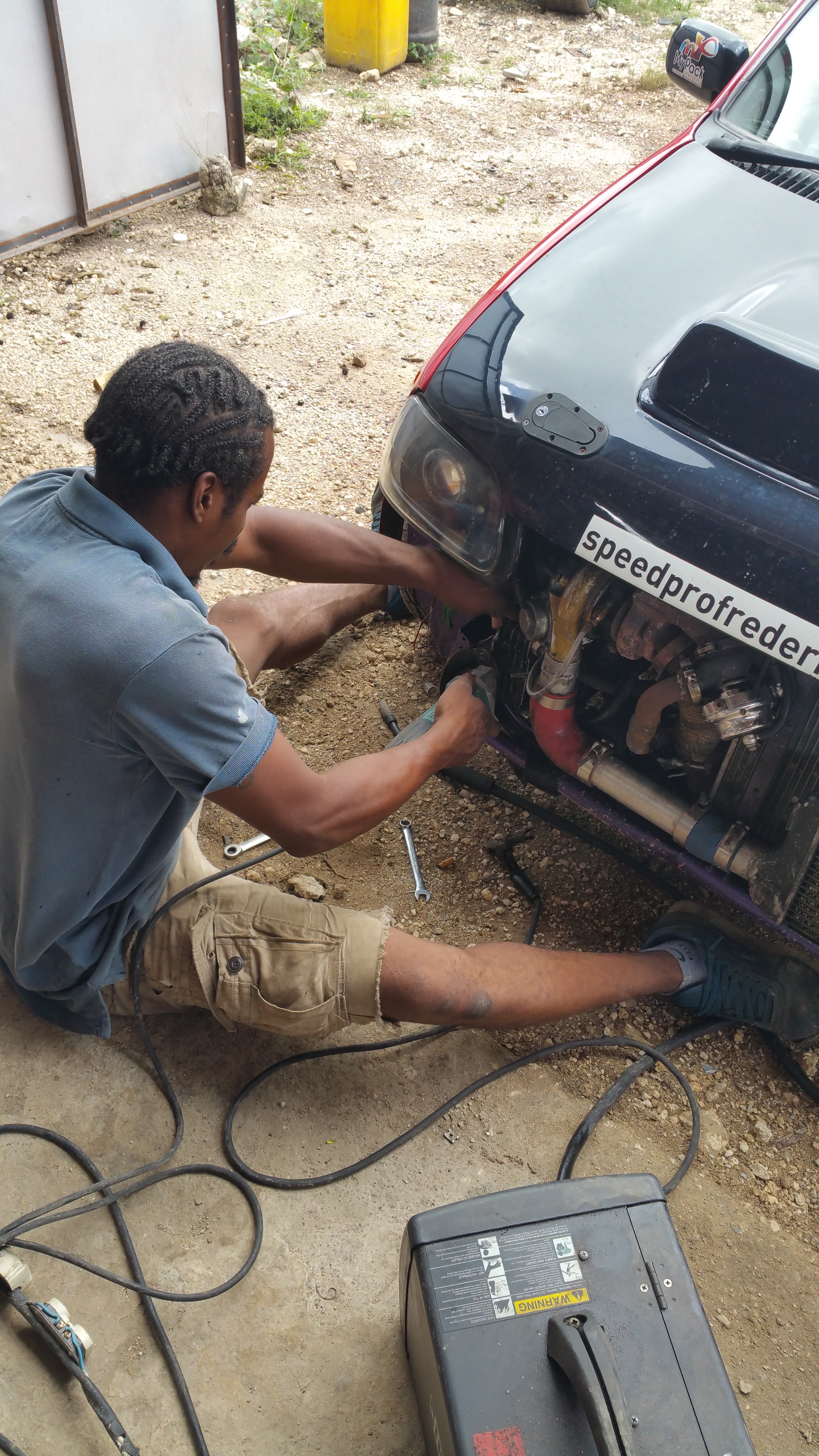

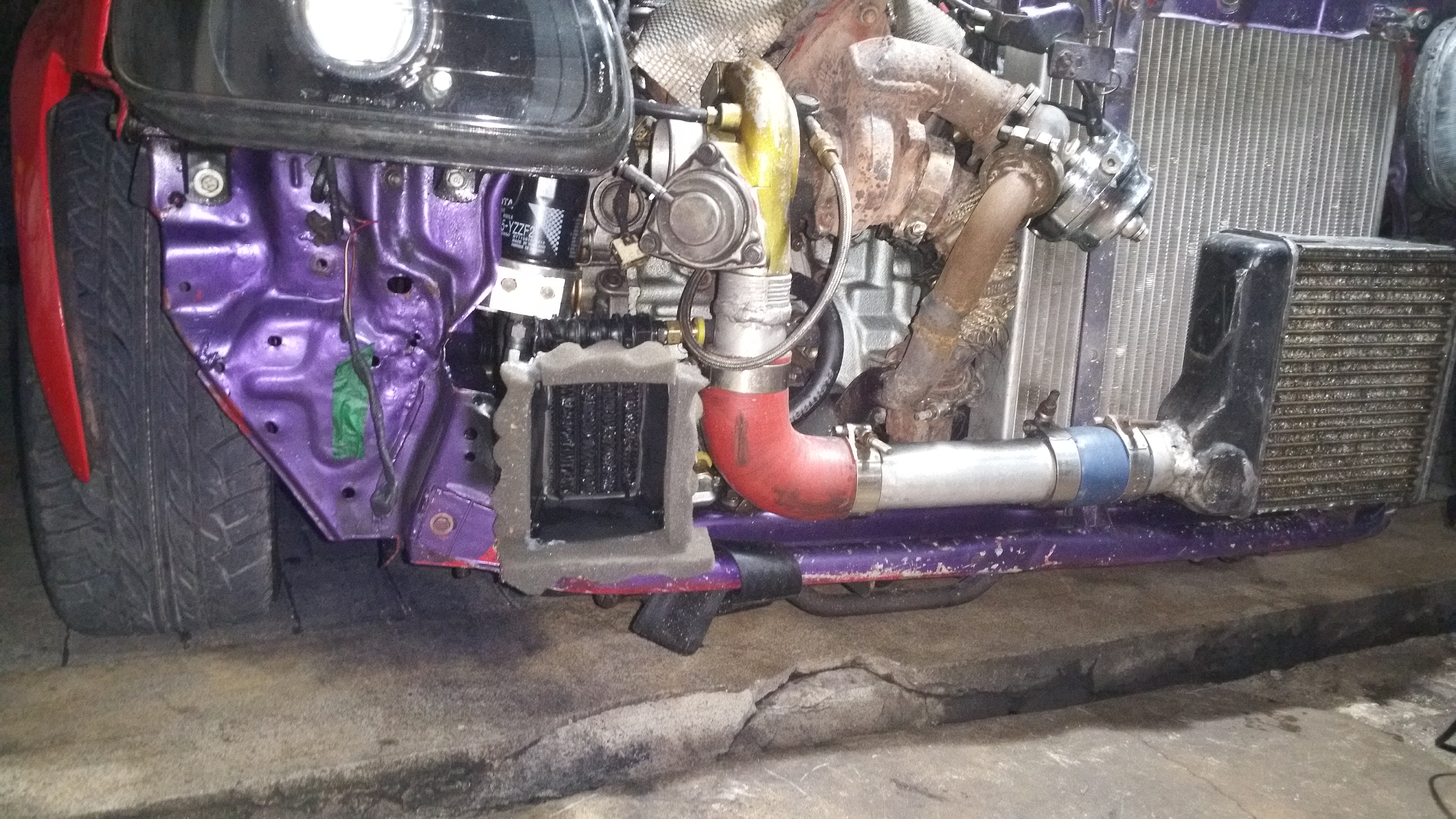

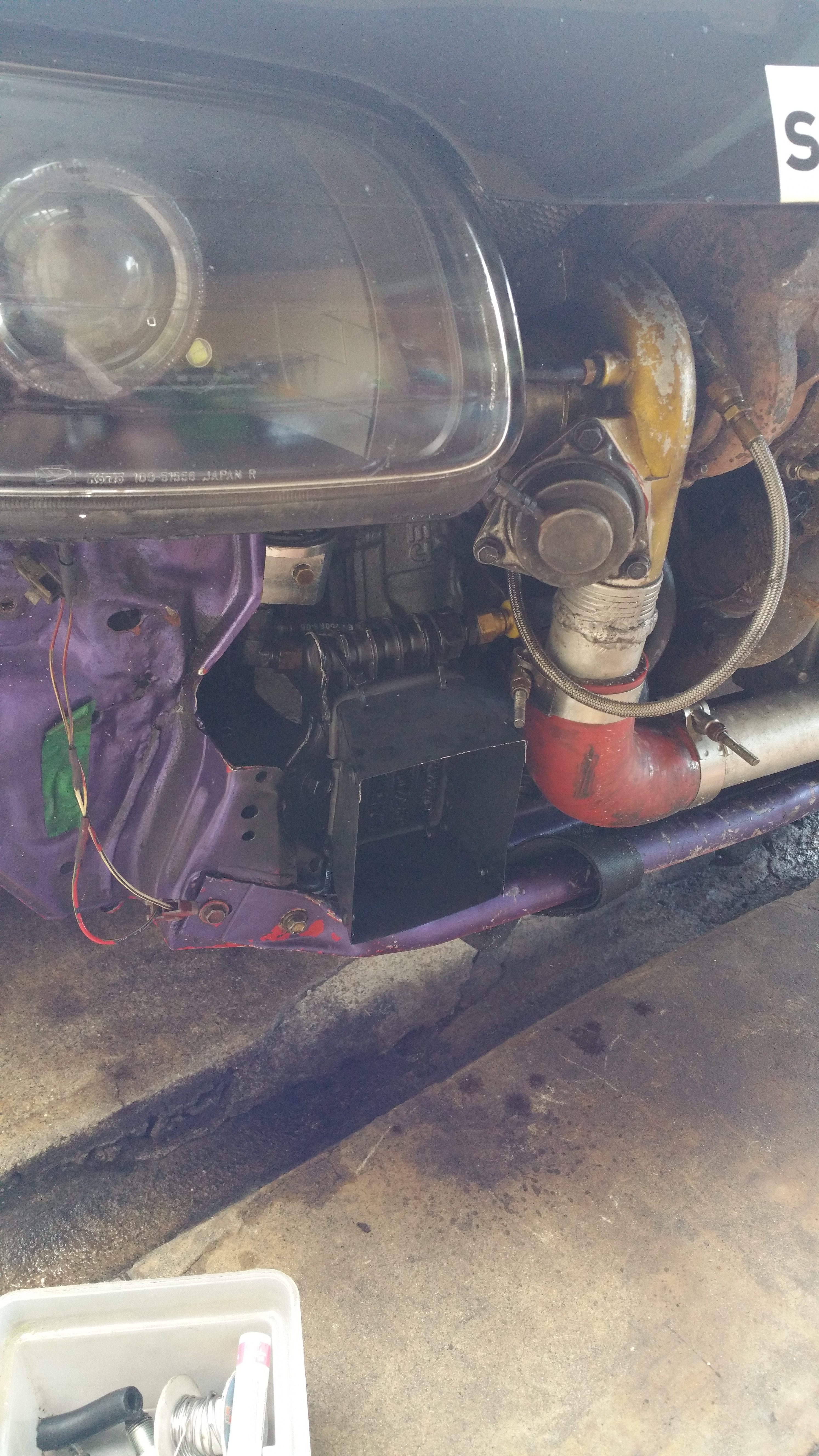

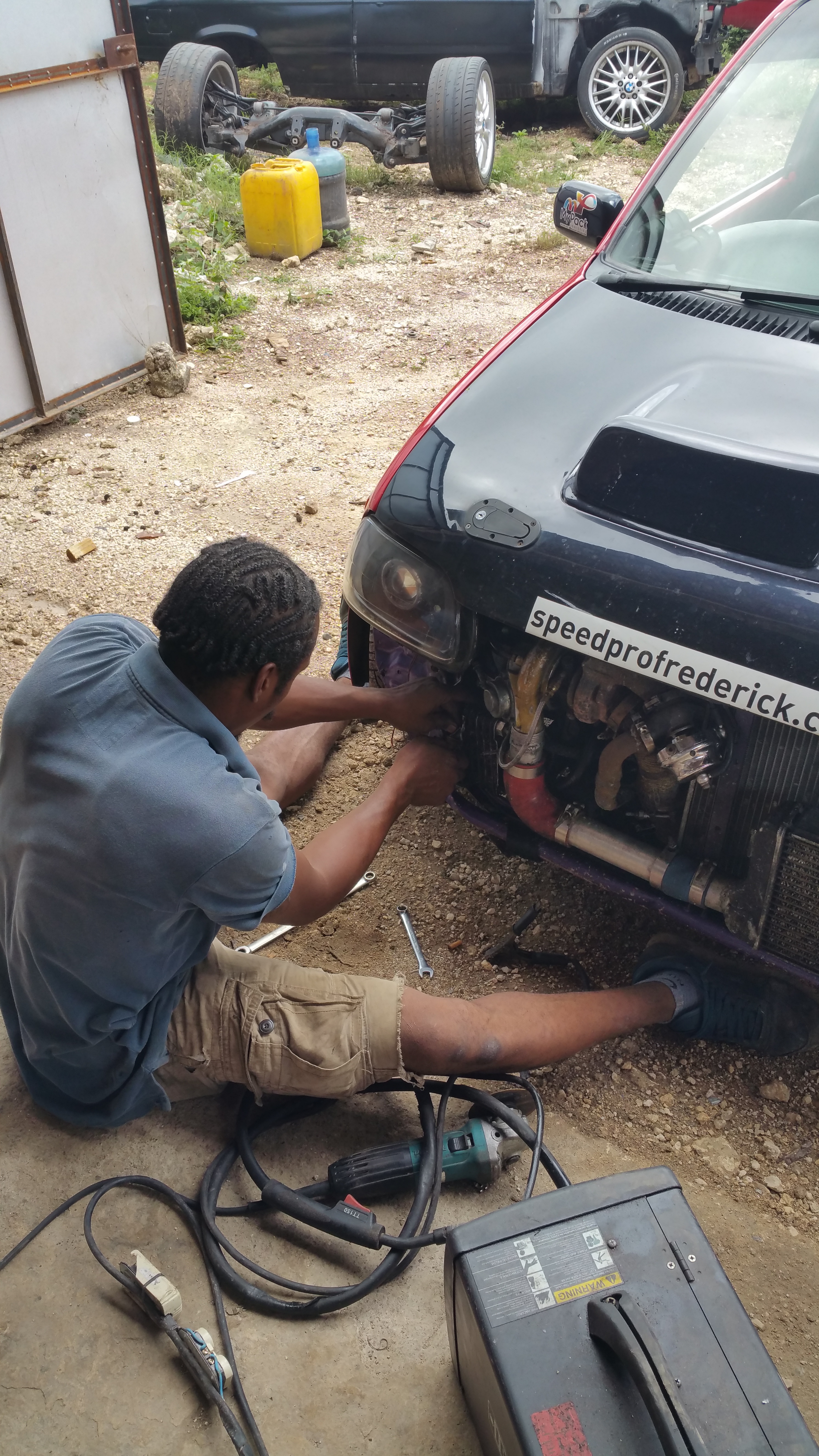

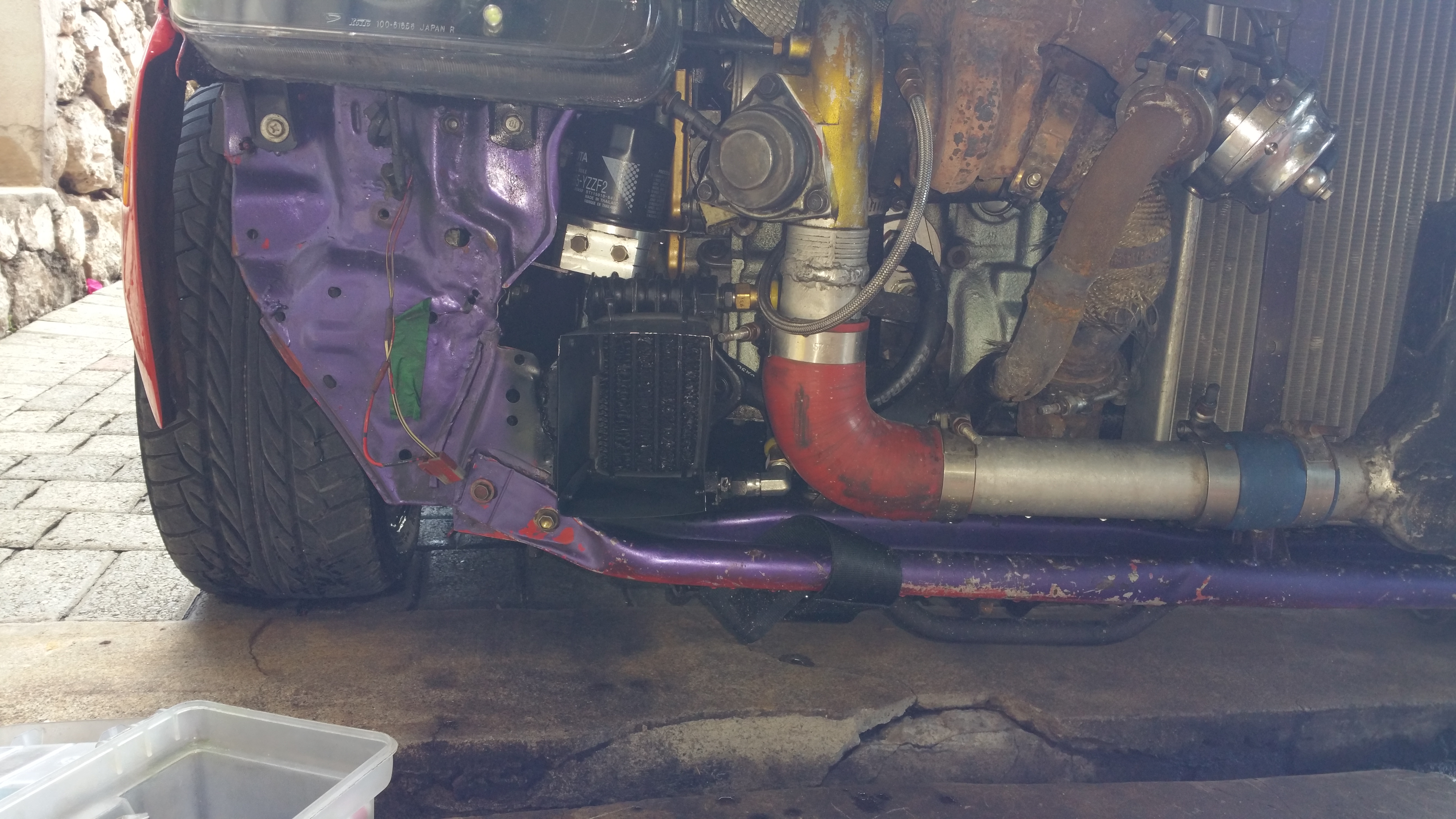

One more upgrade I failed to mention was my Lil oil cooler. Just laying there at my fabricator’s garage, he let me have it. No idea what it’s for but it’s perfect for the little space I have left.
Due to how the external waste gate was installed I no longer had space for the bigger cooler I used to run.
Rodded the fins to ensure air flow and built a little duct and sealed it with some sponge.
Taz doing a little bracketing for the oil cooler
