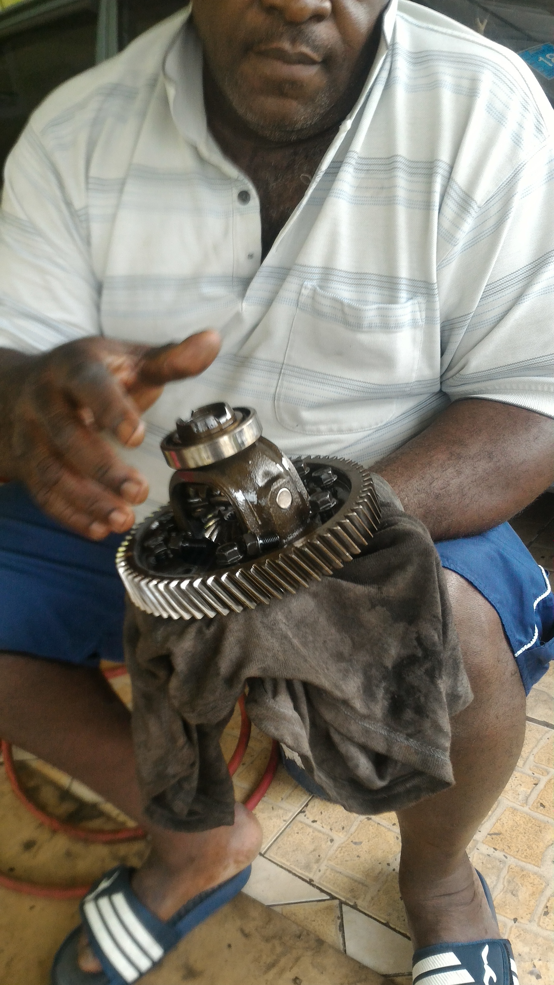

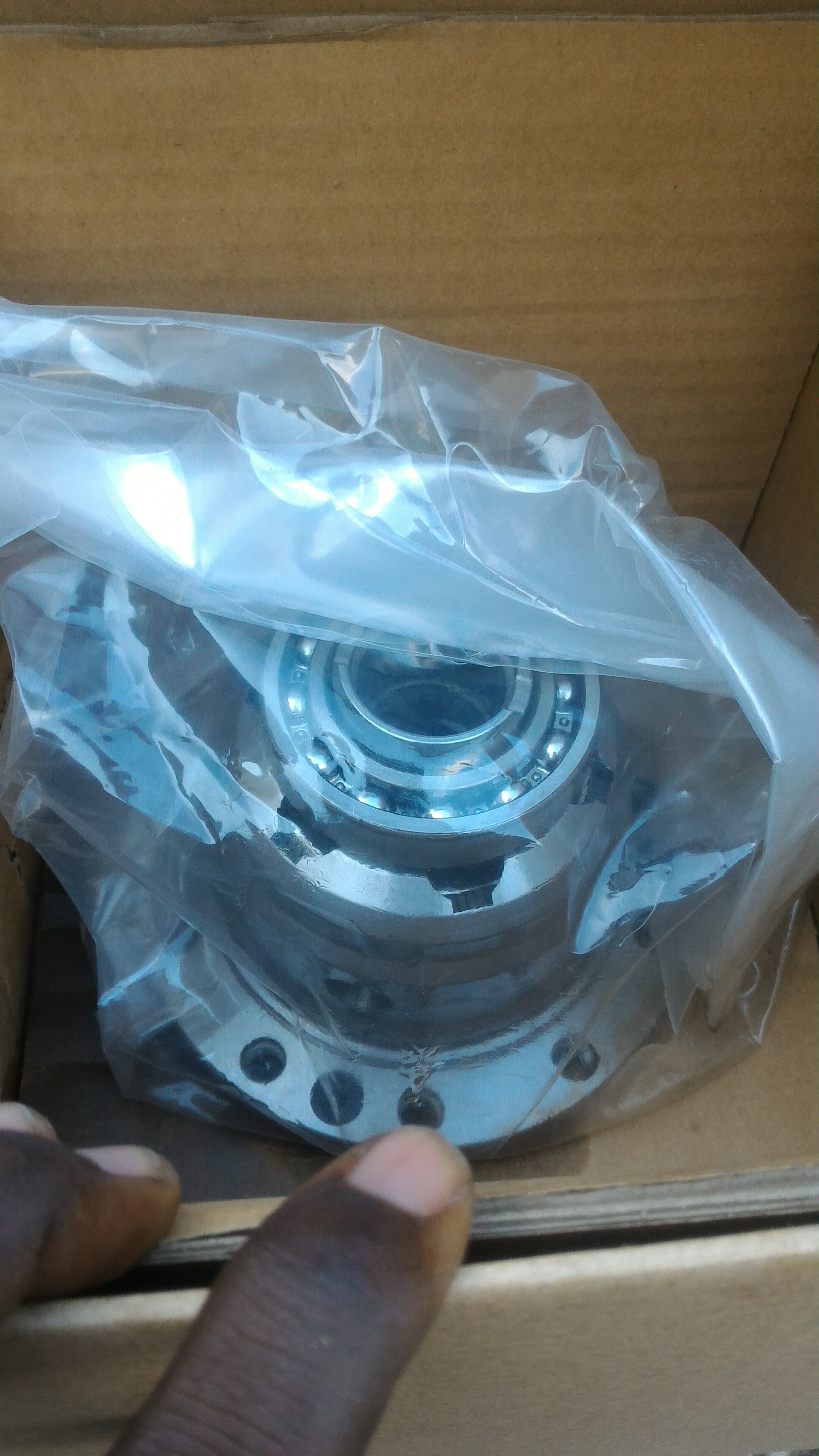

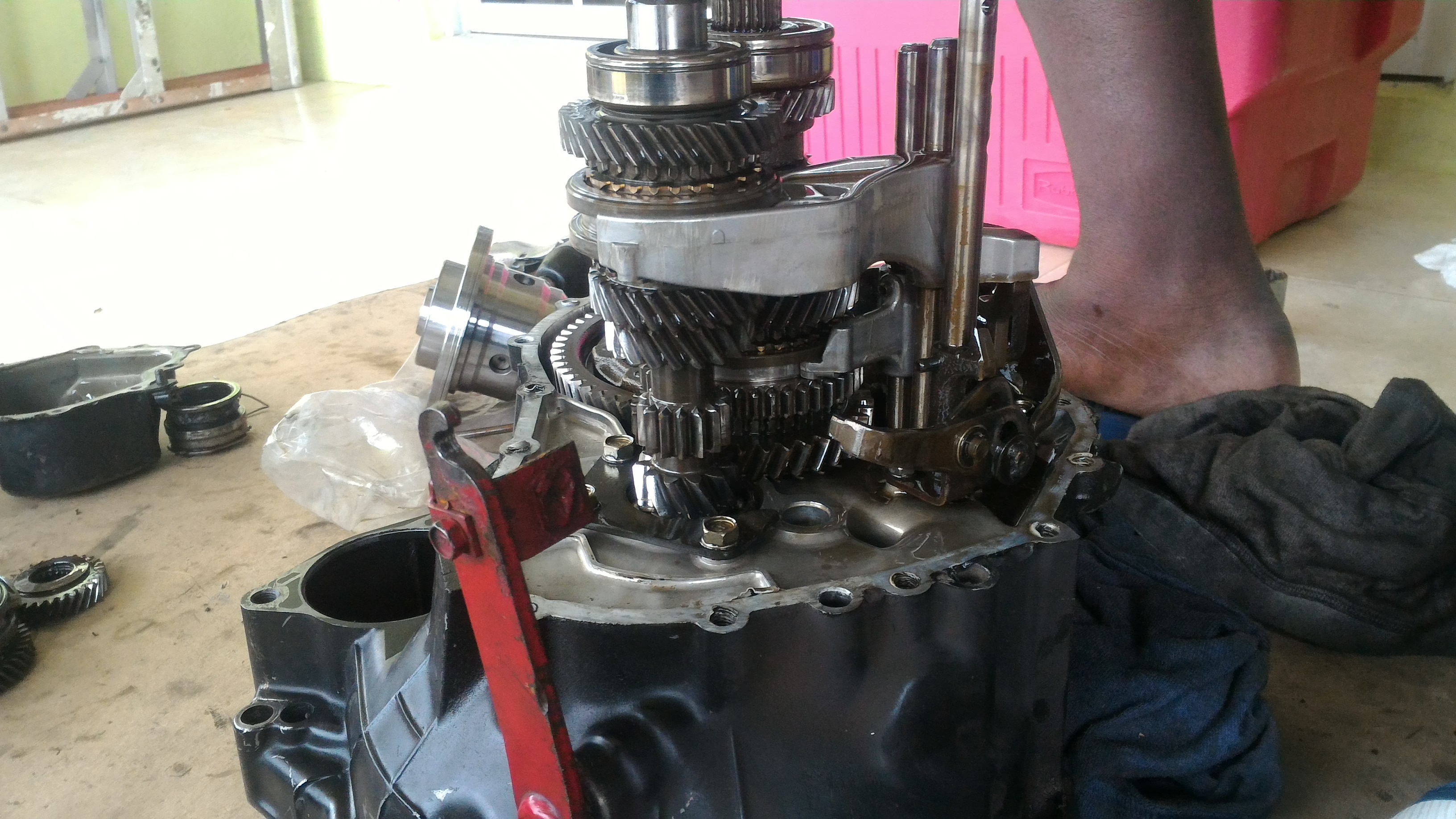

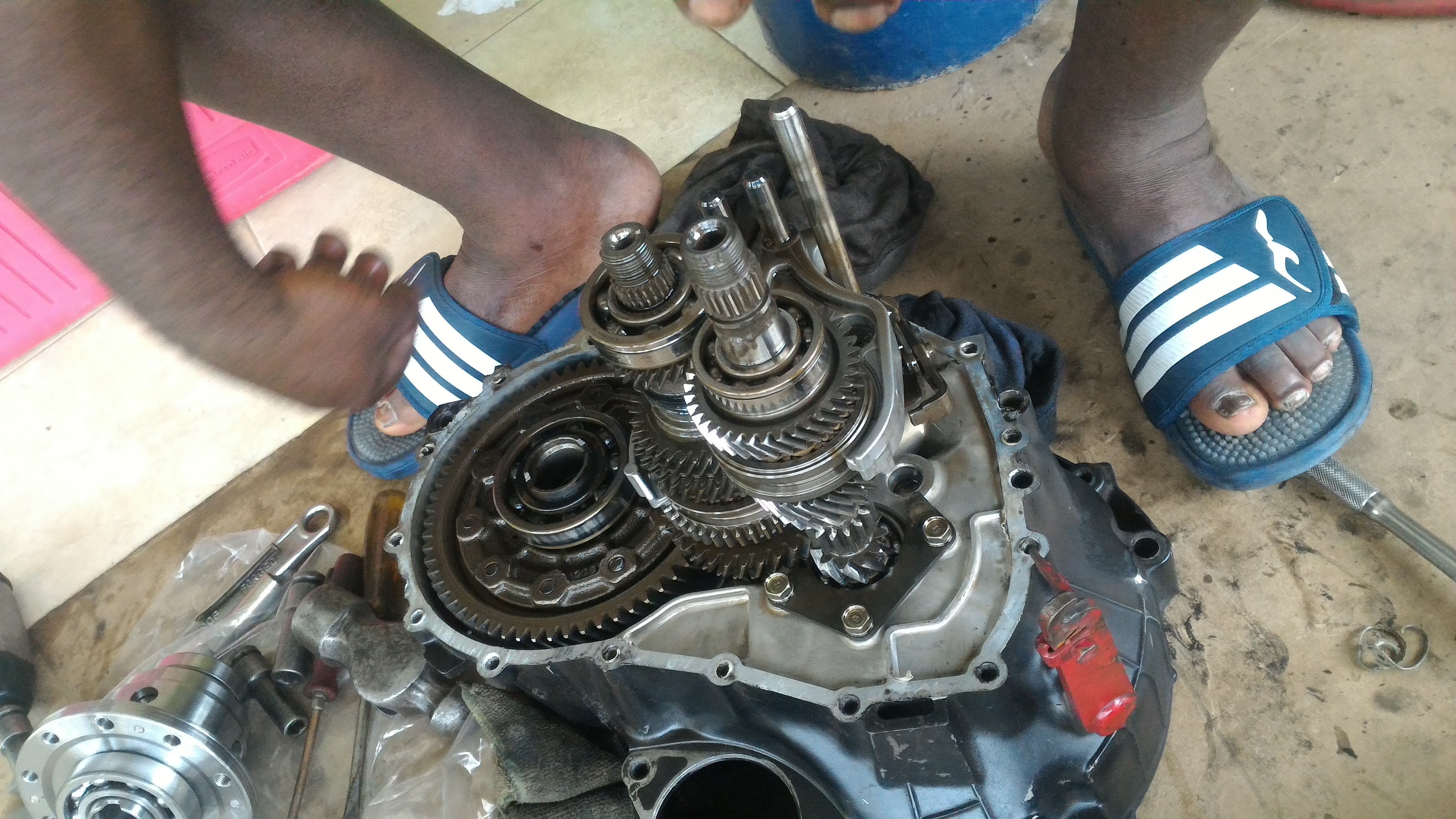

Got myself an early Christmas present :grin: 1.5 LSD for the L700 gearbox I’m running.
Now little did I know that an LSD needs a particular oil and breaking in. So after installation, I had used my amsoil sever gear oil. Just reversing the car I heard popclank* the steering was fighting me jus moving the car its like it was possessed.
Having conversed with others who have experience with LSD and doing some reseach myself I got to realise two things:
  1. With a clutch type LSD, an anti friction additive is suggested to be used to lower the chatter. I opted to use AMSOIL SLIP lock. It was like magic
  2. Break in the LSD; found an open lot and did some figure 8’s at low speed. Don’t throw on power on it aggressively on it for couple hundred KM, as one wants the clutch packs to seat properly.
    The instructions were in Japanese, could not read it, not even google helped, but them I saw this diagram

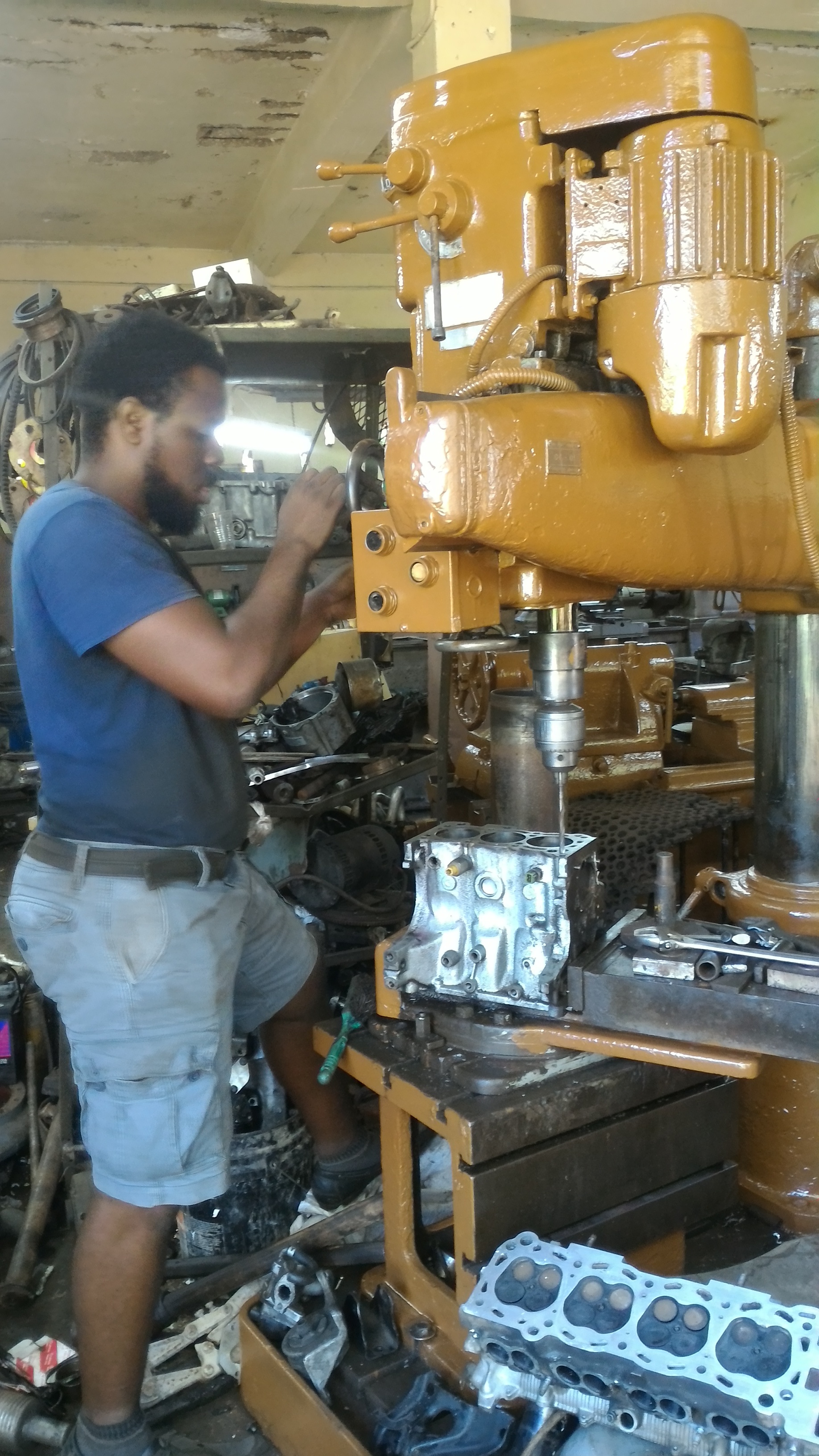

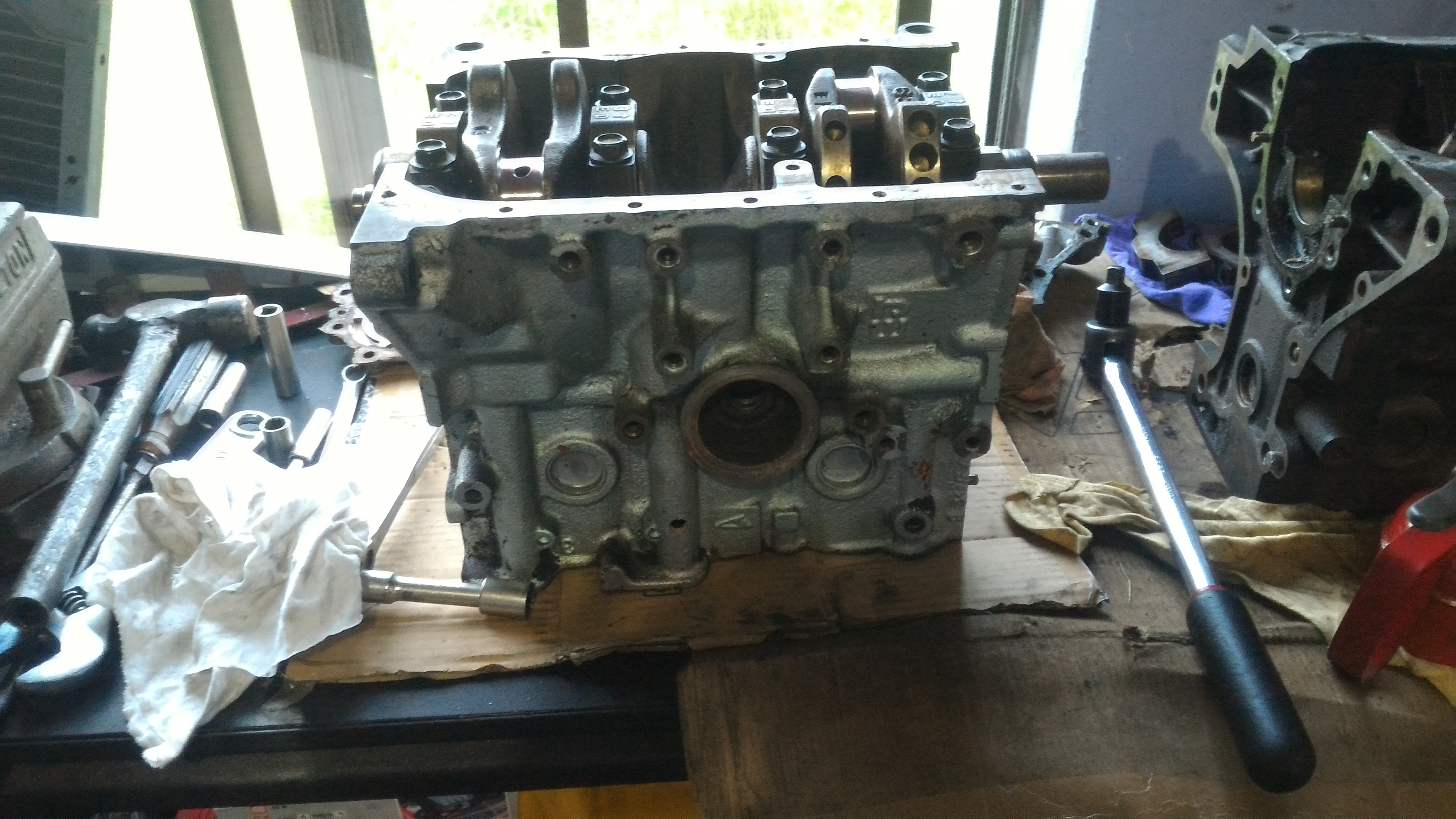

After the new year I decided to refresh the engine. New rings and bearings and another block which I had put down. So having to break in a fresh engine with the LSD was good timing for me.
Used three new pistons…because I could #startfreshanddone

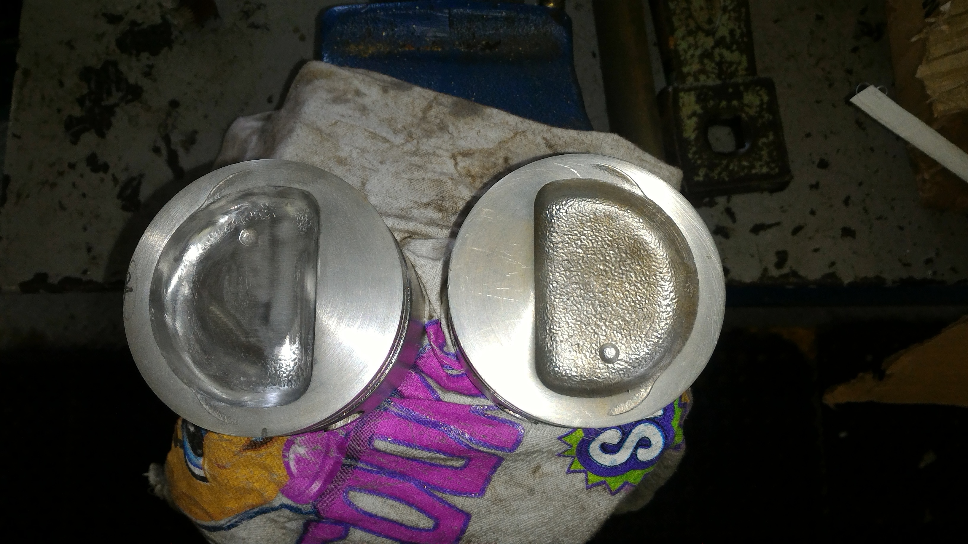

the pistons you are showing in the photos? is this a before and after shot of polishing?
Thanks man
Yes, that’s a before and after polish of the area. Reduce any hotspots.

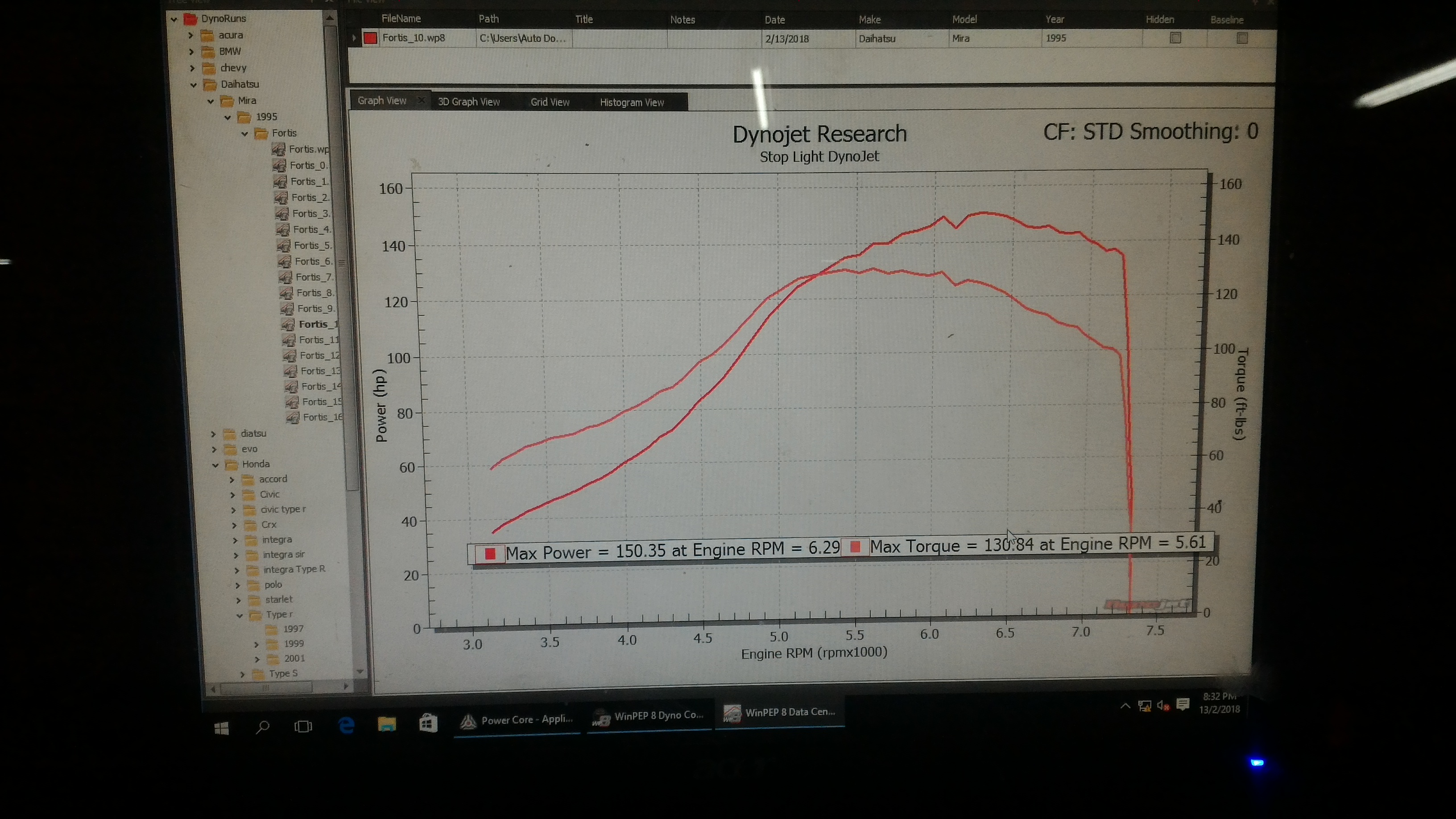

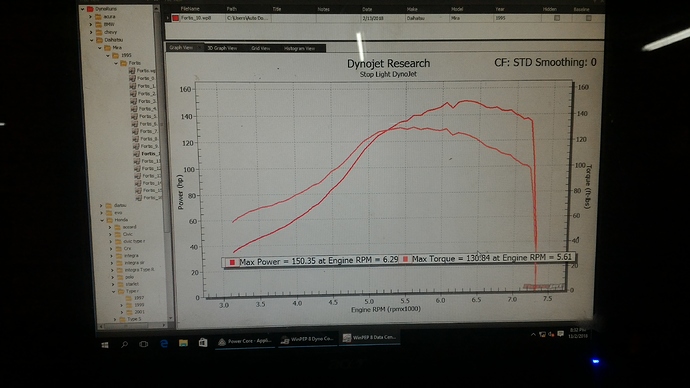

Got some 560CC Evo 8 injectors installed and went in for a retune. Made 120hp on 16psi and 150hp on 23psi.
Happy with the results

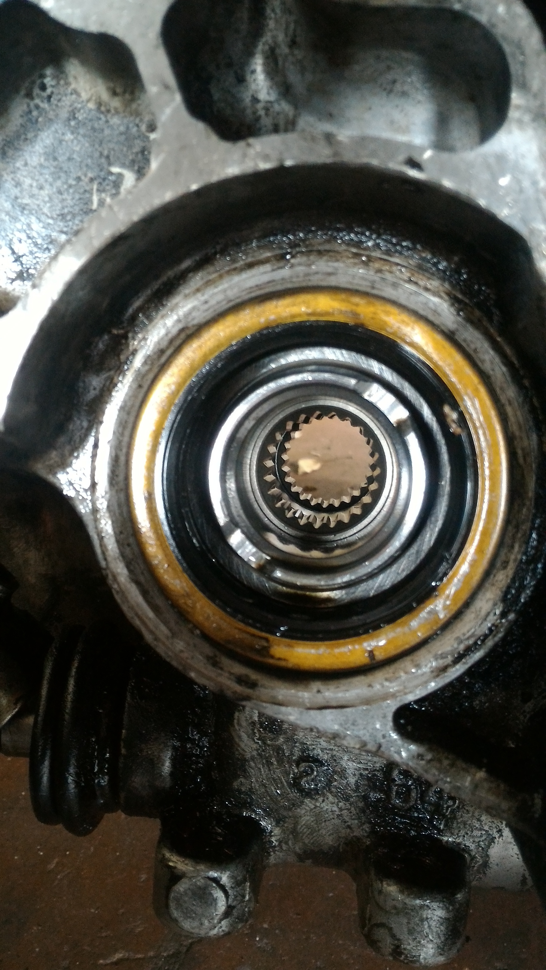

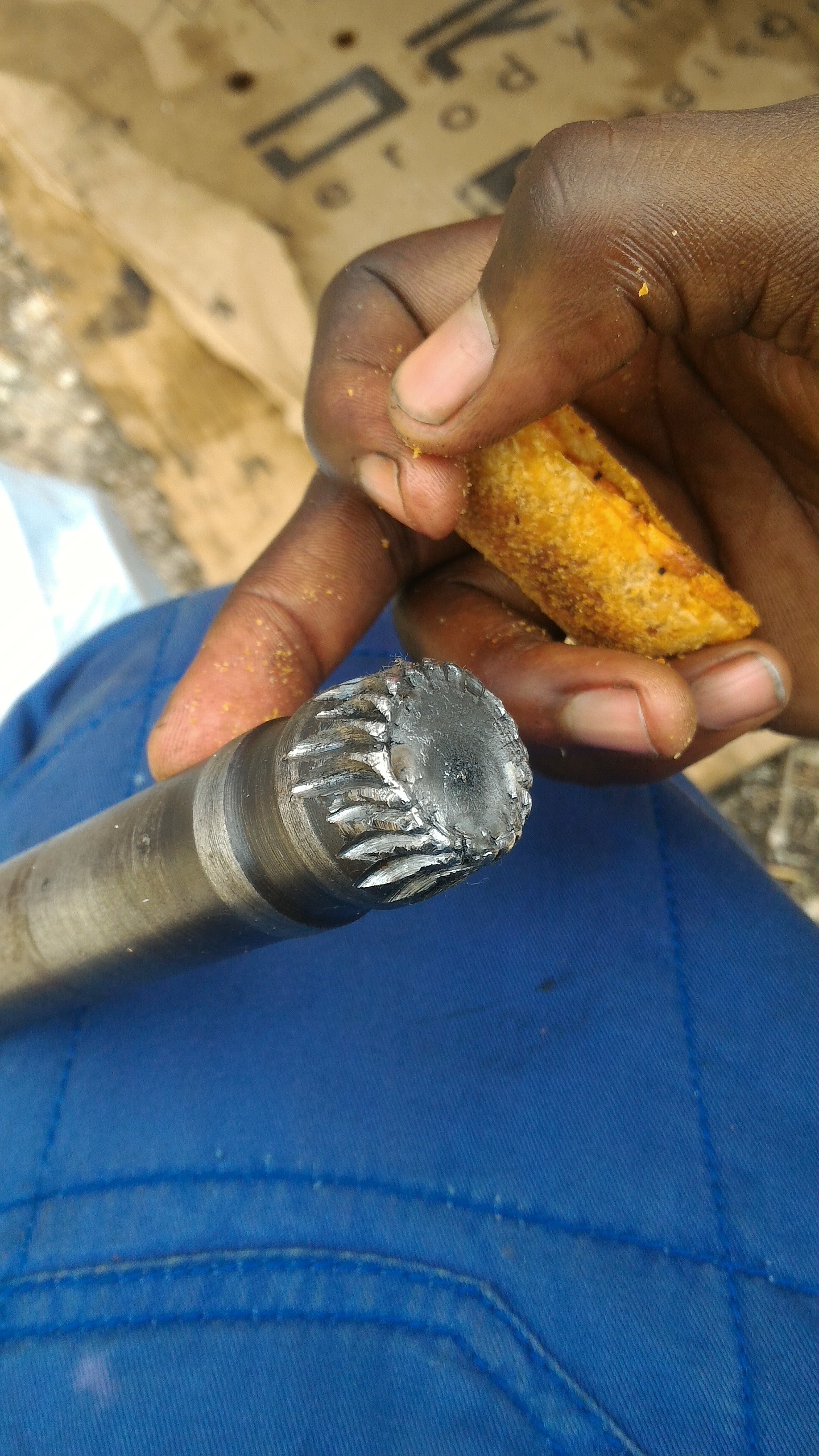

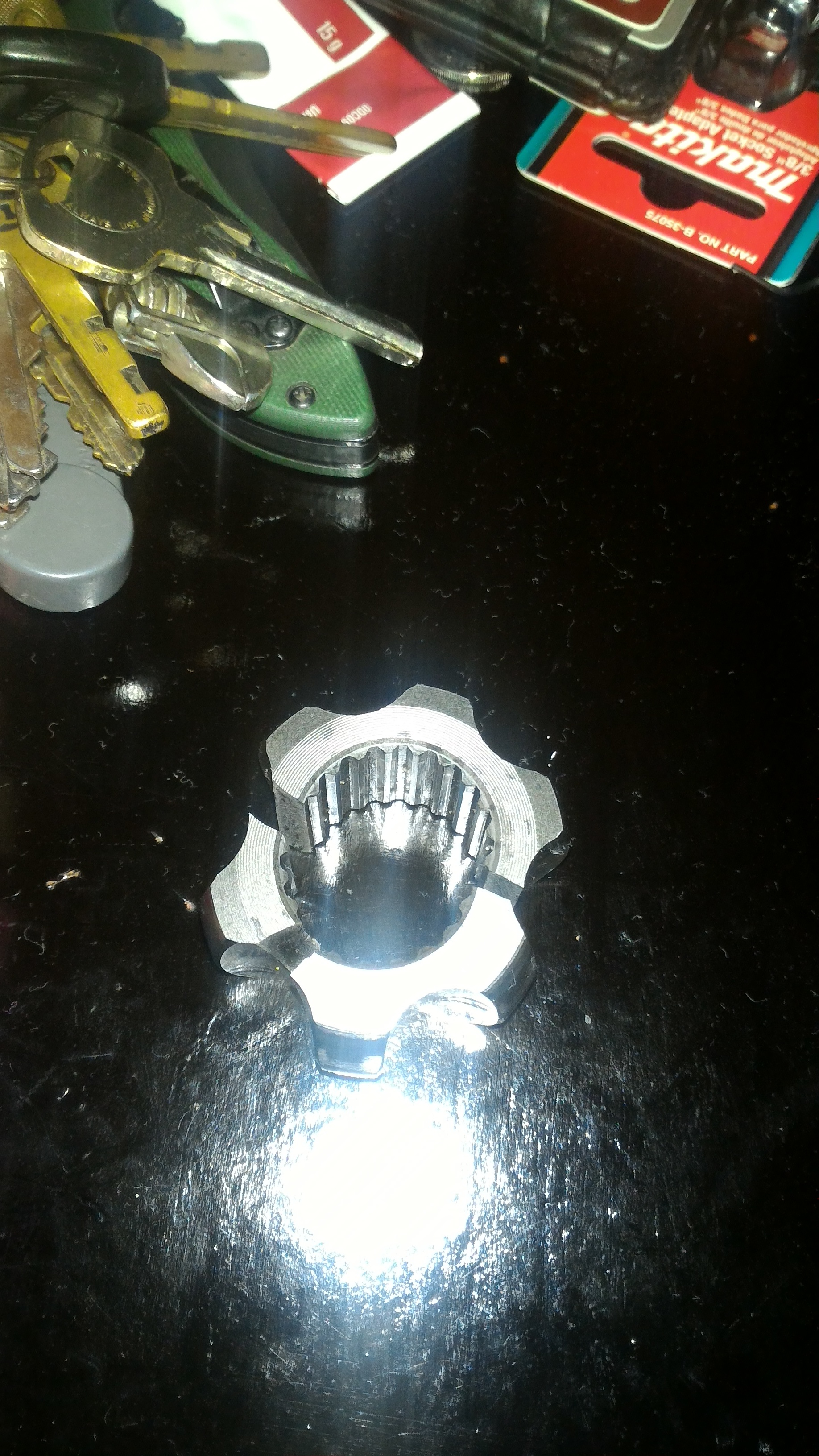

April 2nd was our race meet. Quite an eventful weekend. Loosened flywheel bolts on the Saturday and also found the right CV spline cage split in 3.
Fixed that had a good qualifying session the Sunday. Then Monday during lap 3 the right axle snapped. #endofmyraceday.
Car feel so much better with the LSD.
Now to find a solution with the axles and sort out the rear suspension.

“Rear suspension”, still!
Long or short shaft breaking. EfiMira did a couple of axles, I think I’ve still got a broken one hear. And that was with his viscous LSD.
