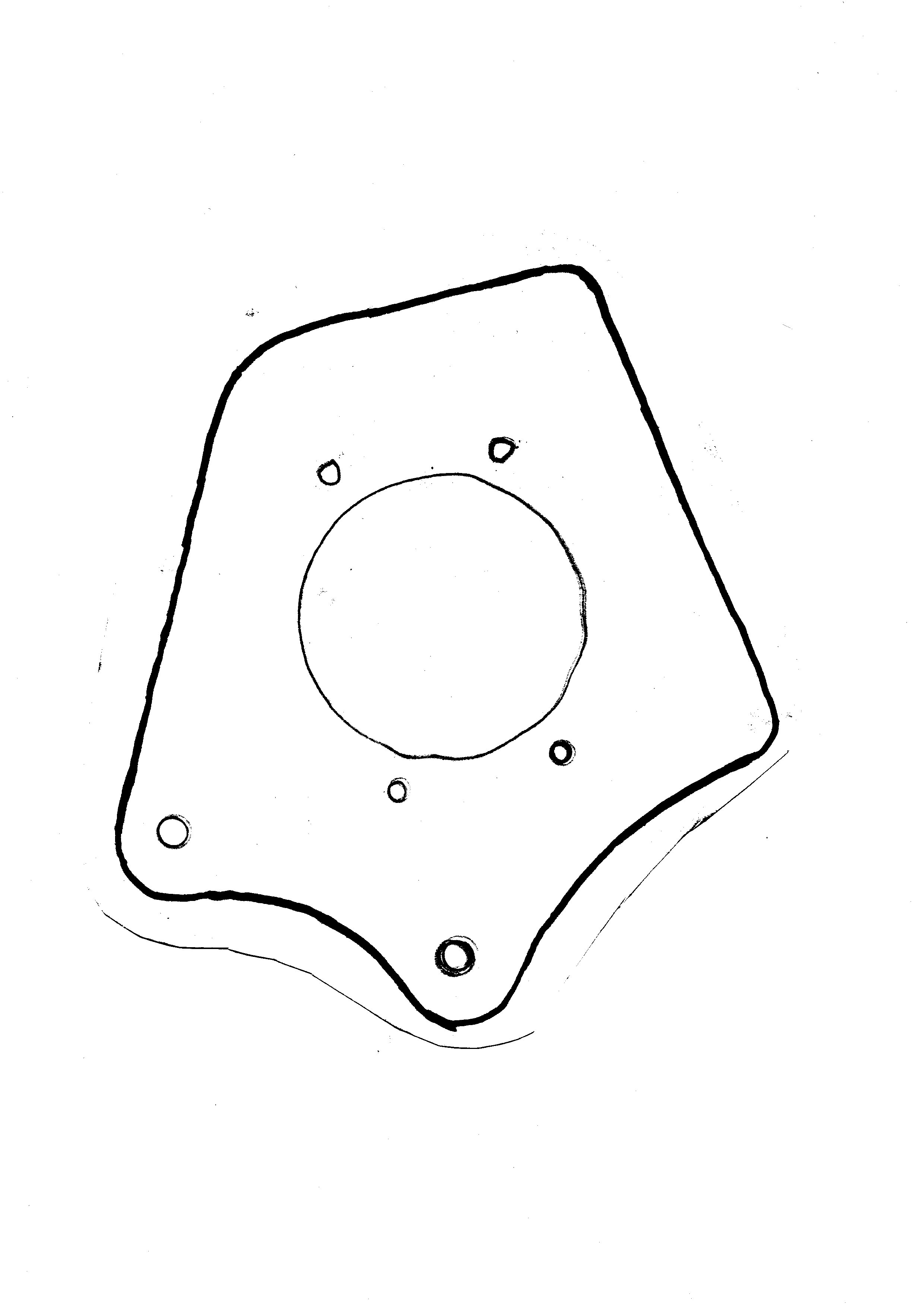

as for backing plates I Know Mr G used spacers on his backing plates. I wasn’t to happy with my welds so i made all the mods an original plate and then bought some 10mm plate and made backing plates by hand out of them.I traced one plate and scanned it so people could just download it and print it on to an a4 sheet of paper. as a rough guide. This is for an L200 but the bolt pattern etc should be the same for sirion and I had rear sirion drum brakes on it first. I dont know how it print’s out but this is the rough template.
