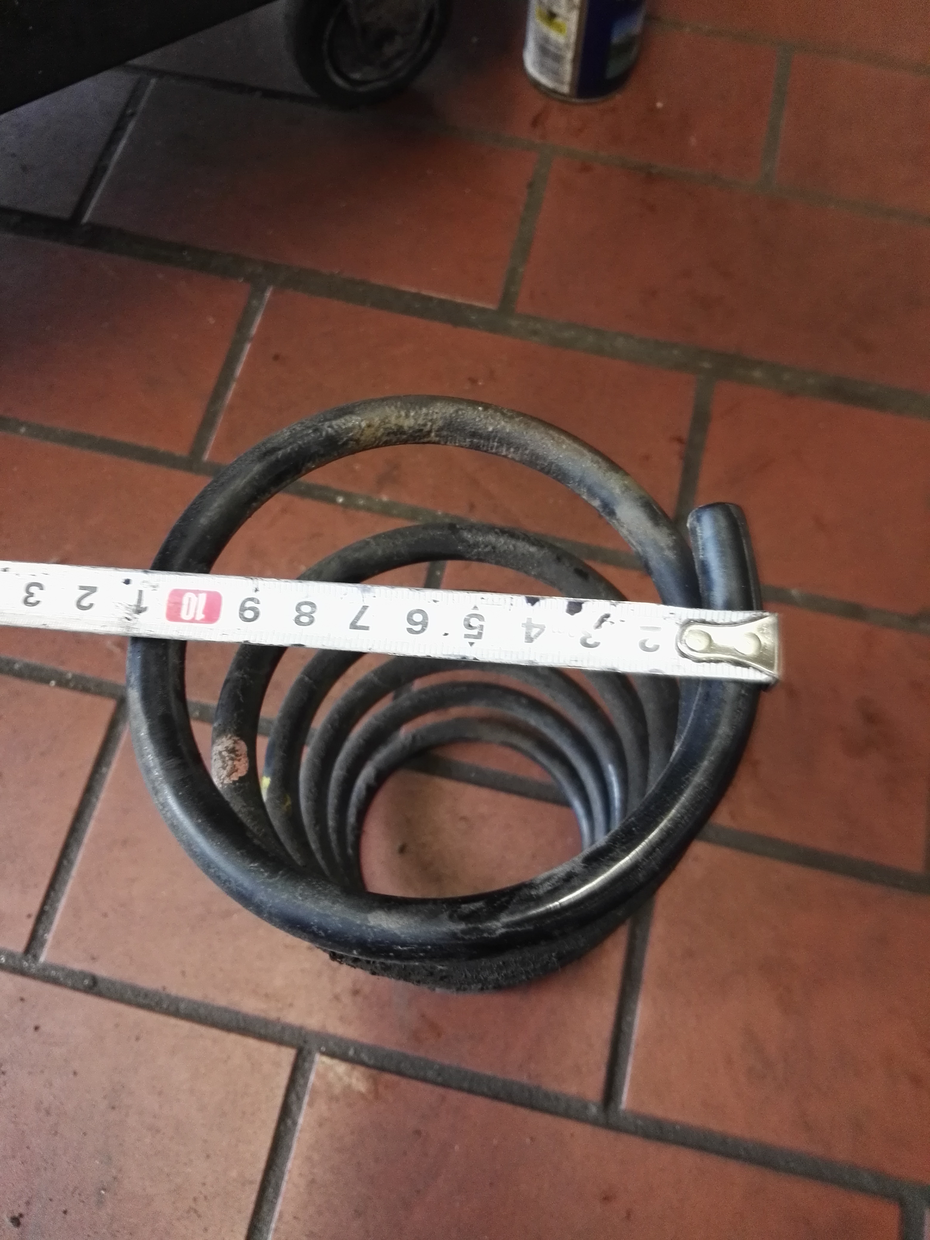

@Mr_Gormsby here are some pics of the AWD rear springs.
I completely forgot to count how many coils (total brain fart haha) but I will do that Monday, then calculate what the factory spring rate is. But one end is open, one end is closed and in the pics are the dimensions.
Maybe you have something there that will do the job, if so please send me info, part numbers or whatever you have. I have heard front springs from a MKII escort fit straight in, have a 220lb spring rate and retain factory ride height so maybe some lowering springs from eibach or something will bring it down enough to match the front and be a bit stiffer again. But this information came from facebook and I am yet to confirm.
aaaaannnnddddd I just realised you can see how many coils the spring has in the photo.
another brain fart haha
I saw that info on the rally sirion fb page. Grab a hold of any said Escort spring and measure to confirm

So the factory rear springs on the awd have a spring rate of approx. 100lb
The front springs from the mkII escort have similar dimensions however the diameter is 4.75 inch (the original springs are about 4.3 inch) and the spring rate is 145lb.
So I guess the escort springs wouldn’t be too much of an improvement
@Mr_Gormsby you said if you knew the factory spring rate you could help determine what spring rate I should aim for, what do you think I should go for now that we know factory is about 100lb?
found something, front springs from a second gen 2wd Mitsubishi L200 (sold as Mighty Max in Europe and the US) free length 11 inches (28cm), I.D 3.42 inches (8.7cm), spring rate 435lb.
so about 2cm shorter, I.D is basically the same, only 3mm smaller but should fit fine, and they have one open end and one closed end the same as the factory springs!
Looks like I might be onto a winner here
What’s the front rate? You need to know that to balance things out. A 50% increase with the Escort springs is in the right direction. Should be common.
ok, im not sure what the front rate is, ill have to do some research but I know the eibachs aren’t fixed rate so it might be tricky to calculate
