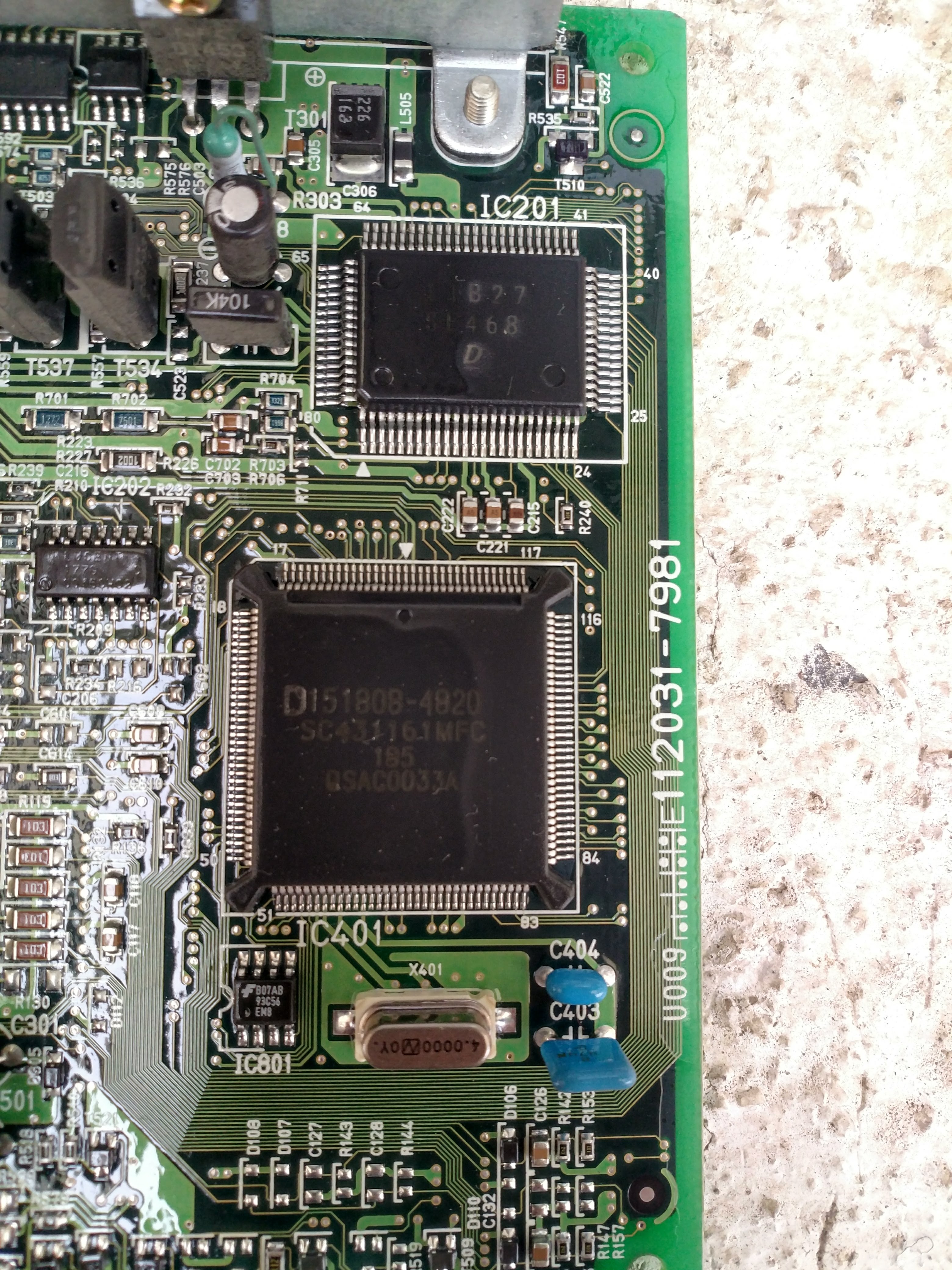

the ecu mod is a prettysimple thing, the ecu calculates rpm using the signal from the CPS against time. The crystal in the ecu is the “time”, to put it simply if you overclock the ecu 10% then one minute is actually 54 seconds inside the ecu. So at say 8000 rpm the ECU thinks the motor is only doing 7200. This is the reason why its not particulary safe to go to extremes with this mod, with a 10% overclock your motor is doing 8000rpm with fuel and timing for 7200. After 10% you start to have communication problems betweenthe ECU and other systems like immobilizors, ABS and scan tools. I was hoping to go 5% to bring the limiter up to 7850rpm, but i couldnt find the right crystal. With the small increase of 3-5% timing and fuel is not such a big problem, this was my reason for installing the FPR so fuel could be increased slightly, and with the advanced crank sensor wheel i have more timing across the board and i wont lose any timing at higher rpm. This is and oldschool hack that origionated from the old Cressida scene, when people didnt have access to aftermarket ecu´s, and they were able to raise the rev limiter and in most cases also gained power due to the stock fuel map being too rich for the old 7AG motors. I have some left over crystals if anyone wants to try it out for themselves, at first i ordered a 4.19Mhz (approx 4% faster) crystal thinking the ecu ran at 4Mhz, then after discovering my ecu ran at 6Mhz i bought a 5pack of 6,144Mhz crystals (approx 2.5% faster). I can do small packs with a crystal and a switch for EU2.50 plus postage if anyones keen, im not going to use the leftover crytals anway, and i have surplus switches because the minimum order was 10 pieces

Yeah you just need to take the cover off and check the number on the crystal

If I take a pic can you show me what I’m looking at and if it has this Magical Dark Krystal on the board?
judging from the photos my ecu is 4 MHZ true?

Hi, no problem, I can post you a 4.19Mhz and a switch. Will raise the limiter approx 4.5%. Just pm me your details

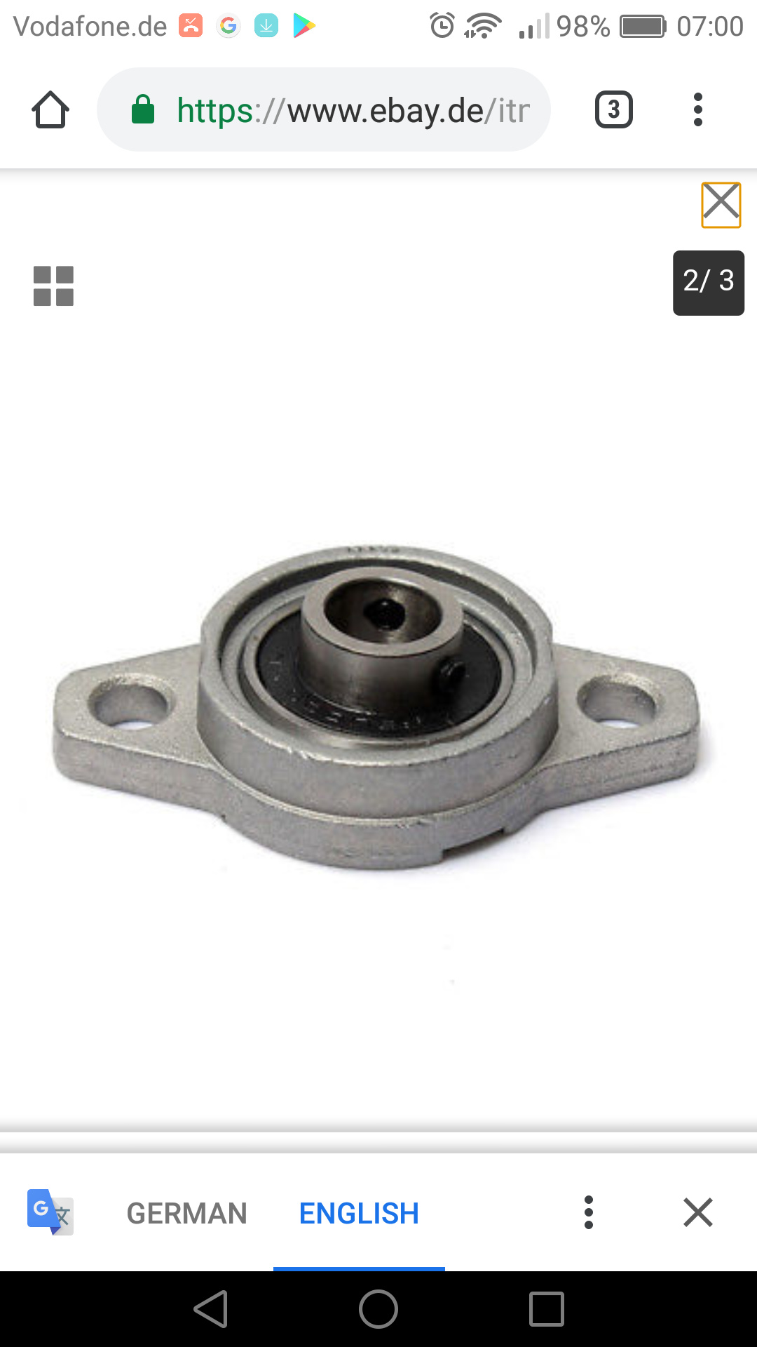

@Mr_Gormsby do you think something like this would work for the pivot on a watts link?
I would cut a diamond out of some heavy flat bar and mount this in the middle. Thoughts?
It already has a panhard rod. How much rear wheel travel do you have - is it less than factory?
Which way do you plan to mount the Watts? Will the centre pivot be diff or chassis mounted?
Centre pivit will be on the diff, I will simply weld on another factory panhard bar mount on the left side, 2 short bars with heim joints and a pivot in the middle on the diff housing
I have seen plenty of kits available but all rather expensive and aimed at the hotrod community, way overkill for me. I could easily make up something plenty good enough and have change left over from 50 bucks, im just looking for the easiest solution for the pivot, weather it be a poly bush or bearing of some sort.
