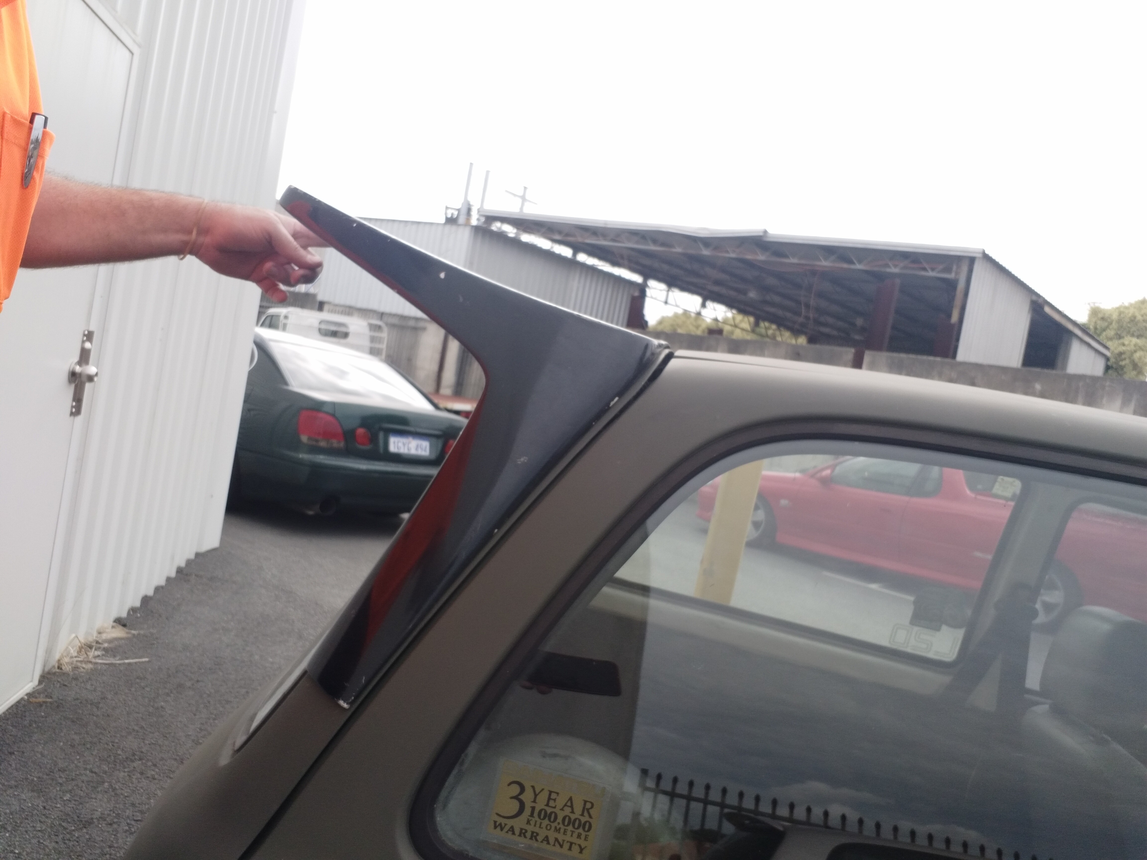

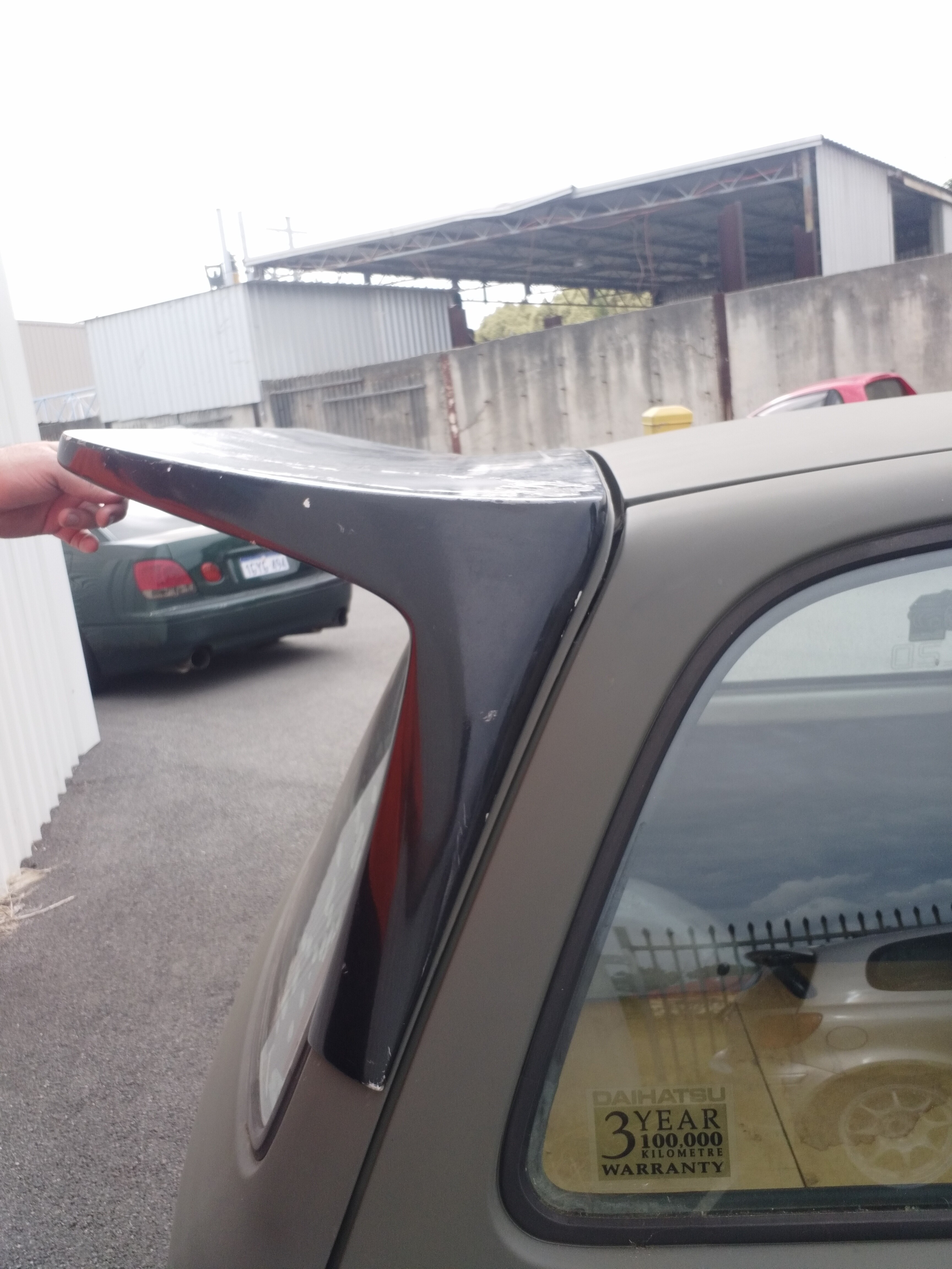

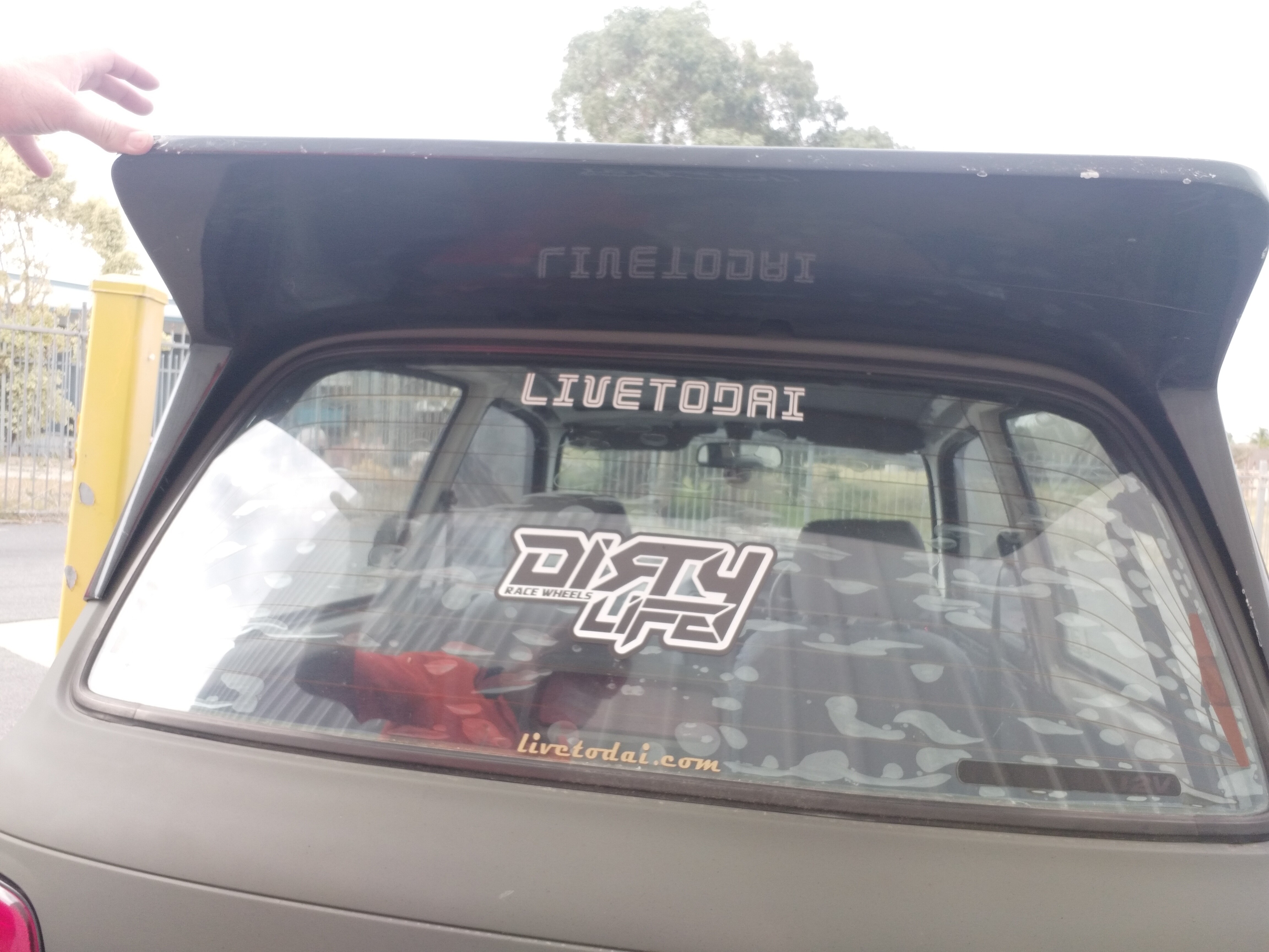

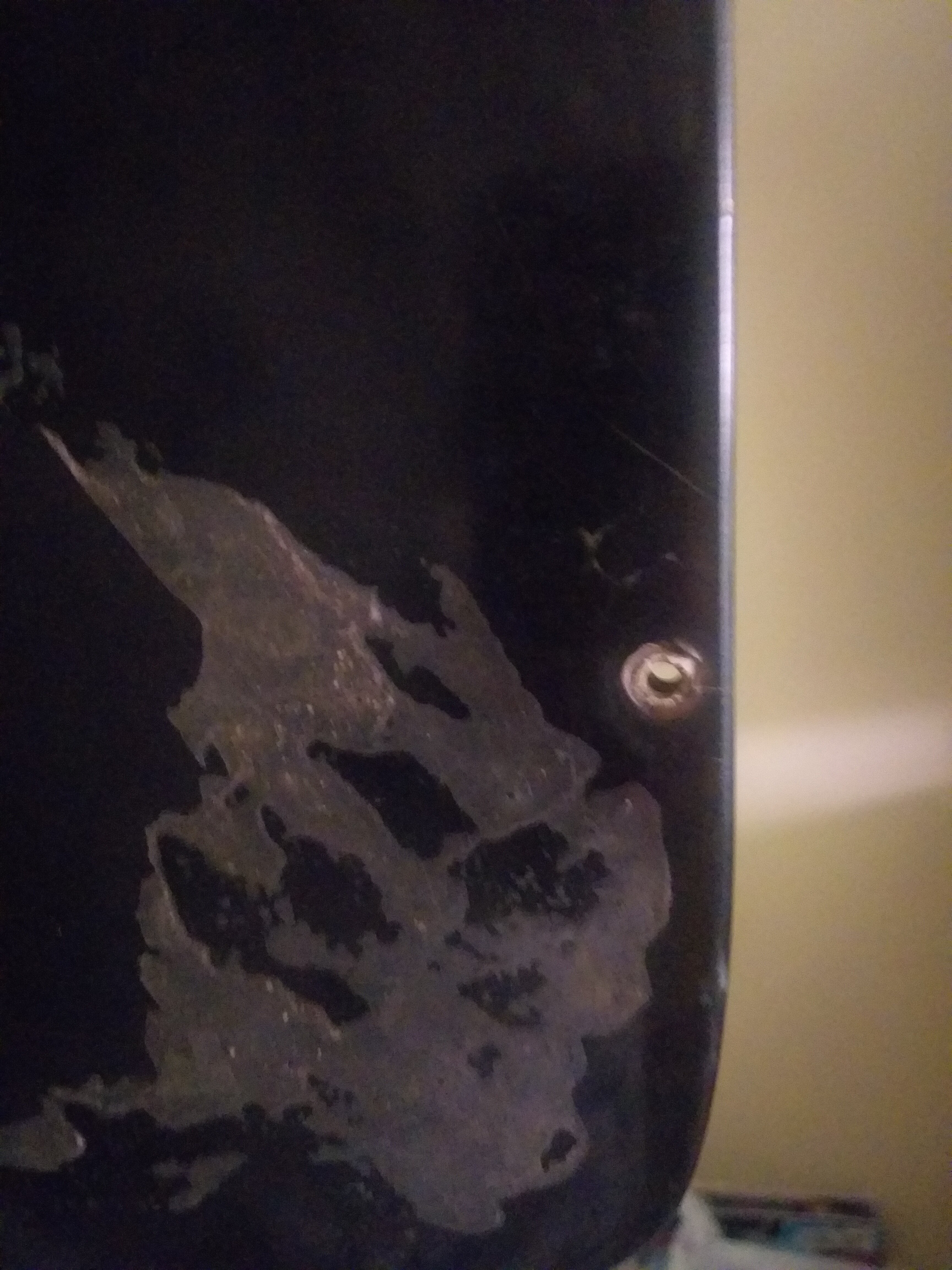

Nothing too substantial to report at the moment. I took delivery of a nice “ski jump” over sized rear wing last Thursday. I purchased it from Malaysia before I knew I was getting the TRXX. Just needs a good sanding, but of body filler for the deep scratches and knocks on the corners then a paint job. It appears it’s mainly held on with double sided tape which is a bit concerning. There are two holes along the top for some screws but I may add one to each of the legs aswell.
sika flex 227 works well also :slight_smile:
Looks good. the malay wings from the ones i’ve seen all need a bit of final work but the main shape is there so its good. suits the car a lot :smiley:
And the only need for screws then are to hold things in place while the adhesive cures.
definitely I when I put my gti spoiler on my swift I had Mary and the 2 kids (when they used to live at home) all helping me stand there holding the spoiler for about 20 minutes until it was stable enough to let go. 2x Teen’s standing in one spot doing nothing and complaining about it can be painful. hahaha
Sounds a bit more permanent than double sided tape so I might in fact go that route. Thanks guys.
