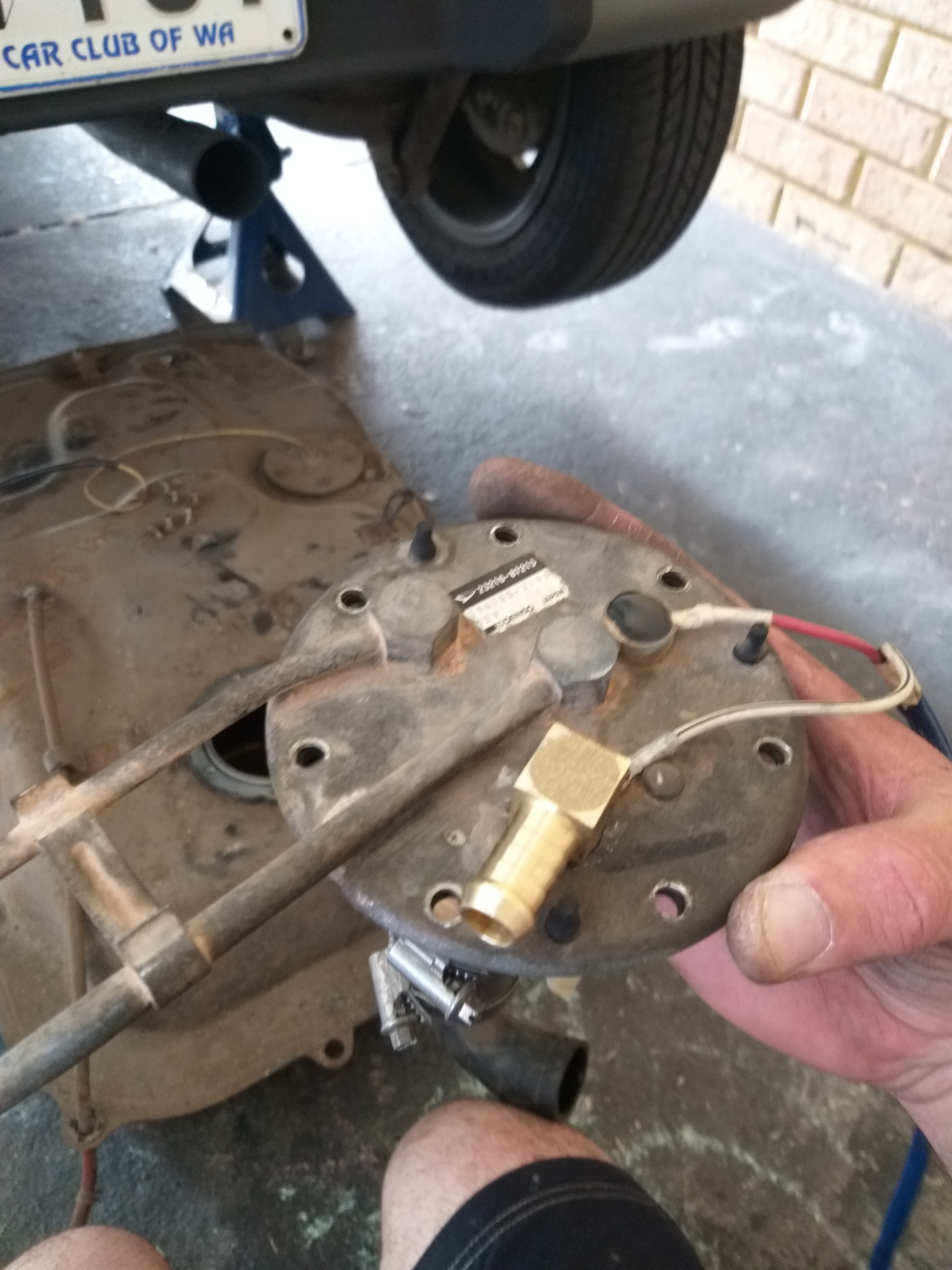

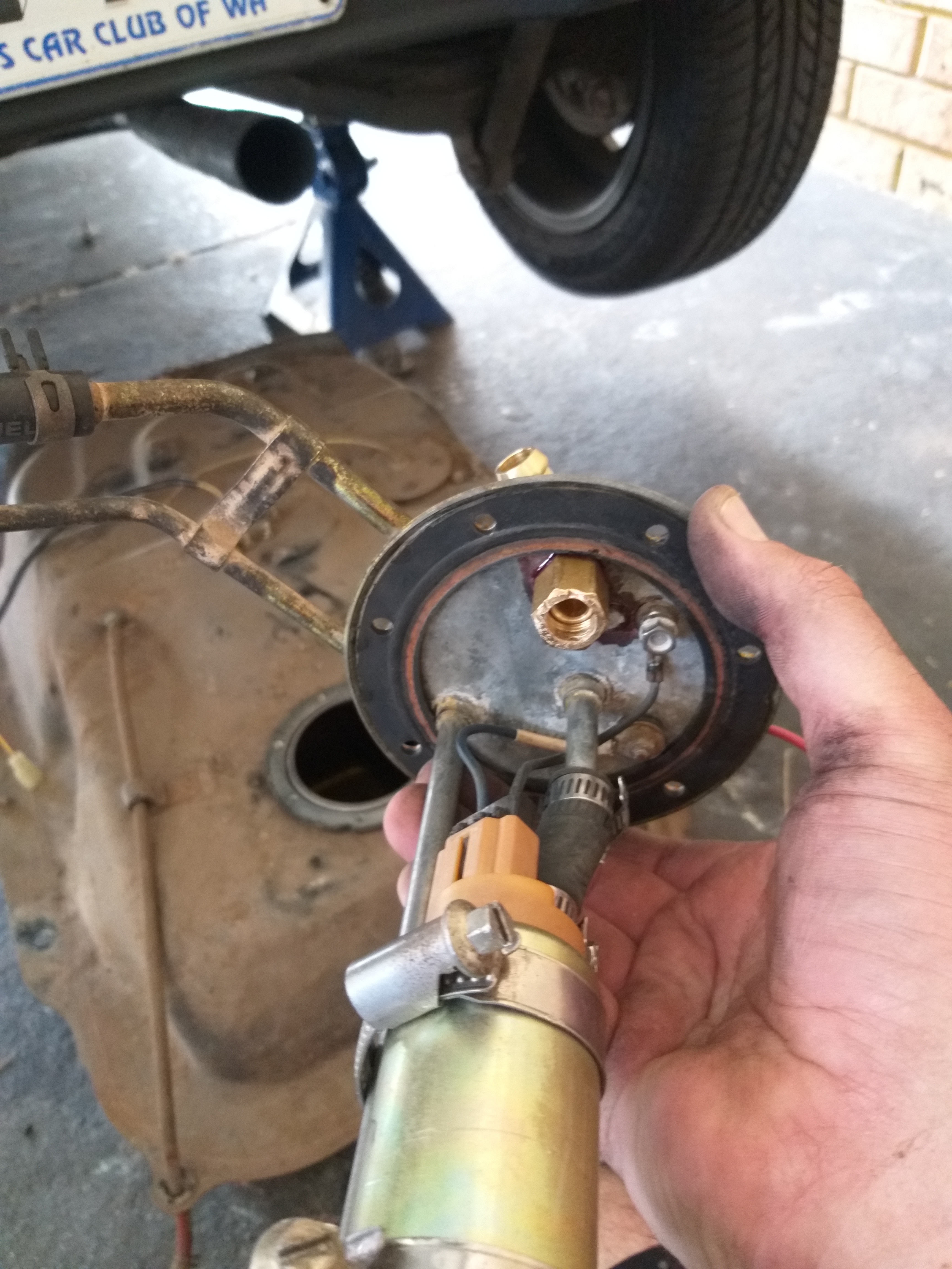

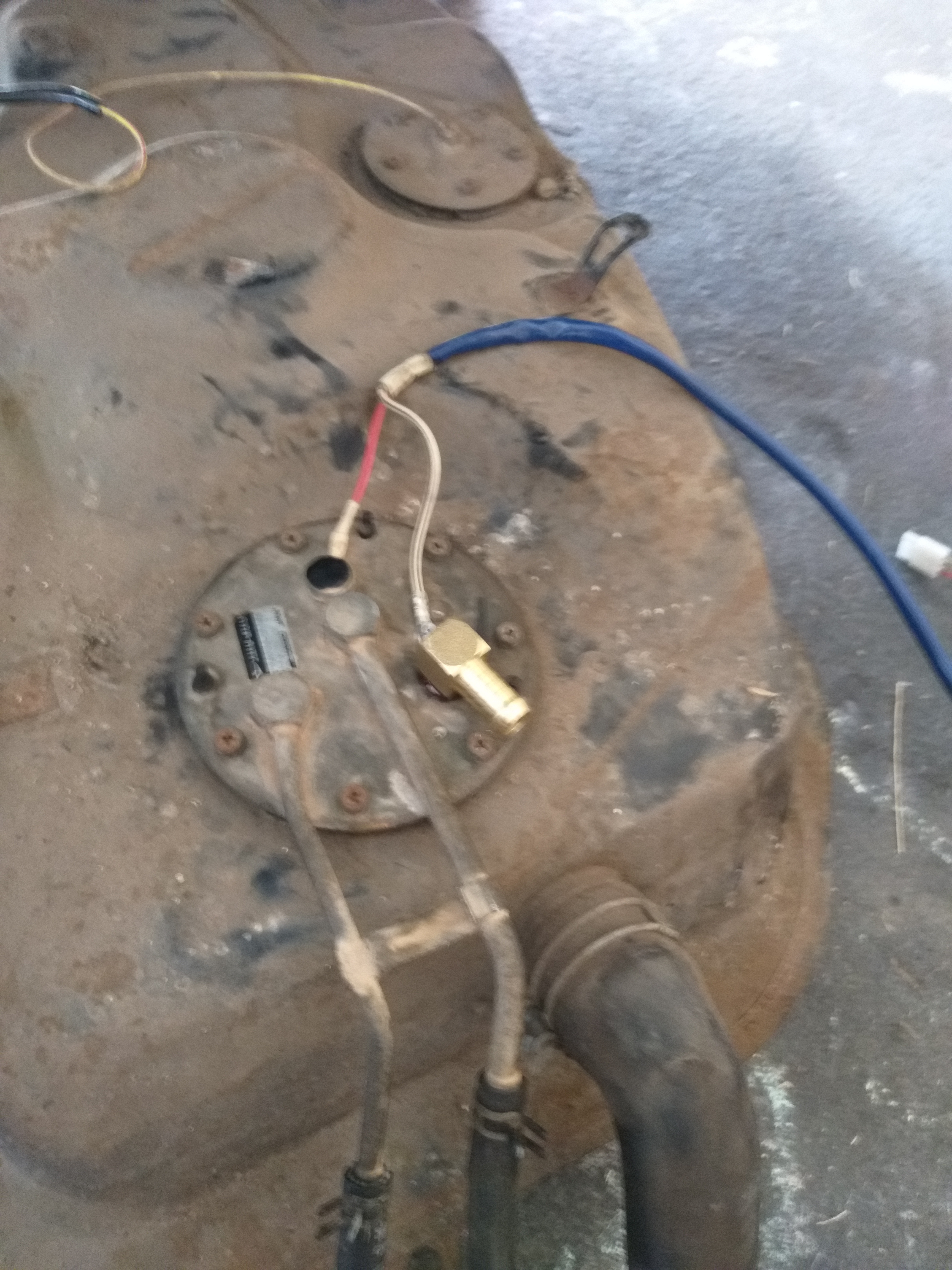

Yesterday I fitted a fuel tank breather, you know the one that goes from the tank to the filler neck just under the cap?
I’m running the efi fuel cradle in the carby fuel tank which doesn’t have the breather on the cradle, it’s on the tank unlike the carby version which is on the cradle.

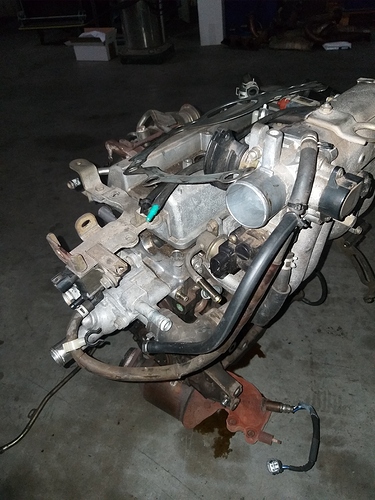

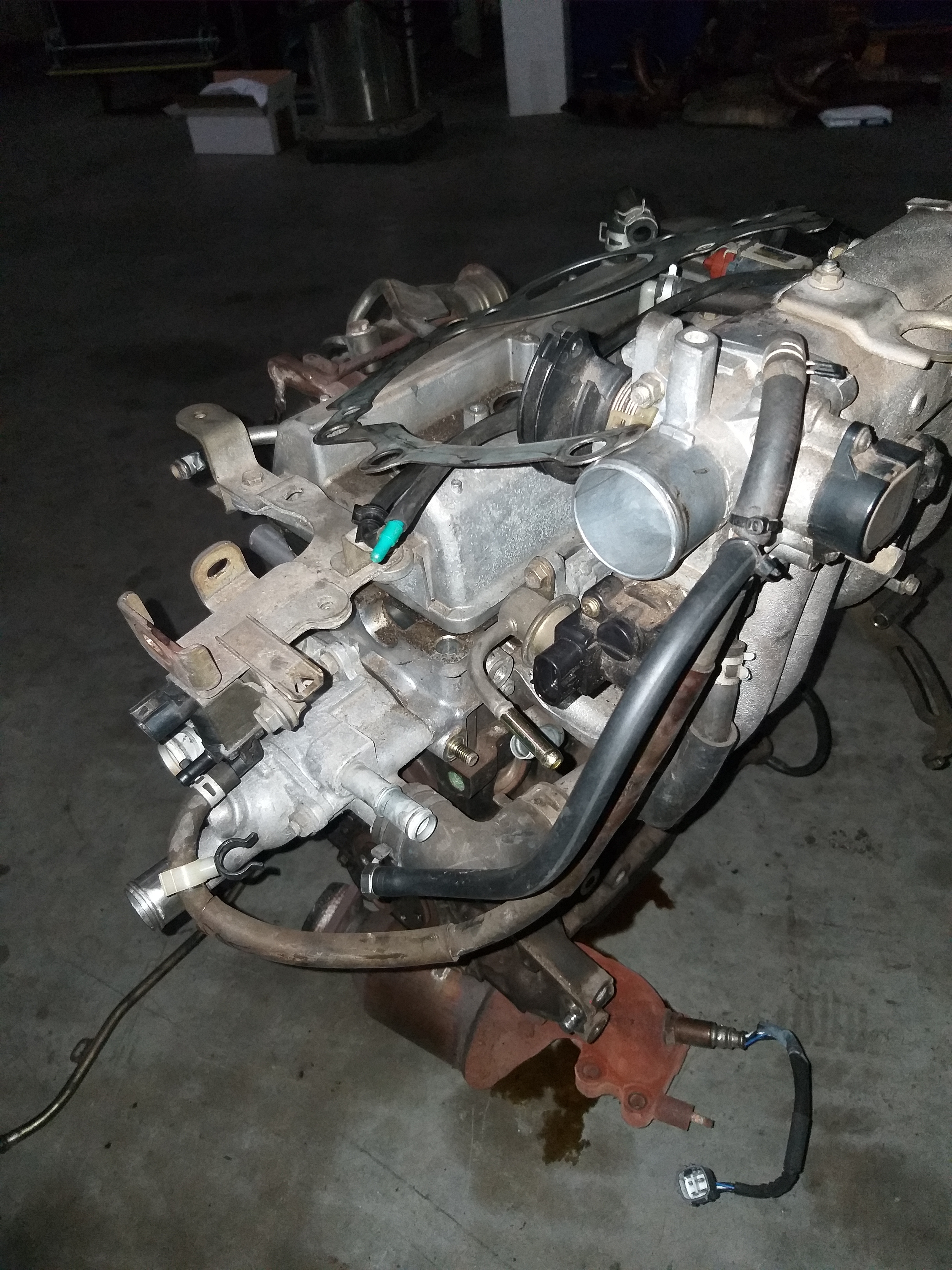

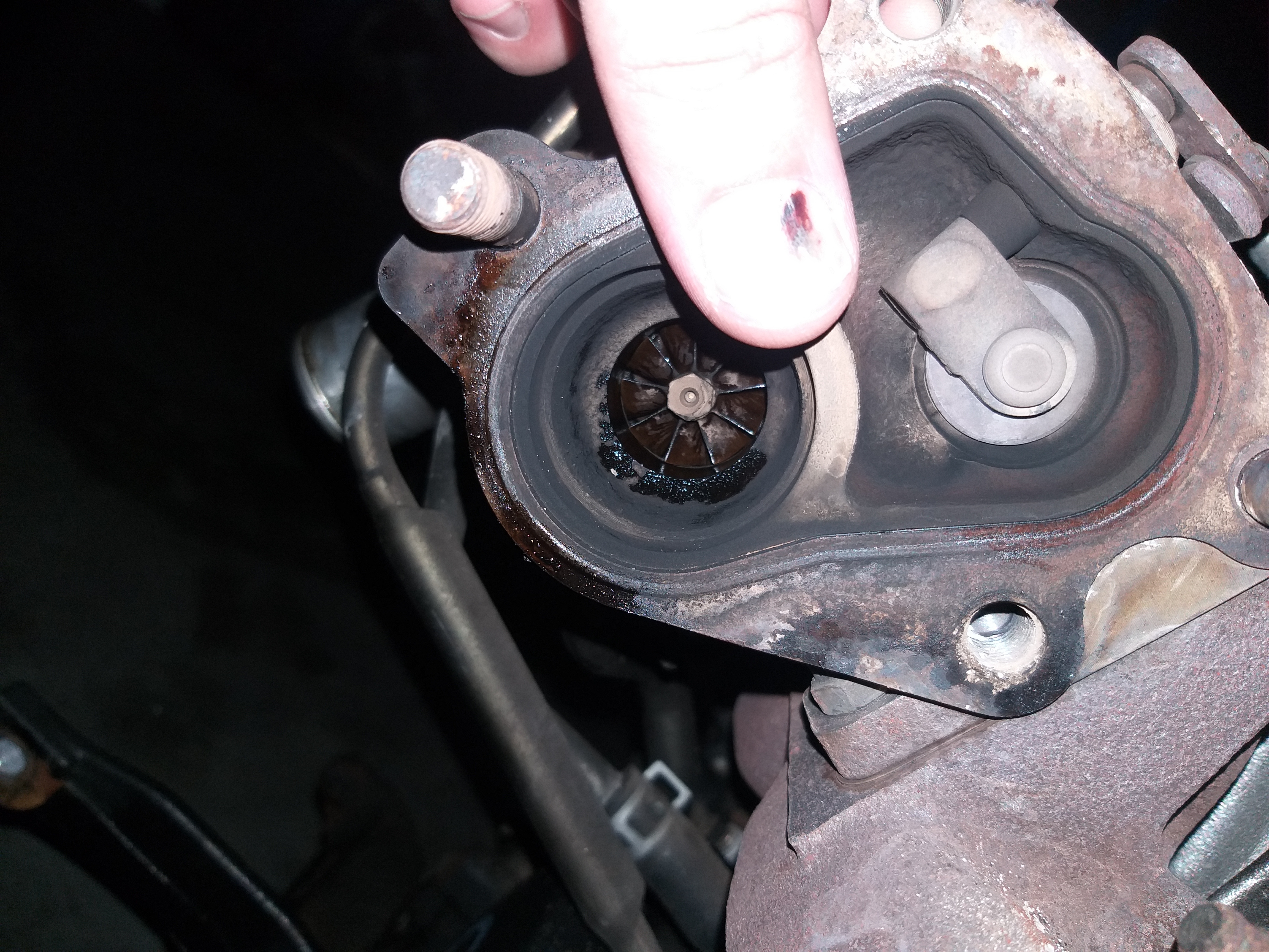

I’m saving a complete jb-det from work, it came from a l880k copen. It’s not useable as the rings are shot but I was just going to keep a few bits as spares rather than see them binned.
It’s got a good turbo aswell, so I may use it to turbo my efgl using a ej factory turbo manifold.
Which means I’ll have to look at management and I’m leaning towards a Everything Fuel Injection ecu who is based in Tasmania. They are pretty cheap, which is what I like. $290 from memory.

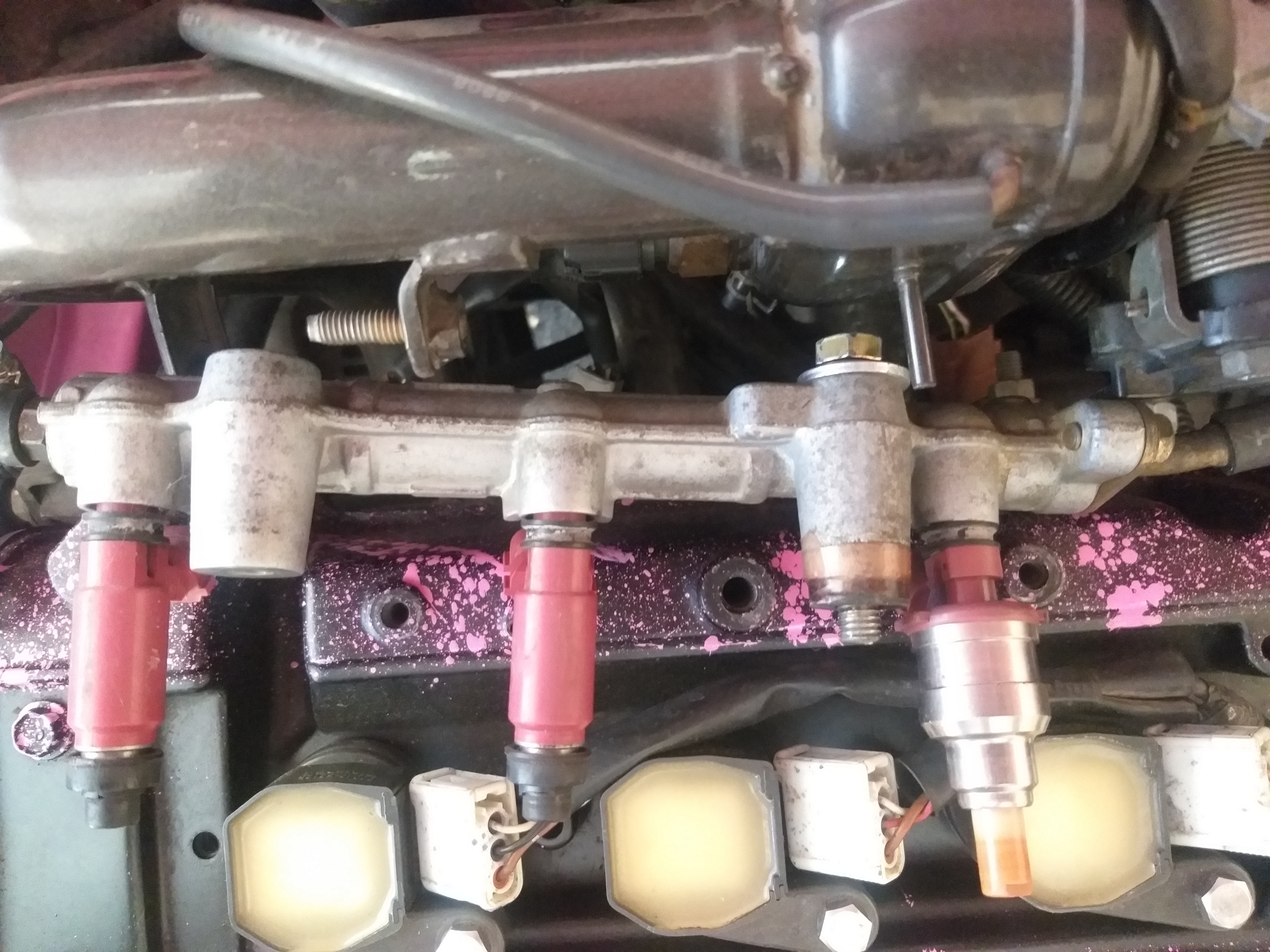

In regards to my injector problem. I tried the ef-el injectors, they do fit the head and rail but unfortunately their width means they foul on the plastic rail spacers so I won’t be using them.
oh bugga about the injectors I really thought they may be the solution.
also why not rebuild the jbdet?
Me too, I could get rough and start shaving the spacers.
Could rebuild the jbdet, as I can have engine loom and subframe too, although I’ve no idea if the l880k subframe is a direct bolt up to the L500. It’s just a matter of cost I guess and what else could possibly be worn inside. My boss actually imported a secondhand one out of Japan to replace it, so he must of thought that was the cheaper way to go than rebuild.

If your in no hurry with the jb then it would definitely be worth it. @FrAsErTaG put an jbdet in his trxx yrs ago and it was an efgl gearbox that fit up to it. I think mc hammer was involved a little bit also to fit it but that would be a great upgrade.
Do you know if the engine mounts lined up?
@frasertag would have a better Idea as he is the only one I know that has done it. All the info was on the old daiforum forum but that has now been gone over a year.
I’ll see if @FrAsErTaG can shed some light on the conversion.
