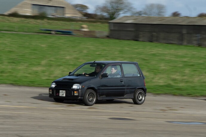

I also competed in an auto test event on the weekend, managed to achieve 5th out of 20 cars being beaten only by cars with semi slicks so very happy.
Its extremely capable despite it having a fraction of the power of the other cars but small things that are needed is the suspension being fine tuned and the steering rack being upgraded like everyone says which leads me onto my question.

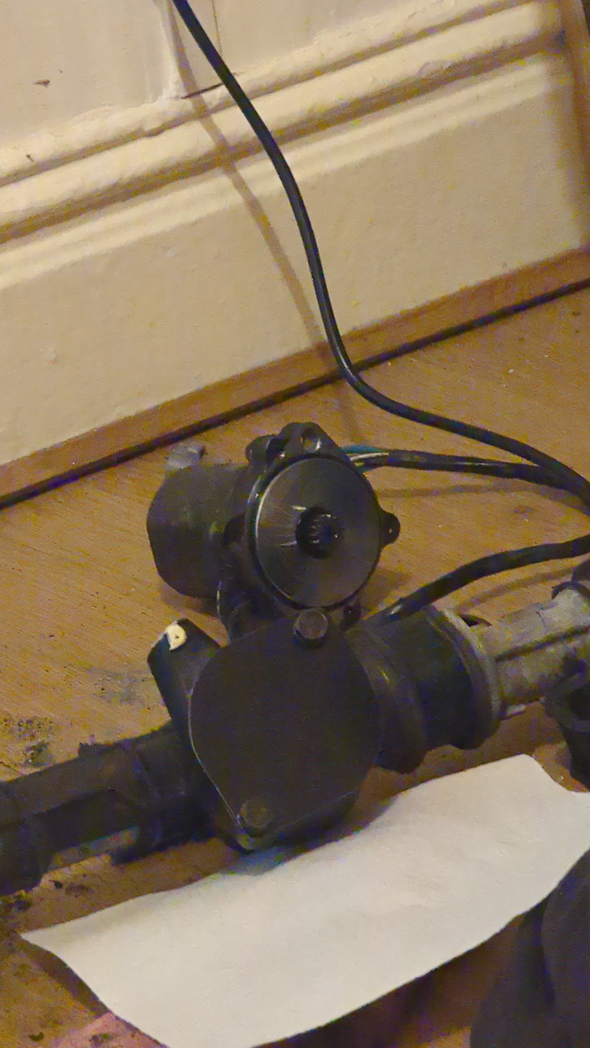

Upgrades have been made to the car, I pulled out my old steering rack and swapped in my TRXX rack bringing the turns down from 4 to 3.25 and them Fitted a quick release to the steering wheel.
When fitting the other rack, to help with clearance and since it was unnecessary, I did remove the motor on the rack and blanked it off which made installation possible without dropping the subframe entirely.
I replaced her o ring under the motor and used some rtv to seal the epicyclic gearbox inside up and prevent the oil leaking but works great! The tie rods need replacing so will do that soon and the rack feels more worn than the previous (because it is) but feels way better overall.

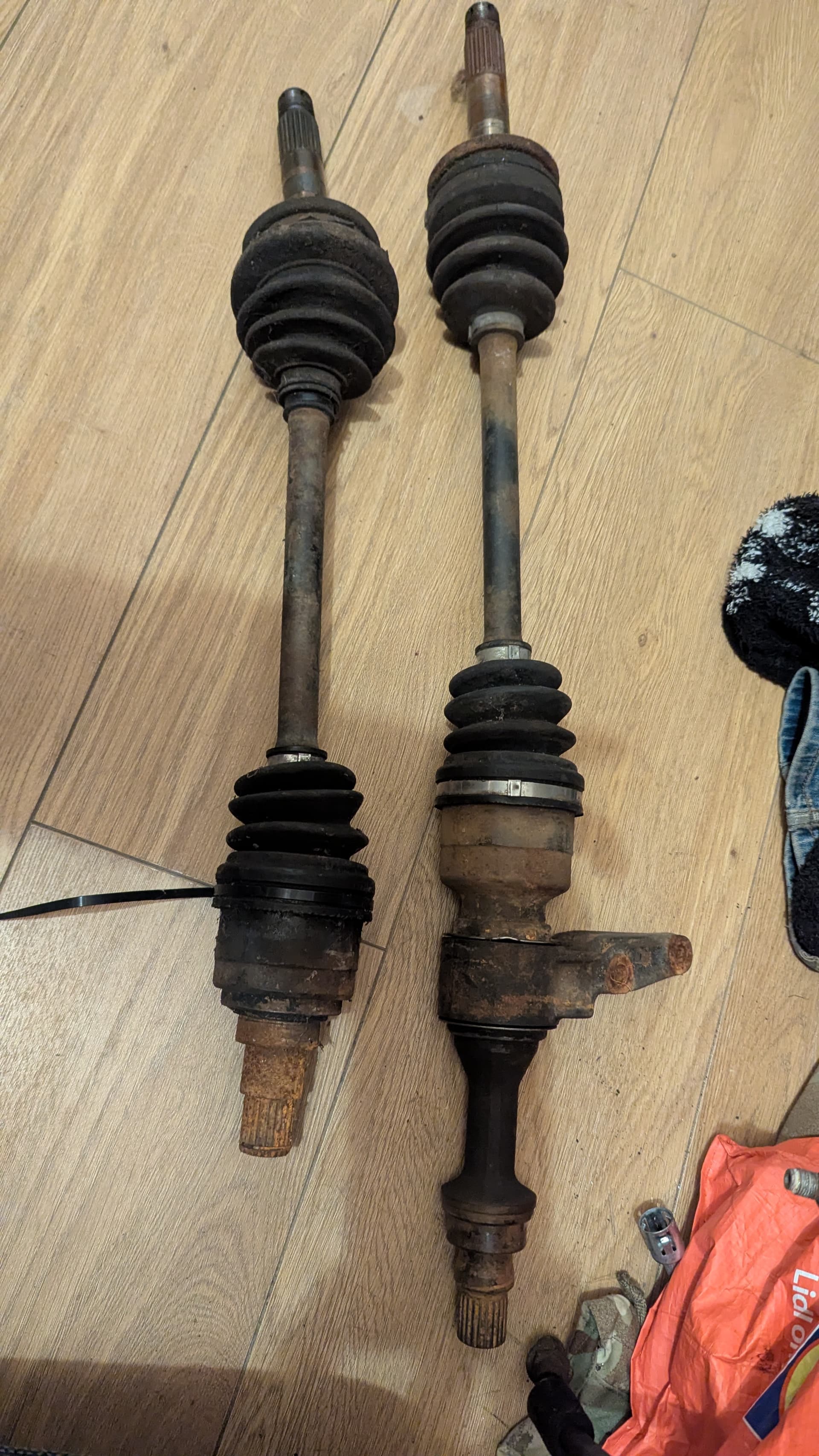

Next thing on my upgrade list is the drivetrain. Long term I wanna drop a jb-det in but for now doing what I can. I have the original TRXX gearbox and driveshafts and I know it’s supposed to be an LSD but from the jack shafts. Which makes me ponder, to use the LSD function, do I need to swap the entire transmission or just the drive shafts as clearly one is far easier than the other.
I’ve attached a picture of the driveshafts I have to aid.
the driverside shaft is only a jackshaft that is used to distribute the equal power to both sides of the car by giving equal length drive shafts to each side. It is not an LSD. It is similar but the LSD has like an outer casing and teeth in it also where in fits into the box. Use the jackshaft They are good.
Ahhhh okay I understand. That makes sense, alright I’ll probably fit that then. Needs a good clean up and new boots first. Thank you for the information.
Your most welcome. :slight_smile:

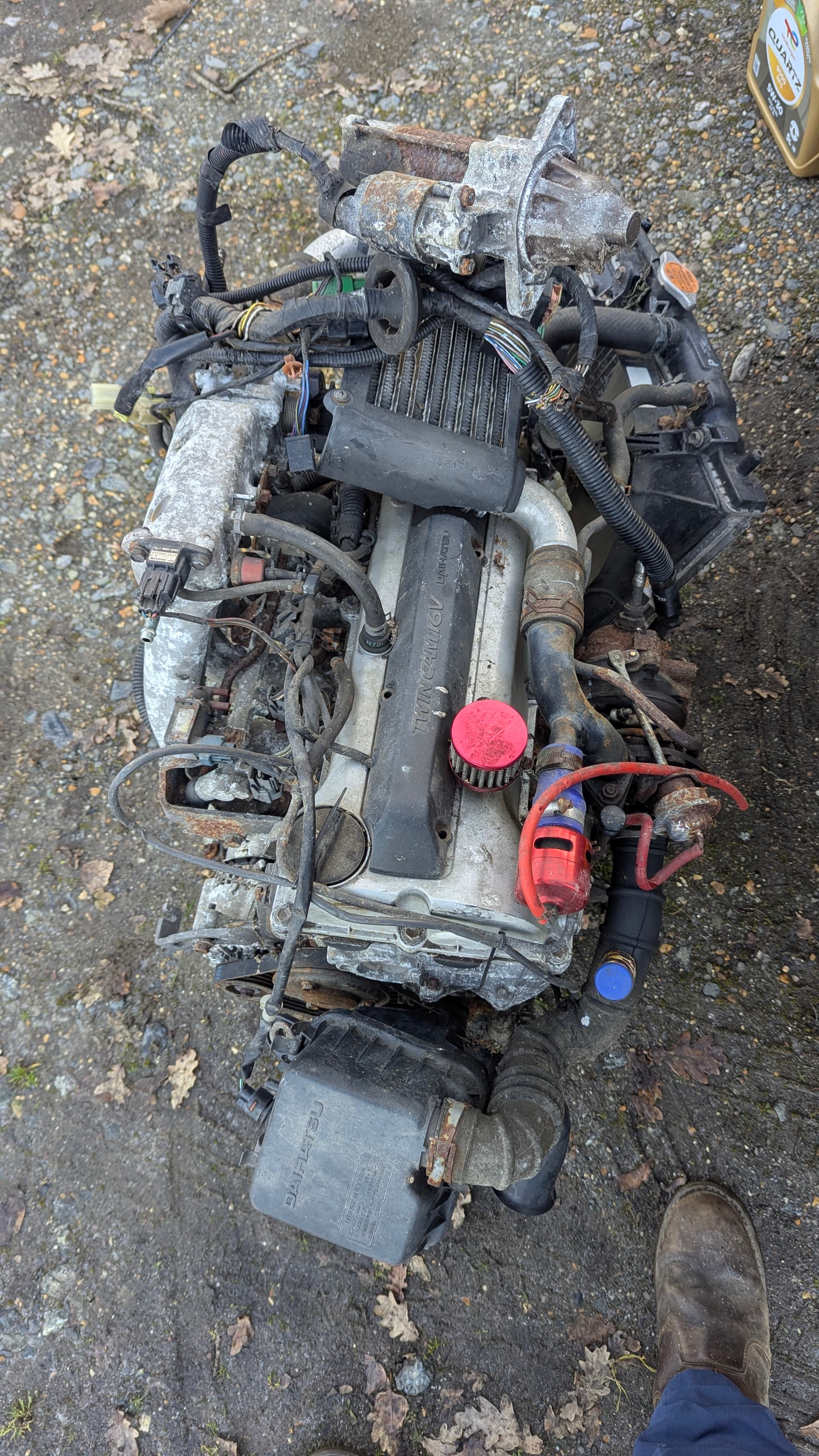

Time for another post, rebuilt my jack shaft to install into my car but haven’t changed my mind and made a bit of impulse purchase but for big improvement. I’ve bought a jb-jl engine as it was going decently cheap and has the traits I was looking for.
So I’m going to start preparing the engine, my spare subframe and all the other bits to hopefully drop this lump in. The biggest worry is just the wiring to the body loom but that comes from my lack of experience! Doesn’t appear to be too many wires, just need to figure out which is for what.

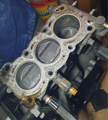

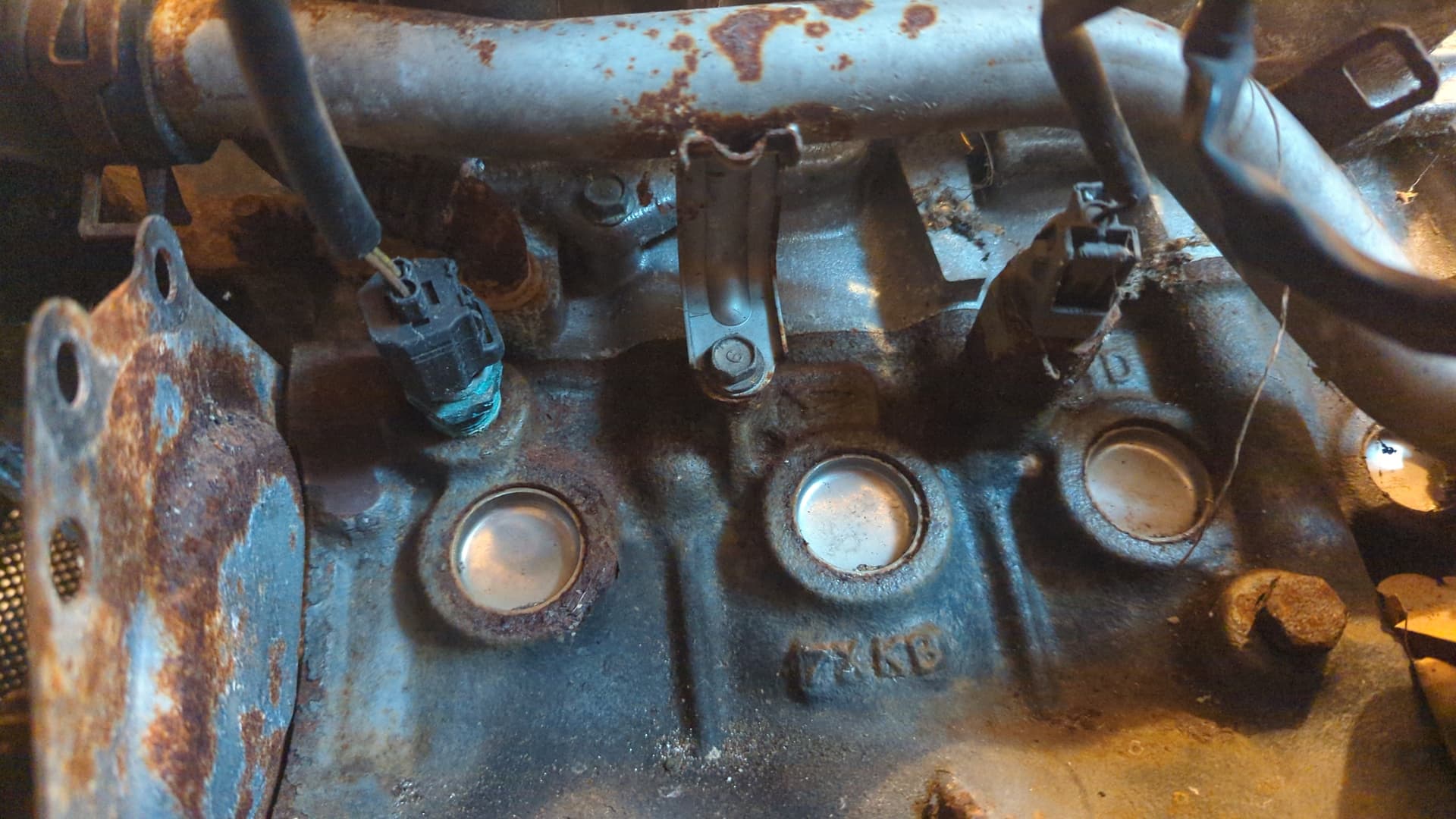

currently going through my jb-jl for a standalone and so far I’ve seen that there appears to be a water temp sensor at the coolant inlet and outlet of the engine but I’ve now seen these two sensors at the back of the block, are these also water coolant sensors? Or is the one on the left coolant and the one on the right oil?
Atleast one will be coolant. the one closer to the gearbox side. Not sure on the other but looks like it. Some dais did have knock sensor’s also though. None of mine did, but they had the wire for them so no Idea what they look like.
Okay interesting, I plan to go speeduino so I doubt. I’ll use all of the sensors, only the crucial ones so I may just ignore some of them. Thank you though!
This is what I’ve gathered from my investigations, the 2 one wire coolant temp sensors are either for ecu imput or cluster temp I’d say.
Agreed, one of them must feed the ECU for managing starting when cold so I won’t be surprised if the other manages the gauge. One exists past the thermostat so surely that one would read little till the thermostat opens.
