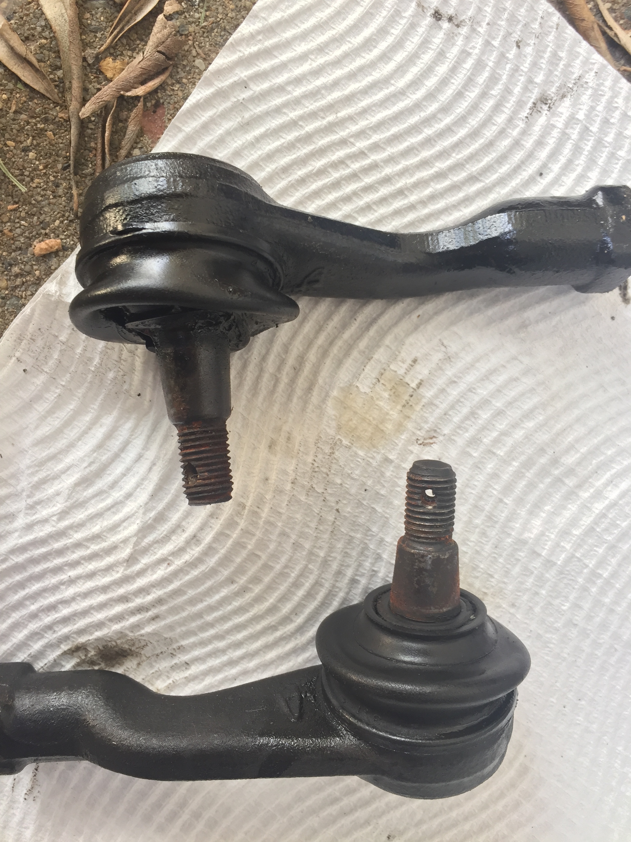

Had a bit more time this morning and was able to replace the inner oil seals and the outer tie rod ends. As you can see in the pic the tie rod ends were pretty had it.

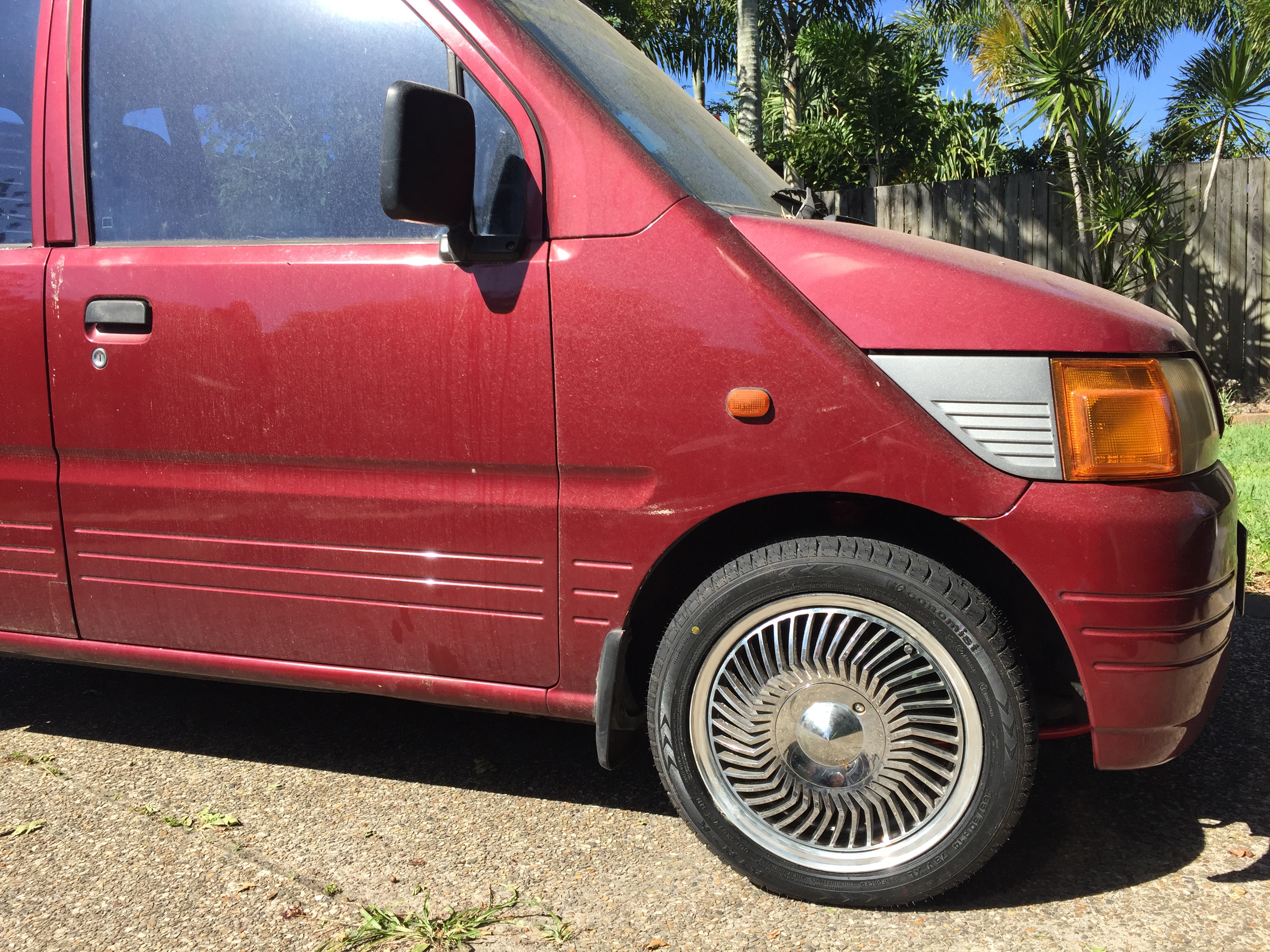

Over the weekend though I reached a big milestone! Breatie was back on its wheels and driving! Front end is basically done, except for a few teething issues which I’ll work through over the next little while.
Next is rear shocks and springs to be done this coming weekend.
I’d like to take the opportunity to thank @evilhighway. Through the course of this build he has been a great source of knowledge, inspiration and encouragement.
I just glad to help mate and happy to see dirty bertie back on it wheels and new sexy wheels too. Well done for persevering and not giving up.
DAYUM, Those wheels look Awesome on the move
Thanks Dale! I’ll get a pic of the whole car once the rear set are on and the car is clean

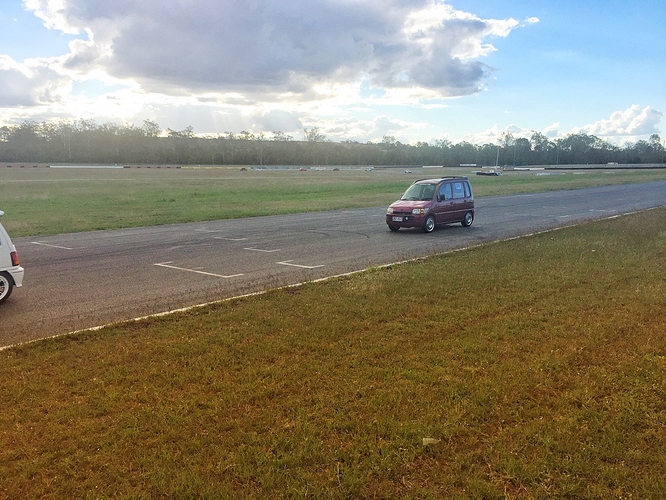

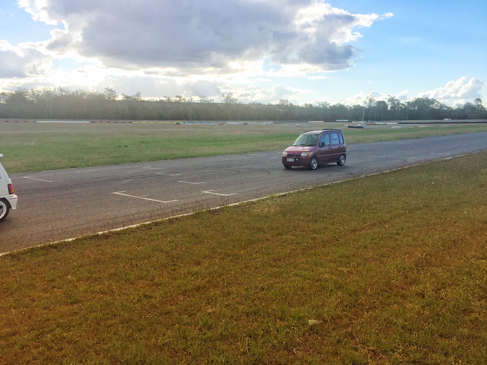

1st Session: I threw caution to the wind and felt like I pushed hard, best time or 1:24.52 checked under the car and no extra leaking from the axle. Excellent!
2nd Session: The reality of not being able to get home and to work the next day if there was more issue with the axle hit home. I deiced to be not so hard on the car and use a higher gear around all the corners so as to be not so hard on the gearbox, drive train and engine. Stupidly, I was 5.5 seconds quicker for my fastest lap with a 1:18.97.
3rd Session: Felt like I got my lines much better and really nailed the last chicane and final corner. Even though I was holding back even more I still was able to get a 1:18.02. There was reports from other drivers that Bertie was cocking the rear wheels on these laps.
I’m really happy with my progress over the day. I feel like if I wasn’t worried about not being able to get home and linked some corners together I would definitely have dropped into the 1:17s, maybe further. I was surprised how much wheel work was needed to get the Move to turn and can definitely see the benefit of @Mr_Gormsby faster steering rack.
I am unsure what my next steps should be to make it faster next time. The amount of roll was disconcerting , but the cocked rear wheels shows the weight was going to the right areas. As Mr G mentioned yesterday maybe I just have to ‘Trust the grip’
