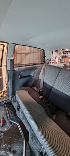

I went to the local paint supplies shop to match up some vinyl paint for the plastic trim panels as the roof lining is now a slightly different colour to factory. What a difference! I was a little unsure at first but im glad i have sprayed them.

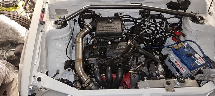

Power is on! Ive hooked up all the battery cables and turned the key to accessories. Currently going through and sorting out some minor issues.

So now that i have finished connecting the fuel tank and wiring. Today i got the bissel out and washed the back seats. The sun was out so dried in no time!

Took the spark plugs out to crank the engine and build oil pressure. Once that was done i installed new plugs that i gapped down to 0.6mm. I have trialled different plugs over the years and these i found worked the best and lasted the longest. They were on sale for less than half price so i bought all that the shop had stocked :rofl:
Filled the fuel tank, no leaks! HooRay! Primed the fuel to the carby and attempted to start the engine. With afew bangs and pops i thought she would be running but on a closer look, the plunger seal has run dry and isnt working as i should. Parts ordered. Afew more weeks!

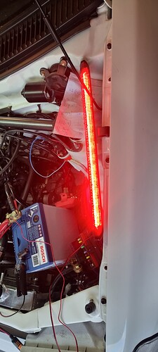

I ended up buying a complete sealed brake light replacement for the spoiler. Original plans were to take the circuit board out and install it into my brake light casing but the whole unit fit inside the casing so i decided to glue it in place.
Just need to wire it in!
All wired in!

Carby issue should be repaired now. Ordered a new accelerator pump and gasket kit. The old rubber seal was a little out of shape. While it was apart i ensured the float level was in spec and there were no contaminants or damaged parts. All looked great.
Seeing im running a bigger turbo and more boost pressure. Ive decided to use a small smear of loctite 515 on the gasket mating surfaces to ensuring it stays sealed. Ive used this sealant in lots of high pressure applications on machinery, so why not on the carby. All screws went in with a dob of retaining compound to ensure they stay tight.
Once it was all back together, i tested accelerator and it all felt smooth, i could hear the plunger building pressure and small spray of excess oil from soaking the plunger came out of the sprayer inside the bowl. I think we have a winner!
And its running!
Bled up the oil, topped up the coolant and checked for leaks. Good to go!
