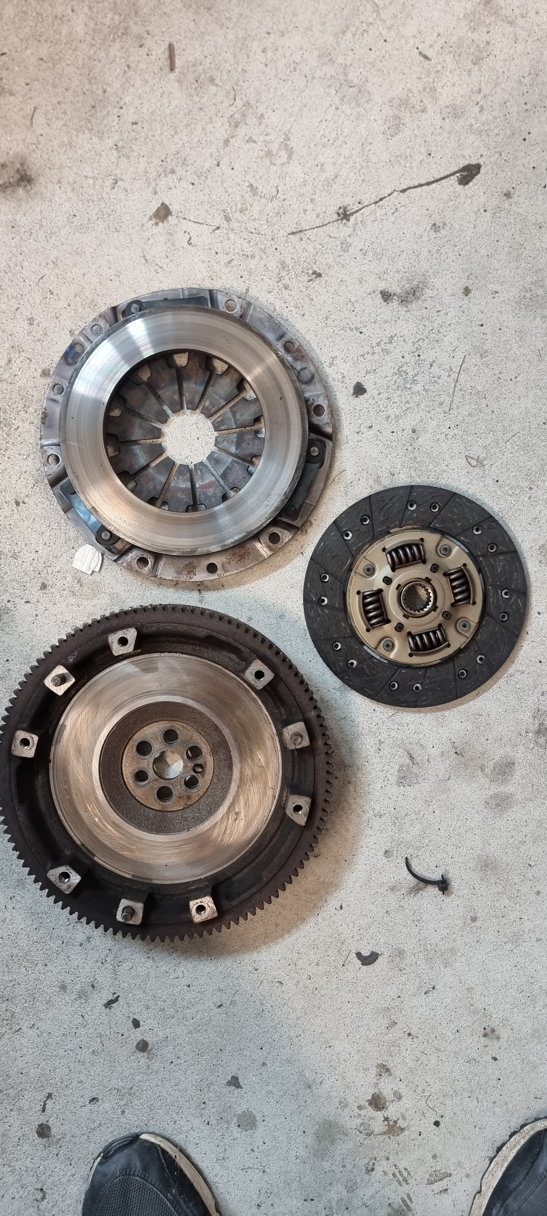

Recently retuned the carby. Secondary jets are drilled to 2.1mm and gauge reading 12-12.5 on the afr. Turned the boost up to 14psi and now having clutch slipping issues! Not seeing the issue until 3rd gear but still not great.
Ive been in contact with a well known clutch expert Jim Berry which has a wealth of knowledge and has been around the industry for years!
Just for abit of info, exedy clutches are made in japan and are good quality. Xtreme are now owned by repco and made in china.
So back to my clutch! Jim tested the pressure plate clamping force for the exedy HD clutch and came out at 400lb. He said even if he was to double that, he has doubts that it will hold up.
In recent conversation with Jim, he wants me to send my current clutch and flywheel so he can do some further investigating on my my clutch has failed and work on making a new clutch to suit my needs.
