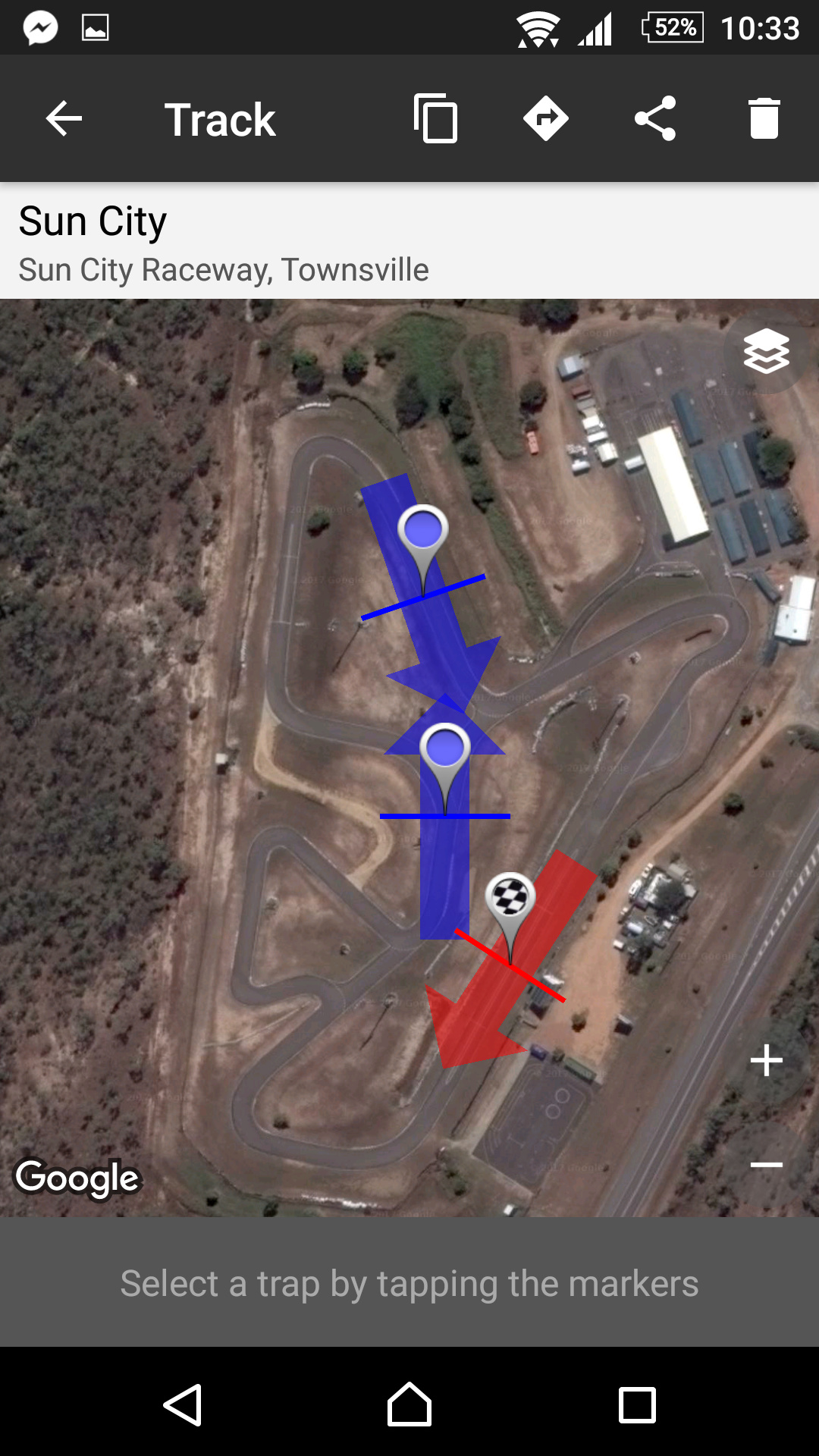

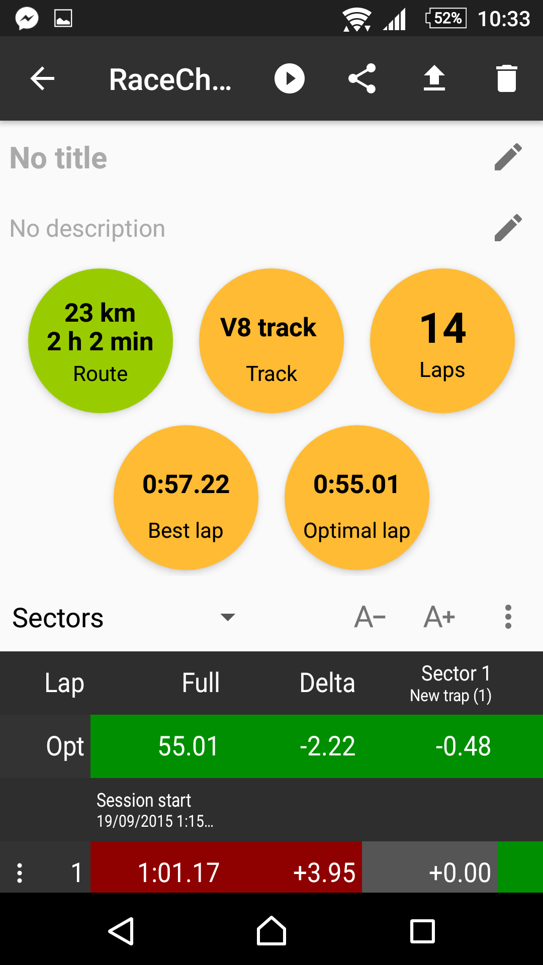

You got a go pro or something man? Also be sure if you have an android phone to download an app called racechrono… It’s essentially a gps timing app that allows you to set start finish lines and timing splits… You can then mount your phone on your dash and it gives you live timing with splits and sector times… It’s an awesome app…

Yeah racechrono is awesome man… Honestly its one of the few apps I have ever paid for… The free version is still good though, it’s so good having live timing flash up with green or red sectors… Makes you feel like a proper race car driver hahahah

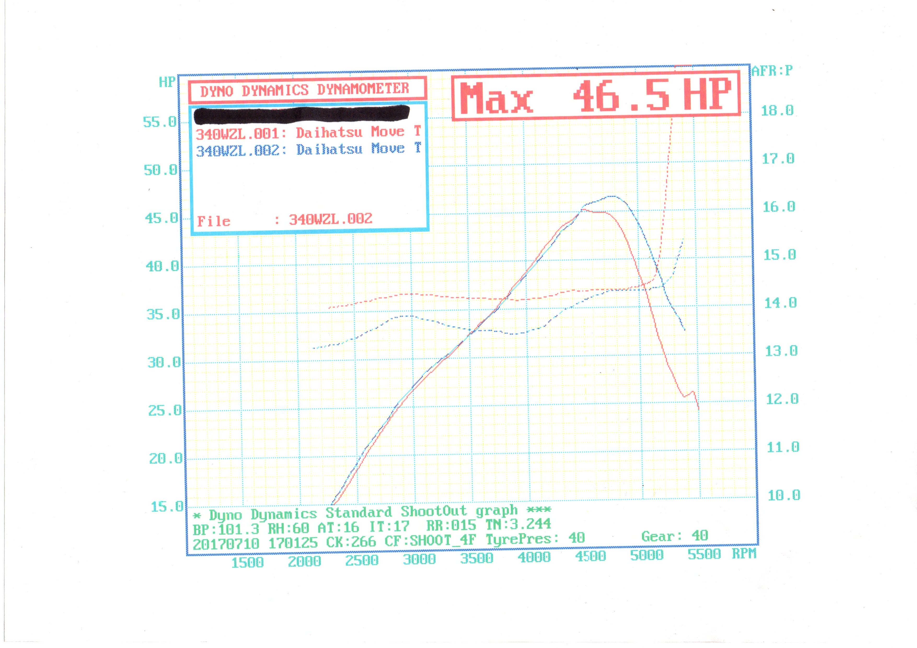

So the last bit was what power did this shit box make?
46hp but all things considered its still better than a stock ef/el
You can see on here where we had to stop and these were to stop with the afr’s going off the charts so couldnt go power anymore from there .
The red was a basic zero on the greddy and the blue was after we put in a +40 fuel from about 2200rpm to 7000rpm
You can see where we hit boost each time where the fuel would just lean out. (the 2 lower lines where they turn straight up)
