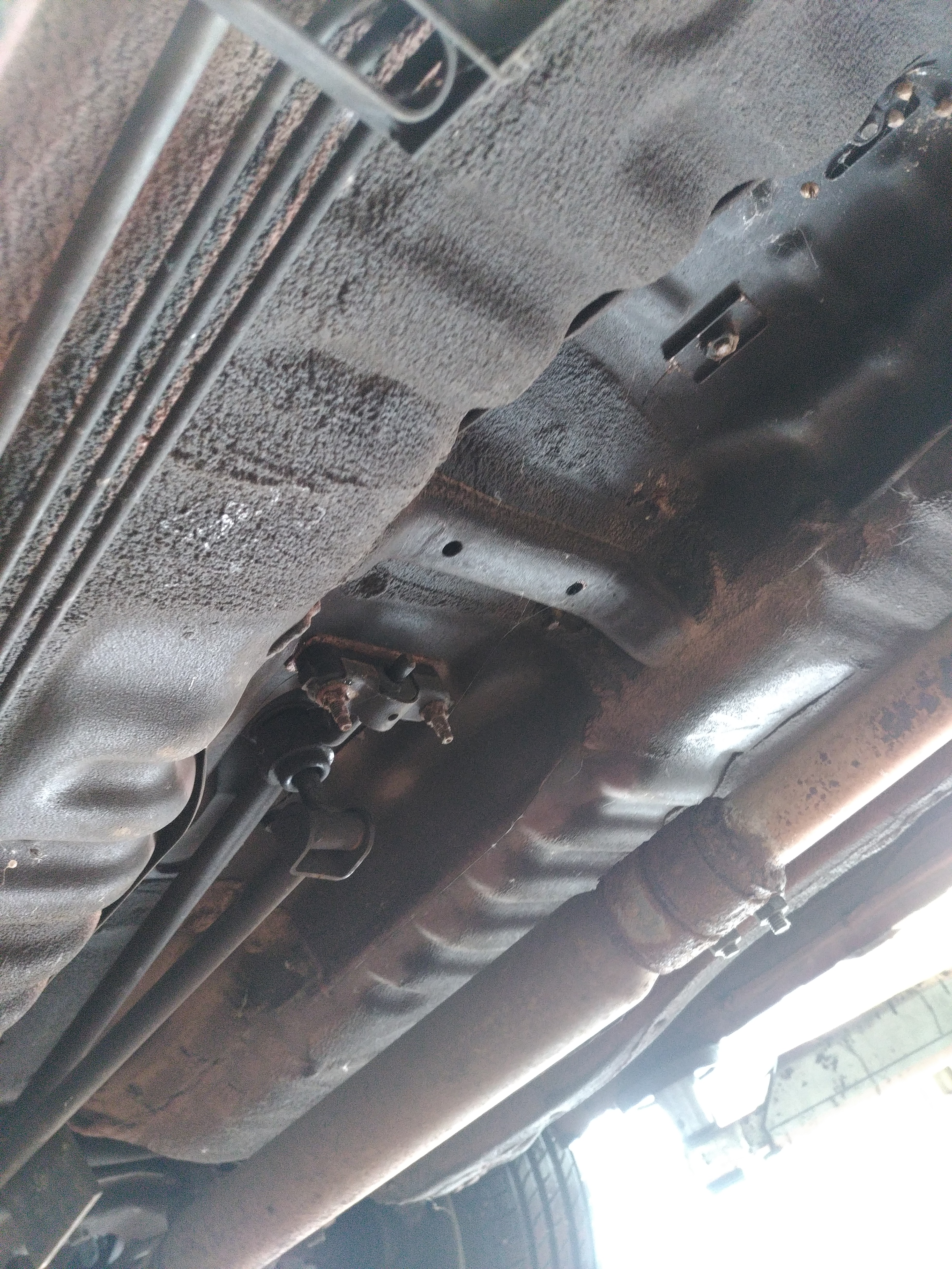

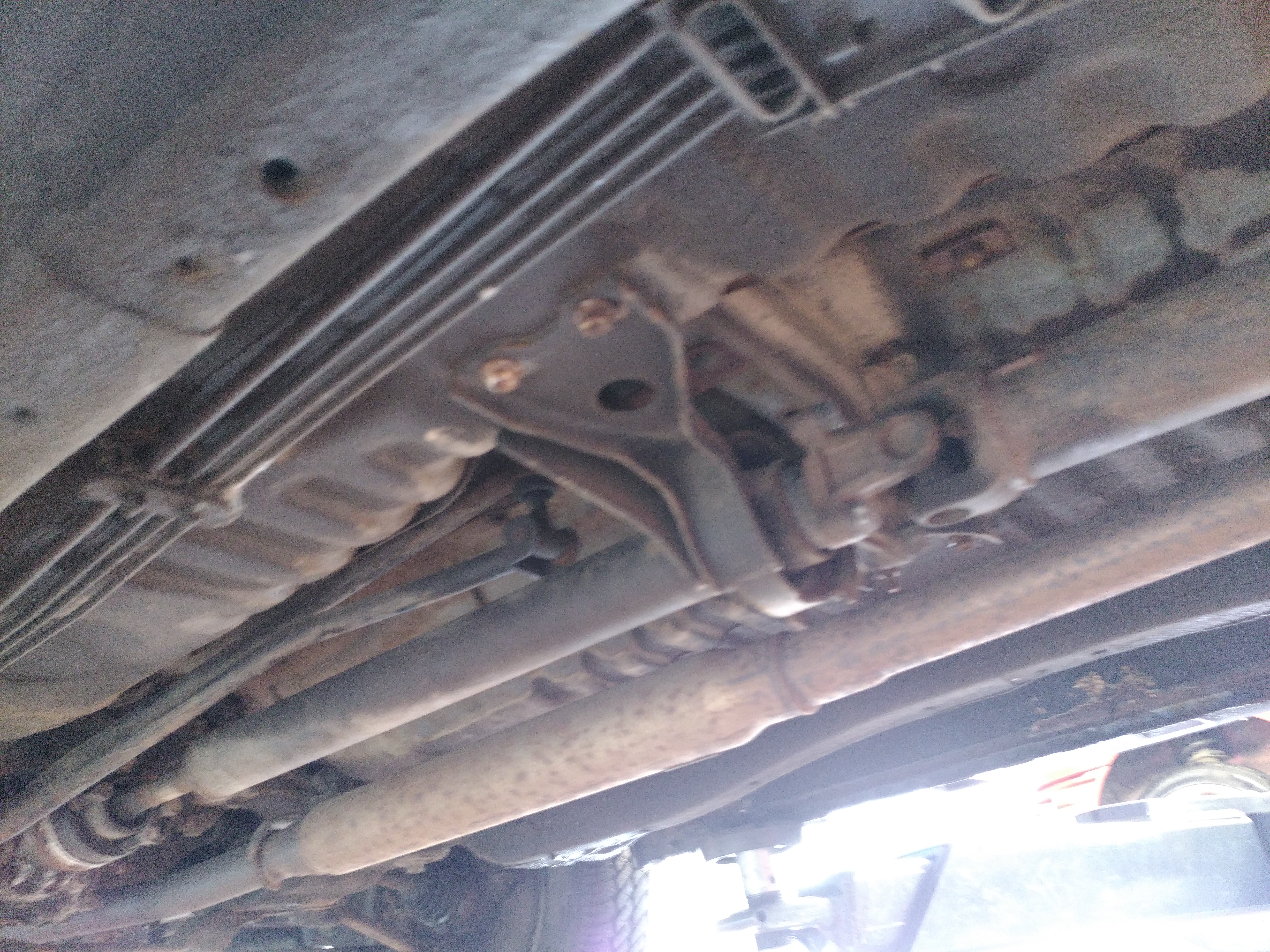

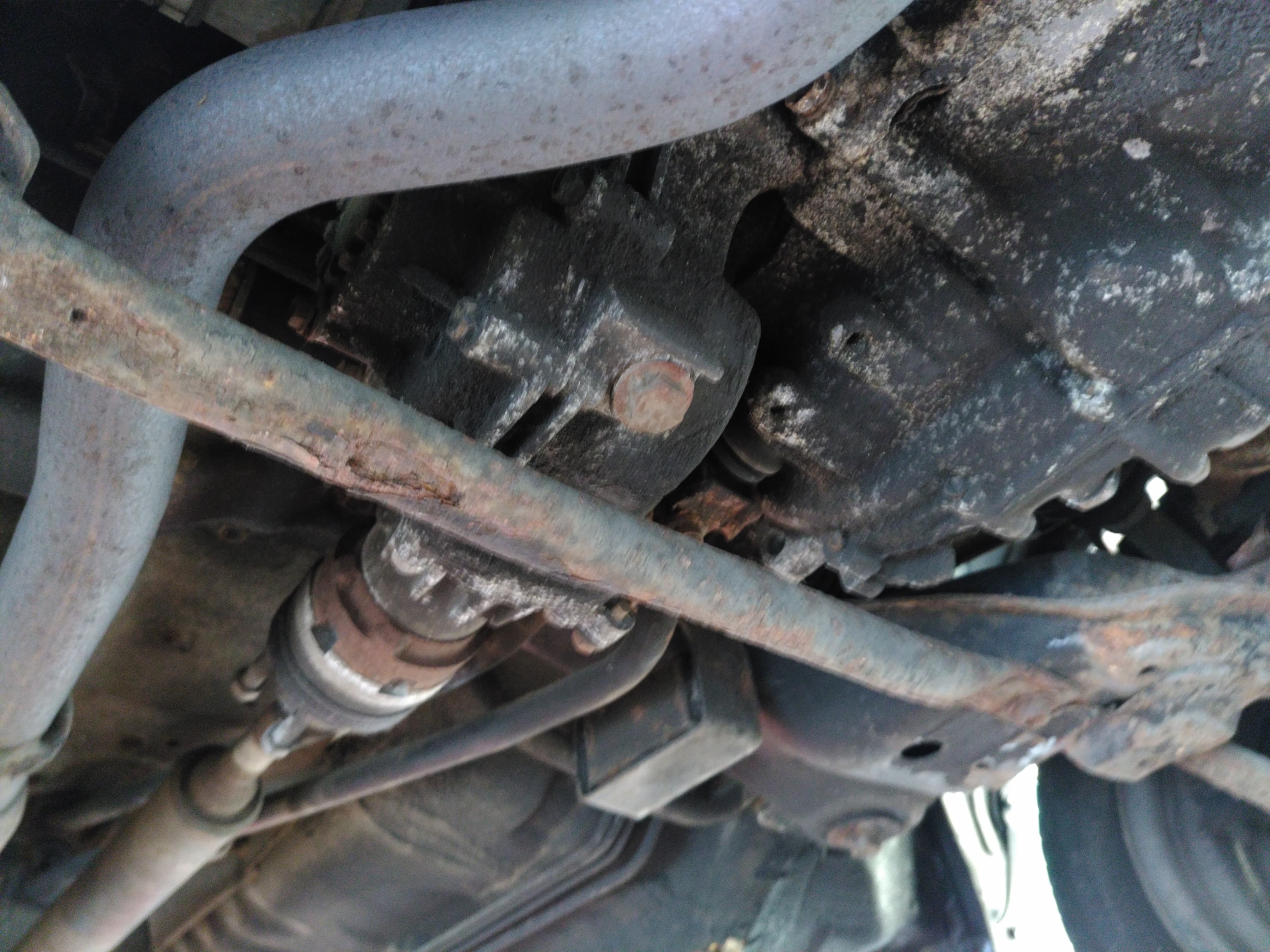

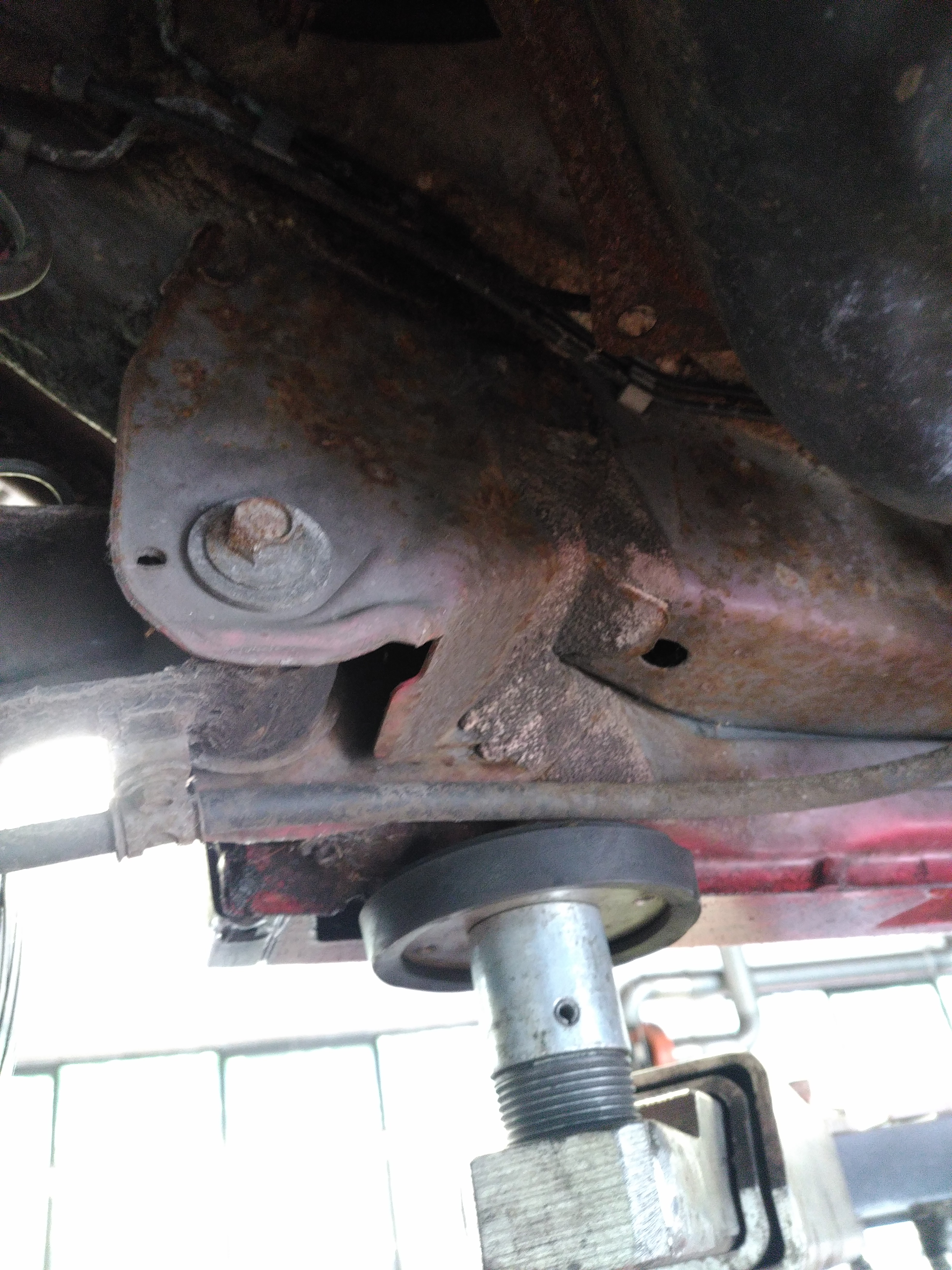

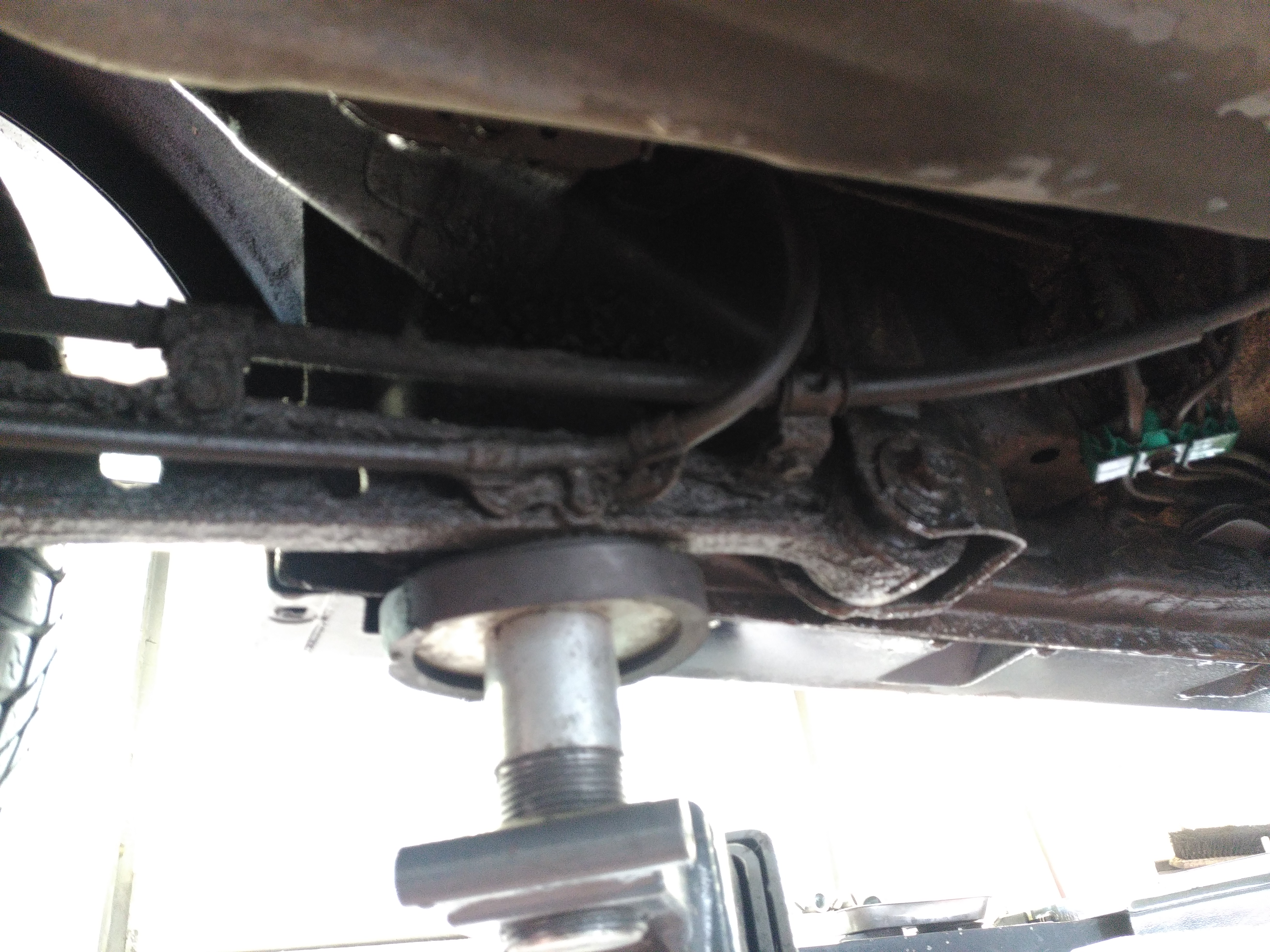

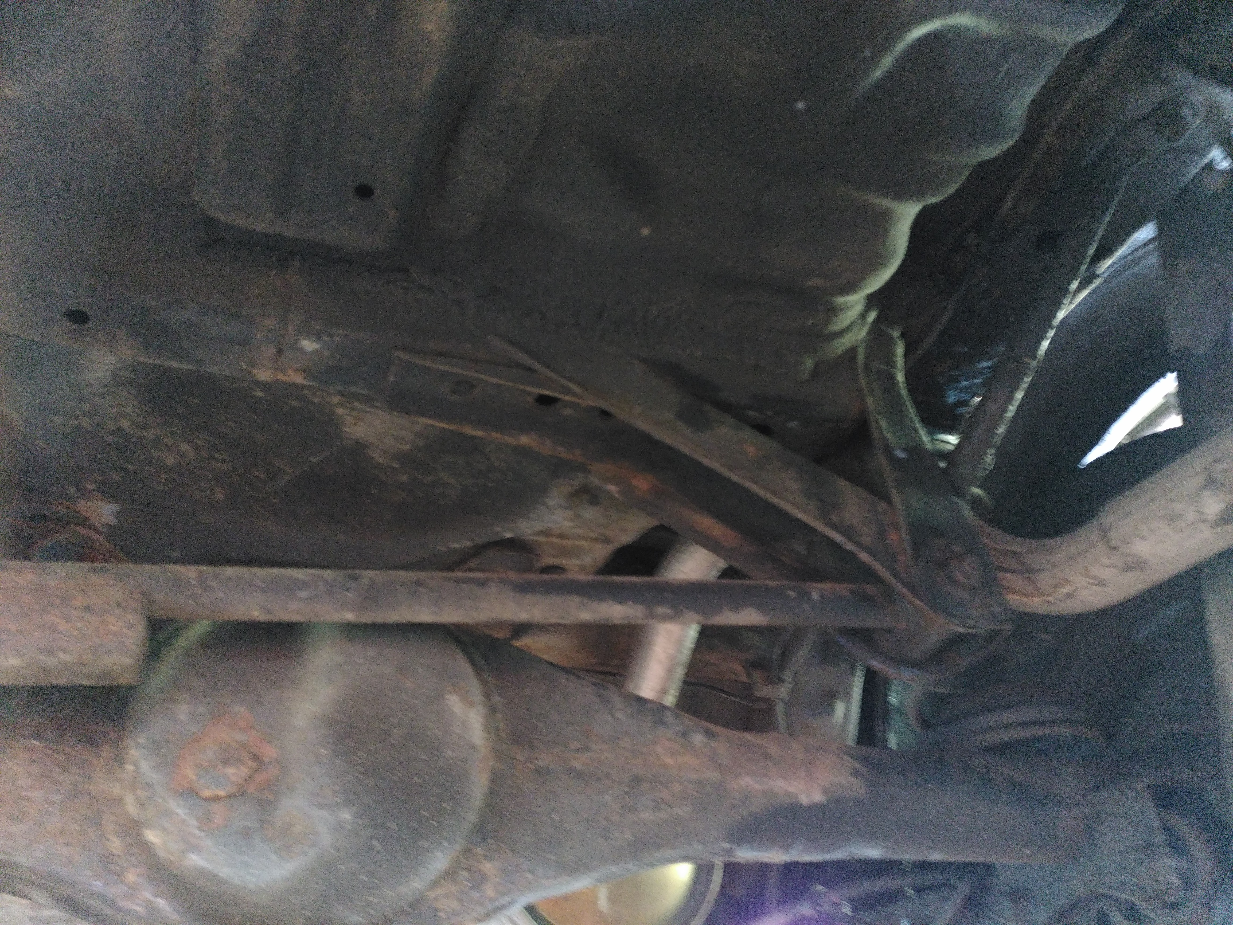

Ok looks like the awd conversion might not be so straight forward, the mounts fro the rear axle are further forward on the car, there is a bracket for the panhard bar and some holes must be drilled to mount the centre bearing bracket for the tailshaft. All the mounts are butt welded on and drilling out the welds and welding the mounts onto the other car is not a problem and really not so much work but the problem will be… wait for it… you guessed it!! TÜV haha
My Boss seems to have a lot of interest in the build which is nice and he has offered to make some enquiries for me about how to go about getting it registered. He has a lot of pull in the automotive community and knows a lot of people here in Bremen because he is always doing stuff for the community, he is an assessor for the final exams for apprentice mechanics and we do a lot of training at our workshop for apprentice mechanics from eastern European countries. I think having him on side will be a big help with all this tuv shit and im sure he could push them a bit to get everything passed.

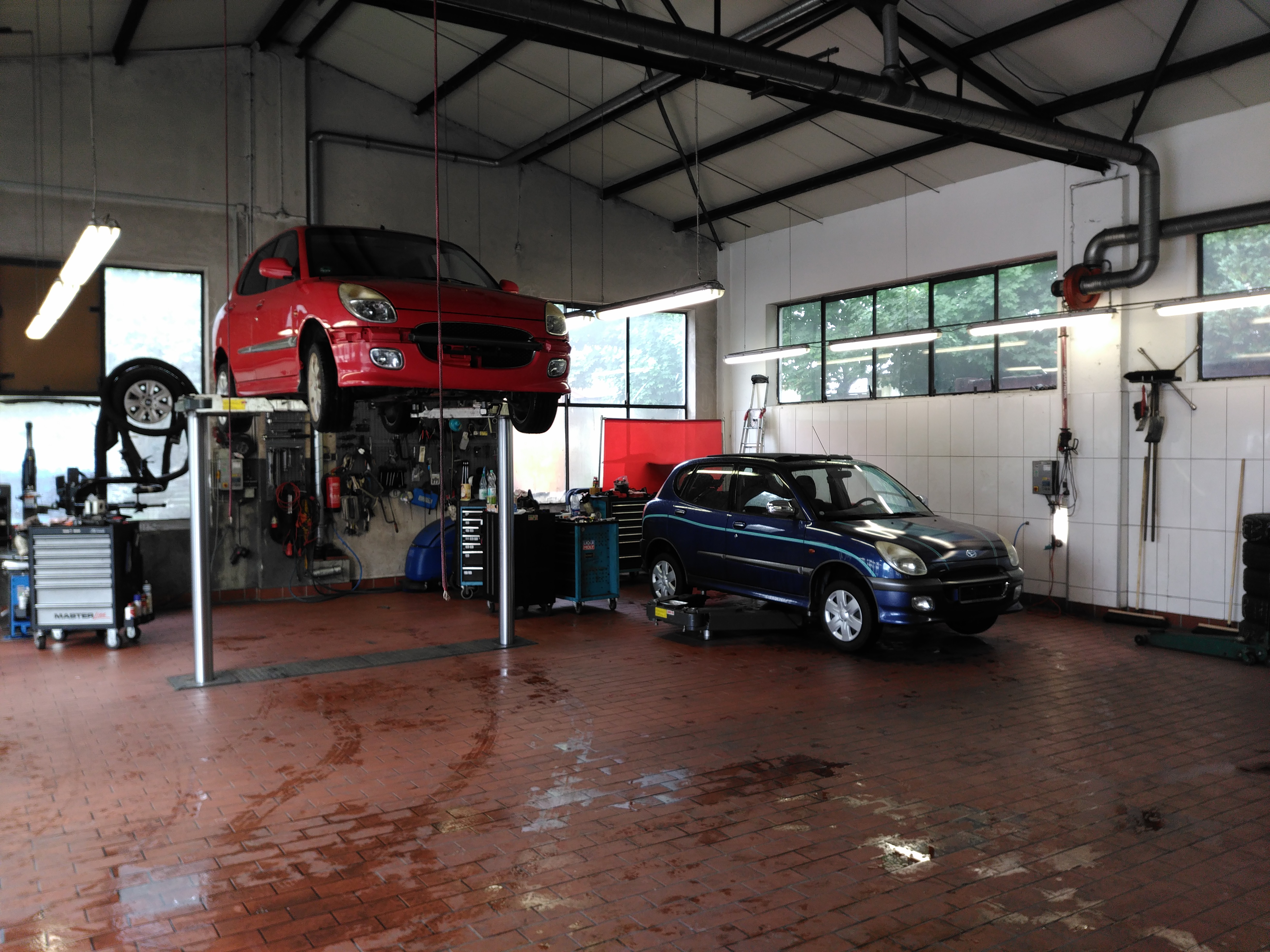

Anyway here are some photos
blue and red sitting side by side

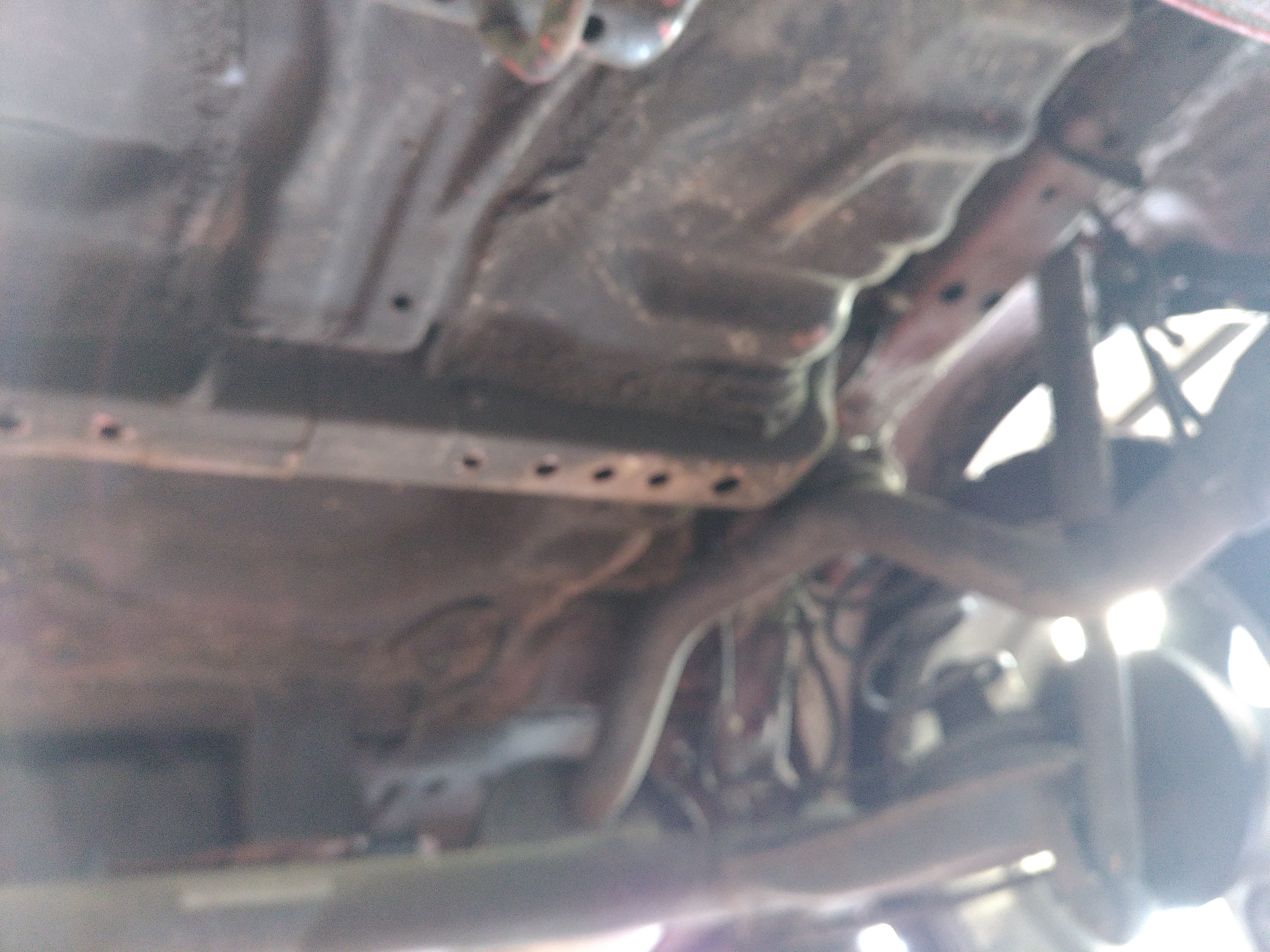

here is the bracket for the panhard bar and then where this bracket would need to go on red

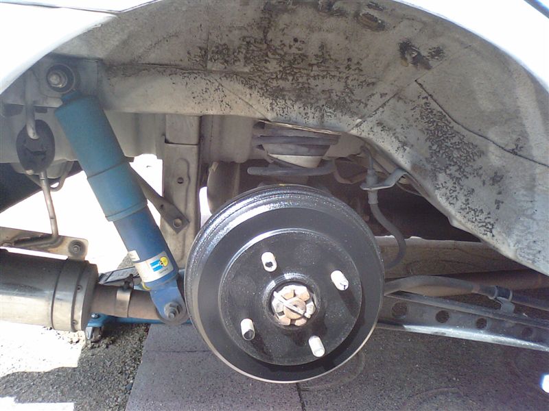

Here are the rear axle mounts AWD and then FWD
here is the centre bearing and where some holes would need to be drilled to mount it
There are some other minor differences such as shift linkage and fuel tank but all this will bolt straight in. So im going to offer a couple of hundred bucks for the blue car then if Its ok for rego to swap the awd into red then woohooo otherwise ill just do a motor swap and jobs done.
Man I’m so jealous of your workshop there… So different to my tiny garage where I do everything hahahah
yeah im lucky the boss is a super cool guy, ive worked at a couple of places where they wont let you do private work in the workshop
ahh I forgot to mention the flanges on the diff for the drum brake backing plates look like they are the same as the 2wd flanges, so I think applause disc conversion is still on the cards

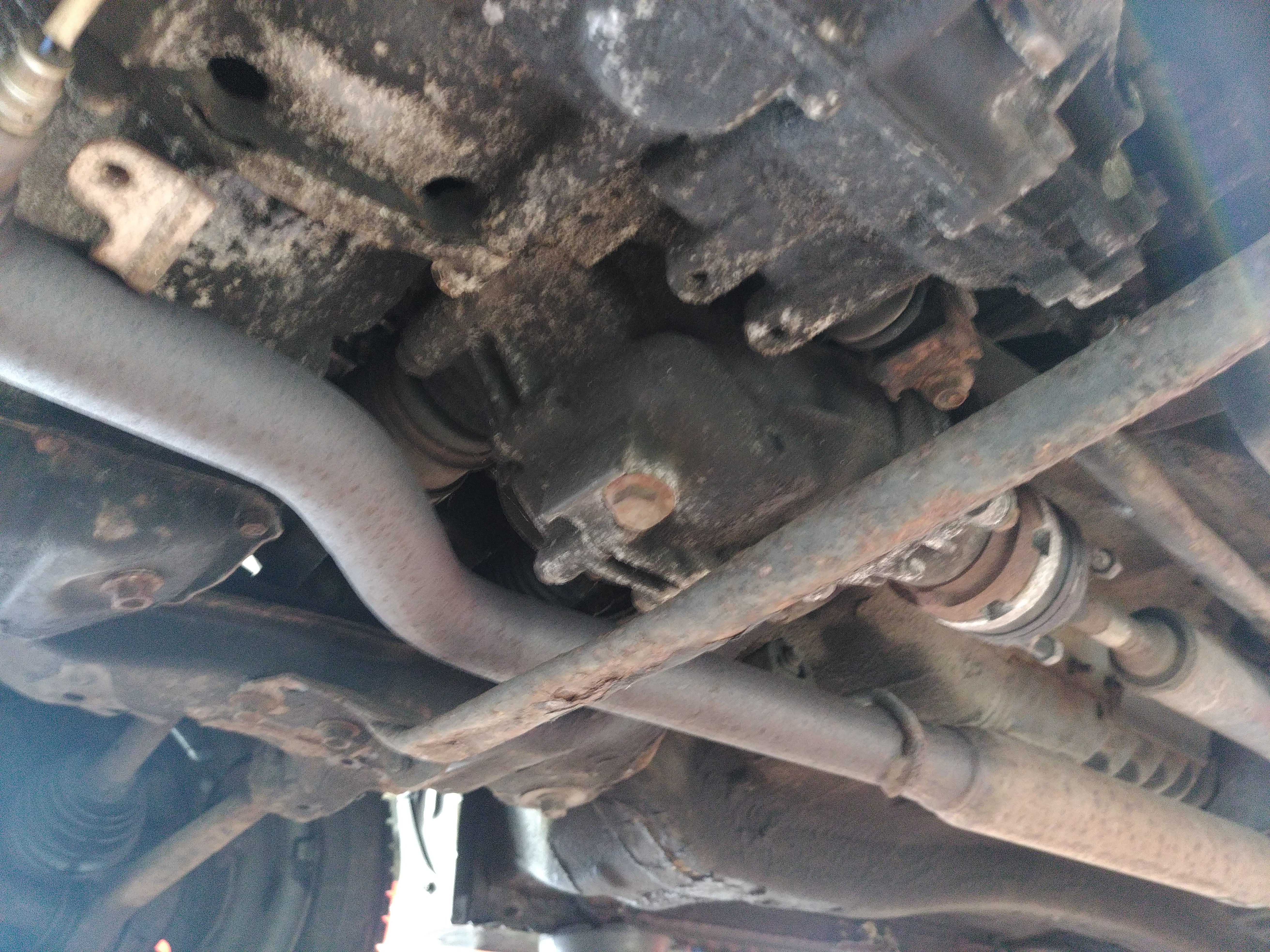

Mr G here is a photo if the transferbox, it looks like it just bolts onto the standard trans. I know youll be interested in this
Mick are the rear chassis rails the same i know the rear floor pan has the same part number as the 2wd version but the rails don’t, they also look a little different in the wheel well, i have always thought of doing the conversion but bringing in a rear cut is very expensive however if its just the mounting points that’s a little different.
You will have to let us know if it runs a different cv shaft on the front. I dont get how they bolt up but probably because ive not had much to do with 4wd’s in general ( i wont tell you how we have a nissan xtrail in the driveway hahaha)
