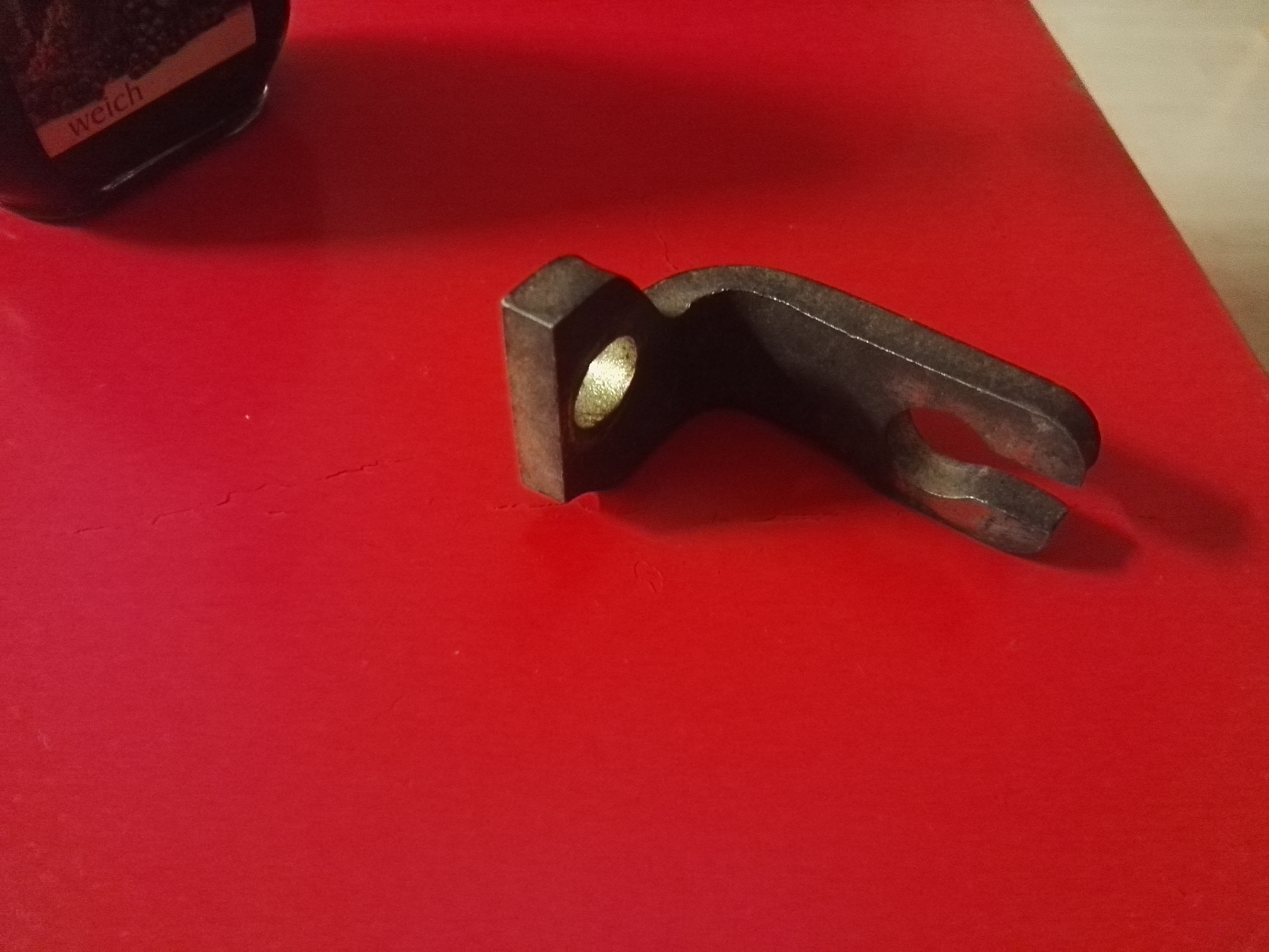

Handbrake stay has arrived!!!
Who would have though such a small insignificant piece of metal could have caused such a hassle!? I probably could have made one but I didnt have any steel thick enough and ive been a bit lazy lately

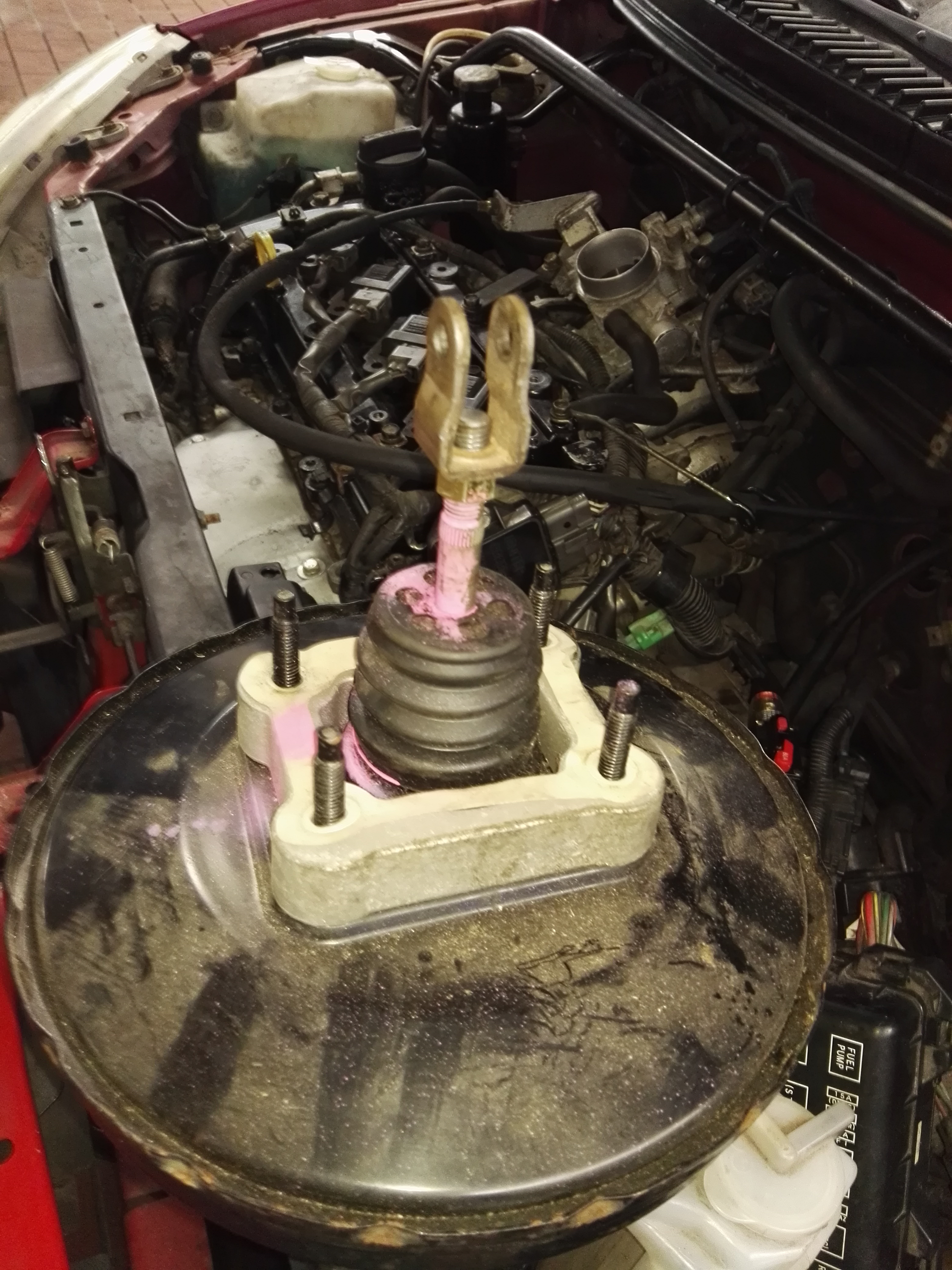

I have also found a solution for the master cylinder! From what I can tell the standard M1xx MC is 19mm or 3/4", and after checking out partsfan I found that the spacer between the brake booster and the body is the same part number between the M1 and M3, which means the M3 brake booster should bolt straight in. This will let me fit the 20,6mm or 13/16" MC from the M3, and if this is still too small the replacement MC from Jakoparts is listed as 22mm or 7/8". I found a MC with brake booster from an M3 on ebay for 40 bucks, its on its way and should be here by the end of the week. I will have a crack at fitting it and share my findings

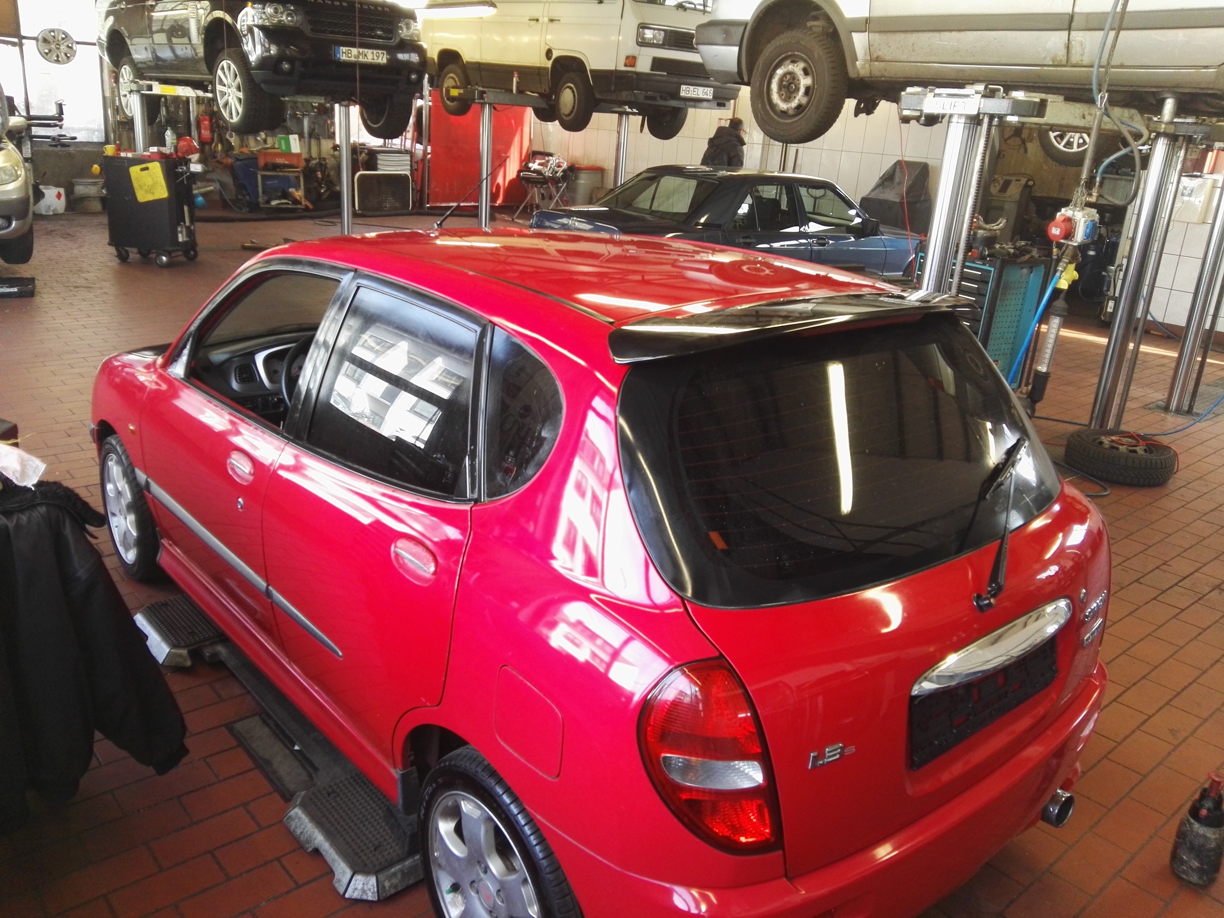

So instead I gave the car a quick polish, swapped the hood which had a few dings in it with the hood from the parts car, painted the hood, mirrors and spoiler in metallic black and tinted the fog lights. Now its really looking nice. Unfortunately I ran out of clear coat so they’ll have to come off again sometime for a few more coats and a polish, but now I can see the colour theme will work and suits this car

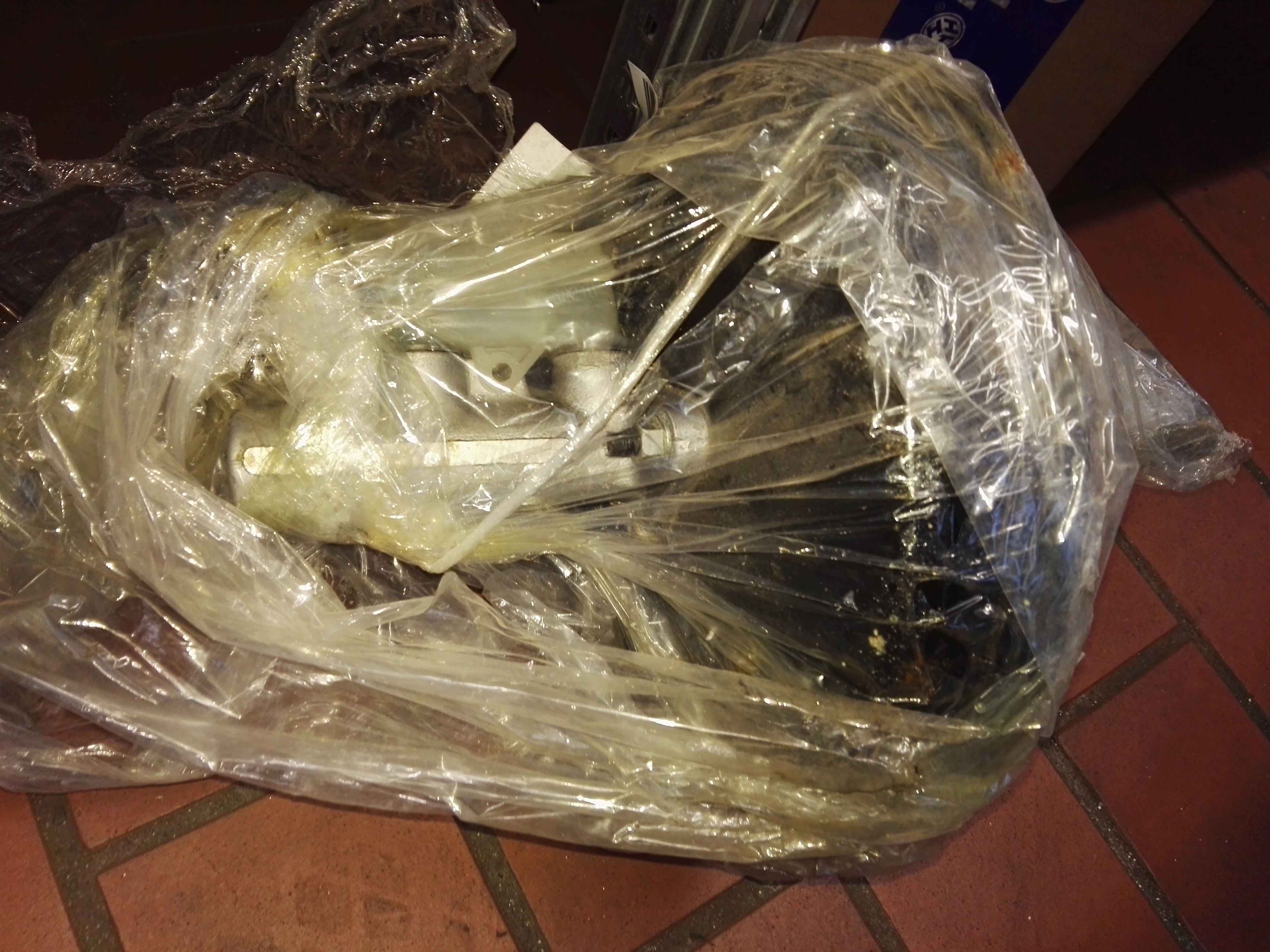

Full on panic mode here, pulled out the old master cylinder, found it was leaking into the brake booster, so that was the problem, no big deal. Had a crack at fitting the M3 master cylinder and brake booster, the brake booster is larger and will fit with some massaging on the fire wall and if I have the spacer which goes between the booster and fire wall, which I dont have
so I pulled the master cylinder from the blue car… also leaking. Now I have 3 and a half days to find a solution, otherwise I wont be ready in time. Please guys pray to the car gods, hopefully I can get this sorted out in time!

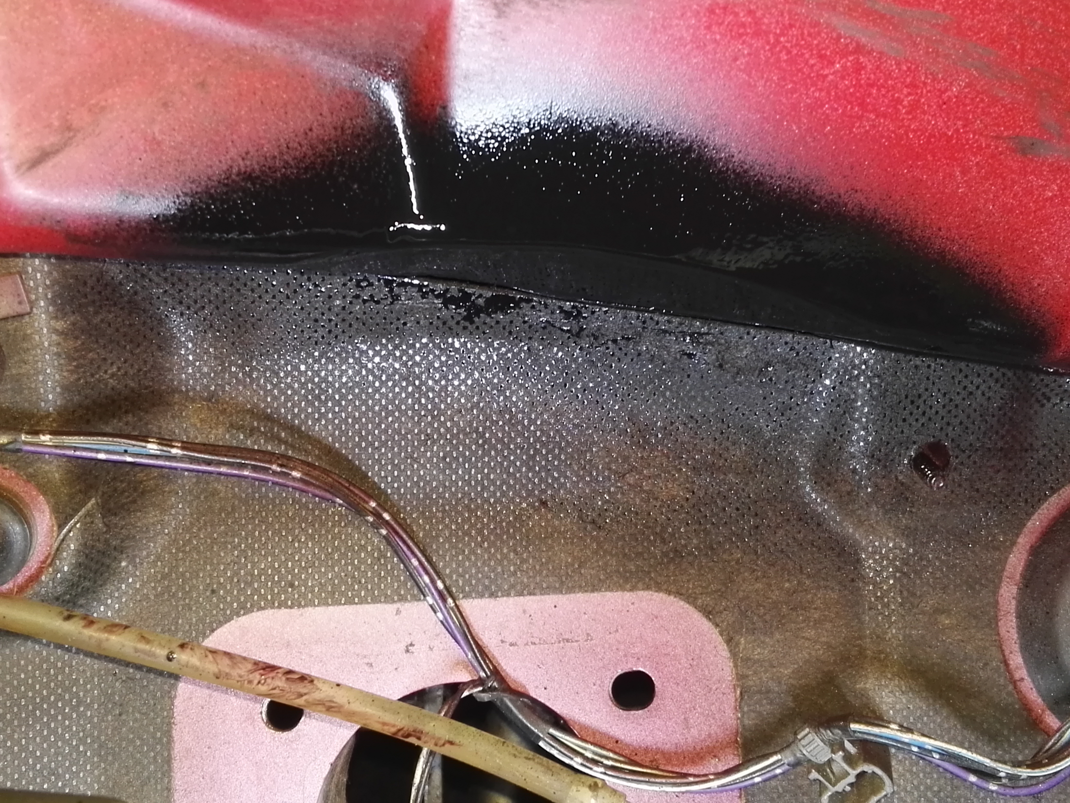

Got a bit more done today, changed all the oils, fixed up a few small things, and did a cut and shut on the fire wall to make room for the new brake booster.
In a rush here to get everything done In time, parts arrived today, got the brake booster and master fitted up. Bit of a pain to mount the reservoir but I jimmyed something up, but ill sort out something better in the future. The whole deal with the master cylinder has been a rushed job and it will definitely be redone soon. Ran out of time so I didnt get a chance to bleed the brakes but hopefully they bleed up ok. Also threw a new set of spark plugs in and took care of a few more minor things.

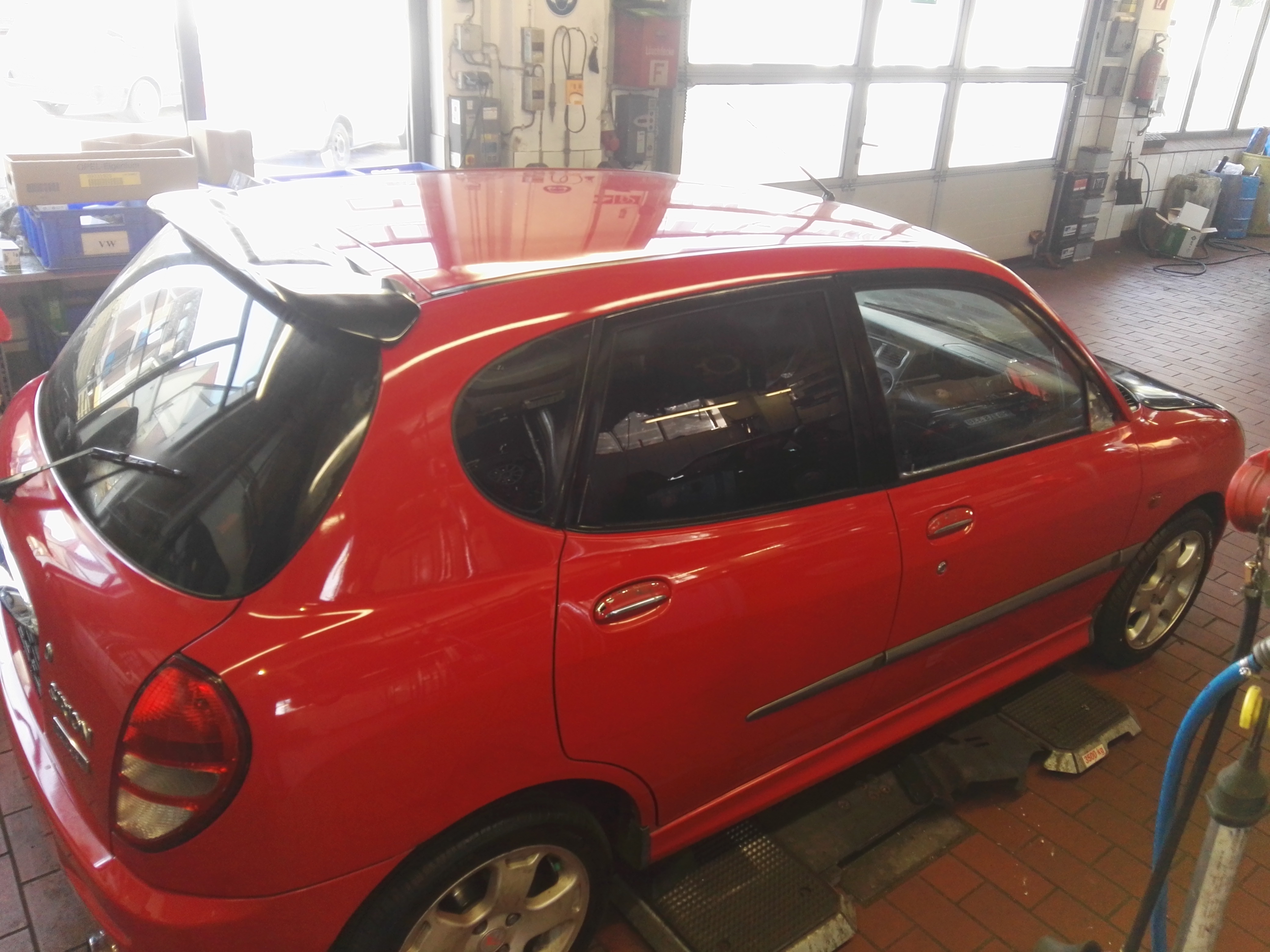

Ahh guys a lot of stress for nothing, got my dates and times mixed up the training session is on Saturday! Got the brakes bled and they are working perfectly, got the mirrors clear coated and fitted, helmet has arrived, got my licence plates, all registered and insured, only problem now is I took it for another test drive and it needs a wheel alignment although that was to be expected swapping the complete front end into another car, and it feels like the shocks are a bit sad too but thats also not a big problem either with new suspension going in over the next few months. With the extra time I will do a better mount for the brake fluid reservoir and maybe clear coat the hood and wing.
