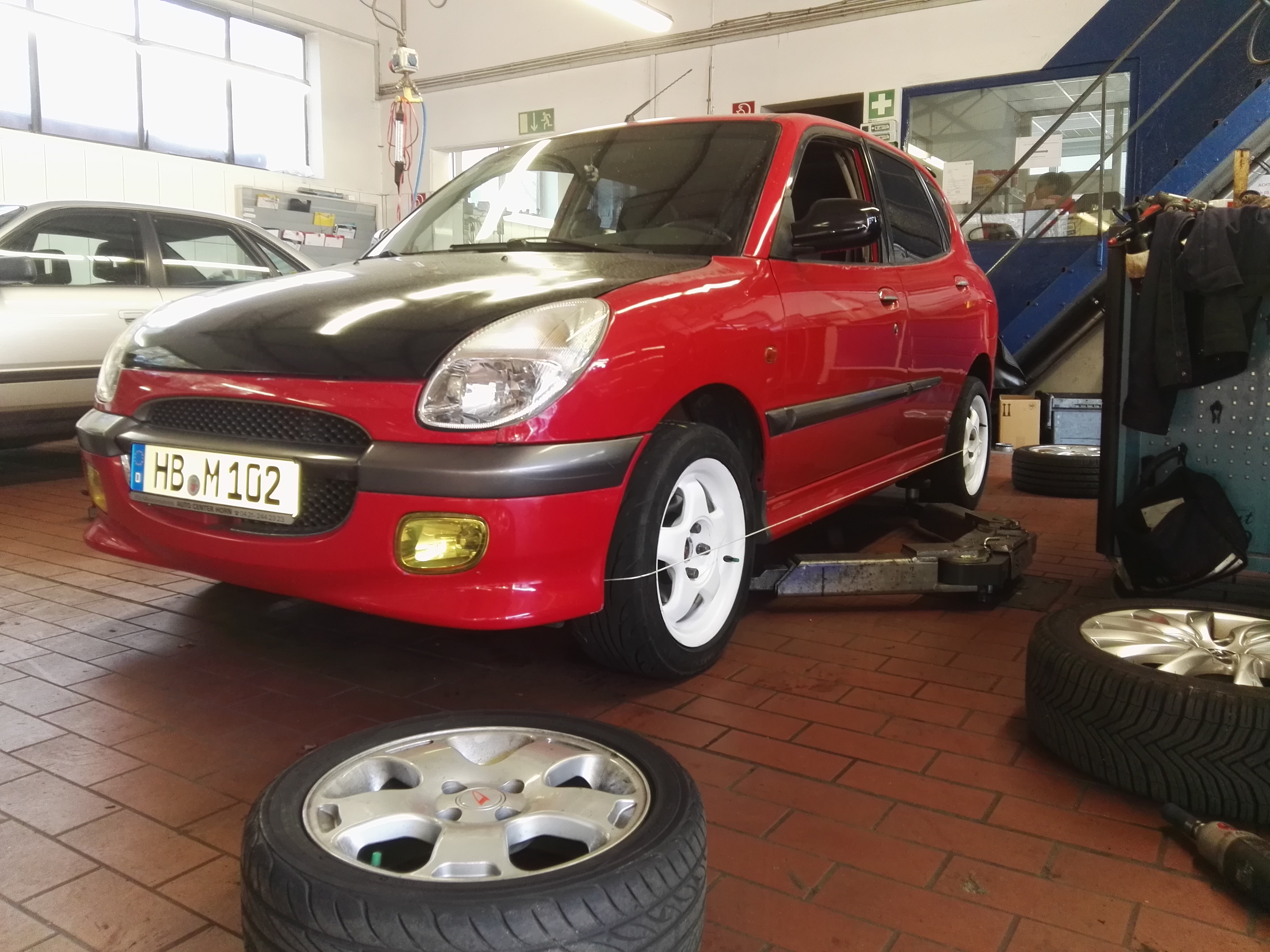

Did a string line wheel alignment, it was actually pretty funny because my colleagues had never seen someone do it like that before
the car actually had a small amount of toe in, so I shortened the right side by 1 turn now its just a tad past 0 on the toe out, and moved the rear axle over to the left a half turn, took one coil out of the rear springs. Now its driving much better and the steering wheel is straight but its still not perfect, and the rear is still a bi higher than the front. Im getting ready to head out to the air strip, ill be taking it easy today, just making sure everthing works well and maybe driving a bit more aggressive in the afternoon if everything works well. Videos will be coming soon

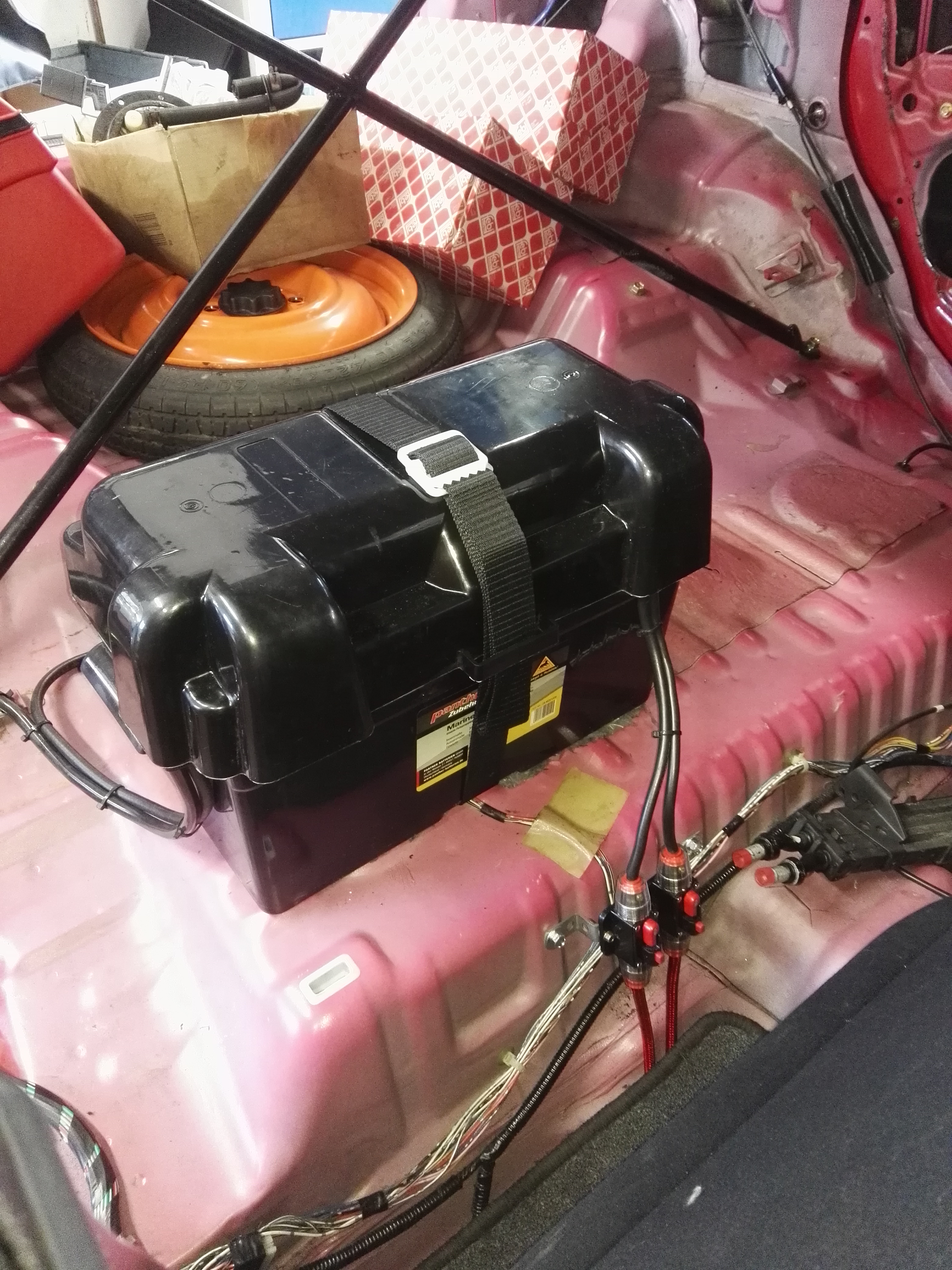

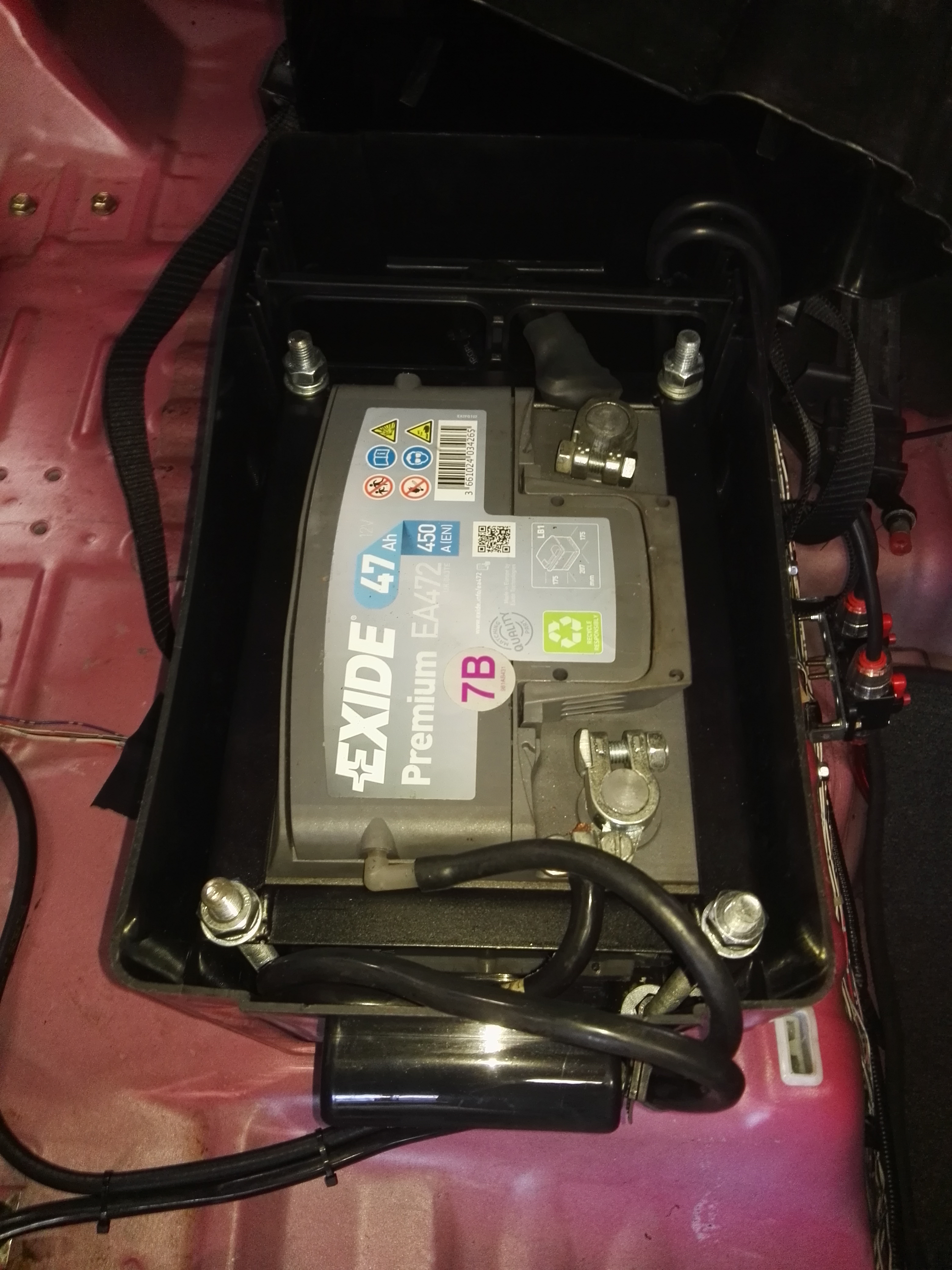

Technical inspection went ok, but i need to change my battery box, needs to be water tight, made from thicker material, have the cables entering from the top, and the battery itself needs to have 2 straps holding it in, not one. I had read that in the regulations so it was no surprise, and other than that the inspector said there shouldnt be any problems to enter in the competitive races.

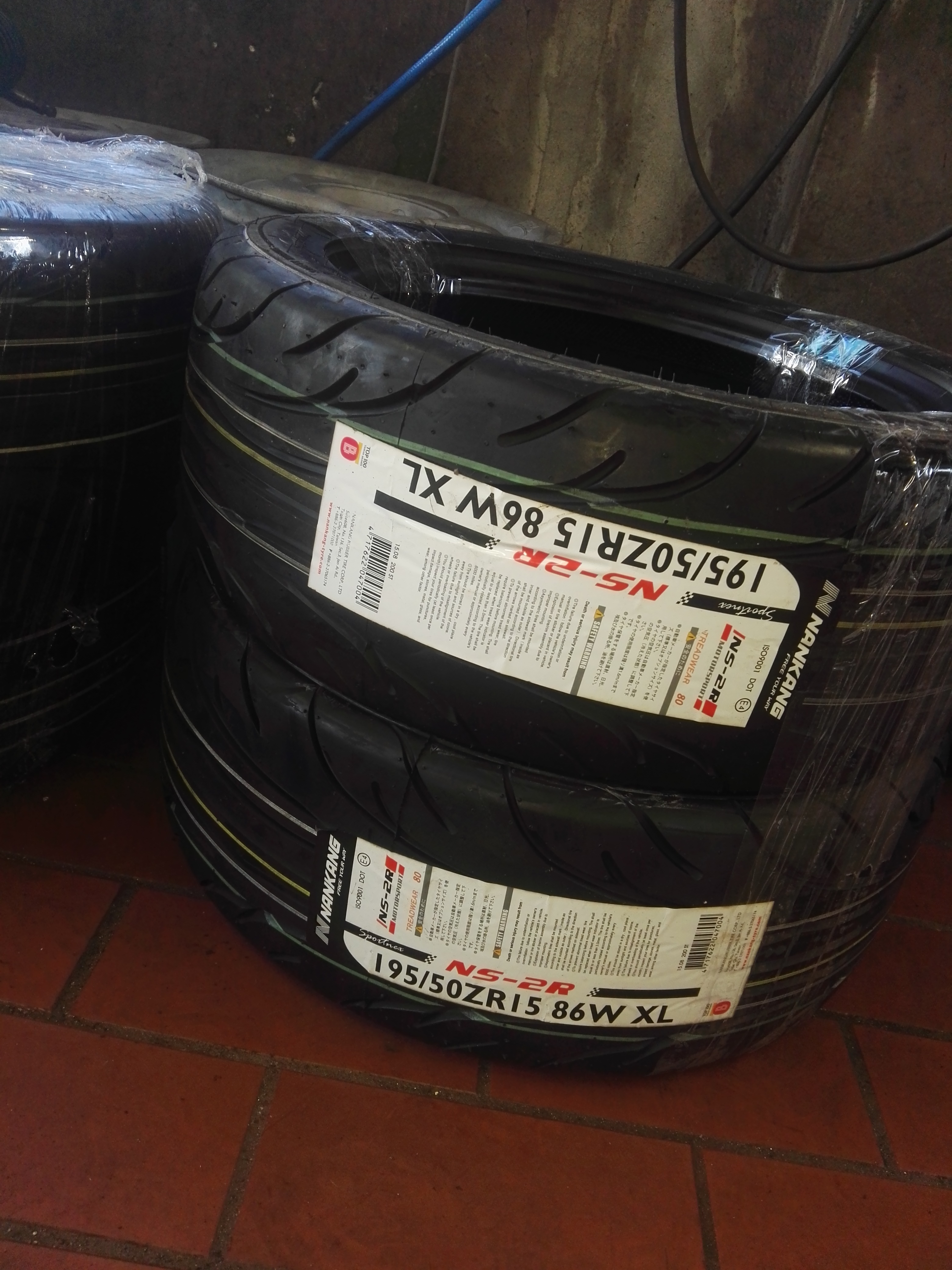

Hi guys, quick update here, the next training session is this weekend, I have some tyres on the way. I opted for the Nankang NS2R because of my budget (or lack of
) but @Mr_Gormsby says they perform quite well, and he is a vey knowledgeable man. I was a bit skeptical at first after reading some reviews, but after a bit of research I found that this particular tyre is available in a wide range of compounds, and this explains the differing opinions of the tyre. In any case I have ordered a set with a traedwear rating of 80 so they should stick like shit to a blanket

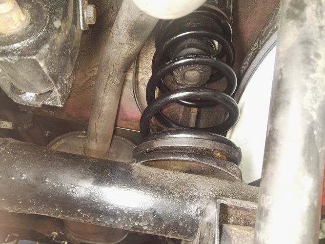

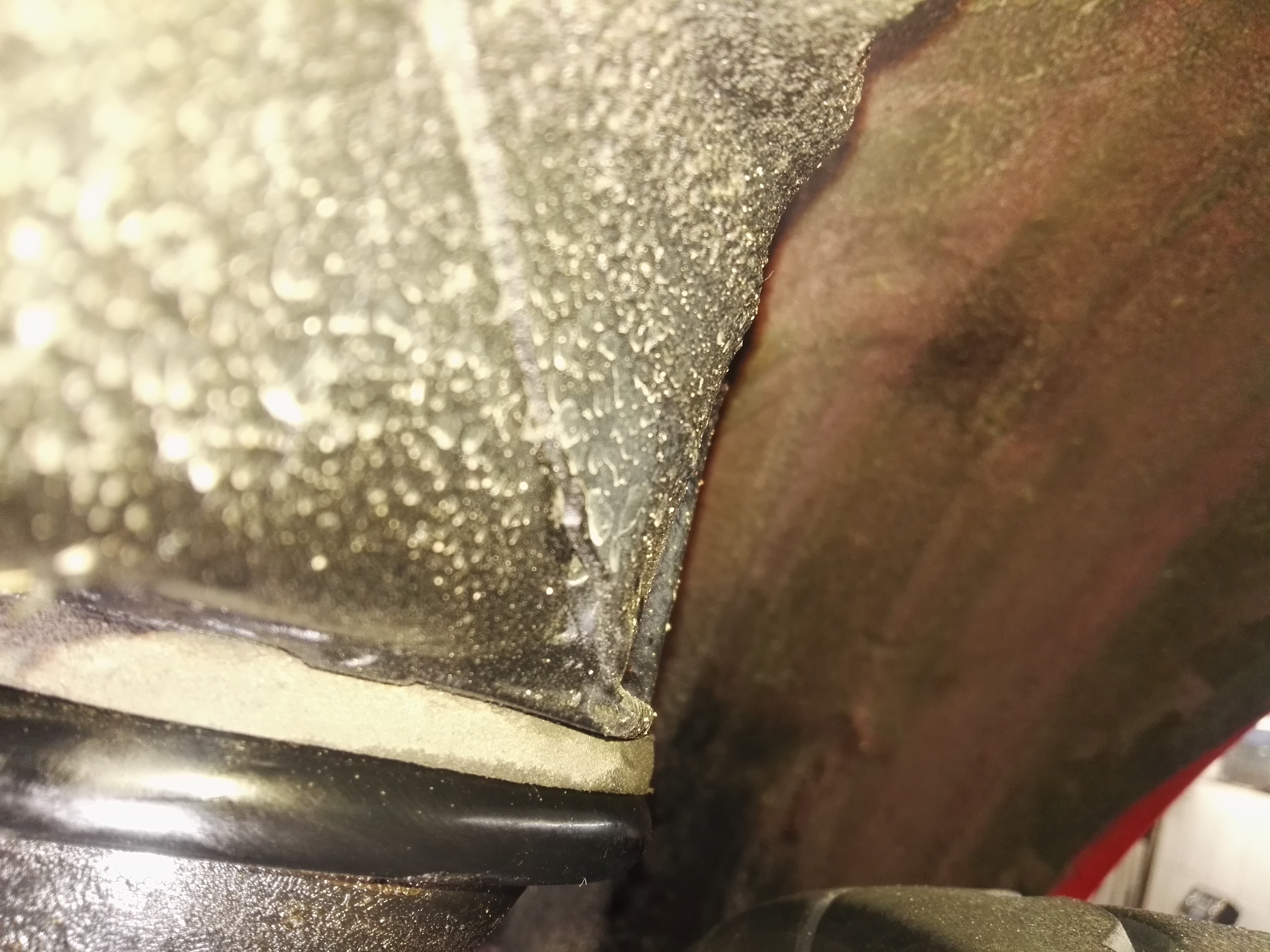

After another test fit of the 15x7’s it looks like with tyres on them they will probably foul on the upper spring seats on the rear during hard cornering, so this will be the next problem I will need to overcome, nothing a quick cut & shut shouldn’t fix. Some good news is my FPR has arrived (finally, its only been like 3 months), so I will be fitting this up in the coming weeks, I have also found a solution for the return line and factory in-tank fpr some time ago, but haven’t shared the knowledge yet. But I will soon

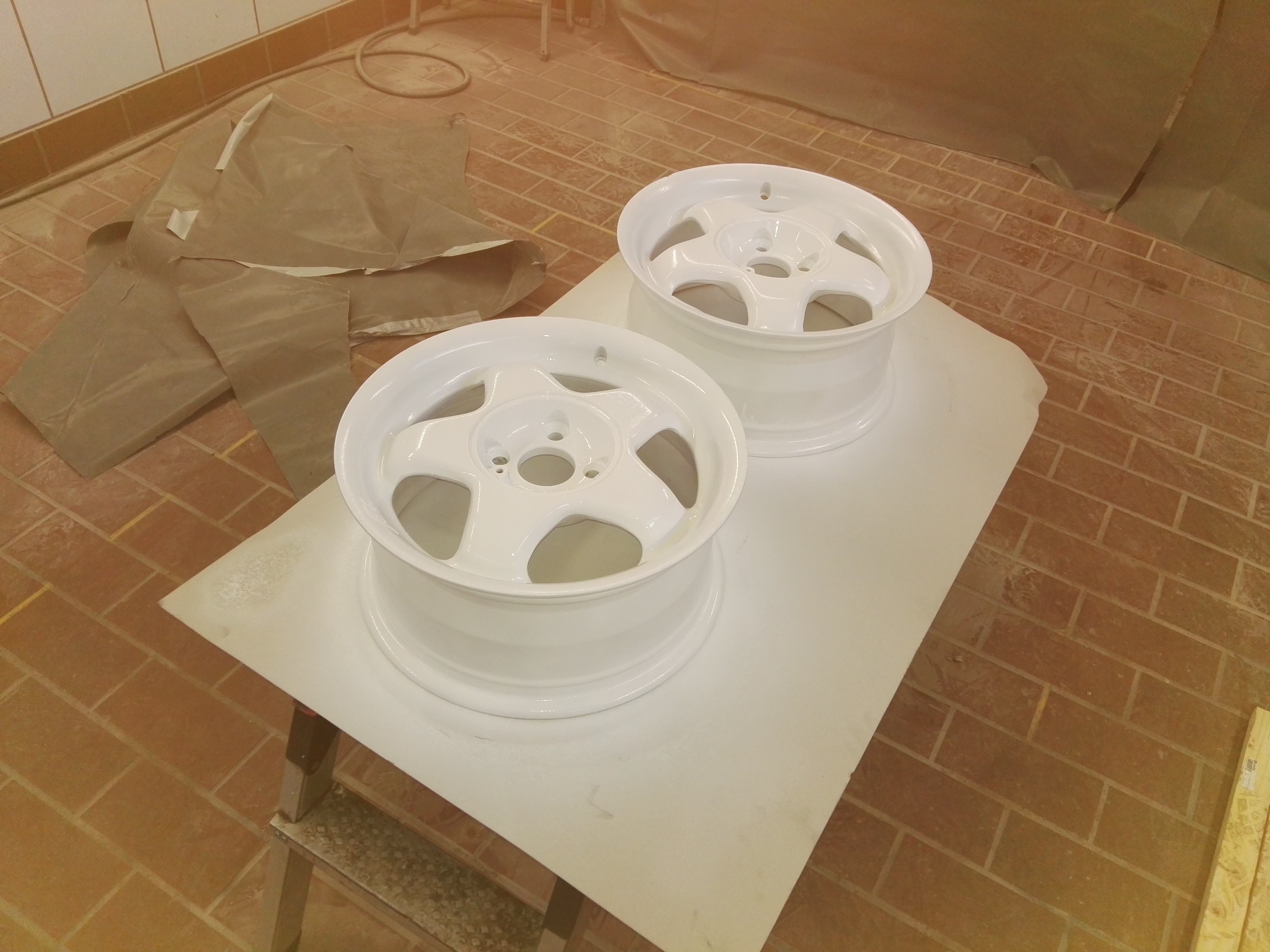

I think tomorrow night will be a long one! I only got 2 rims painted today, ill attack the other 2 tomorrow and ill probably have to break out the heat gun to get them dry enough to mount the tyres.
I used motip paint, proper wheel paint but white is a real pain because its soo thin. Had to do a ton of thin coats and it chewed up all my time today. I still have to modify the rear so the wheels dont foul and I ordered some camber bolts a while back, they are due to arrive tomorrow and with a bit of luck ill have enough time to throw them in and get a bit more camber, and ill probably give it a tad more toe out while im messing around with the front end. I also need too adjust the clutch cable as the friction point is a little too high, and I need to go over the rear brakes again, after pulling everything apart yesterday to fit the new studs and putting everything back together again the rear right was a bit tight and started smoking after dropping off a work mate on the way home. I hope its just the handbrake cable wasn’t seated in the holder properly or something like that, and I hope I haven’t destroyed the pads either. Anyway we will see.

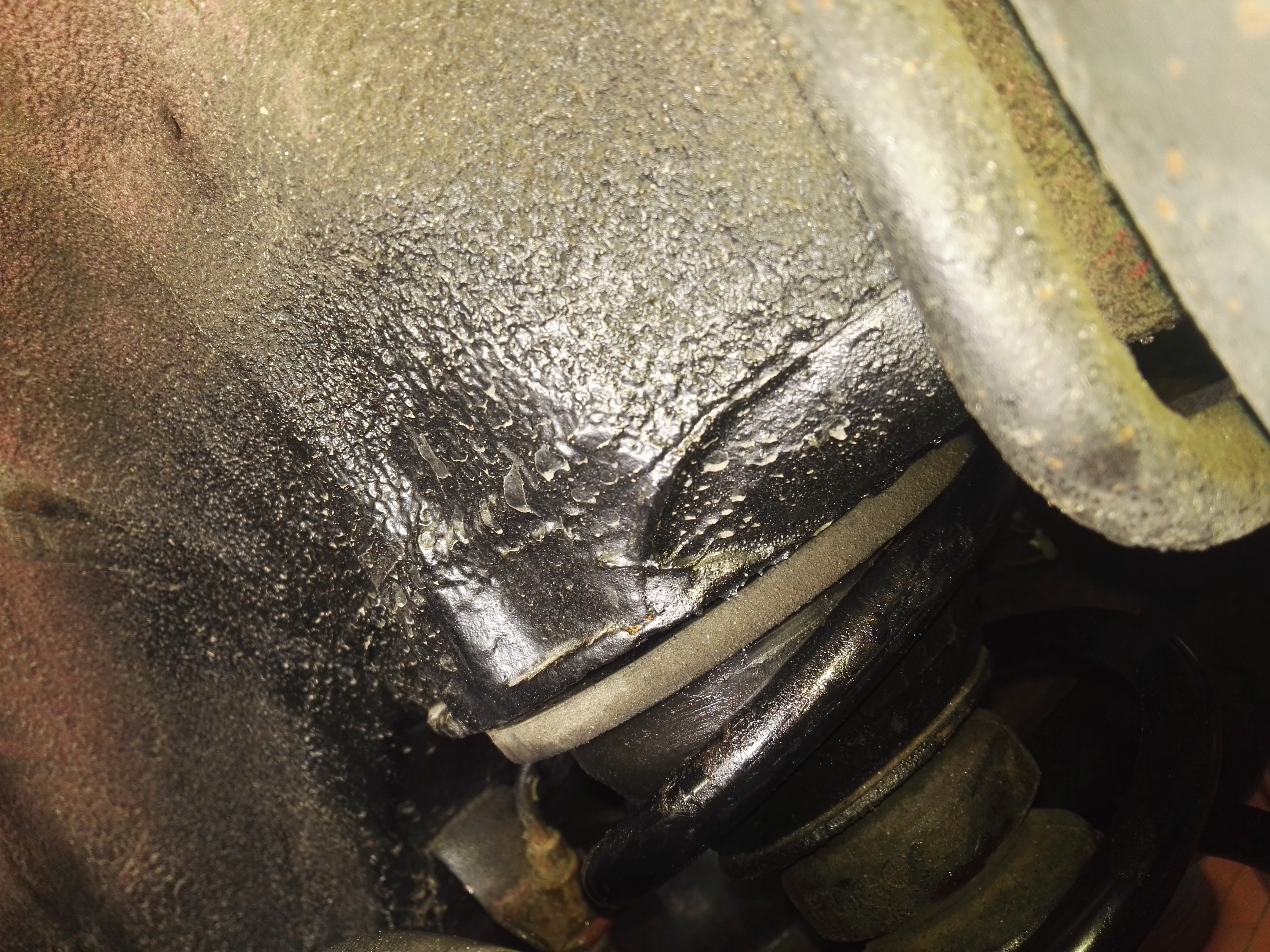

So friday night was a long one as expected, couldn’t do much with the clutch, adjustment didnt bring the results I was after, I have a feeling the clutch is on its way out. I modified the rear spring seats to get enough clearance for the tyres, now there is plenty of room and only minimal rubbing on the trailing arms which should be rectified with new bushes where the trailing arms mount to the diff (the old ones are almost completely torn and new poly bushes are on the way) and minimal scrubbing against the inside of the wheel arch which should be rectified with stiffer springs. My camber bolts didn’t arrive so I was still running with standard camber. I adjusted the toe out but only 1/4 turn so only around 0.3mm more than last time but I think I still need more. This time I managed a 47.56 on the same course, but there is still room for improvement. The first few runs on the new tyres were terrible, the car handled very differently and the tyres had to get a bit of wear and a bit of warmth before they began to grip properly. Its very strange, the tyres seem to grip more, but when they do give out they seem to slide more, but having said that the car is more predictable and more consistent. Im definitely catching up to my compitition, but there are some areas that could use improvement, a decent clutch so I can launch properly, better suspension, especially the rear but the front also needs attention. Last time I pulled the front apart to take measurements I noticed the front struts had NO gas pressure lol. But the car performs very well, I have plenty of top end power, the brakes are magnificent, but I could use a little more torque in the lower revs. I also realised I need to improve myself ALOT because there were a couple of professional racers (im not sure in which discipline they race) who were driving the course faster than me in a ford focus station wagon, when I saw that I realized I need to push myself harder and focus more on my lines. Having said that they were acting like a pair of knobs so I didnt bother asking them for advice. Im also lucky the next race aka my first actual race will be at the same course, so I should get some good results. Videos and pictures will come soon, Sabrina has the laptop with her and doesnt get back until Tuesday so youll have to wait a bit.

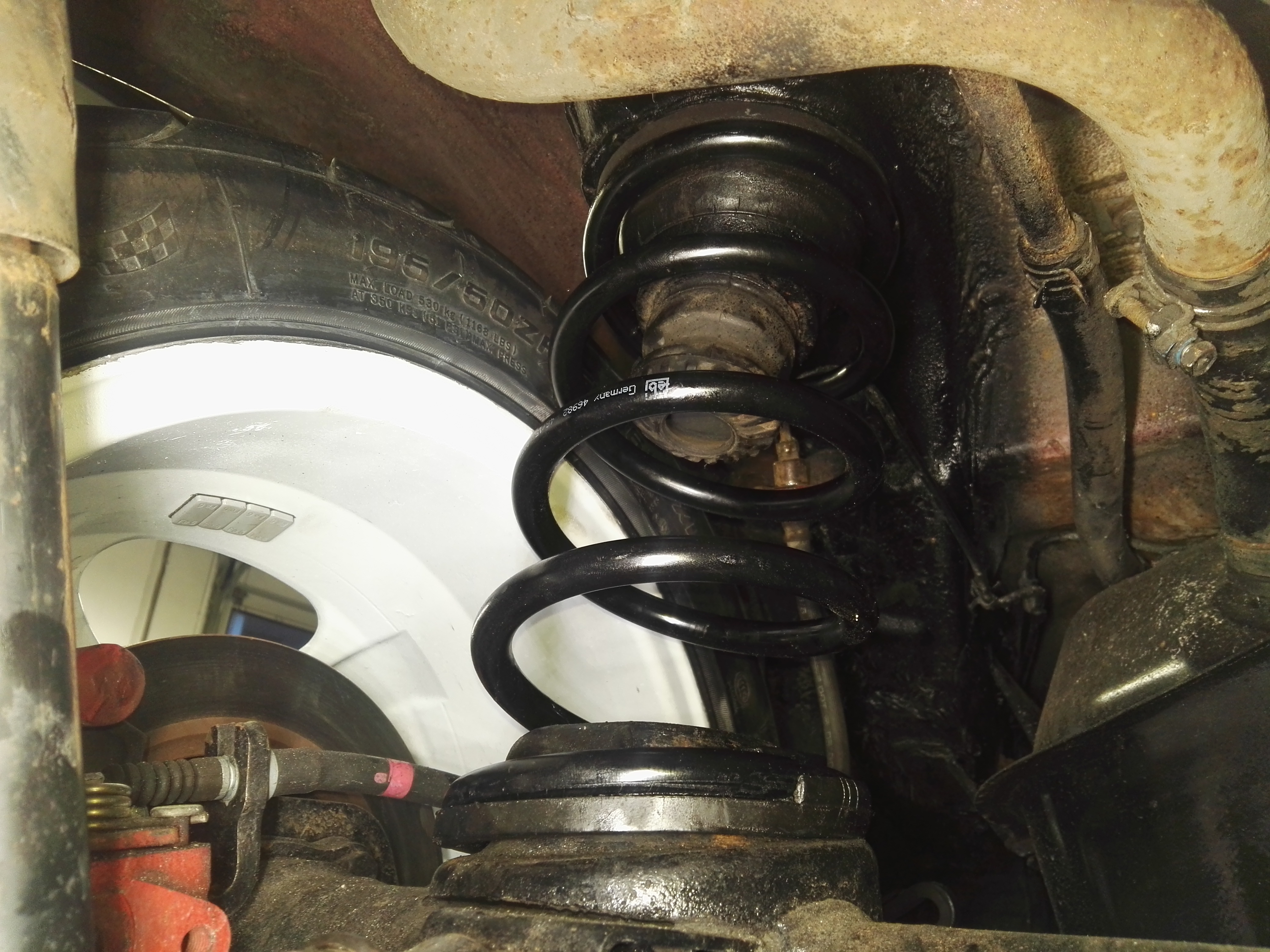

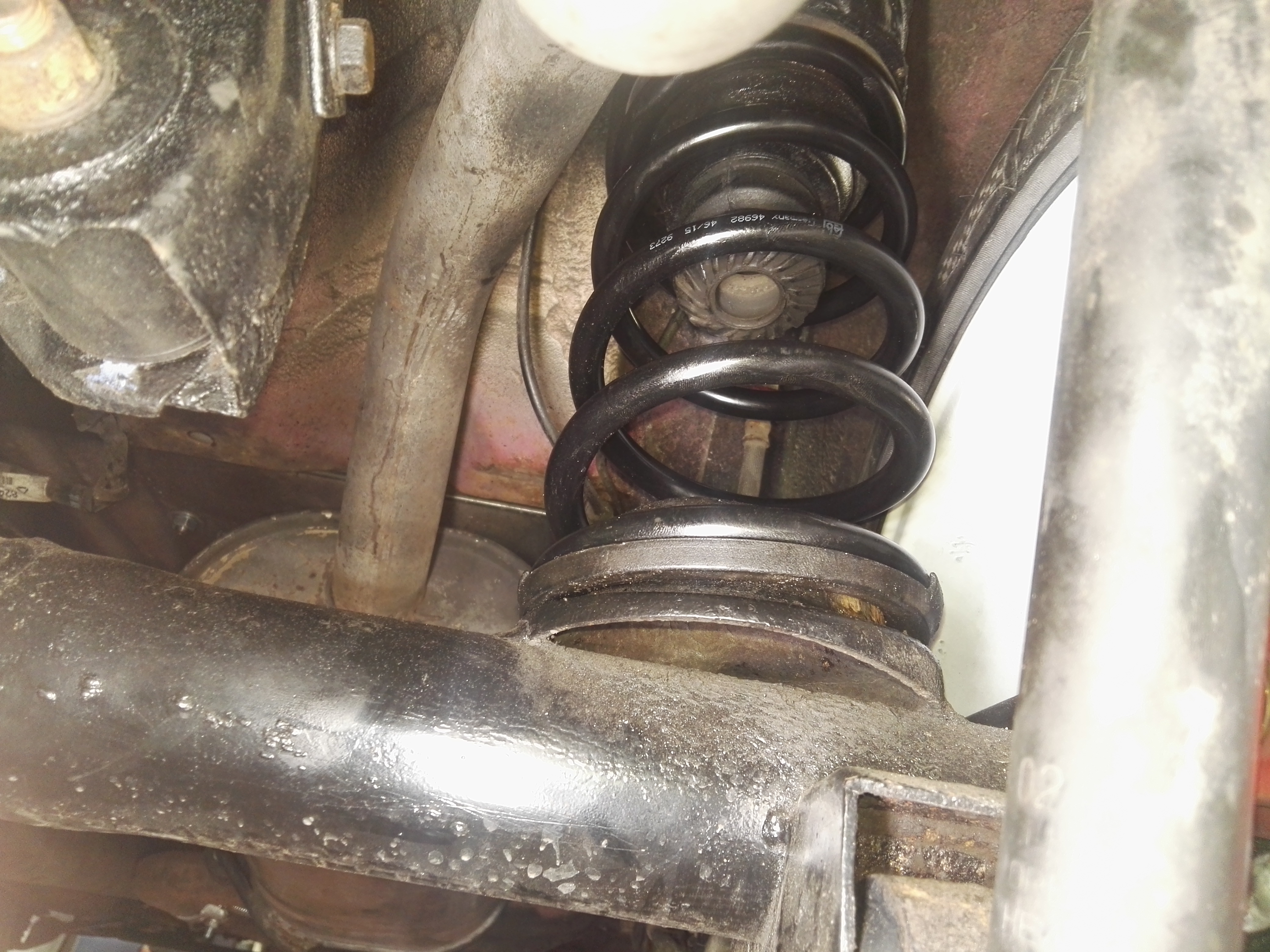

I ordered a pair of the fiat 500 springs I have spoken about a few times, the spring rate is around 48N/mm, quite a bit stronger than the front springs and a hell of alot stiffer than the original rear springs.
This brought the rear up about 35mm higher than it was, and with the eibachs on the front it was raked downwards to the front, looks terrible and basically cancelled out all castor. To compensate for this I installed the normal front springs from the parts car, this brought the front up level with the rear. This also means the front will have more upwards travel before it hits the bumps, and should in theory give me better traction in the front during cornering.

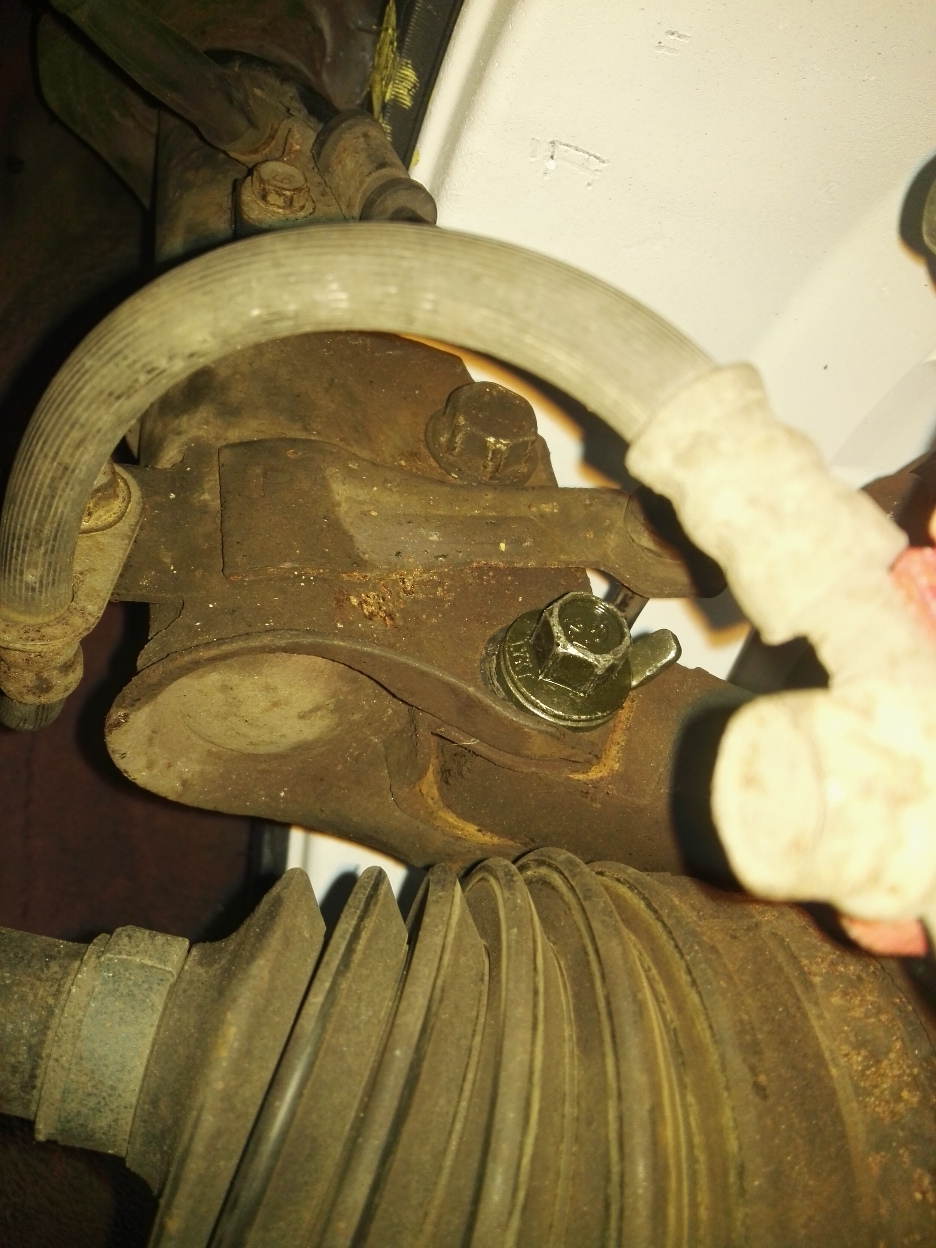

The camber bolts arrived
I now have around 1.5° more camber on each side. I have no idea what it was before, but we have a spirit level magnetic tool thing that we use when we change struts to make sure the camber is the same as before, I zeroed it out then installed the bolts, st them to max and it said 1.5°. You can see I used the camber bolts in the bottom hole, this is to get them maxed out and still have enough clearance for the semi slicks. With them in the top hole the semis would scrub on the strut.

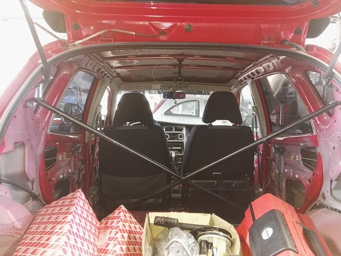

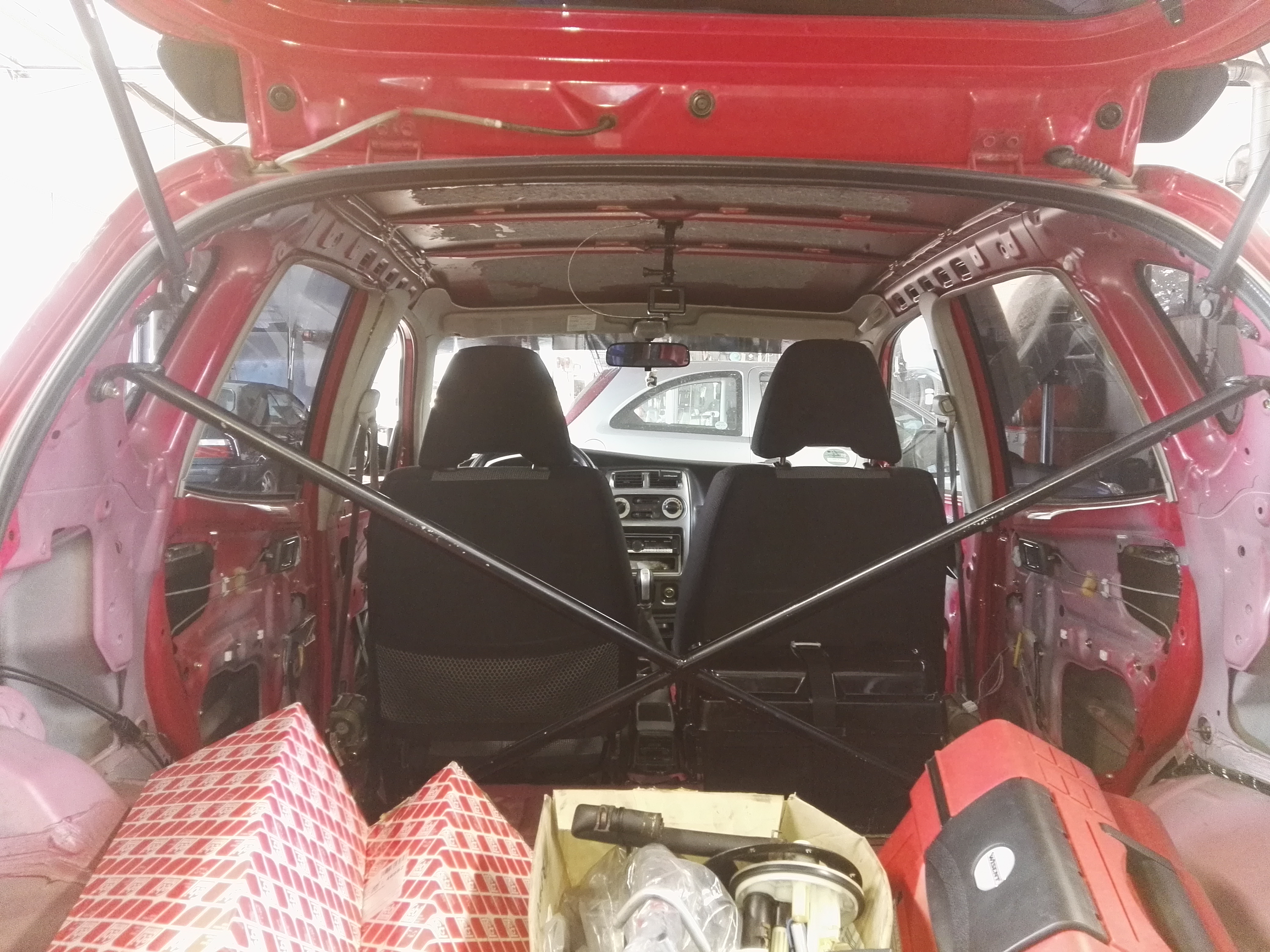

I also stripped the complete interior.
Installed the new battery box to meet DMSB regulations.

Also for those interested, here are a few photos of what the spring seats look like now. You’ll have to compare them with some previous photos to see the difference.

Great work as always. I am sure you will find it will want to turn much better than before despite being higher (slammed and stance people listen in on this!). Can’t wait to hear how it goes.
