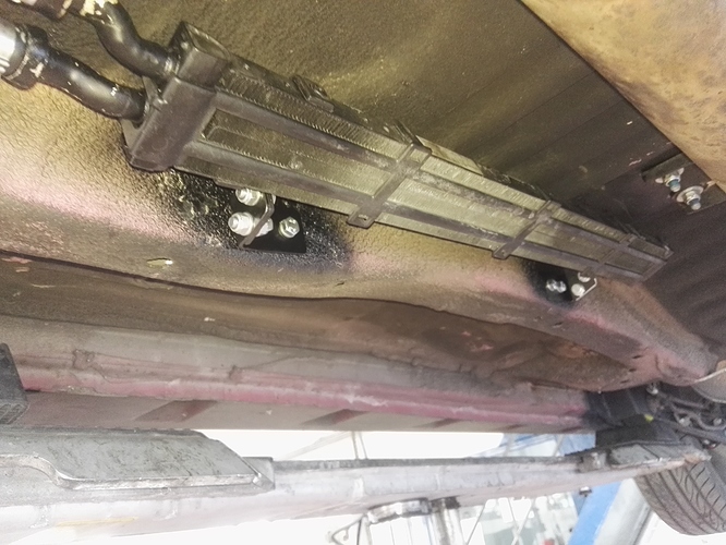

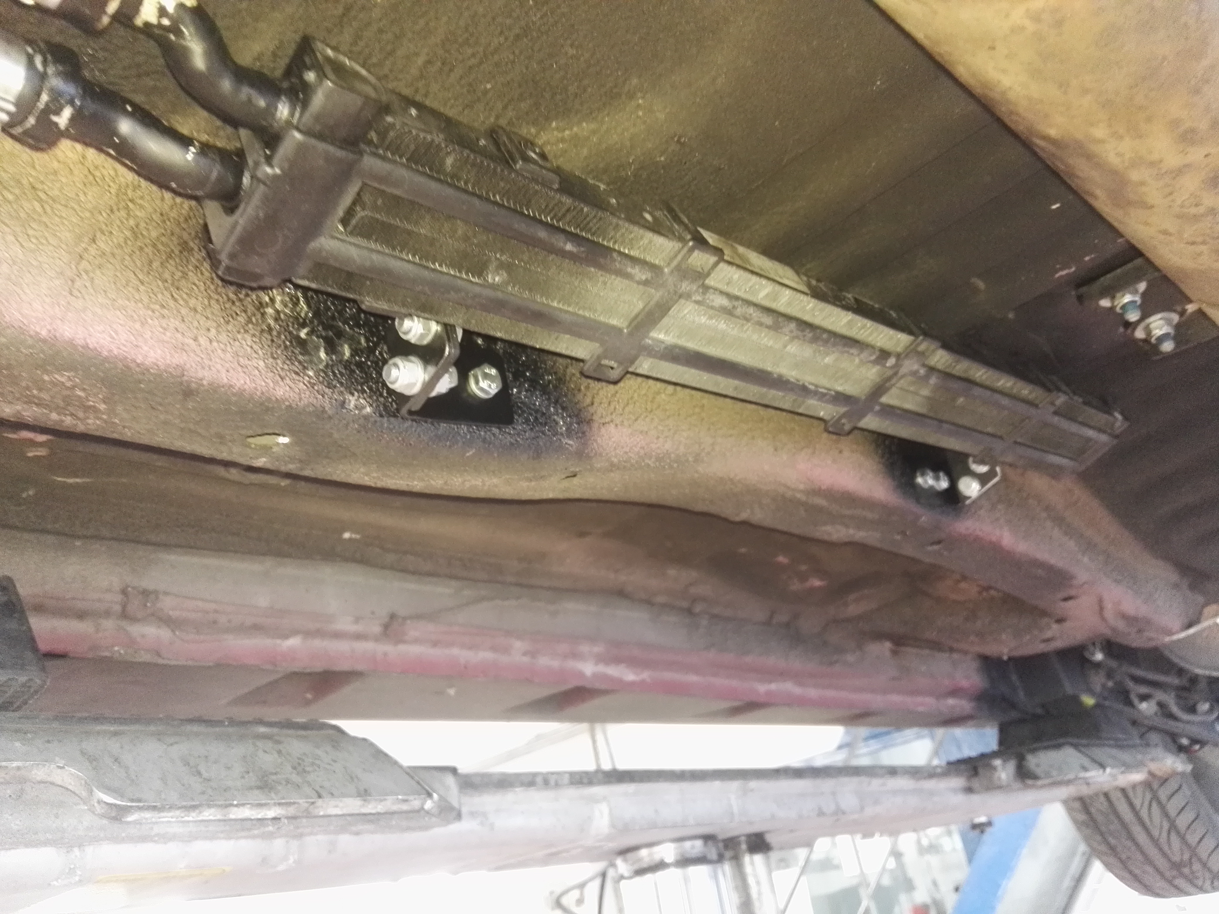

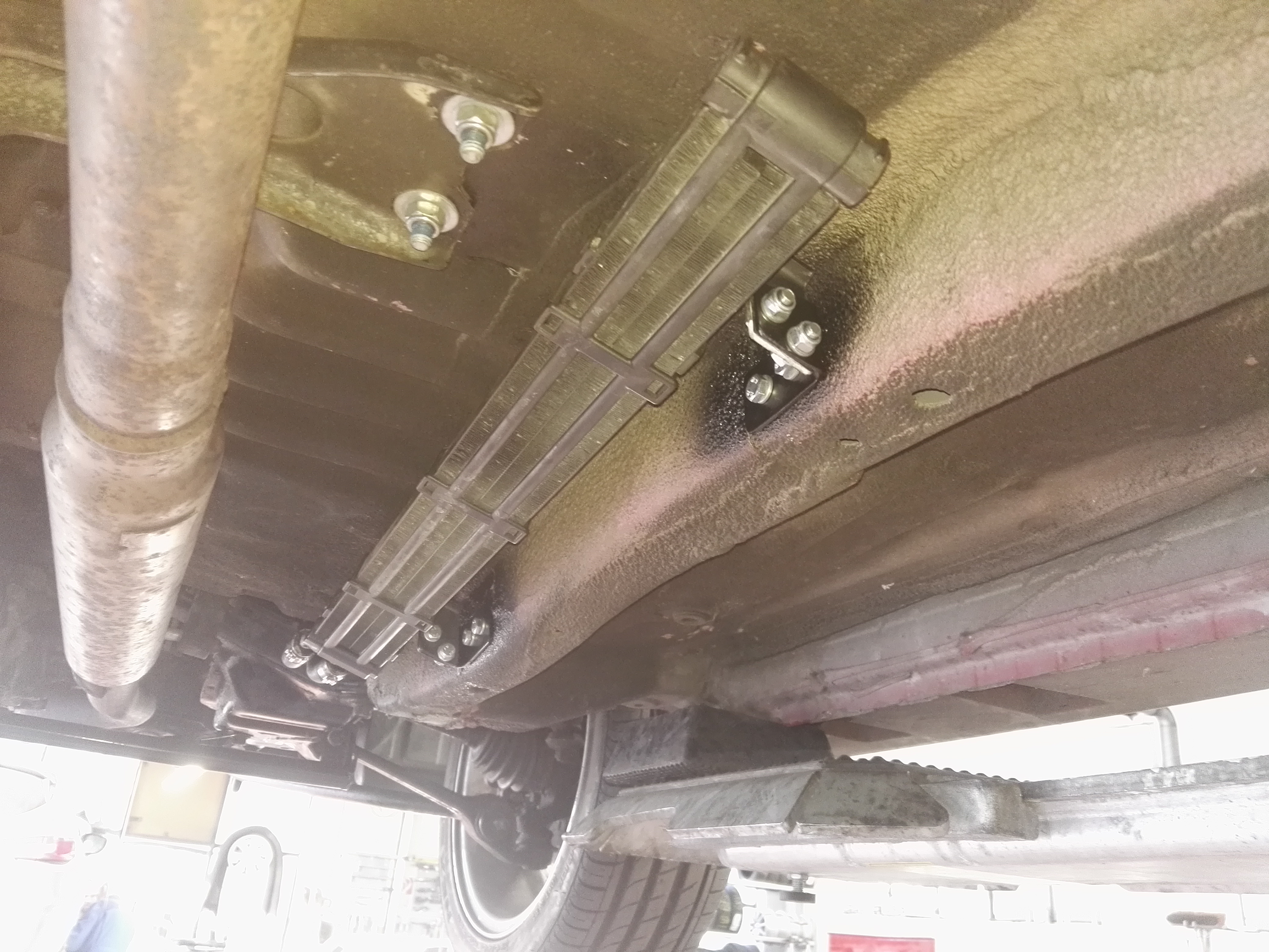

Here are some photos of the power steering cooler. Its from a VW phateon or something, it was the cheapest thing I could find on ebay. Its probably overkill, but since it is fitted to the low pressure side the cooling efficiency wont be as good, but I think it should work well. At some point ill fold up a sheet metal duct for it to help feed air through it and protect it from stones ect.

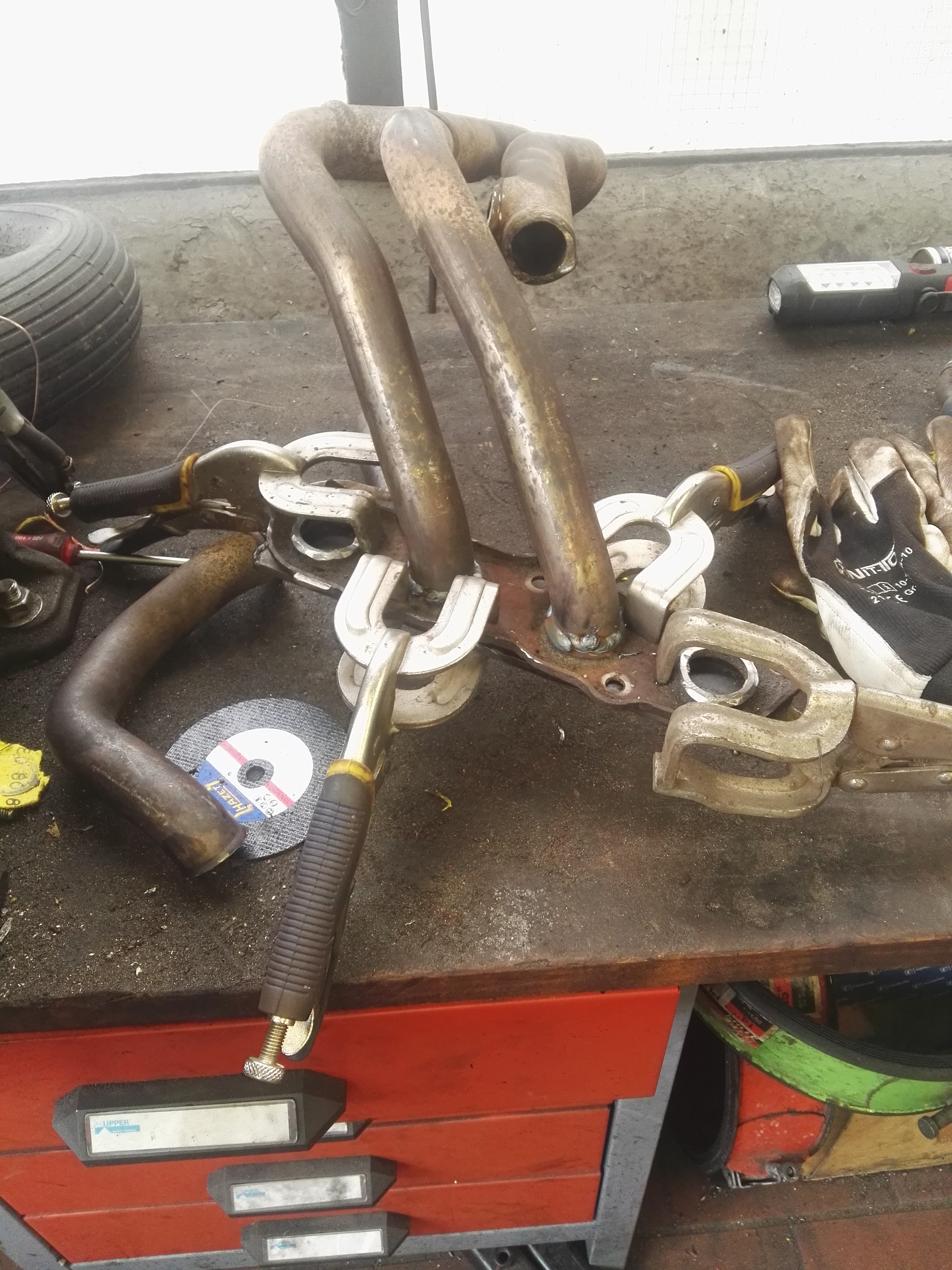

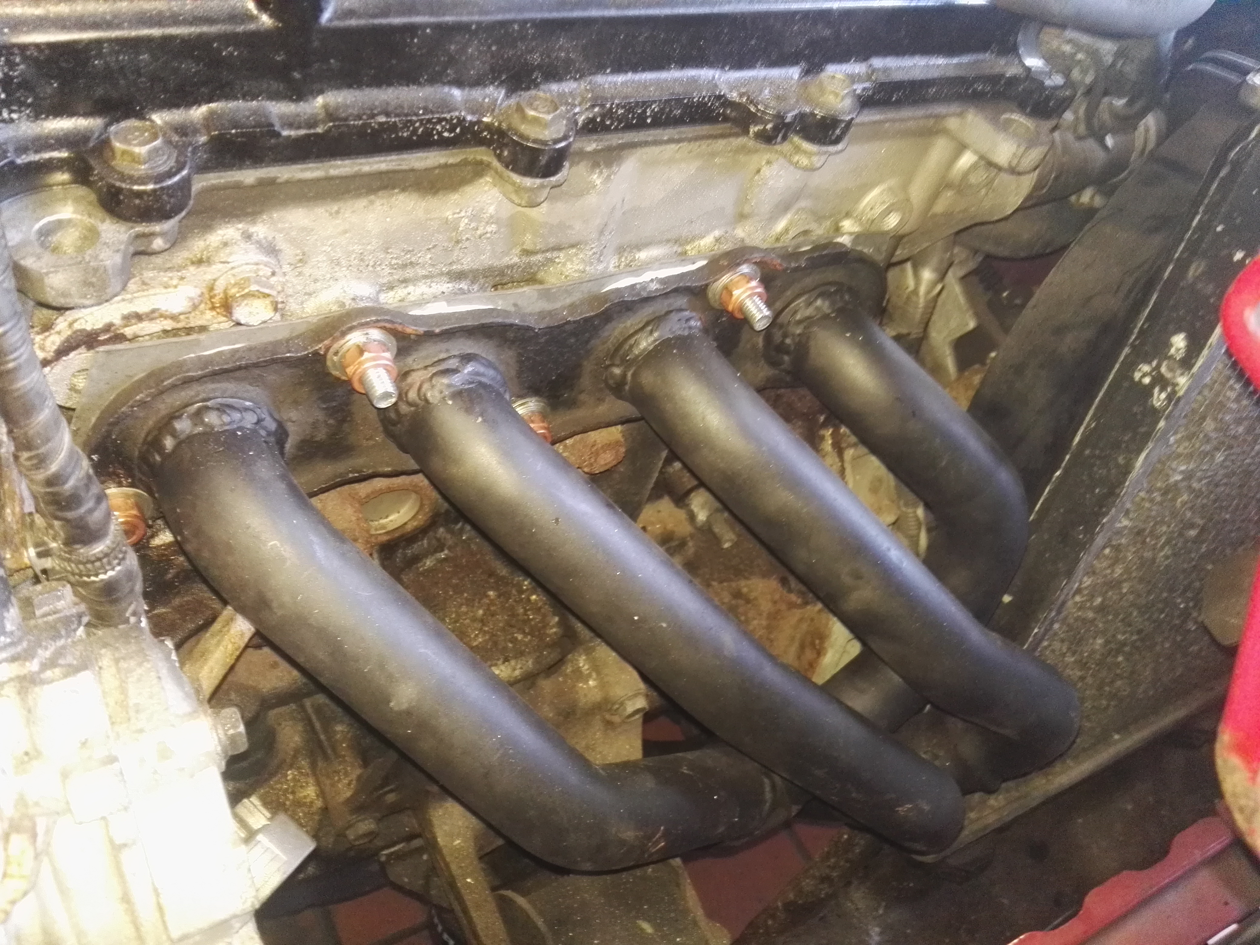

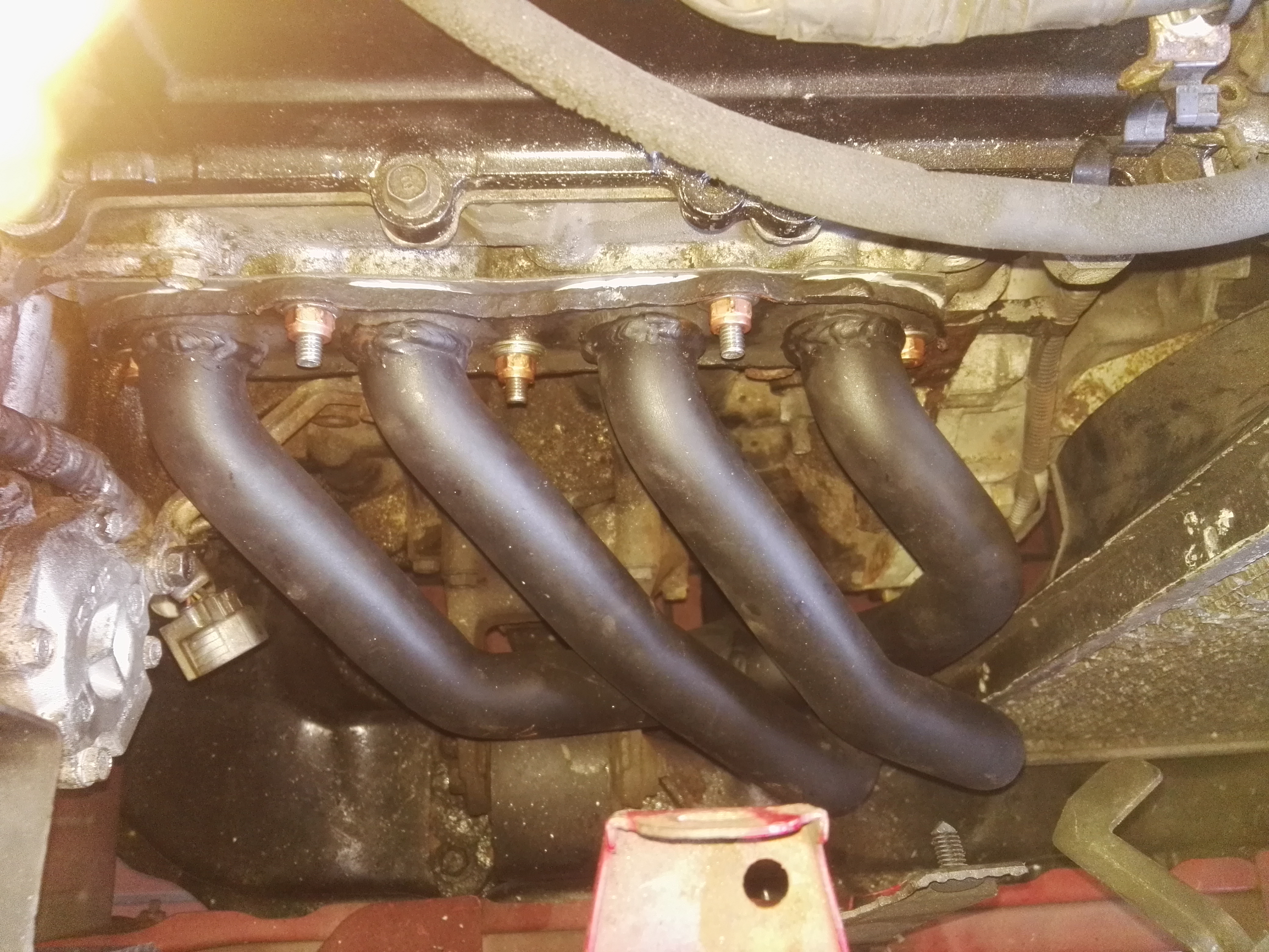

Made some really nice headers yesterday

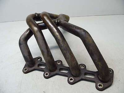

Started with an exhaust manifold from a Mercedes A class I picked up off ebay for 30 bucks
Some small modifications to get everything to line up with the K3 flange
And the finished product
Nice work man. Looks like it was made for it.
Your doing some nice and genuine functional enhancements there. I like reading your updates.
Keep it up.

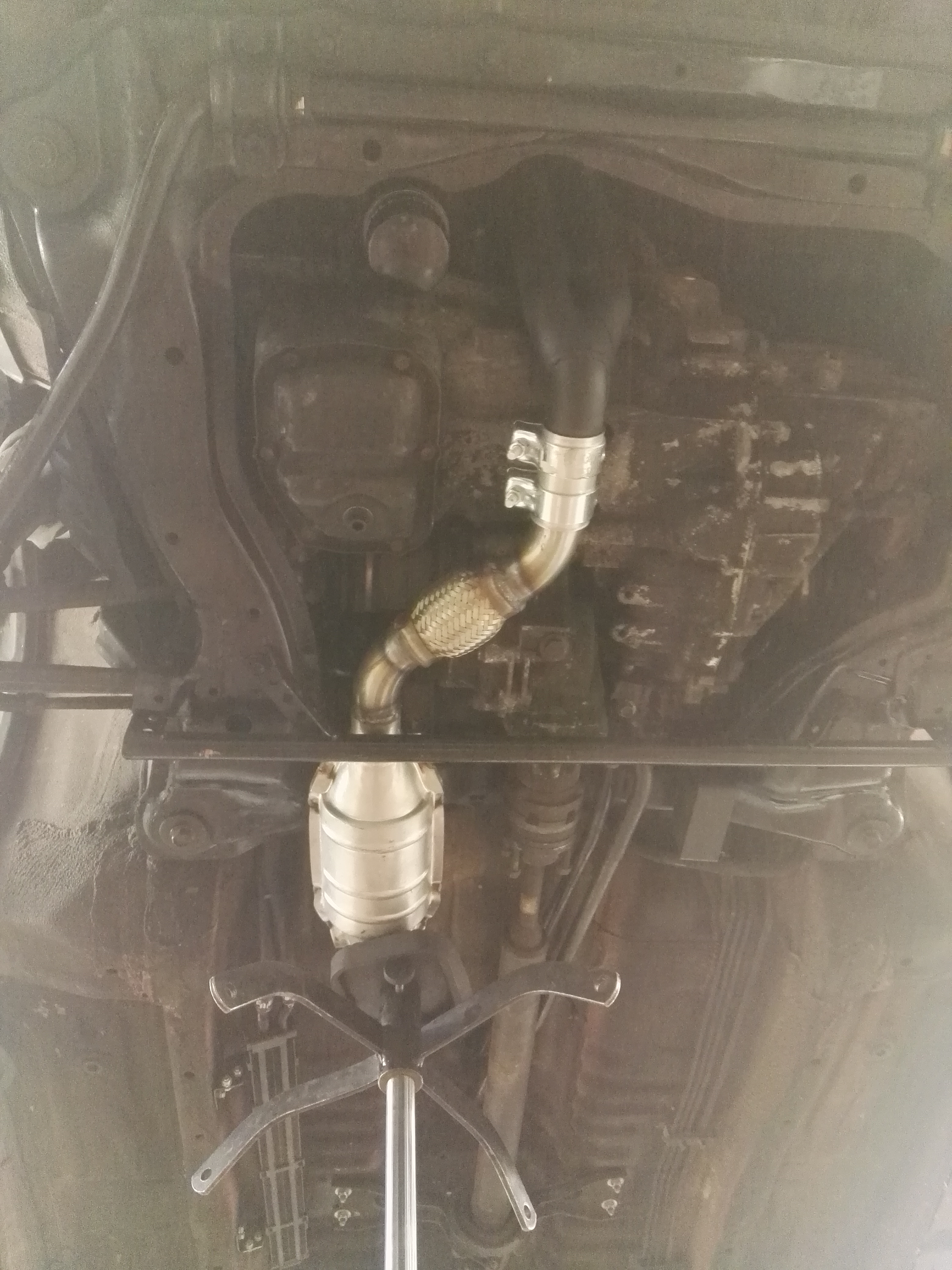

Since then I have built the headers shown above and also built an exhaust using mandrel bends, I stepped it up to 45mm to match the REMUS exhaust on the rear of the car.

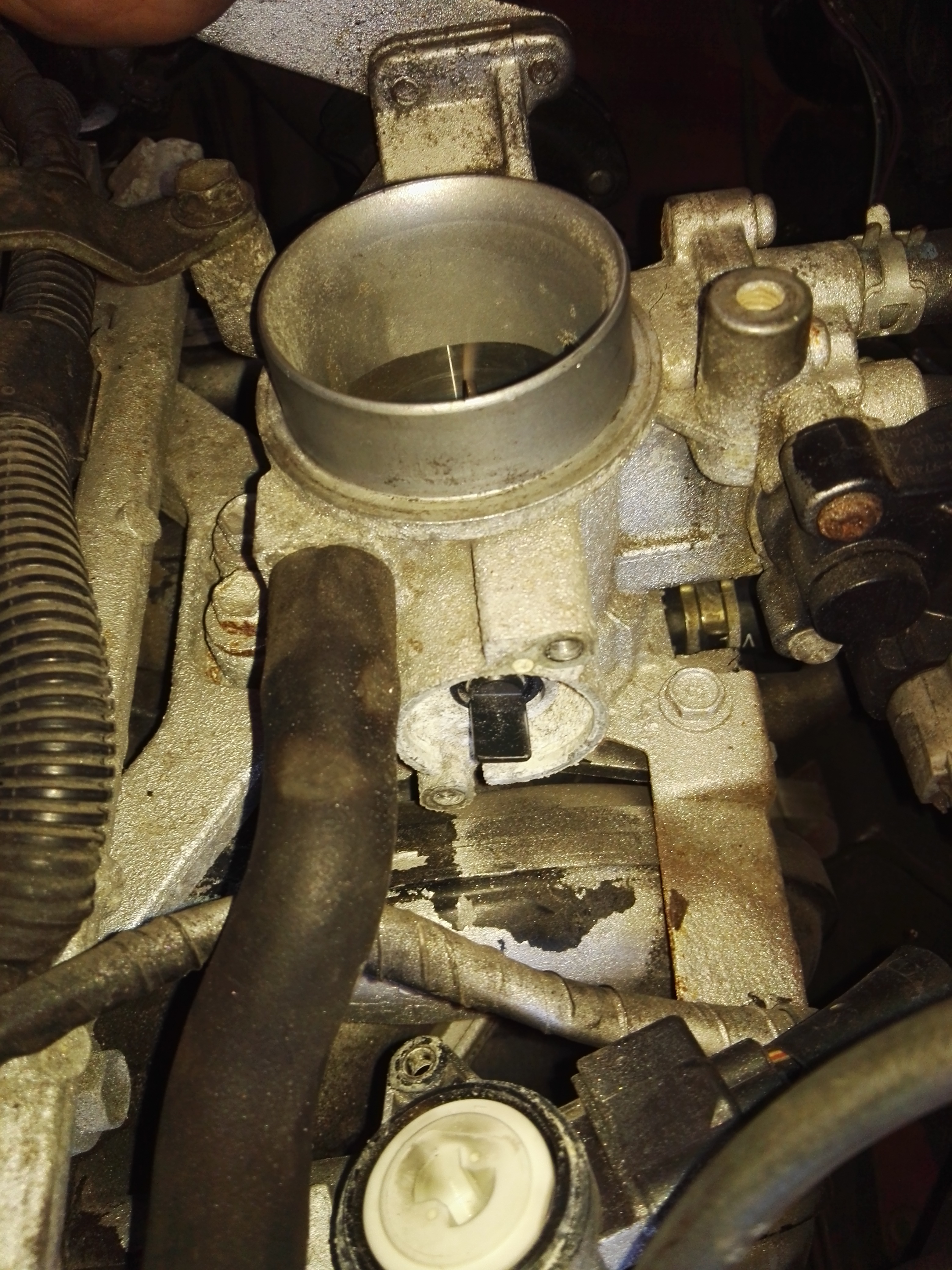

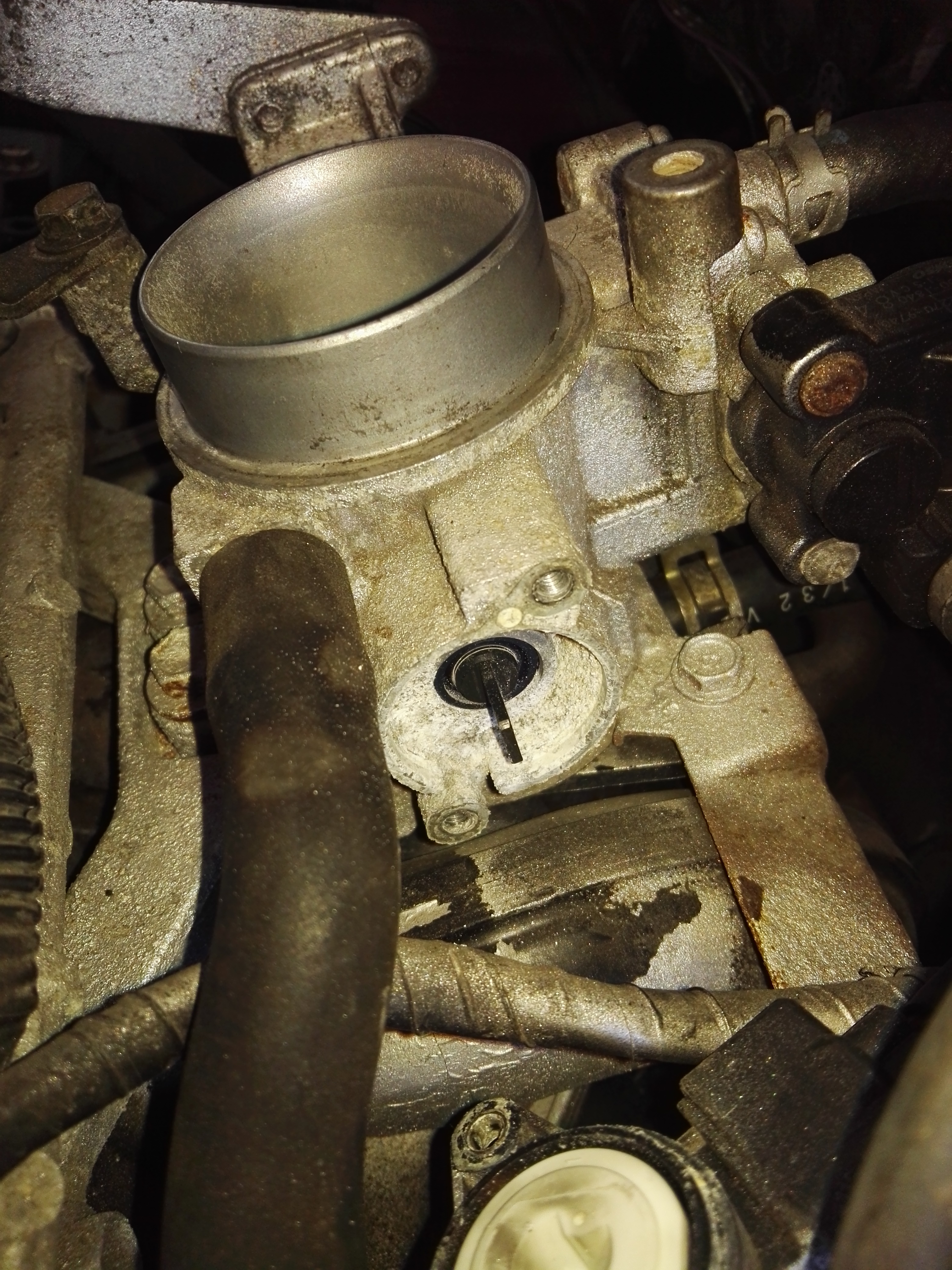

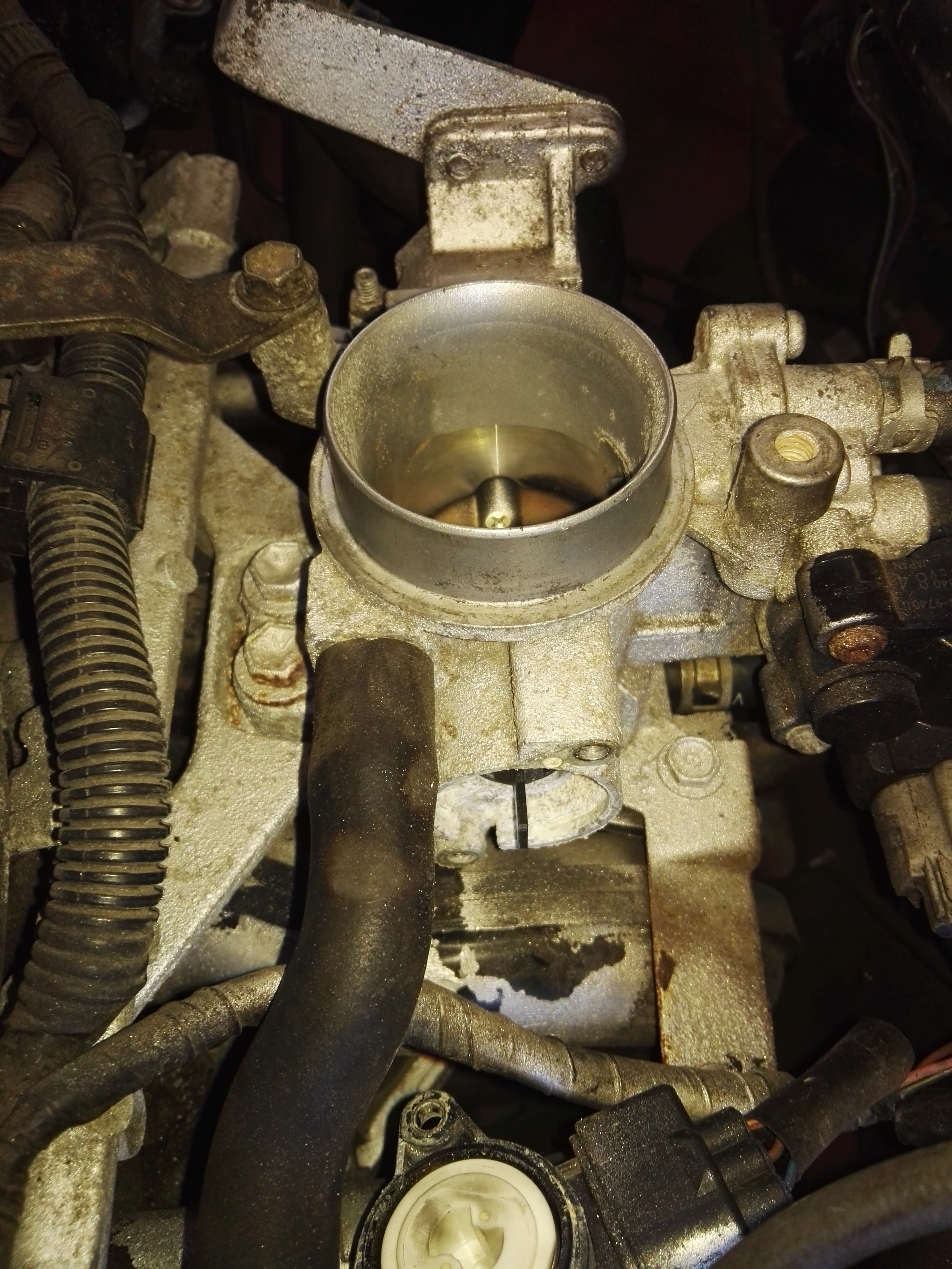

Might need some pics. Sorry, I’d normally make a mark, The offset tab that goes into the throttle position is offset. Where does that sit at the closed position?
@Mr_Gormsby at the closed position the tab is vertical, at WOT when the butterfly is vertical the tab is tapered ever so slightly downwards towards the bottom rear (rear is the coolant channels). Here are some photos, but im not sure if they will help because its hard to see the angles properly.
The first and third photos are closed position and the photo in the middle is at wot
They help. I needed to see which way the offset sat.

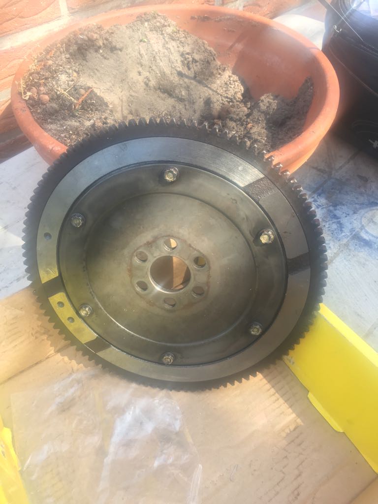

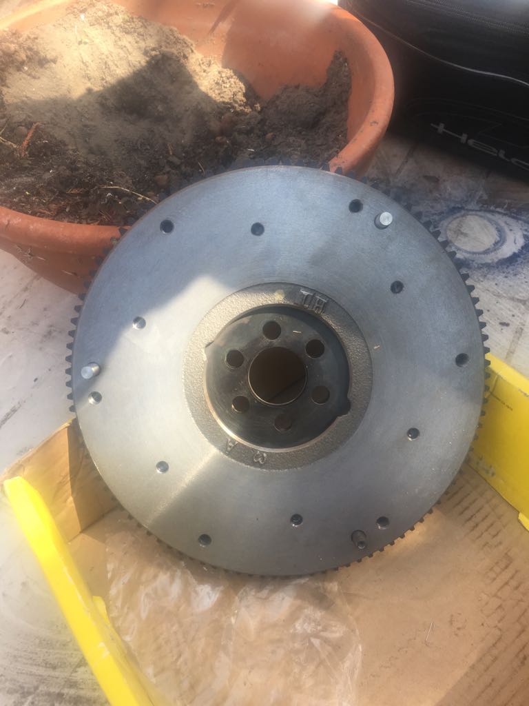

I got my flywheel finished, but I may have a problem… When I told him how much material to remove I didnt think to measure how deep the threaded holes were for the back piece. Here are some pics.
Holes need not be deeper than one and a half bolt diameters
I mean the holes closer to the centre that hold of the backing plate on, the clutch disk will be riding over them. The holes for the pressure plate are ok.
@Mr_Gormsby do you think it will be ok?
