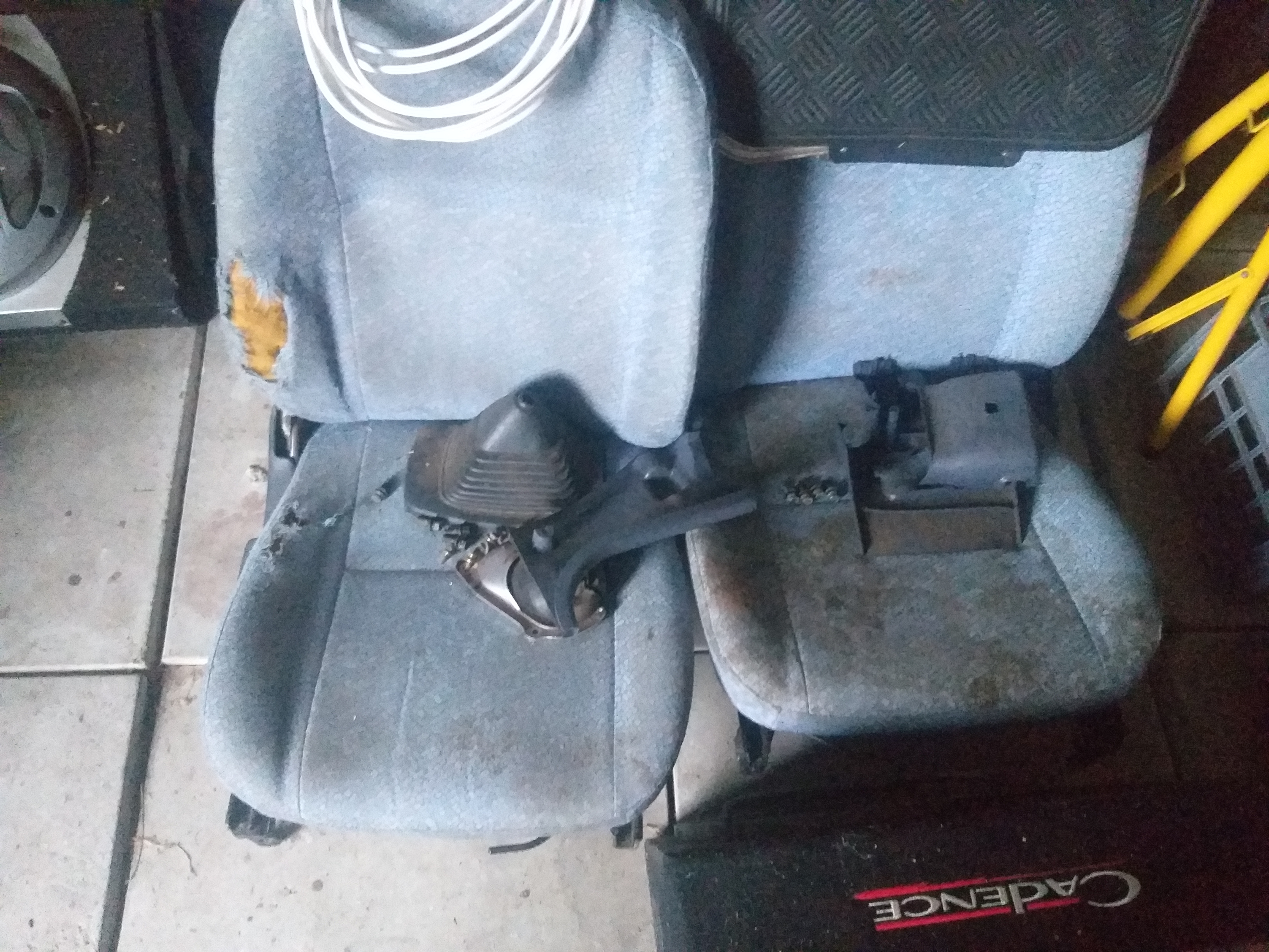

They’ve been out for so long that I forgot how bad the front seats are. I’ll have to keep an eye out for a pair or throw some seat covers on them for the time being…

Regarding the seats, perhaps some Sirion ones would fit?
I have seen sirion seats in a mira and yeh need to be modified to fit. These have the same setup as a move for bolt holes for the seats. If you modded these in then the seats sit higher and if your a tall person it ain’t gonna work real well It did for the move as Im not tall and the move’s are really tall. I would definitely look at cover’s or something easy.
