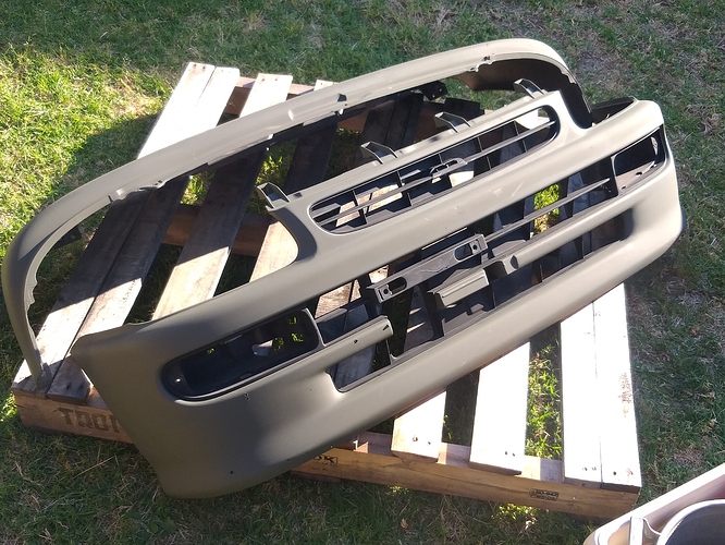

Getting there…

The light of the day in the pics doesn’t show the actual colour, it’s actually deep forrest green, a deep flat army green. You can see the green better in the bumpers and the inserts I’ve painted deep flat black.
oh yeh you can too. I looked at it first thing in the morning and just saw black haha. It will look good man.
haha that’s okay, the missus says she sees grey and she’s seeing it in person.
