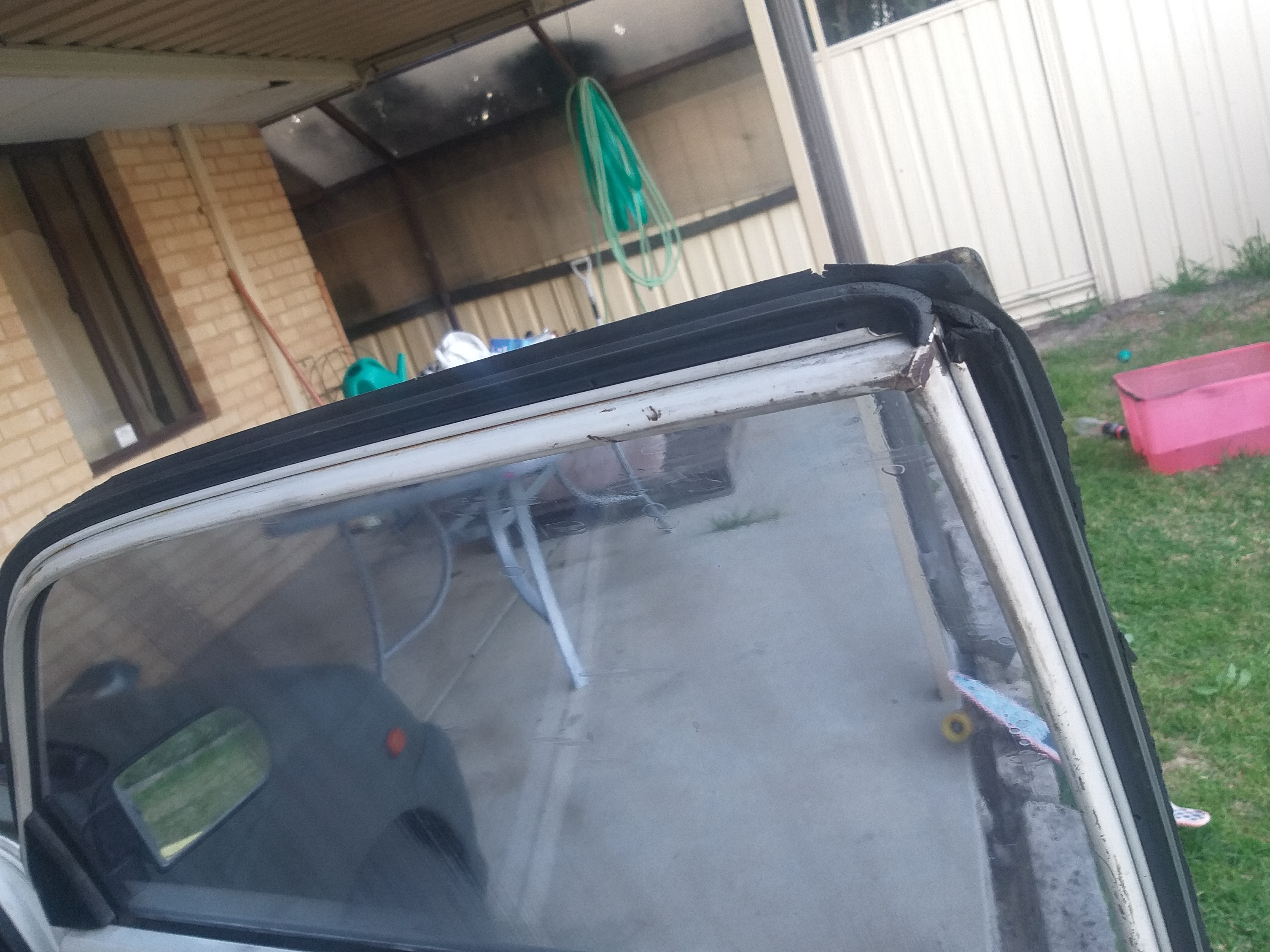

Heading out to Clark Rubber today to see what their range of seals are like as I need new front door window seals and the weather seals that goes around the inside of the doors.

No luck at Clark Rubber for the door seals. Found the three part numbers I need on partsfan so I’ll give that a go with the local Toyota parts department.

Those weather seals I wanted, almost $500 and that’s with two of them discontinued. Time to keep looking for generic stuff or hope I find a wrecking two door L5 that has the seals I want in good nick.

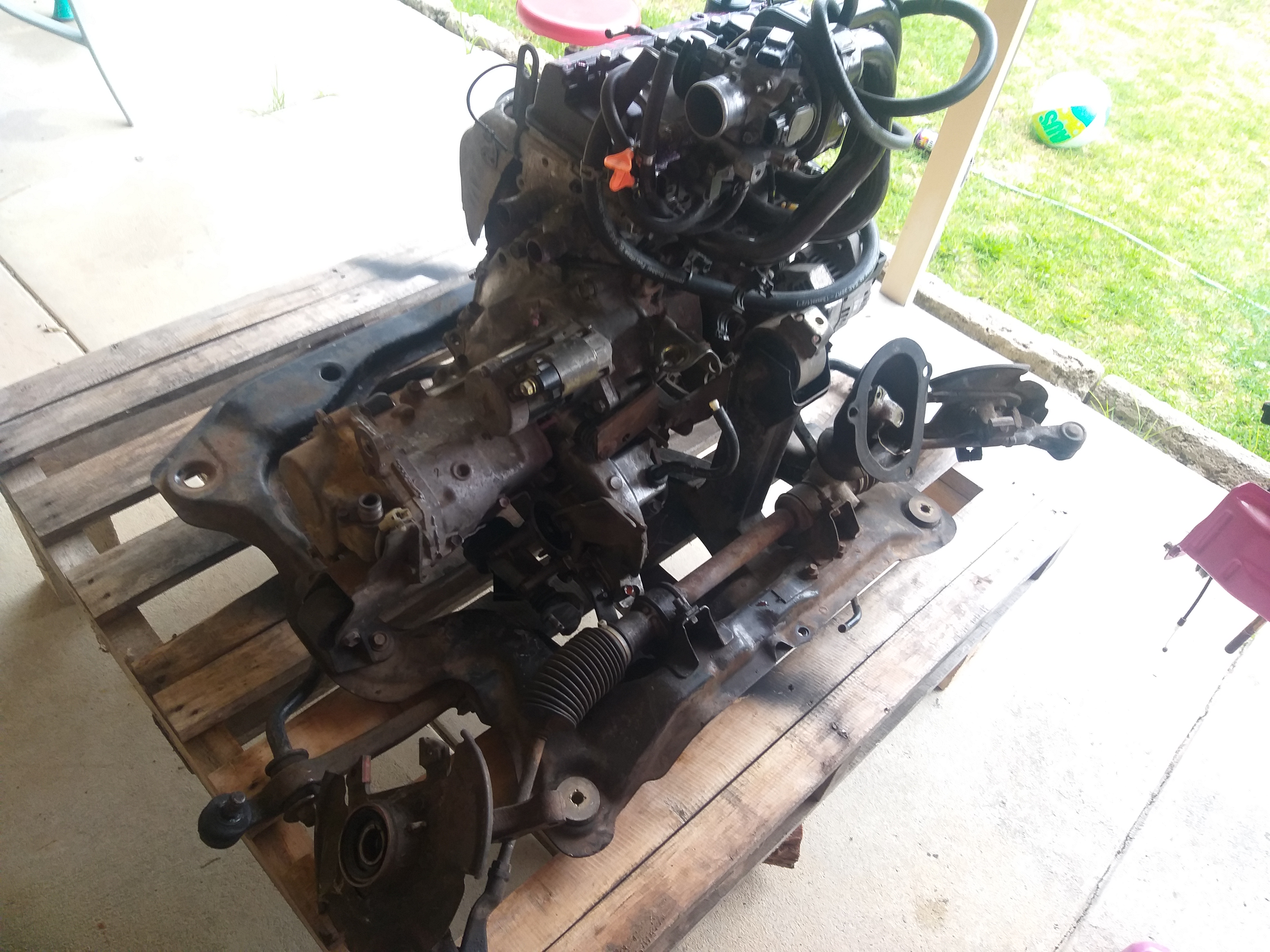

So 29 days ago I put the L5 on jacks and that’s where it’s been since as I’ve had no motorvation to work on it, I just cbf’d to be honest.
Yesterday and today I pushed through it as much as I could and I got as far as dropping the subframe, getting the gearbox off and taking the end plate off.

I showed these two worn down gears before, but they still amazingly make contact. I wonder if the gear set in my L80 gbox will fit my L5 gbox?

I’ll be trying to make time to split the gearbox this weekend to see what I did wrong during assembly. But if it looks the same as when I first assembled it I think I’ll post pics so you guys can see any problems, as I don’t know of any way else it could go together.
