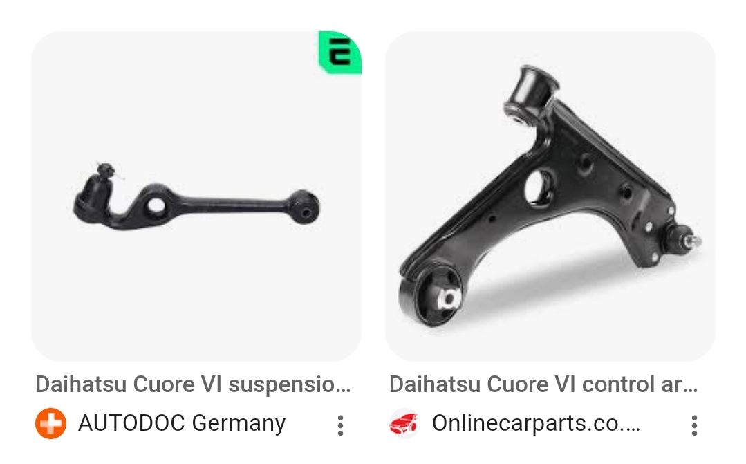

Which is the one it uses the cast iron or the welded one??
Both fit but if your doing 4x100 conversion then use the Cast LCA as they bolt to the sub frame inplace of the L600 ones. You will need to extend your cv shaft (atleast the driver side anyway) as the L600 hub setup is different to the 4x100 type, especially the outer cv joint.

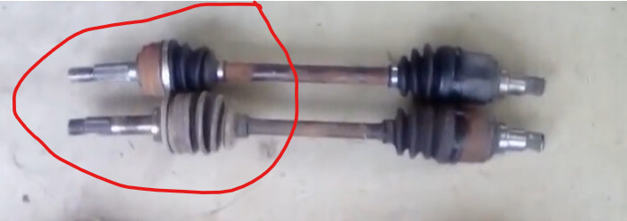

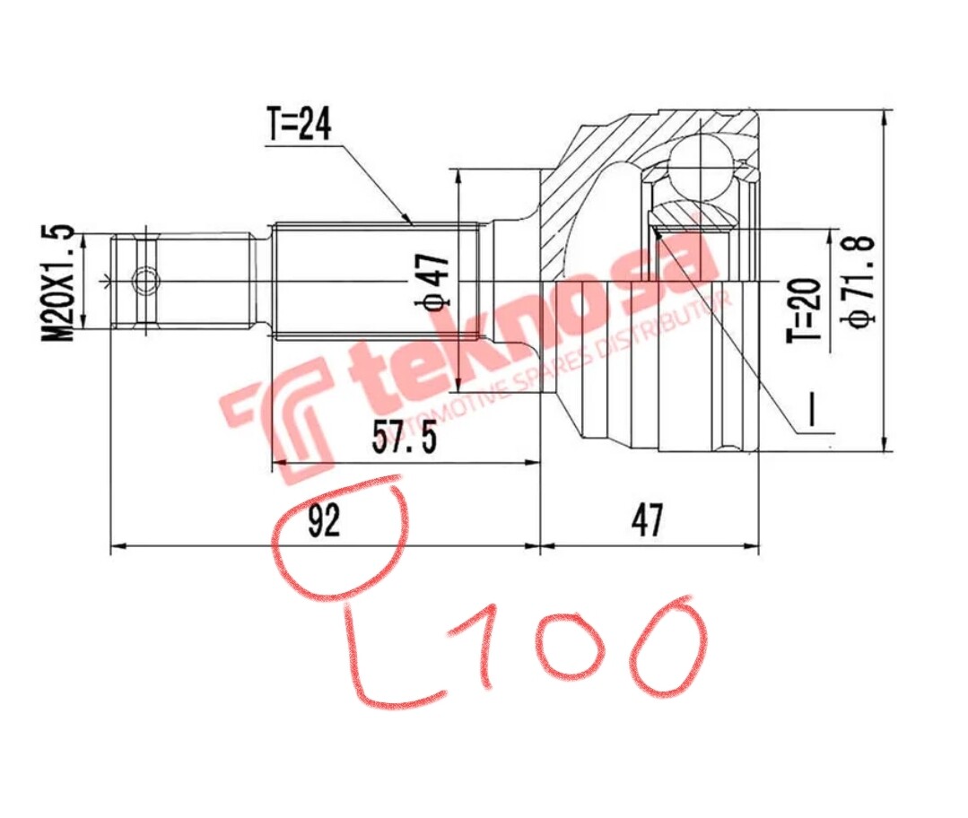

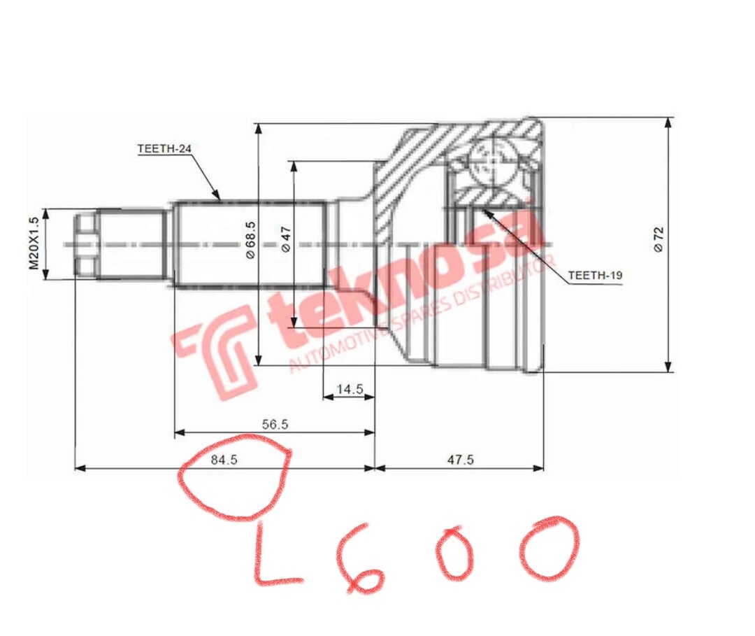

doing that does not change you will need to cut n shut the cv shaft. You cant use the outer L6 cv on a L7 hub. The splines are in different places. hence why you need to lengthen your drive shaft. This has been covered many times in the forum. I may have it in my move thread. Also @ceiliee has covered 4x100 many times and is about the latest one to do it as far as I’m aware.
Not being an ass just trying help. here is a bad pic from what I mean.

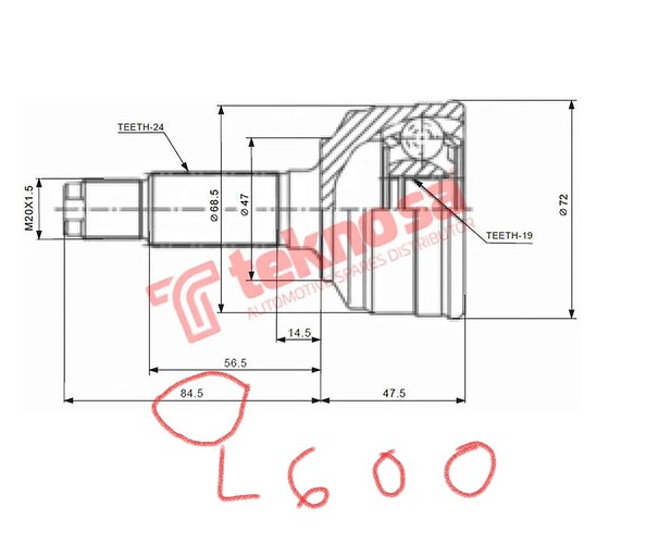

No not at all, this is all truly frustrating I understand. And the video is very helpful thank you, it’s a great resource seeing others having knocked their heads with these same issues before me, saves me some pain!! Are l200 shafts and l600 shafts the same length?
I see the length difference in the l700 and l600 outer cv cup. Wouldn’t the cup make up the difference, or would the driveshafts still need modification.

I actually never welded a drive shaft I found the passenger side to be fine but for the driver side I bought Jackshafts from Yahoo Japan Auctions and I have to use camber bolts as it was still a tiny bit short and gave + camber. Many others have Cut n shut the drive shafts.
The cups don’t make up the difference.

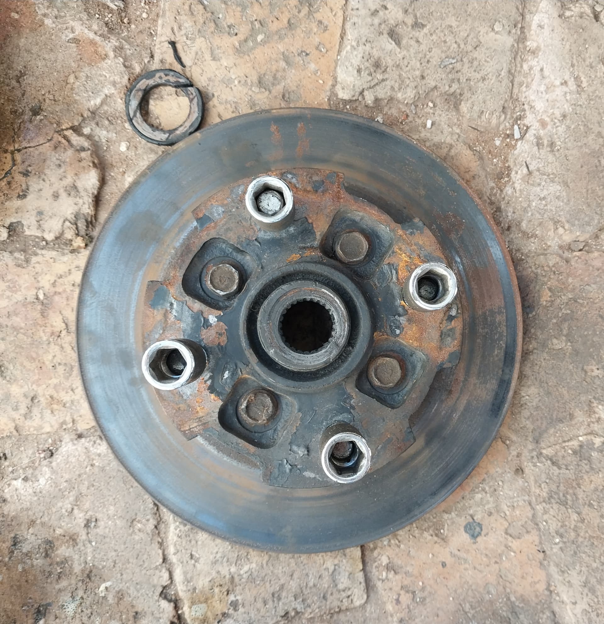

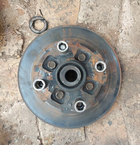

Right so I managed to source both front hubs calipers discs etc complete off a g11 charade, so now my question is, will this bolt directly onto the Moves strut steering tie rod and ball joint, the outer cv will fit on the Moves shaft no problem.
The short answer from me is no Idea I have never tried with a g11. I have never even worked on a g11. You may be lucky with it you may not.

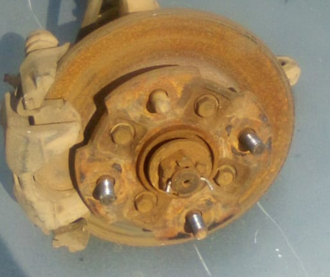

They look to match on the pics obv these were sitting in a field in some guys farm.
Vs mine from the garage
Give us the green light evilhighway and we will take the plunge.
this is uncharted territory for me hahaha. Your gonna have to make your own call on this one.
They look promising. G11 is 4x110 same as a Move. The brakes look bigger than a moves brakes. If they work that would be a bonus.
